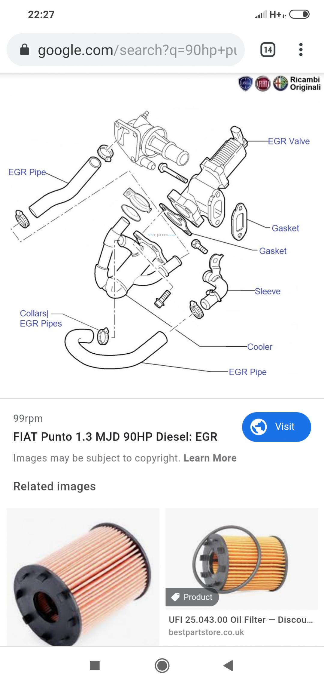

The egr is connected too exauhst manifold yes and the coolant system, because when i went too remove it, coolant came out, the pipes from the egr lead directly into the radiator mate, theres no discussion on that ill add a video if need be.
One goes into the inlet manifold with the metal pipe, the other 2 are running coolant and 1 of them is fed straight from the radiator into the egr.

What diameter radiator hoses are going to the egr?
If you don't mind getting dirty, you could just take the lower radiator hose off and let the coolant drain out everywhere or into a tub
Ah I see now

I blanked the egr and it didnt smoke fan didnt come on and it didnt over heat( i say overheat it dosnt overheat on gauge just feels too hot).
Engine failure light did come on though which i assume normal untill the egr is deleted.
