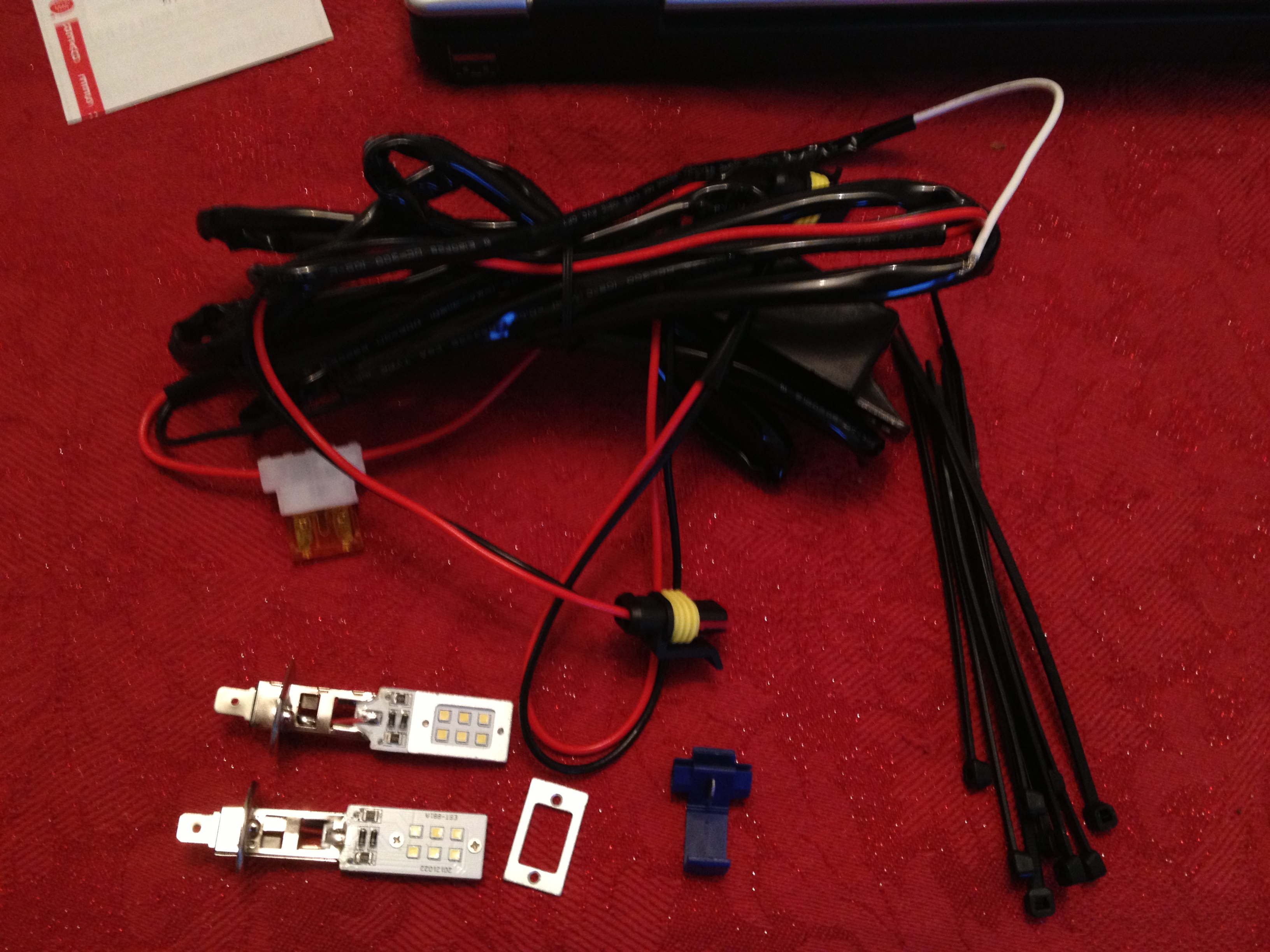

Things you will need:
Drl relay switch
H1 Led Bulbs
Superseal 2 pin connectors
Cable Ties
Scotchlock
Tools:
Crimping/wirestripping tool
Wire Cutters

The drl relay comes with connectors already on it but the wrong type so needs cutting off.

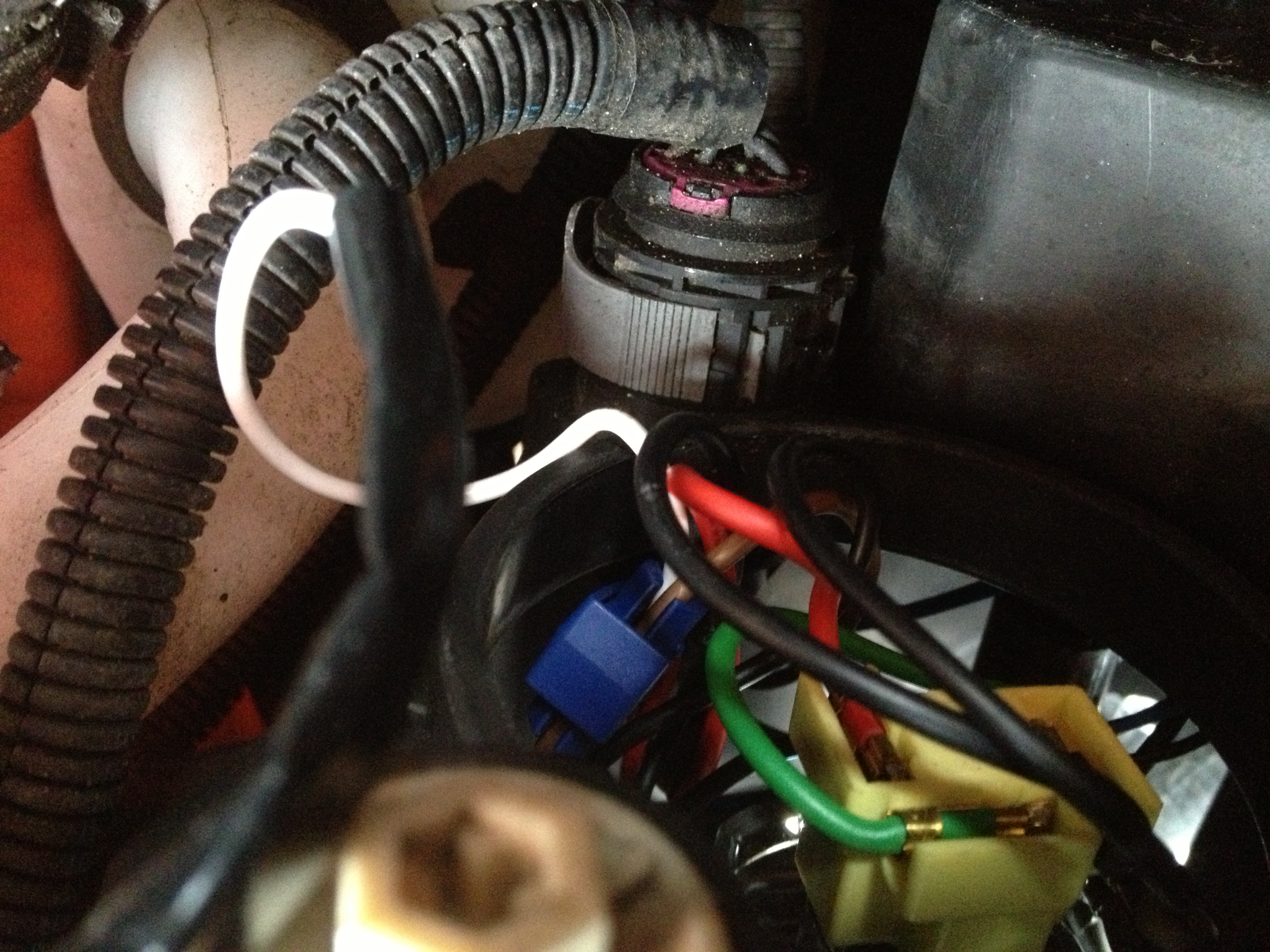

Make sure you connect the positive and negative the same as in this pic for bothsides

Then connect your superseal connectors to the back of each lamp
