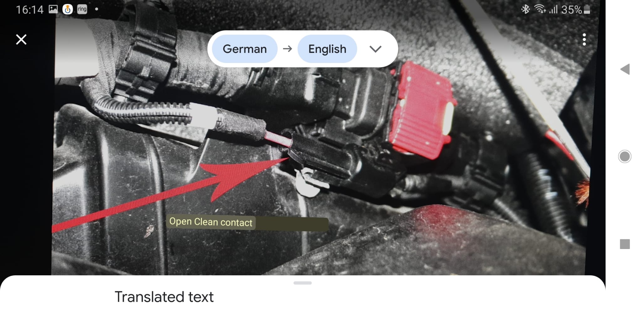

I had found the red wire connector was causing the problem in the past - pictured below (under bonnet, passenger side above fuse box) - this meant the pump wasn't running to pressurise the robotic system that powers the clutch, hence no gear change available. Now however, this plug is not the cause - there is no power to either side of the plug. there must be a solenoid and possibly an elusive fuse no 26 that I can't find. I rather think a bad connection - or another one I should say- as occasionally I hear the pump running.

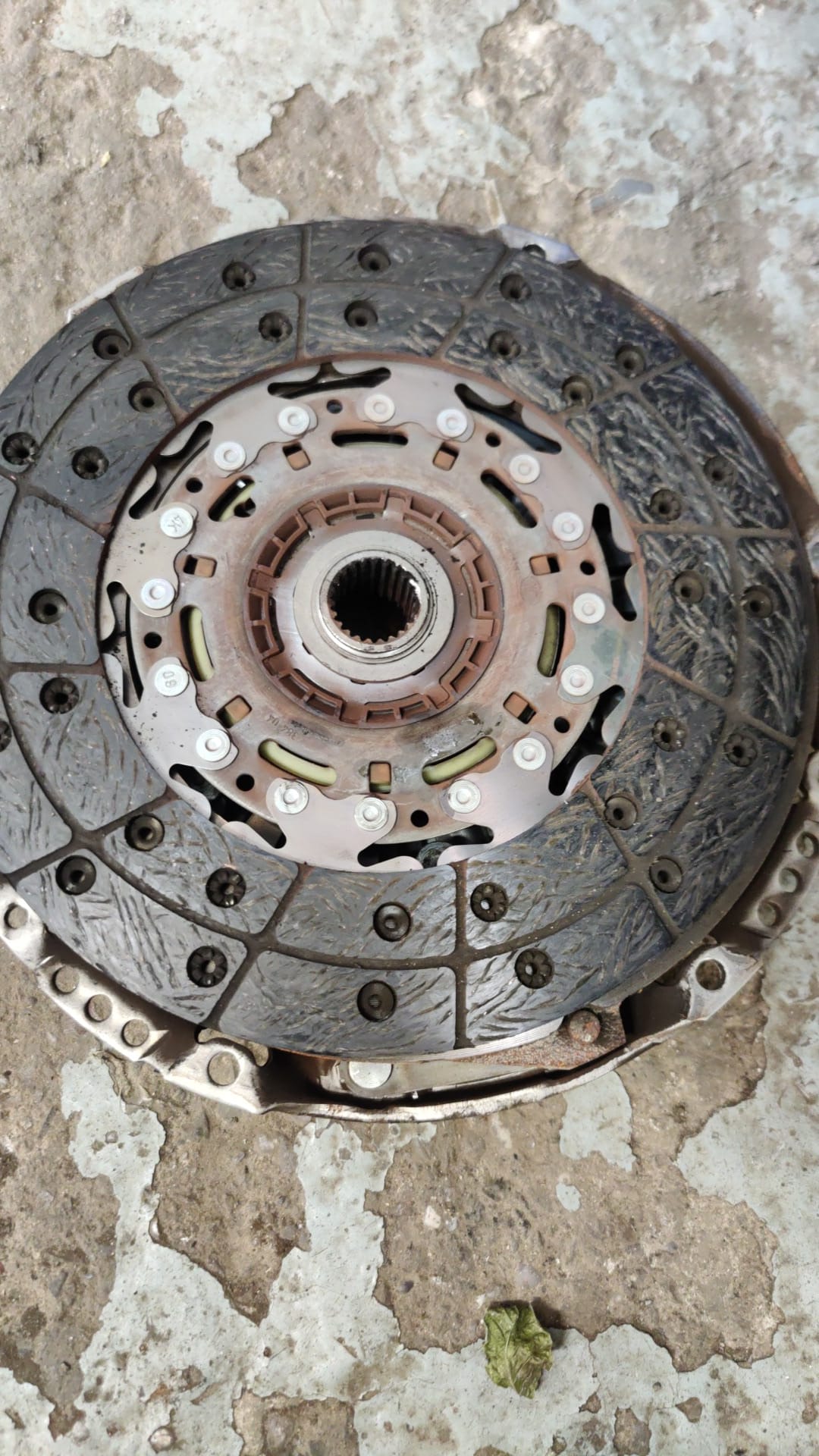

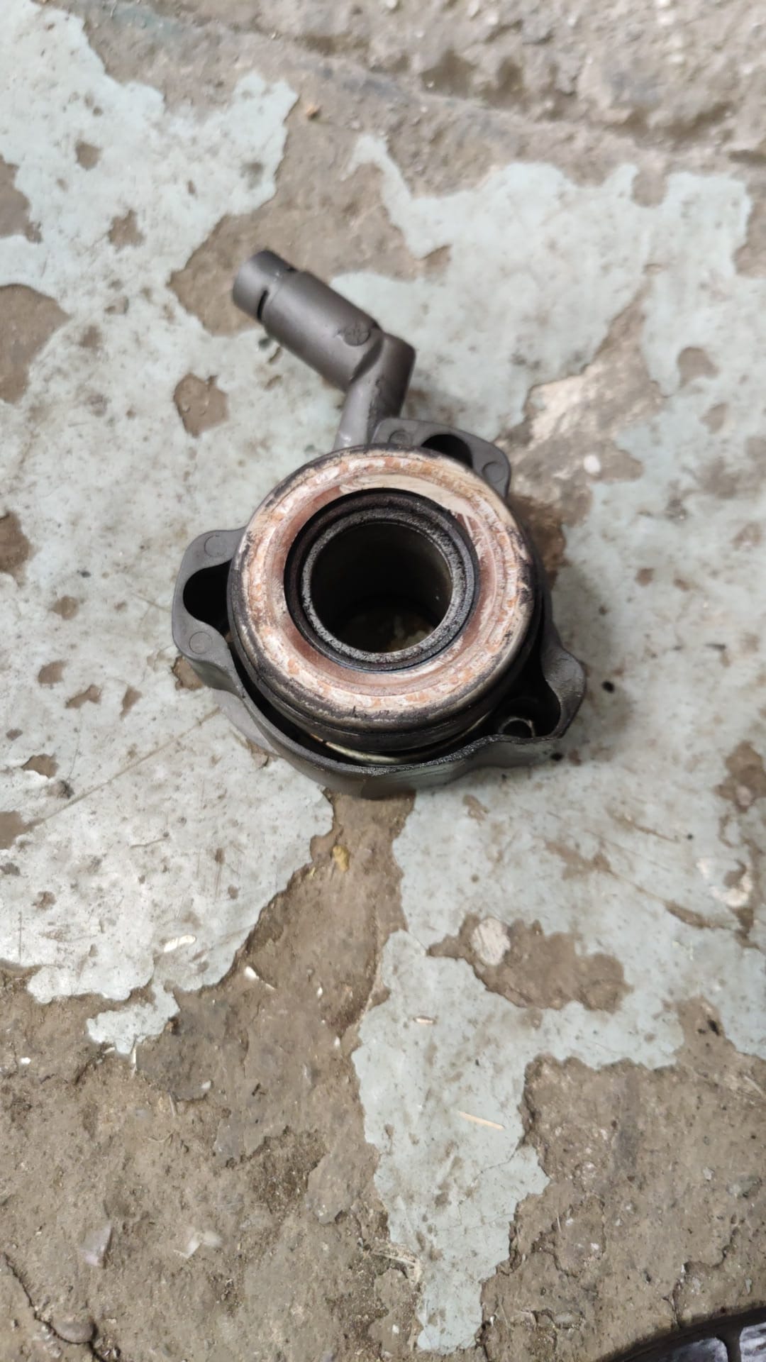

As I suspected the clutch plate fitted to these vehicles from 2014 to about 2018 have seven springs that have plastic covers and these get very hot & break off - causing various problems such as getting stuck in the mechanism & throwing fault codes up that stop the gearbox from working - 'gear not available' I suspect the bits possibly get into the slave cylinder & cause that to leak as well. There is a huge thread on it here from the Netherlands - Google will translate it for you:
https://www.nkcforum.nl/topic/5-probleem-met-automaat-fiat-ducato-uit-2017/
Here are pictures of my clutch plate:
I have had a Sachs clutch fitted now - without these springs! It amazes me that several suppliers still sell the original plates with the plastic bits!!
I can't tell you what it drives like yet as I need a hydraulic pipe replacing that will take nearly 2 weeks to get here from Italy :(
If yours is the same when it is taken out I strongly suggest you replace it with one without these plastic parts!!
