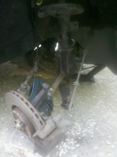

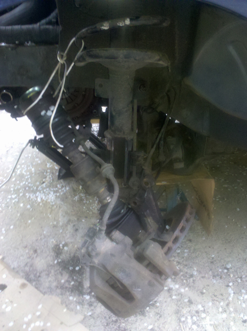

4) Driveshafts
I found that you don't need to break the track-rod ends on either side or undo the anti-roll bar nuts to get the driveshafts out of the way, just undo the two bolts attaching the hub to the strut on the N/S and you'll have enough room to maneuver.
On the O/S, you don't have to split the driveshaft, but you'll have to undo the two hub/strut bolts and crack the lower wishbone knuckle to get enough movement to actually get the driveshaft clear of the gearbox oil seal.

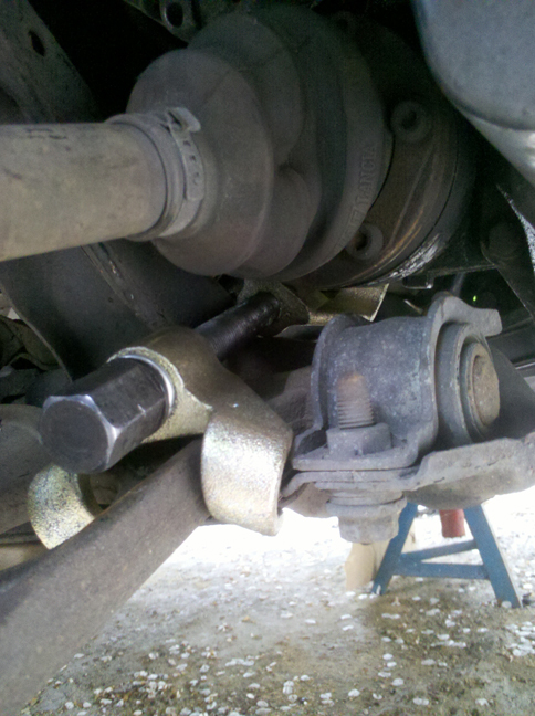

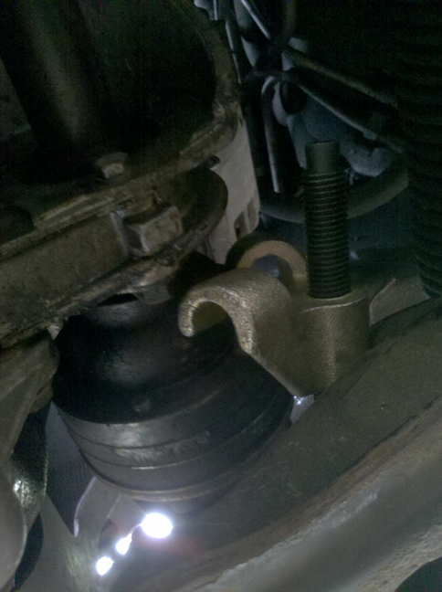

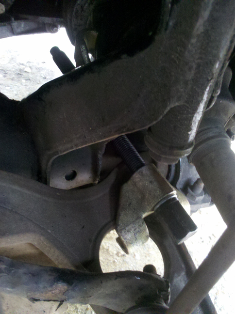

I had trouble getting the O/S driveshaft bearing to move, so I improvised a puller using spring compressors (Hilka, £17.99 from Screwfix) between the driveshaft flange and wishbone as below:
Fair amount of pressure on the puller and a couple of sharp tugs on the hub and the bearing popped out of its housing, allowing the driveshaft to clear the gearbox oil seal.

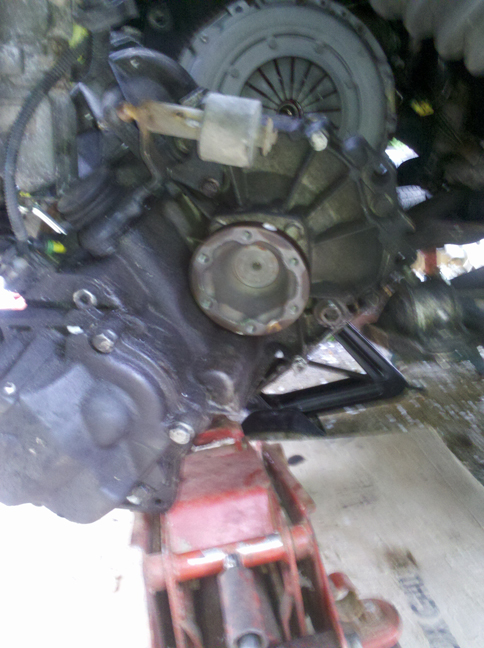

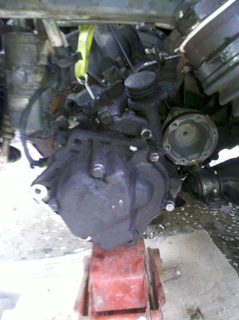

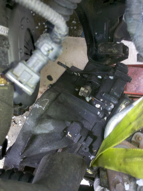

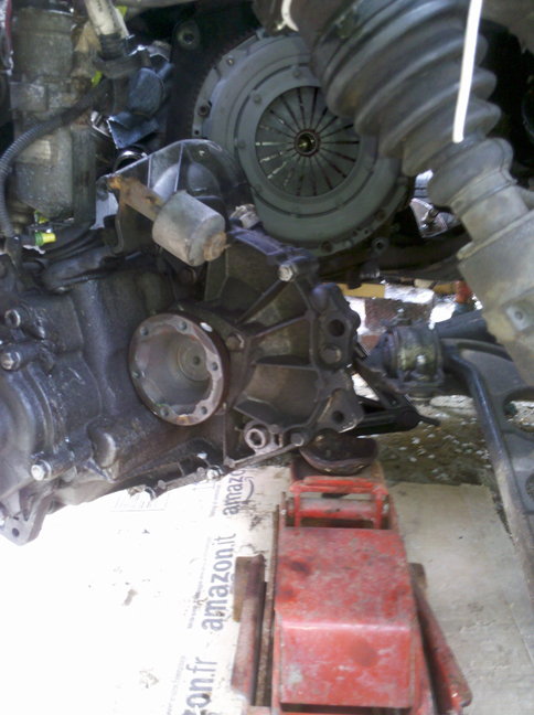

5) Gearbox

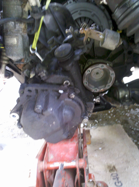

I got mine out without dropping the subframe. It's tight, but not impossible. And if like me the look of the rusty bolts on your subframe give you the fear, here's roughly how I did it.

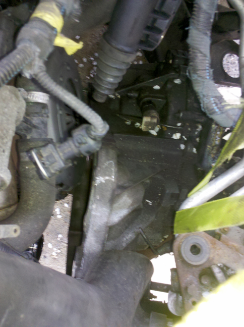

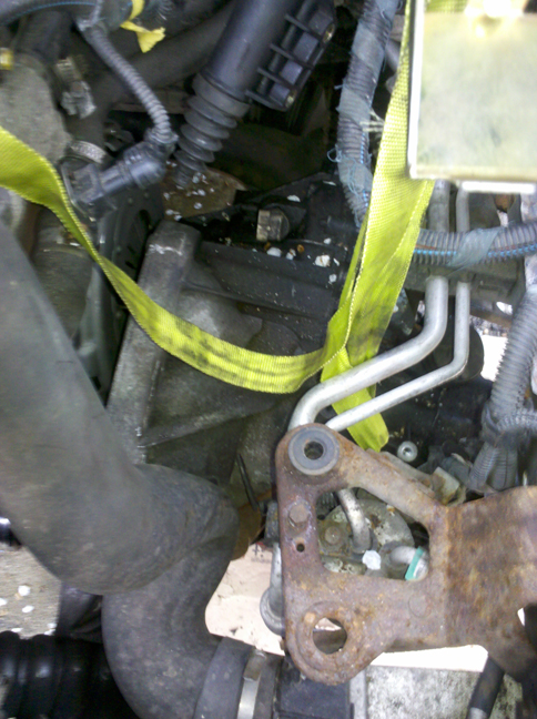

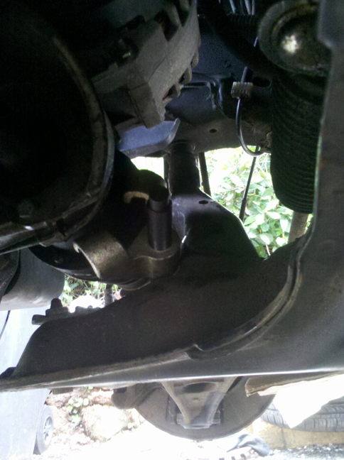

After much wiggling, I came back to the forum as I vaguely remembered reading that someone had managed the feat. I found the post from Flying Clutchman saying that you need to jack up the engine. Only having one hydraulic jack (which was under the gearbox), I put the Multi's own scissor jack under the sump with a block of wood. I think that this helped (more by luck than judgement) as the articulated foot on the jack allowed the engine to move backwards (towards the bulkhead) as I raised it, giving a bit more clearance at the front to get the box out. I also had to undo the front intercooler pipe (the corrugated one) at the engine end, to give enough room for the bell-housing to come out.
In the end, the box had to turn in two axes
- as you look from on top (under the bonnet): clockwise
- as you look from the end (through the N/S wheelarch): anti-clockwise

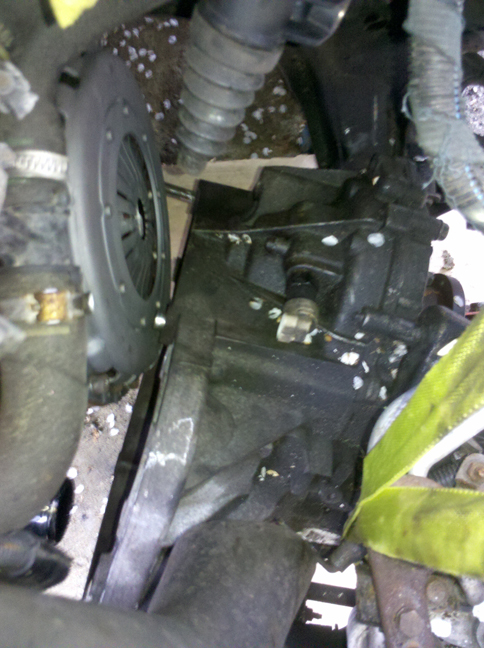

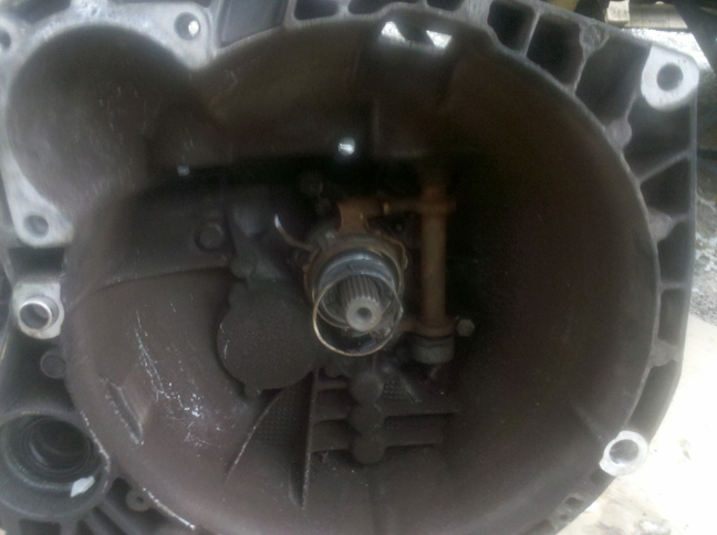

I took pictures as I put it back in to show roughly how it went (apologies for the poor focus on some of them, not the best light and camera on my phone):
After the last photo, I spent quite a long time scratching my head and not being able to get the splined shaft to line up with the clutch until I realised I needed to let the engine back down off the jack. As I did, the engine obligingly came back forward towards the radiator, and the gearbox slid nicely home. Success (y)

I just wanted to say thanks to Ben, I spent two hours trying to get the driveshaft out and had the same issue with the bearing. Your solution worked perfectly, thanks!
