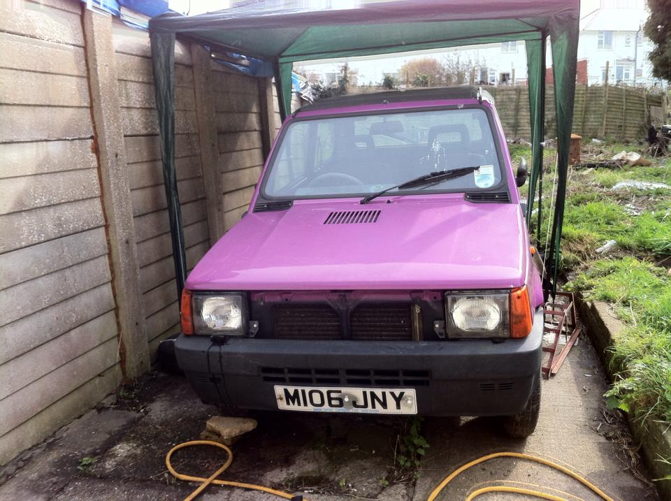

hey, im chris from south wales been lurking on here for a while but now seeing as ive started work on the Panda i though id let you in on it ,The cars a 1994 panda 1000 fire Colour , my grandad bought it from new (my nan chose the colour) , it spend most of its life in a garage although it spent a year in my brother ownership so theres the odd dent , but apart from that , rust is minimal and its got an immaculate interior.
my aim is to do a resto mod as the americans would say, restore the whole car , Standard interior,respray, cleaned bay, lowered suspension and nice,possibly widish wheels, possibility by widening the body,maybe
atm heres how it stood up untill last week , only real issues are that its been off the road for two years ,at the time the front caliper was sticking and the rear beam center bush was knocking its balls off. apart from that its a solid , unwelded , one owner car with 66k on the clock.

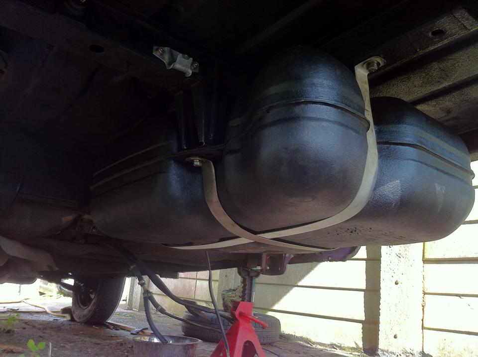

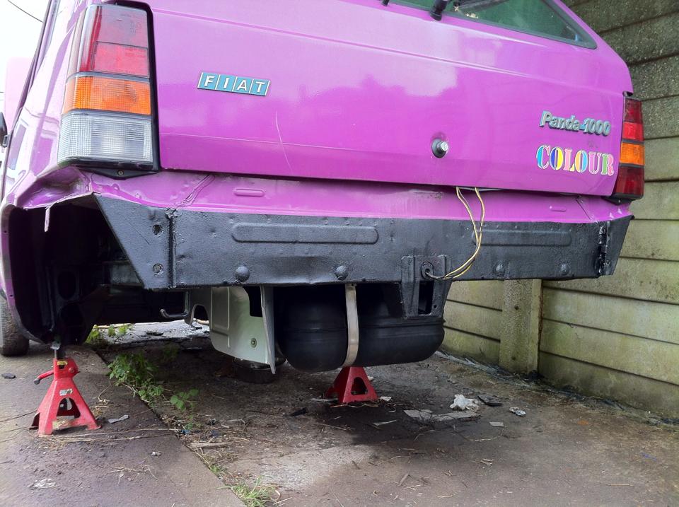

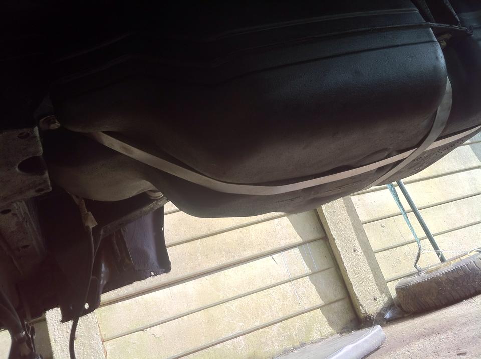

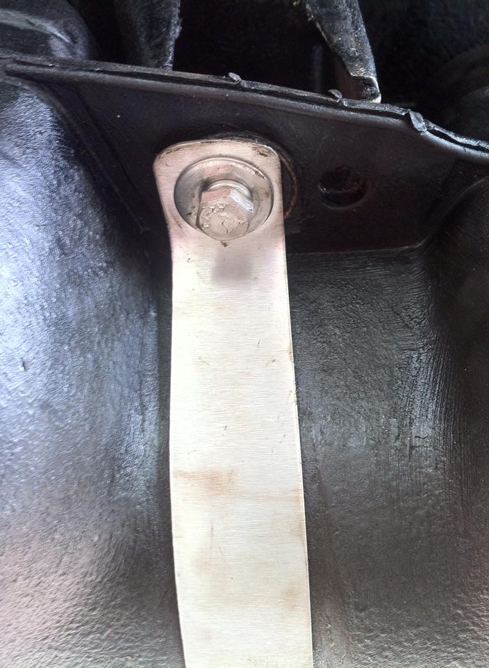

managed to get the custom stainless fuel tank straps ,cut, bent and fitted properly , all with stainless bolts,spring washers and washers as they should be. this is only a trial fit so their not polished yet , or even clean tbh lol( i could possibly supply s/s bands (unbent) and bolts/washer etc , could even bend them and have them as a bolt on ready to use set) now i have my set made its a bit easier to make duplicates.if i get enough interest ill sort out a price delivered.
also fitted the exhaust mount i had painted , with of course , stainless bolts

as always ,comments welcome!

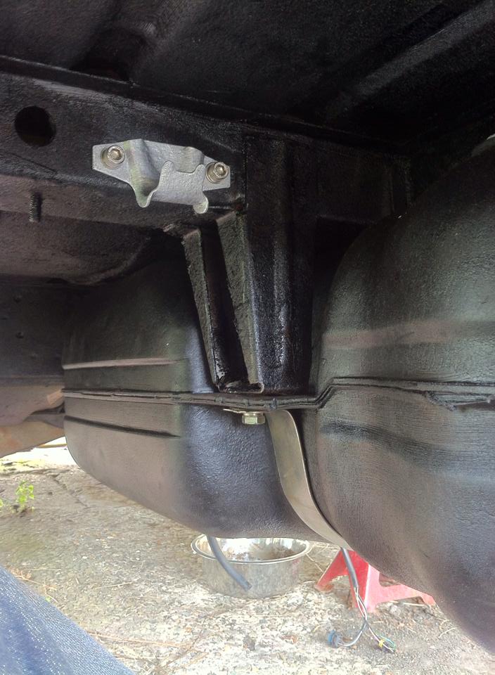

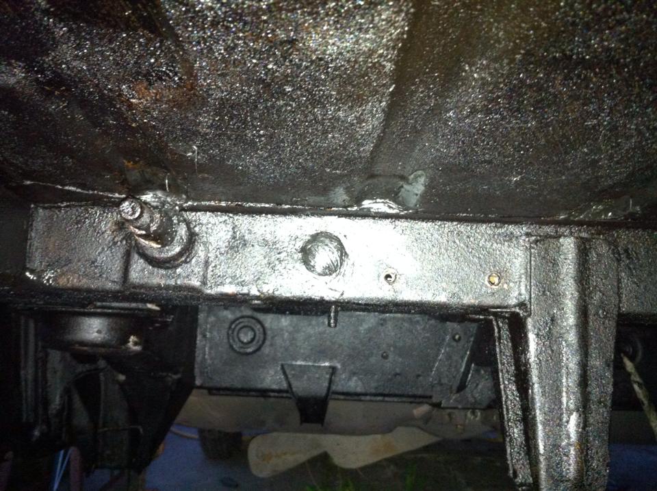

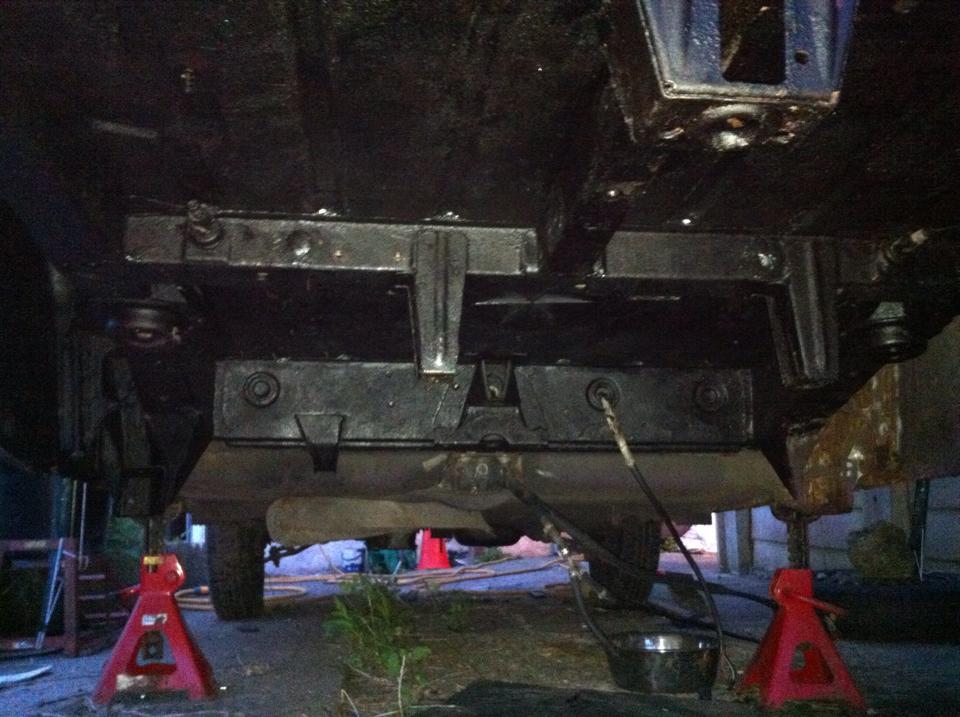

got the fuel tank back out as i wanted to seal up the gaps between the corrugated floor and flat cross beams, also started bunging up the holes in the chassis with tigersealed grommets (all voids have a healthy dose of waxoyl)

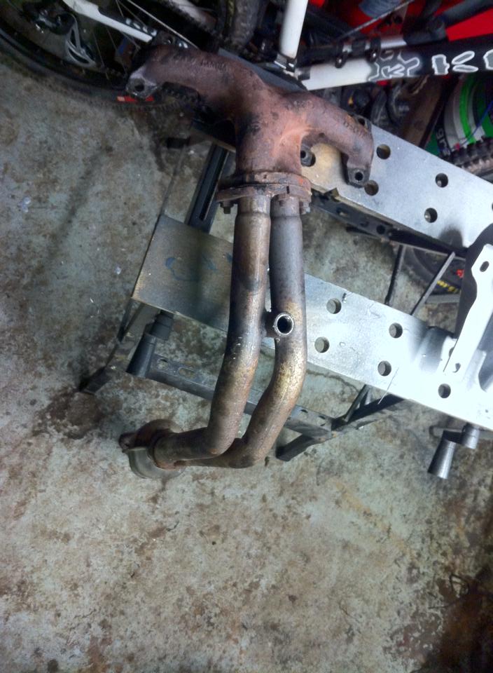

also managed to drop off the exhaust manifold and cat off.
tommorows jobs are to drop some parts off to be sand blasted , get the sill welded now my sheet metal has finally arrived , may even try and drop the engine out but seeing as ive lent my hoist to a mate i may give it a miss for now .

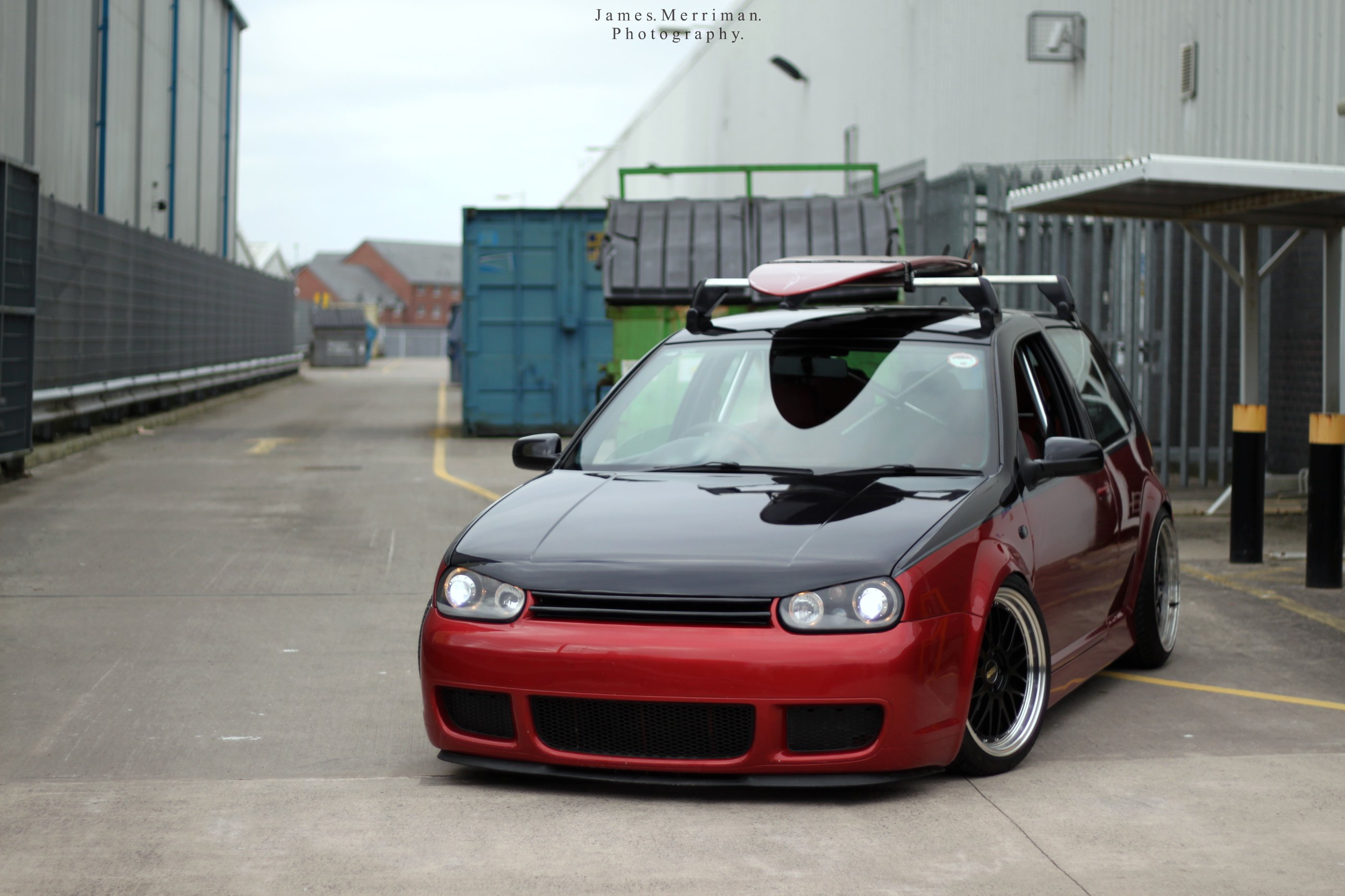

yeah i learnt on vw's , this was my old golf, managed to win 5 awards at various shows before i sold it,

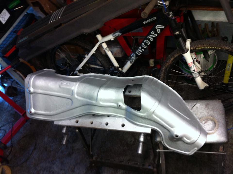

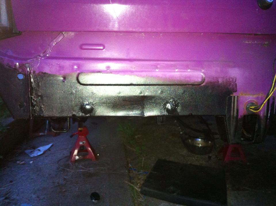

well today i managed to weld up the only part of the sill with a hole, dropped off a few bits to the shot blasters and also got the rest of the heatshields off the car and got them cleaned up , even got one painted wit vht paint too
comments welcome!

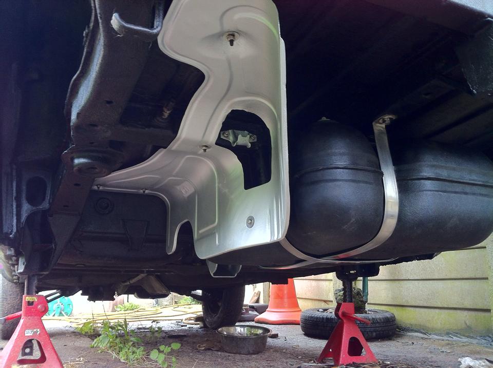

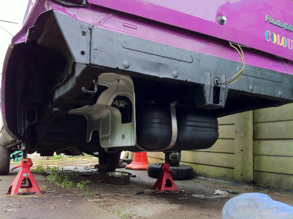

Managed to finally start putting thing back on for good! Head sheild,fuel tank and rear beam mount all fitted!

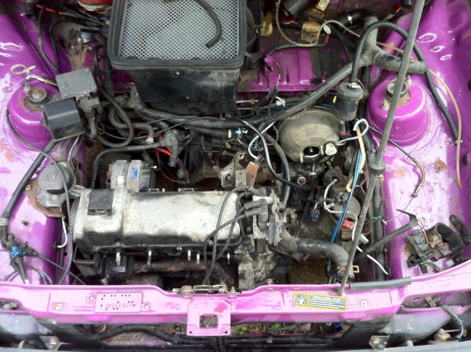

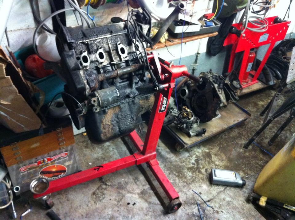

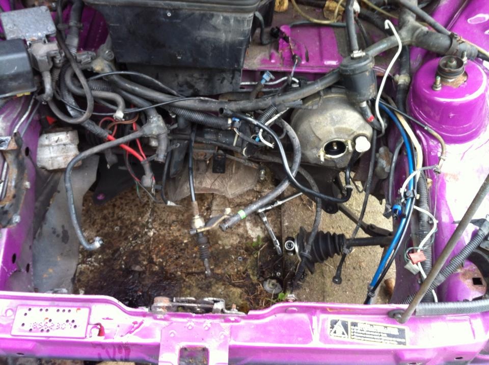

Also stripped the engine back a bit further ready for removal , only need to undo the driveshafts and it'll be out!

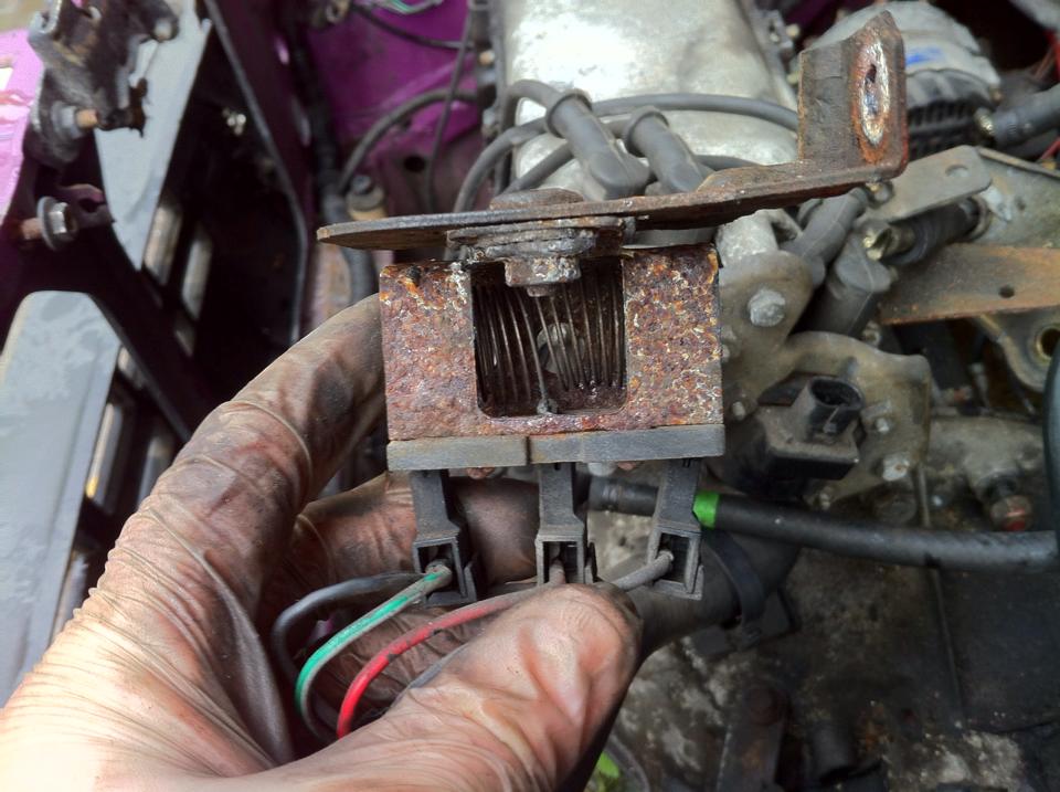

Also noticed this sitting by the bonnet latch , at the top on the radiator , seems like some sort or resistor but I have no idea , anyone know?
Comments welcome as always :slayer:
:yeahthat:
But every time a purist looks under your bonnet they'll notice! No pressure :p
In the bin it goes! Haha! .

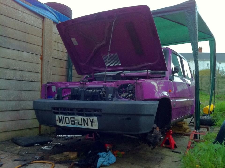

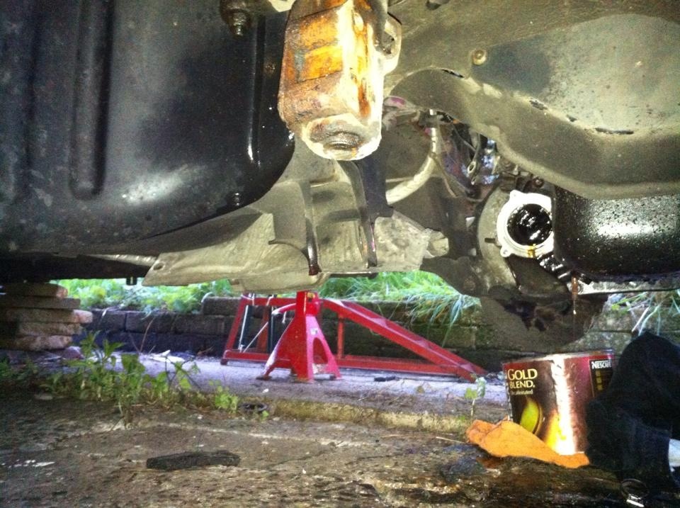

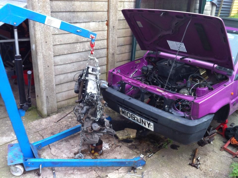

Got back from work today and couldn't resist getting my spanners out , gotta love these light evenings !
Now that the rears fully protected I've lowered onto blocks so I could get the front end in the air ready for engine removal ... Ahhh the excitement!!
Managed to remove the offside driveshaft + hub assembly , also managed to spread half the gearbox oil over the concrete :bang: managed to find an old coffee container to collect the other half lol
Comments welcome .

Mmmm, gold blend. That rich aroma:yum:
..or did you mean the car? That's coming on well too.(y)
Can't beat a bit of golf blend :cool:
