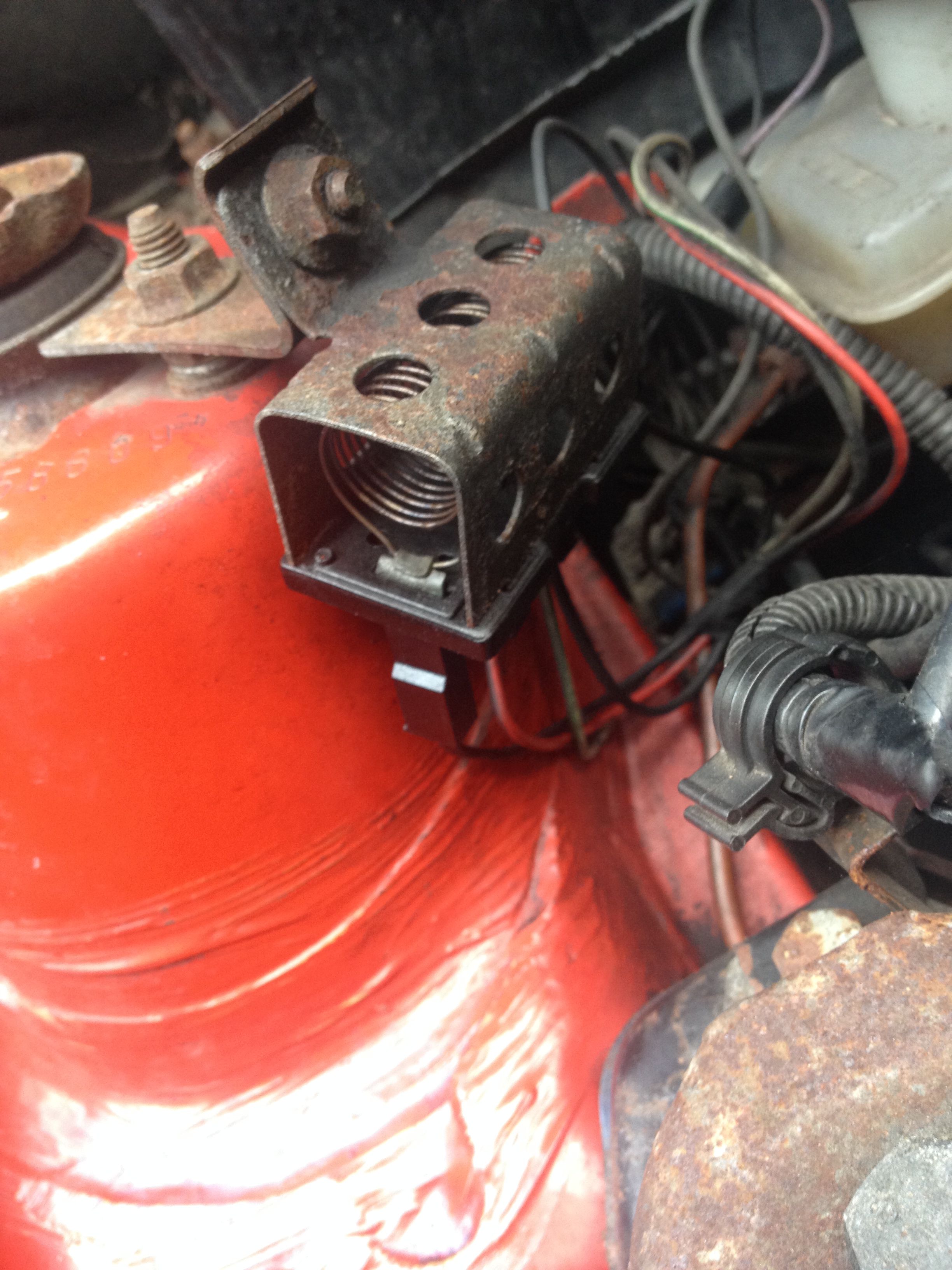

Her electrical gremlins seemed to have solved themselves once I reconnected the battery and fired her up today, wiper and interior fan etc working. Managed to persuade the sidelights to come on too.
...However, this doesn't have anything to do with those pesky sidelights does it?
After managing to get the sidelights working (headlights still work 100% fine) this little bugger got all hot and smokey in a matter of seconds.... :eek:
Thought so, if I remove it (therefore unplugging all going into it) do I then have to connect some wires together to make things happen or is it a case of disconnect and bin?
Shame about the purists, not my fault though since it's clearly buggered. Will source another before taking her to any shows (y)
It's the dim-dip resistor: puts the headlights on low, when you switch the sidelights on. Can easily and legally be binned (but the purists will mock you for eternity...)! (y)
Just disconnect all 3 wires and leave it in place. Lights should still work properly. Or, you could remove the 5amp dimdip fuse (unmarked in the fuse box) and leave it all connected and origional looking :)
I really wouldn't worry about having it there. Your car is absolutely fine for shows & looks great - it has quite a few mods anyway so would never be a purist's dream. Even if I had one absolutely mint and completely original I really wouldn't bother about that ugly lump disappearing from my engine bay - no one is ever likely to spot it at a show anyway. Just my view on it! (y)
