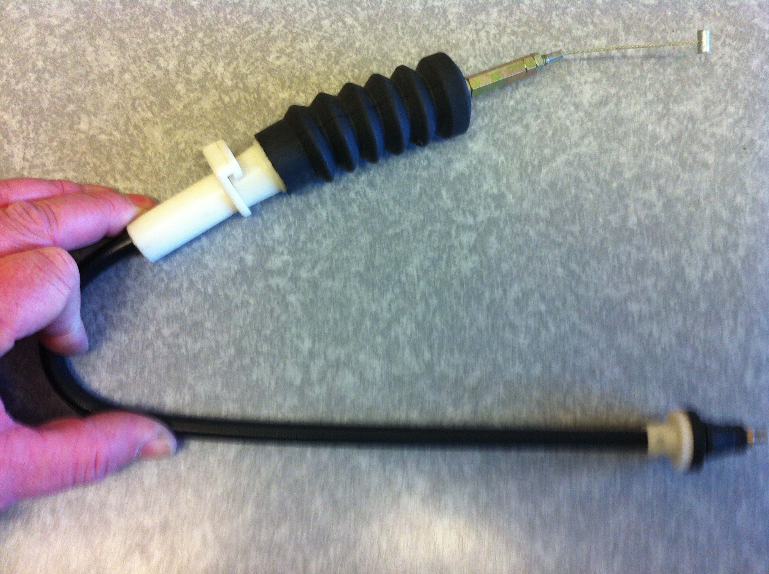

the one on Talon was different. it came up and over.. rather than down and under like this one does.
replaced it now with this type. you need to use the or mod the thing the cable winds on from off the carb of the new type. as the old one winds differently.
the throttle cable snaps on the up and over type but this other kind is built to last!
how the new one fits:
how the old one fits:

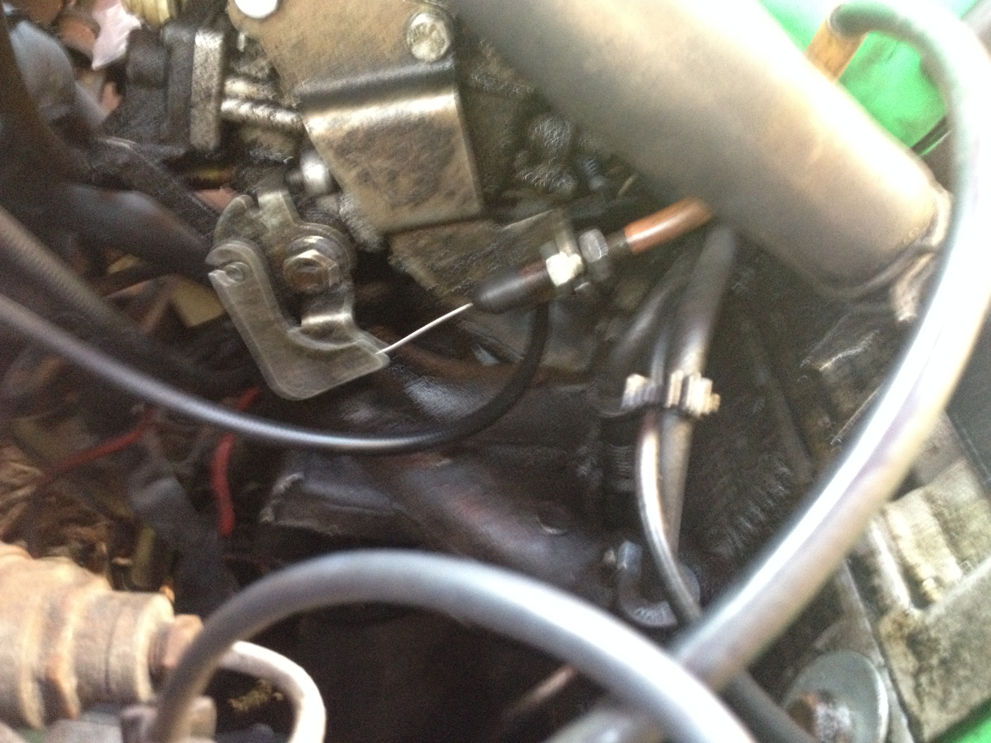

I can do next time I visit home (first week of March), mine doesn't have any of the plastic bits, it bolts onto a bracket by the carb and then hooks onto the throttle. I tried to work out how I can get the one from ebay to fit but it has too much slack between the bracket and the throttle.
Here is a highly complex diagram of my throttle cable setup, (it gets bigger if you click it...)
It only has 2 bolts on it, to hold it the bracket which is the point it gets its leverage from, unlike the ebay one which has a plastic thing and then the bit rubberized bit that compresses when the cable is pulled. Mine lacks such a thing.
Heading home this weekend so will take some pictures of my throttle cable in the hope I can get a replacement from somewhere, if not can anyone take a picture of how theirs is fitted to see if I can make the one from ebay work on Char?

I should be able to if you need it, take a pic of your carb though before hand as iirc there are 2 types of cable depending upon the throttle design.

Twiddled around with the throttle under the bonnet but couldn't get it to turn all the way to idle, its just turning itself back? Decided to loosen the nuts on either side of the bracket thing that holds the throttle cable, so now they're just finger tight rather than spanner tight and lo and behold she idles :worship: and the throttle comes back when pressed!

So.... uhhh is it ok that the throttle cable nuts are only finger tight? It seems to have solved my problem?
I'll get a picture of the cable anyway since I should probably replace it anyway, just going out to wash her now (y)

its the same throttle cable that Talon had. mine snapped where the cable goes into the metal.
see the pictures of it a few posts back..
Somehow I completely missed that post?? :confused: don't think I've ever seen it before, whoops :rolleyes:
Yes it would appear Talon has the same cable as Char', which would make sense as they're similar ages. Did you just replace the cable? Can't seem to find one for sale that's the same type.
i had to replace the thing that the cable winds on to, that is bolted to the carb.. and also needed a bracket that fixed to the intake manifold. then the other style cable..
that was the only thing i could do. these cables are badly flawed. the more common type are much better!
