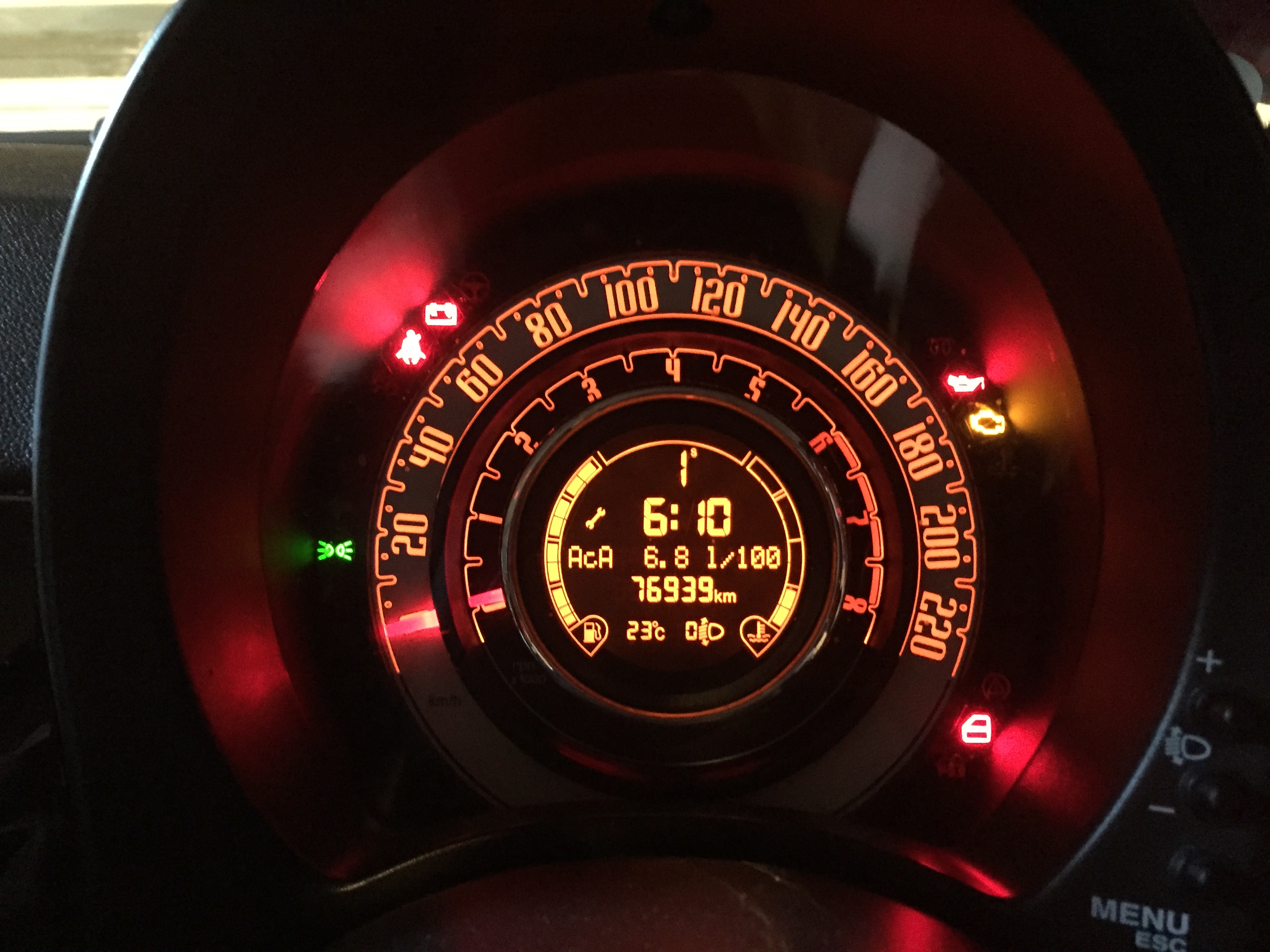

I found that the standard orange colour of the speedo and rev counter numbers was hard to read at a glance. The orange was very dark and the red needles did not stand out sufficiently against the numbers. This might be more of a problem with the retro-inspired Lounge and Pop design, rather than the Sport (which has conventional numbers).
This photo shows the standard colours, though it is difficult to capture light colours with a camera - here, the LCD looks quite a lot yellower than it actually is, and therefore, the orange numbers also appear lighter than they actually are.
