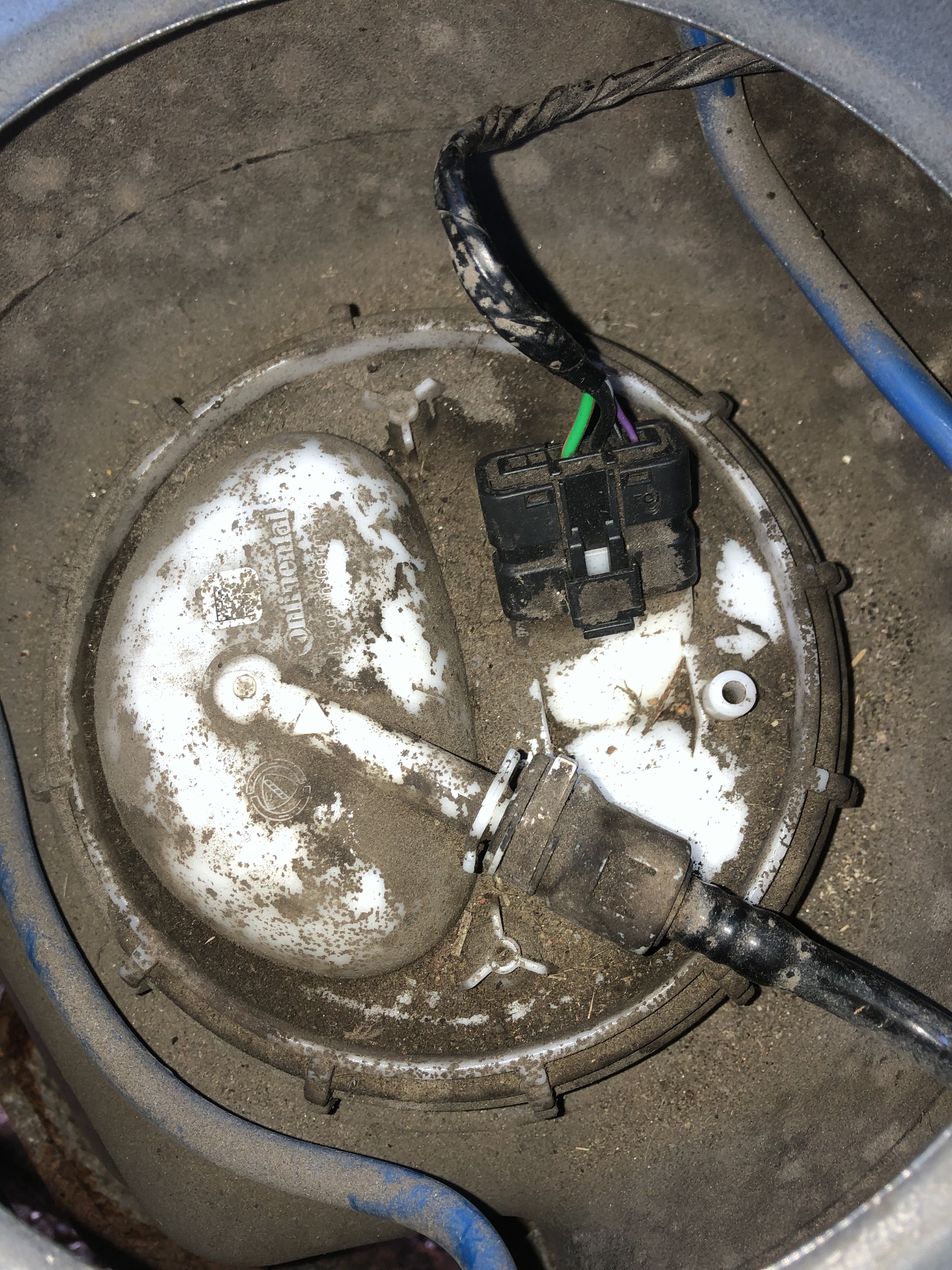

If you need to undo the fuel gauge sender/fuel pump, it is the large plastic ring in the photo you supplied, remove the wiring plug and the fuel connector then ideally you need a tool like this photo as it can be quite stiff to undo, don't loose the large O ring and don't cross thread the plastic nut, it is quite easy to do. Some people try a large flat screwdriver and a hammer to tap the ring nut around, even if you manage to undo it that way to tighten satisfactorily a proper tool is much easier. Obviously watch for sparks around petrol especially on a hot day!!!
