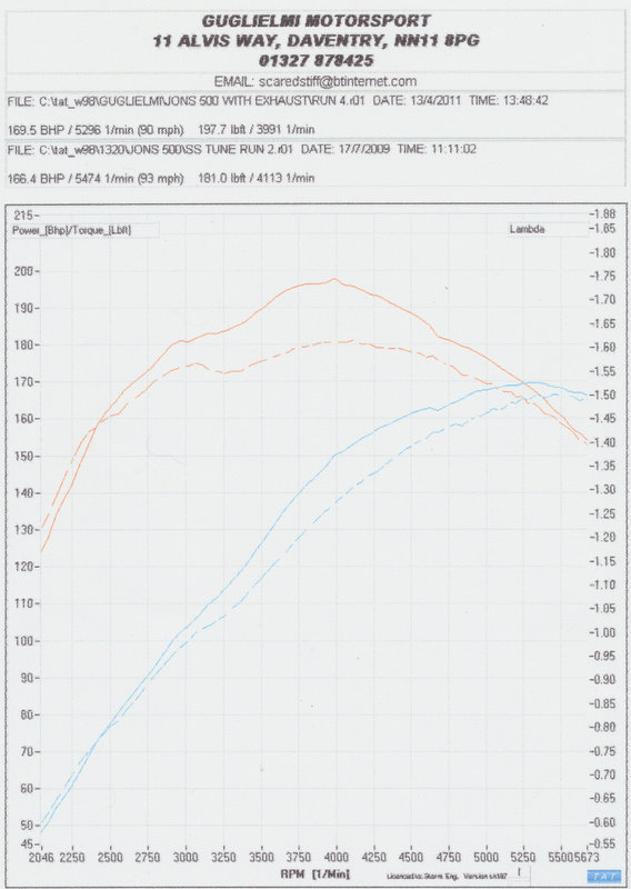

Checked out the gains mentioned by J333EVO on a RR graph. End result looks disappointing for a near £1K payout but mid-range looks healthy. Graph came from here. (A500 appears to have been TMC'd). Can't help thinking that you would be better off with the standard exhaust setup and buy a 'spare' one off ebay when the standard one starts to blow.
https://www.fiatforum.com/abarth-500/271237-standard-exhaust-good-enough-me.html

OK couple of things, the 500 in the video is my father-in-laws with the prototype BTB, & the graph is his as well. The car is not TMC'd as not a fan of add on box's that trick ECU into giving extra boost, it runs the SS map which is on the standard ECU.
And the gains are amazing for just an exhaust, over 10lbft extra is available from roughly 3000-4750rpm and roughly 10bhp more from 3750-4750rpm pretty much ideally where you want it. 18lbft more torque at peak. Yes peak bhp isn't up much but that's the limits of the standard tiny asthmatic turbo which runs out of puff at about 5200rpm.
It has been demonstrated that the turbo can make no more than 170-175ish & that's pushing it boost wise, yet the BTB extracted near maximum known power with no extra boost being used highlighting how effect it is over OEM.
The fit and finish are beautiful, something that can't be said for the OEM which nearly always sits on the ****, or the Monza where the 10 or so I've seen have the four pipes sits at all sorts of different angles to each other.
So pay £1000 for a stainless steel turbo back exhaust system with proven performance gains that will last the life of the car, or be removed and sold when moving car on and putting the OEM system back on or £700 for a mild steel back box that one have had the valve rust shut after only 6 months of use with negligible gains if at all.

I might have been a bit harsh saying that it wasn't value for money. Since you could take it off and re-use it that isn't too bad but where do you store the older exhaust ? It would be an interesting exercise to put in on a 695 and see if it gets more that the quoted 180bhp.
On that link I posted your father-in-law was asked if his car as an SS and he didn't give a straight answer so I incorrectly assumed he was running a TMC. The 'before' figure of 166bhp is the same as the TMC ones on the basis that all RRs give the same figures (which isn't of course true). Still it does look the business and is money better spend given that it should last given that it is made of stainless steel.
