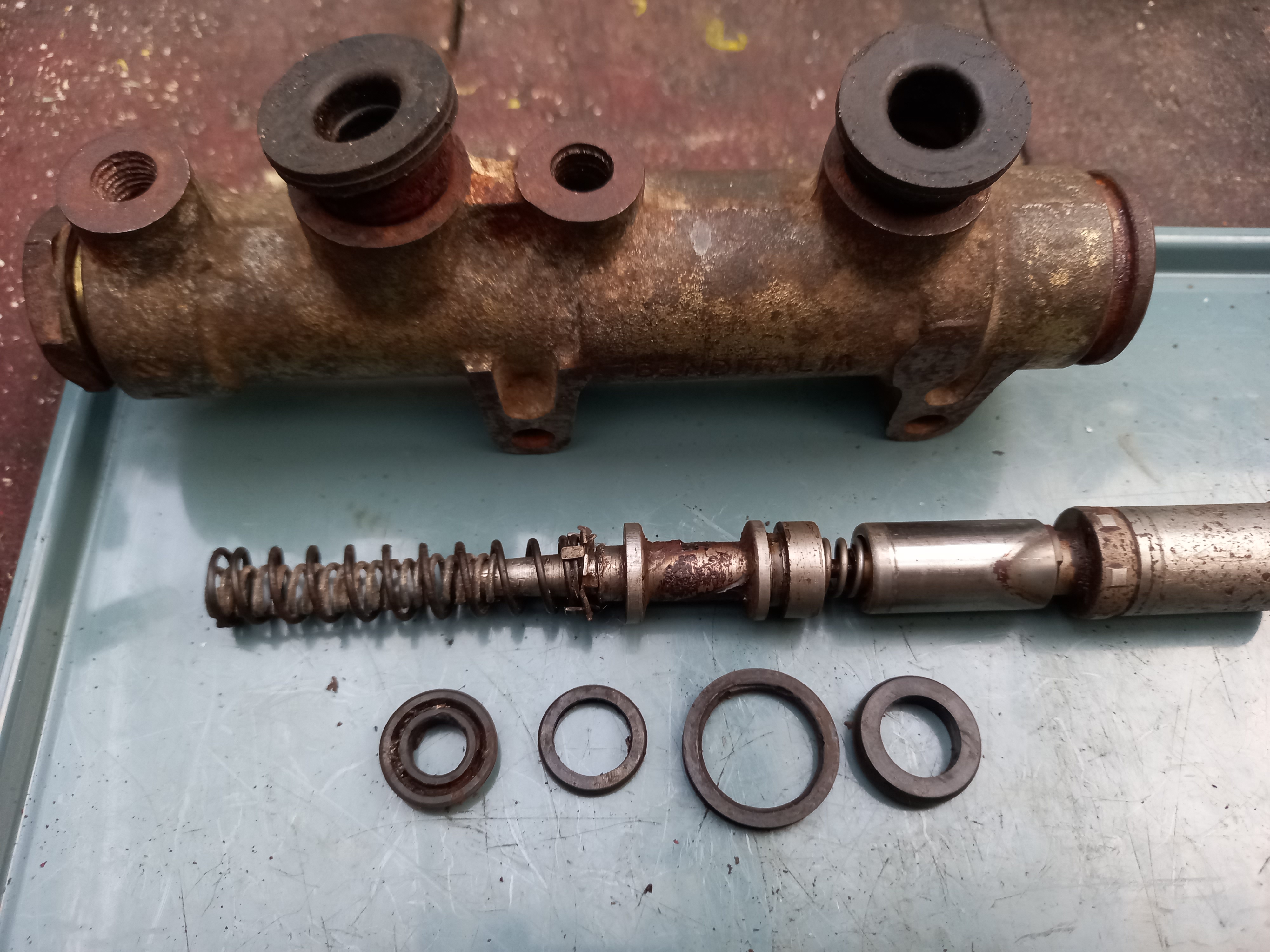

Whilst I was there I came across an old master cylinder that came with the van. It was quite a job to dismantle and needs an oddball selction of new seals if I am to make it work; I can't find a kit online at any price. As most 850/900 people know, new cylinders cost around £300, although the basic one for the non dual-circuit brakes is only £25. I'm still checking out other possibilities, including the one for the Fiat 238 van and various choices for Fiat 600's and Zastava 750's. I've read that the Fiat X19 can be made to fit. If anyone has any experience of any of this I would appreciate the feedback even if you're reading this months after I'm writing it. The easiest option I can think of just now is to fit the single-circuit version as all of the van's brake system is going to be replaced anyway. The problem with that is that I'm not sure if it would be proportionate to the front calipers as it may have been intended for drum-brakes all round.

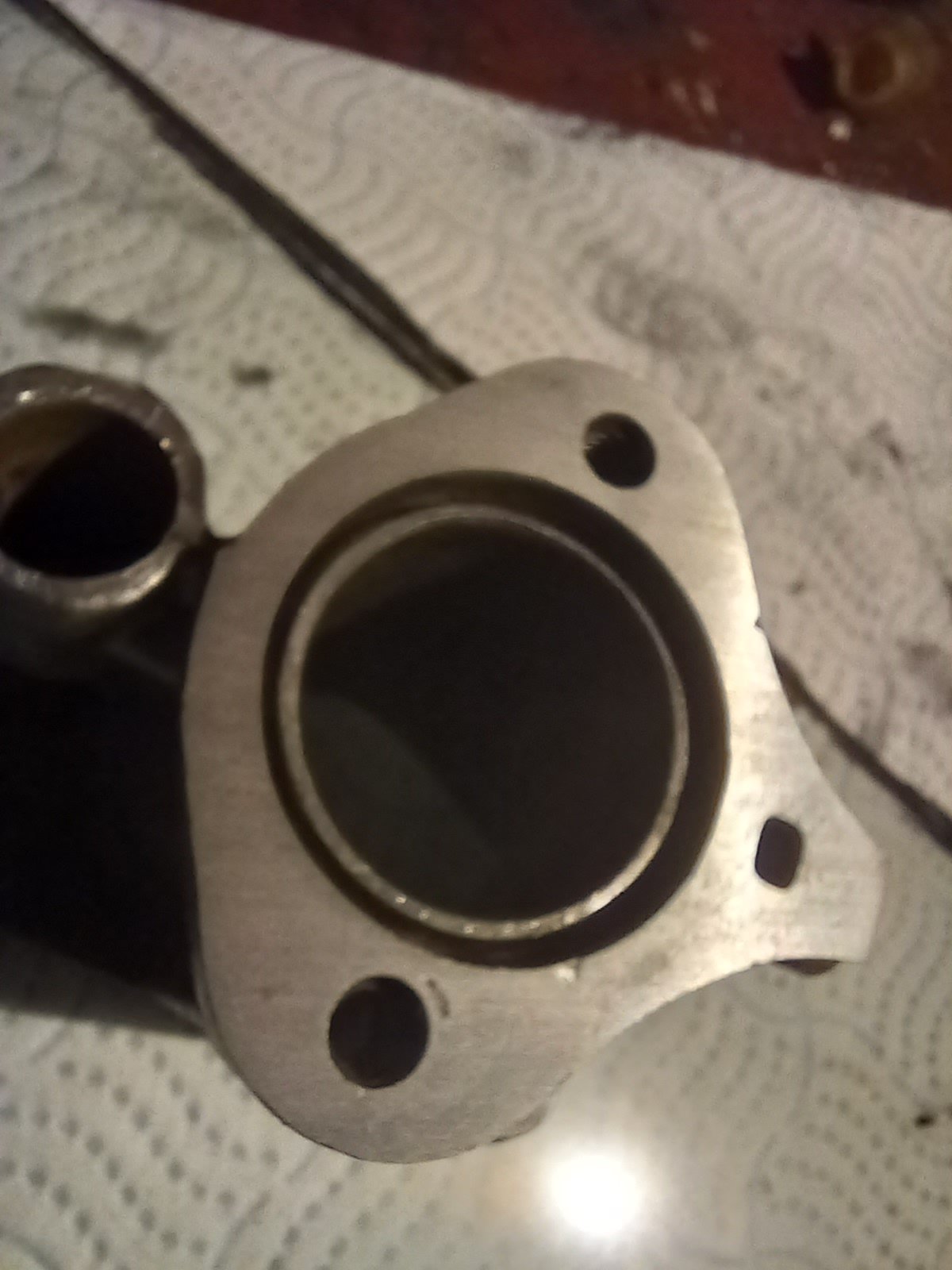

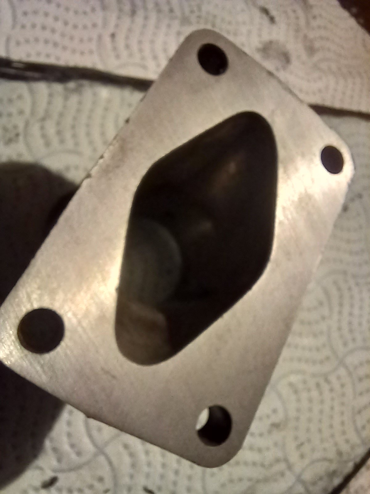

But I did look into the carburettor spacer that has puzzled me and decided that its design possibly does away with the need for the tray that goes under the carb. I'm ready to put the pieces back together and first I flattened the mating surfaces on some oiled wet or dry paper on a sheet of glass.

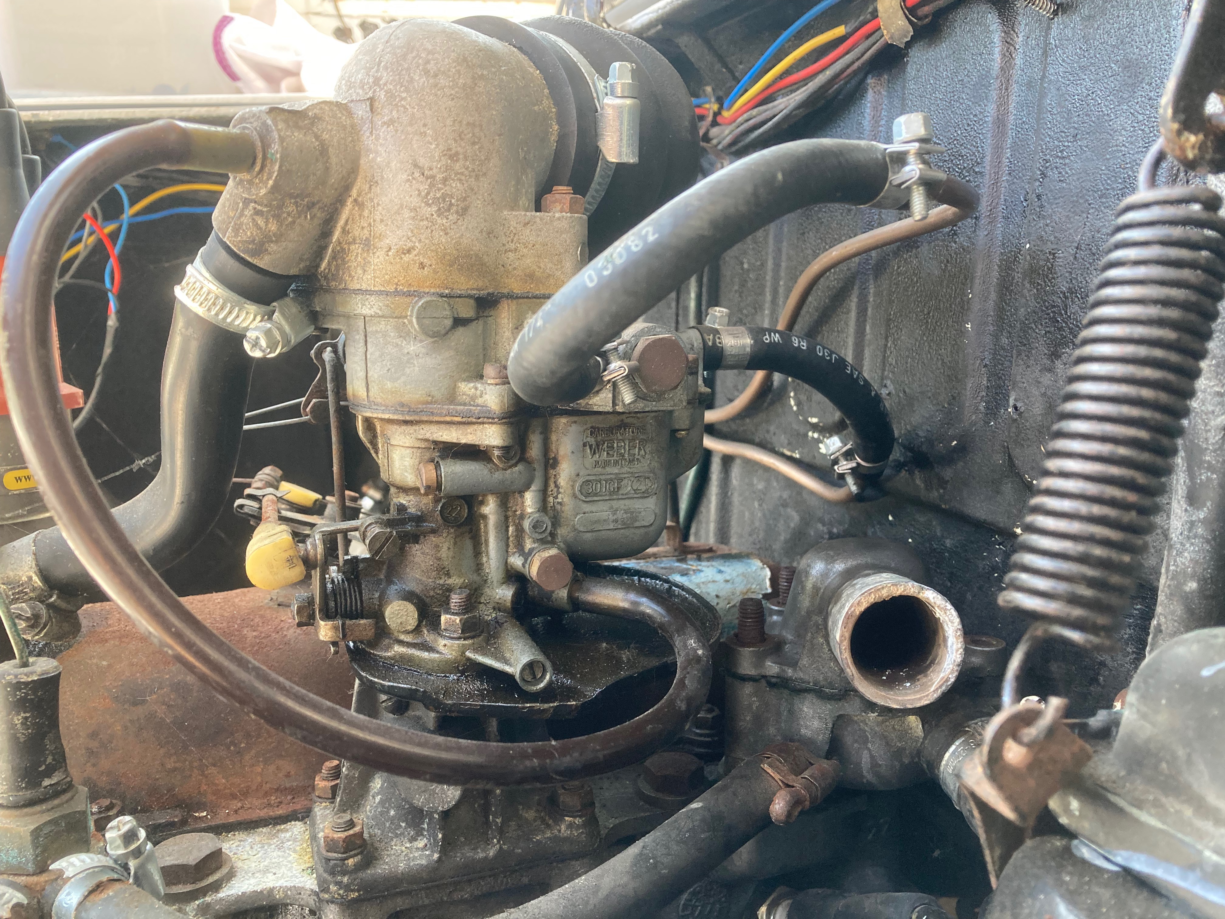

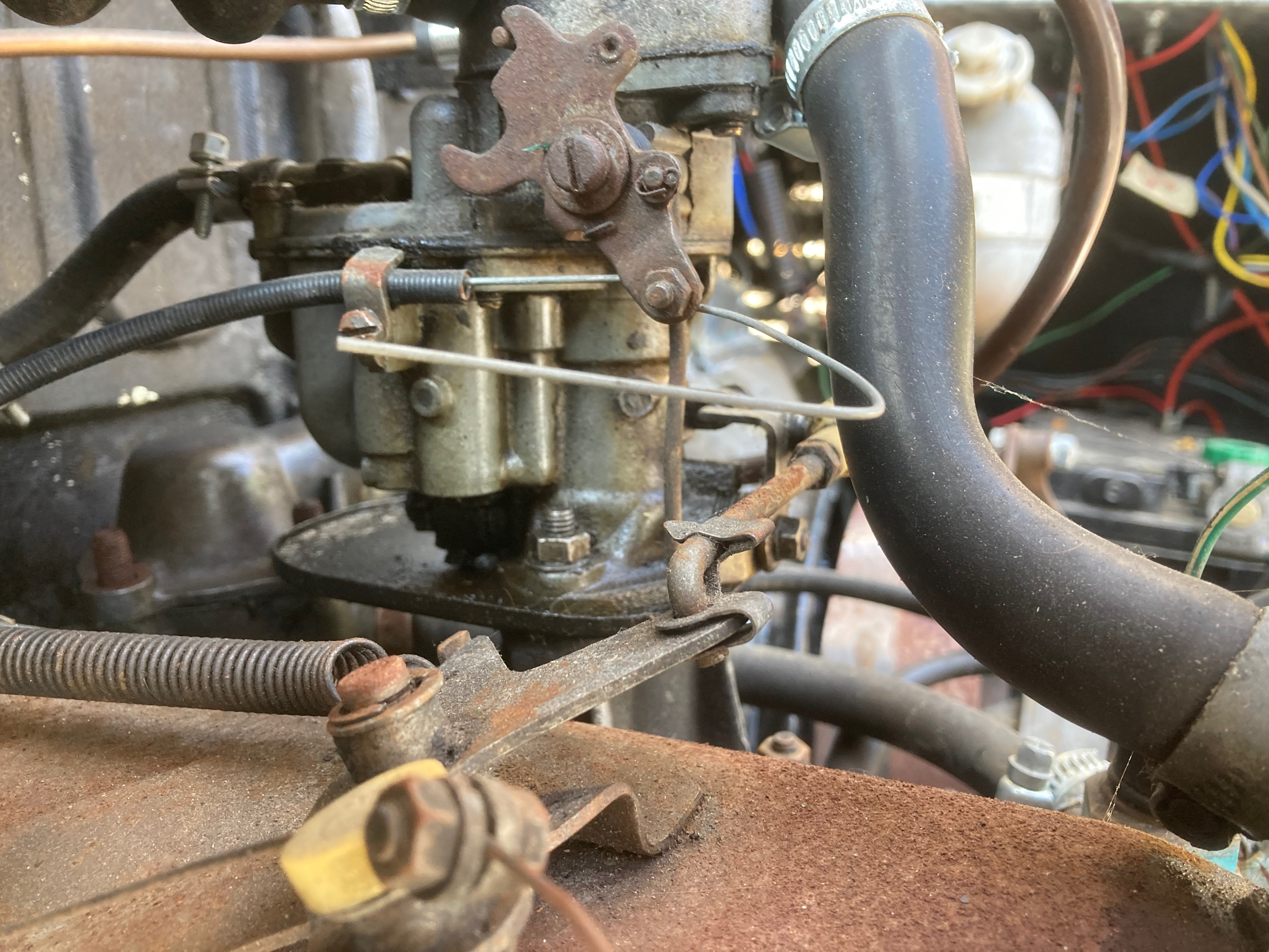

Hi Peter,
Apologies for the delay, not been able to get on to the van for a while.
Comparing your carb to the one I have fitted it looks like we have the same version... even the casting number (22) is the same.
If you compare the two, it looks like there is a brass nut/screw plug missing from yours (when viewed from the radiator side).
Hope this helps.
Cheers
Gary

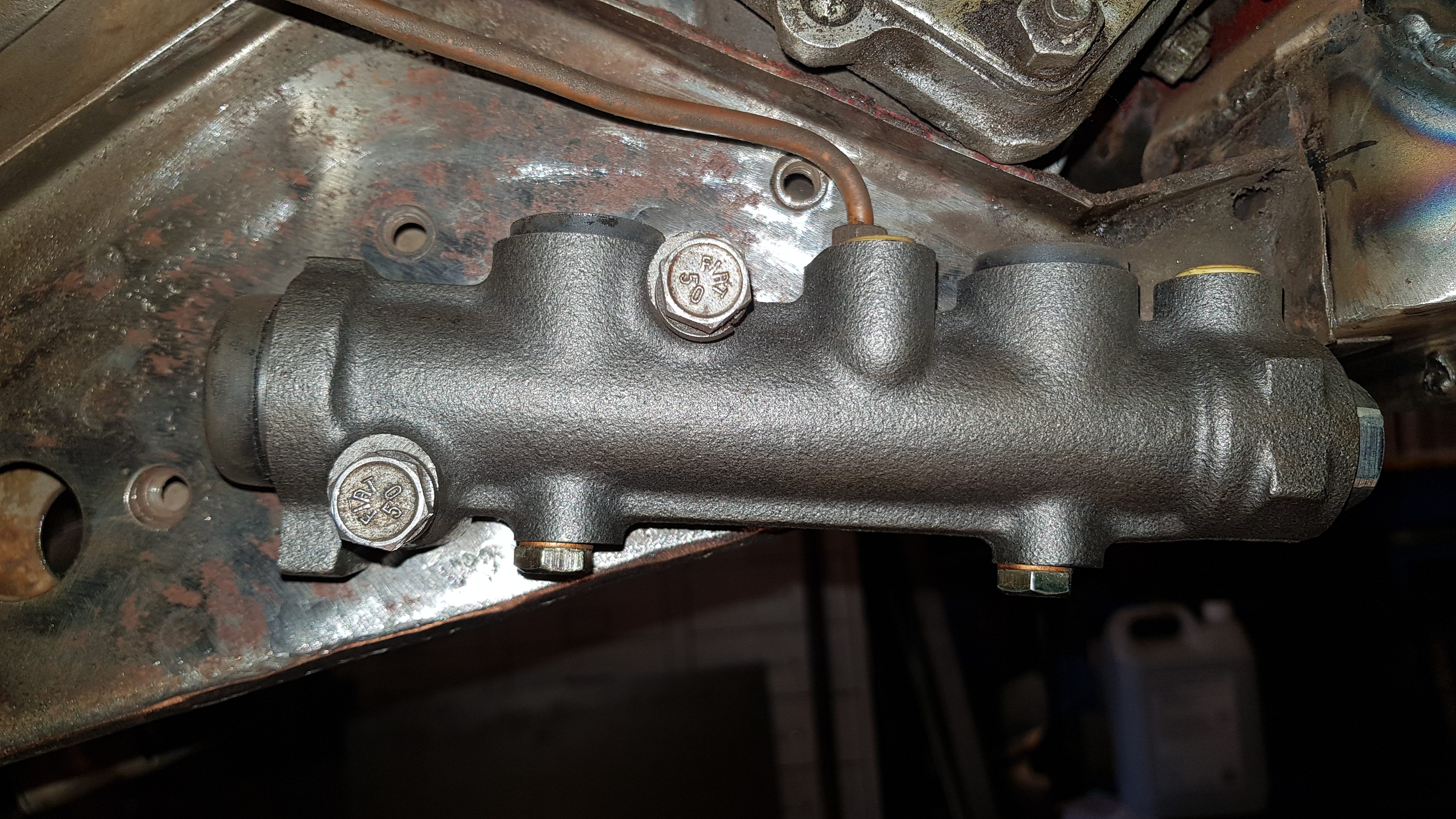

It's taken a while as I still have a substantial amount of de rusting and welding ongoing, but here is the final location mock up for the x1/9 master.
It's not as tight a fit as I'd feared and standard pipe ends will work.
I hope you're passed this part and have figured this out but if not maybe this helps

If only I had passed this part! That guidance will be really useful when I do. Thank you.
