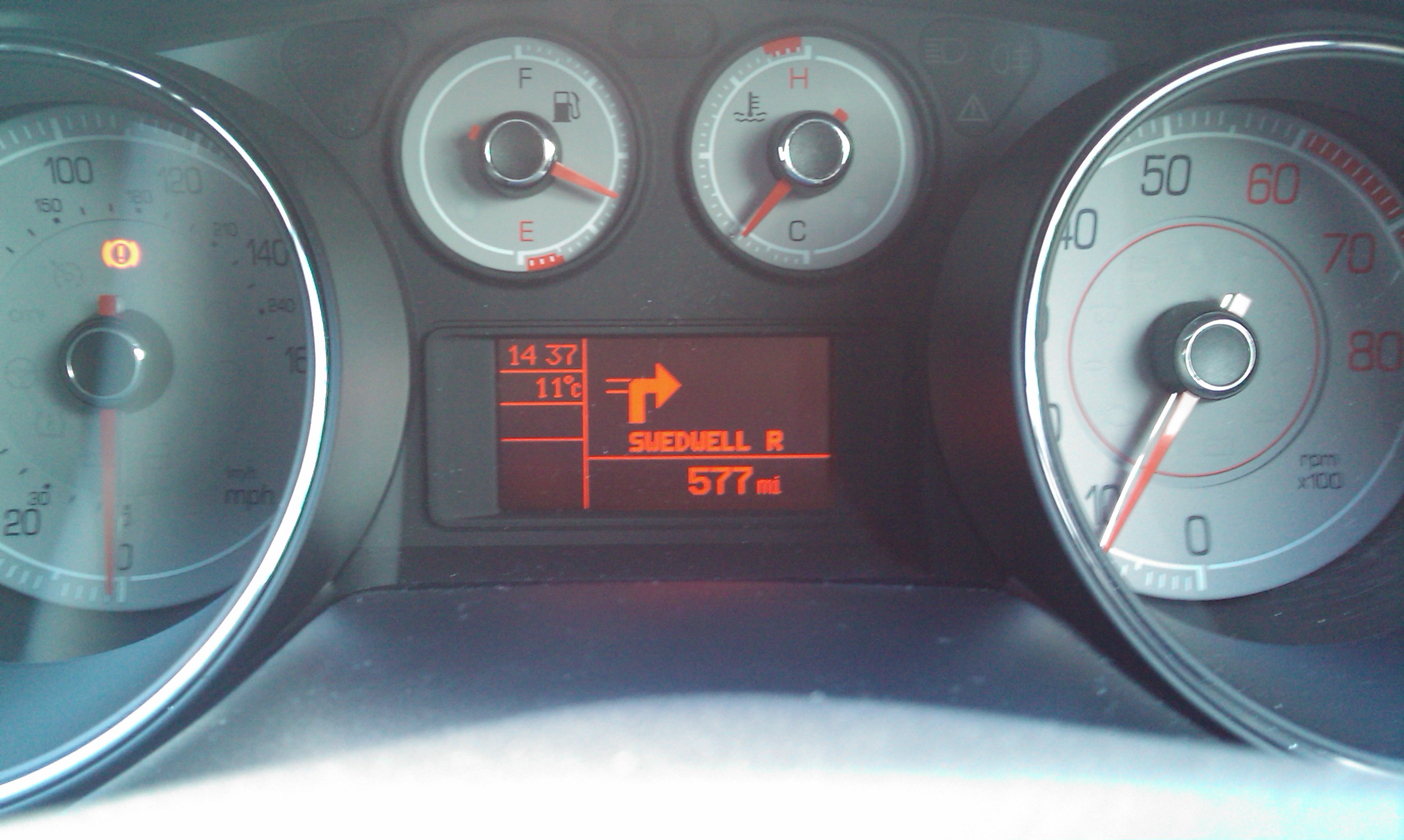

Don't think I have any actually . . . I assume you mean of the unit working? It basically gives you a directional arrow and countdown in yards, as well as a voice-over; it's actually quite a good system, I was quite surprised. Totally voice activated too.
