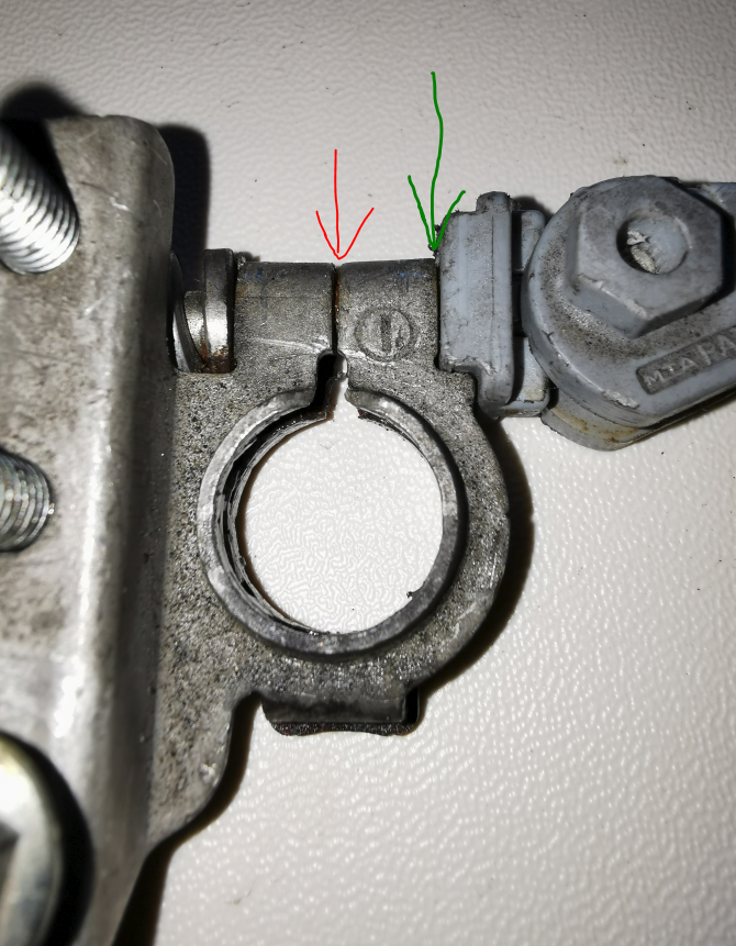

I've put a washer where the green arrow is and sanded a little bit where the red arrow is:

It took me like 10 minutes to bring the thing home, unscrew it, grind the surfaces and put a washer on the other side. It was just worn out, and the battery was replaced a few months earlier, so I knew it was not the problem of the lead battery terminal (which is definitely softer than the clamp).

Hi all great advice. Its a brand new battery. Euro parts and others sell battery shims which can slip over the terminal. I will file/grind between the clamp so it is tighter. Also as mentioned the lower the clamp goes down the tighter it gets.
Thanks all for helping me overcome the problem.
