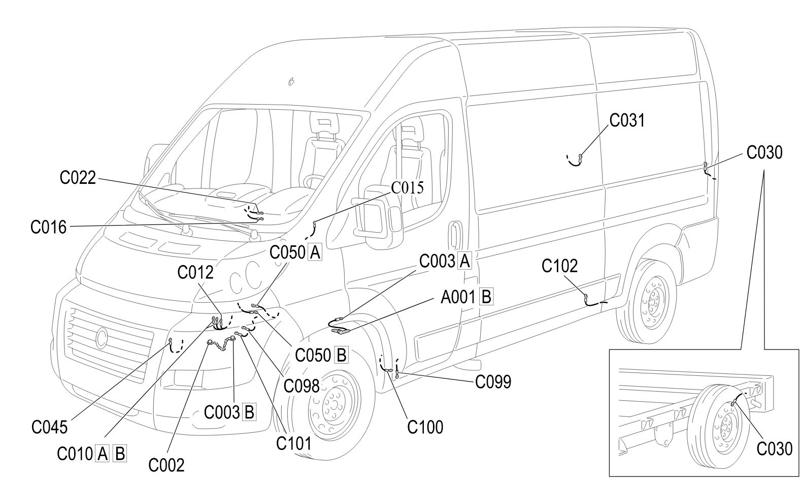

Here's the diagram of the grounding points location on the x250:
and the description:
A001: battery ground
C002: battery ground on the engine
C003: battery ground on the body
C010: front left ground
C012: ABS front ground
C015: driver's side instruments' panel ground
C016: A/C ground
C022: center instruments' panel ground
C030: rear left ground
C031: rear right ground
C045: fan ground
C050: airbag ground
C098: right doorstep ground
C099: optionnal: cab ground
C100: optionnal: cab ground
C101: cab's double ground
C102: rear axle ground
