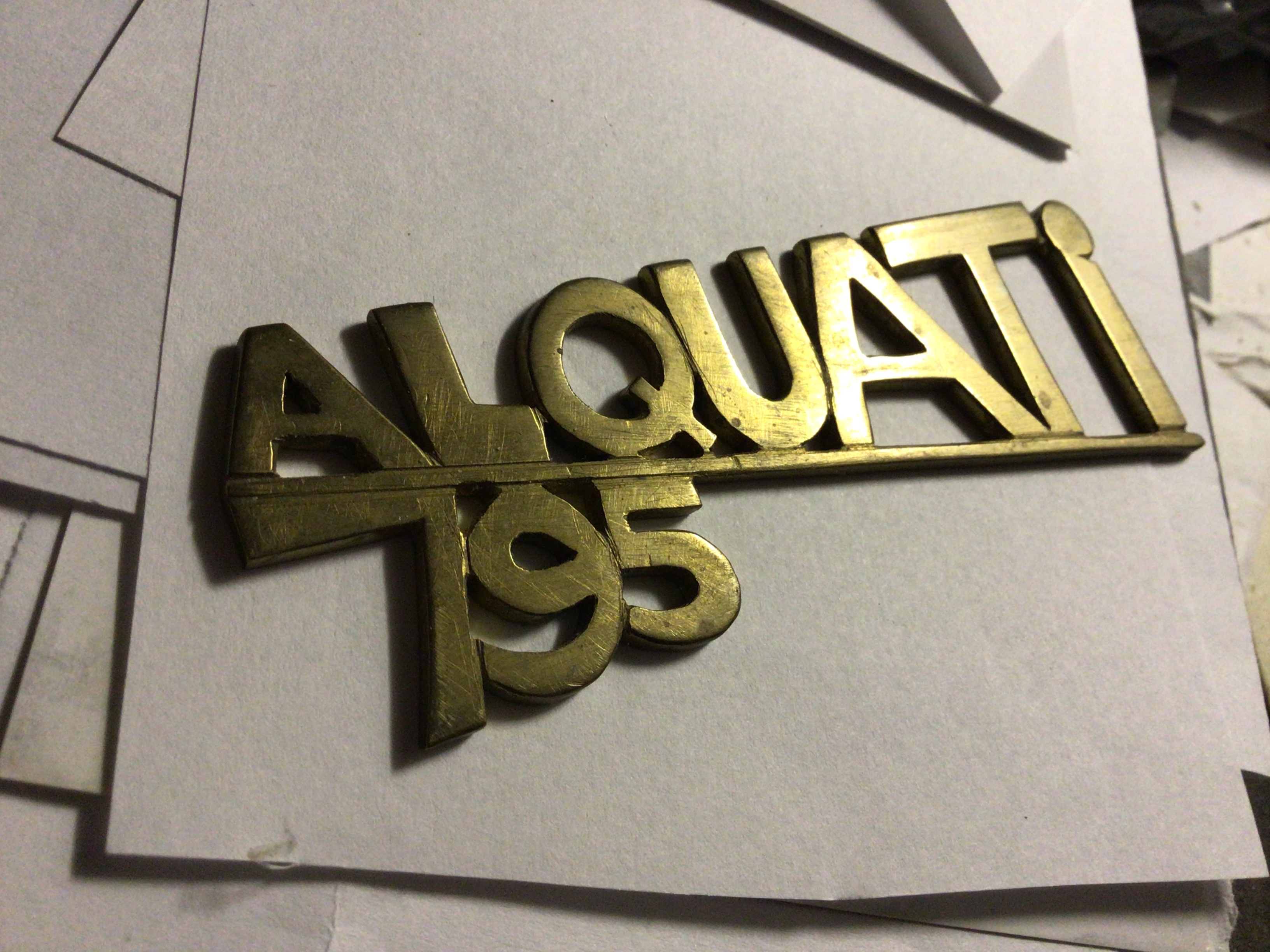

Another alternative is to make one which may sound daft but when I had a 1937 Talbot years ago the elaborate Talbot badge was missing from the back panel. The originals were stamped out of 16swg sheet brass, had small studs on the back, were polished then chrome plated. I worked alongside a silversmith at the time and she said it was quite possible to cut one out using a fine piercing saw which we did. I silver soldered M2.5 studs on the back, polished it then chrome plated to give a perfect replica. I made a dozen or so in the end and sent a couple as far as Australia and New Zealand. Cutting aluminium would be so much easier but with modern technology there will probably be much easier ways if you can get a tracing of an original. I never kept any pictures of the Talbot badge but in more recent years I did design and make an Alquati badge to go on the engine I had.

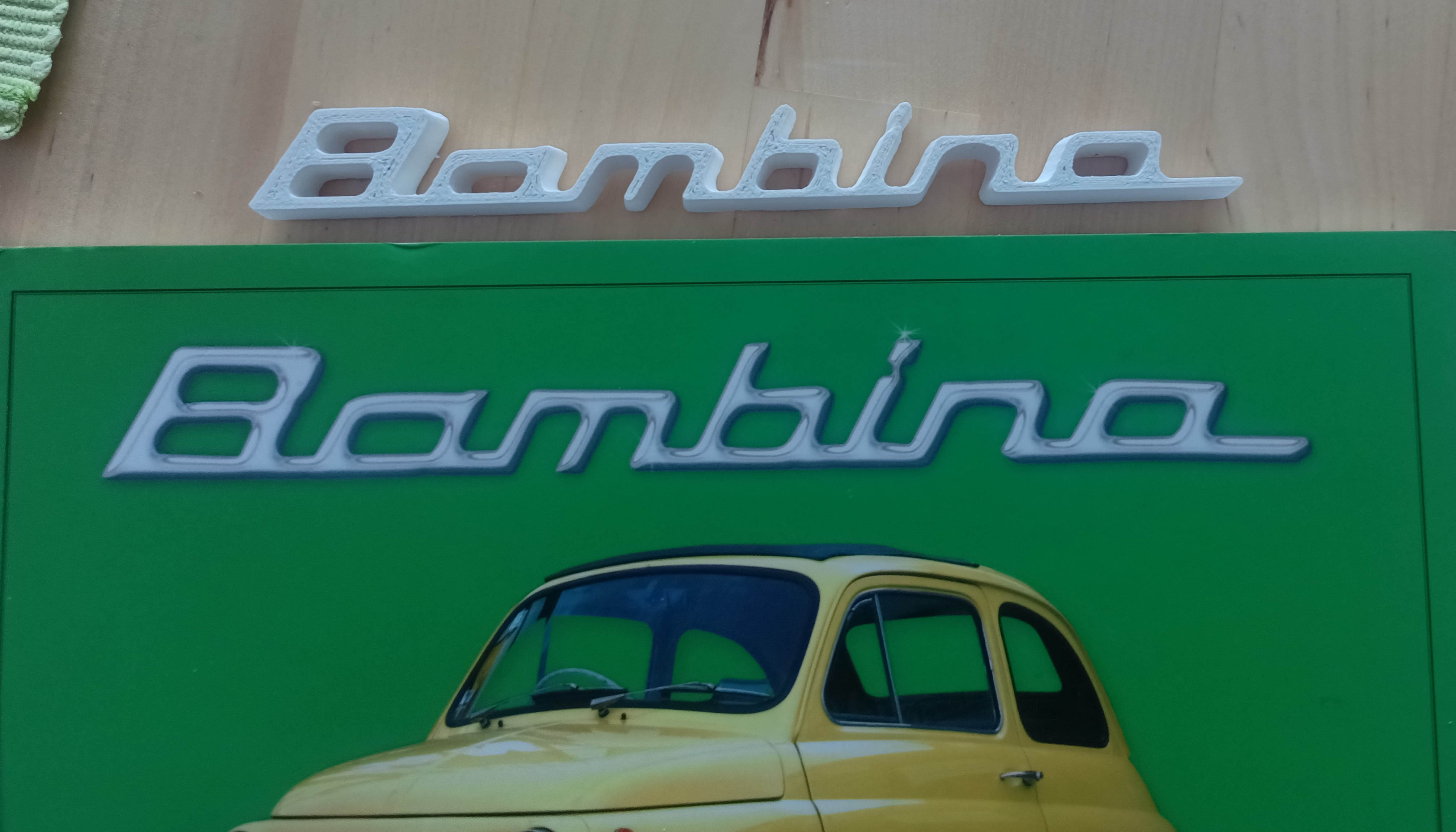

Well, ended up fiddling around with 3D tools and first test print turned out pretty sweet.
It still needs some fine tuning before I find some CNC shop to do a proper version
With the progress made with '3D'printing, Iwould have thought that it would not be too difficult to have a new badge printed in metal for you, using as you have done, the font on the front of the book (of which I also have a copy) as the "master copy"
