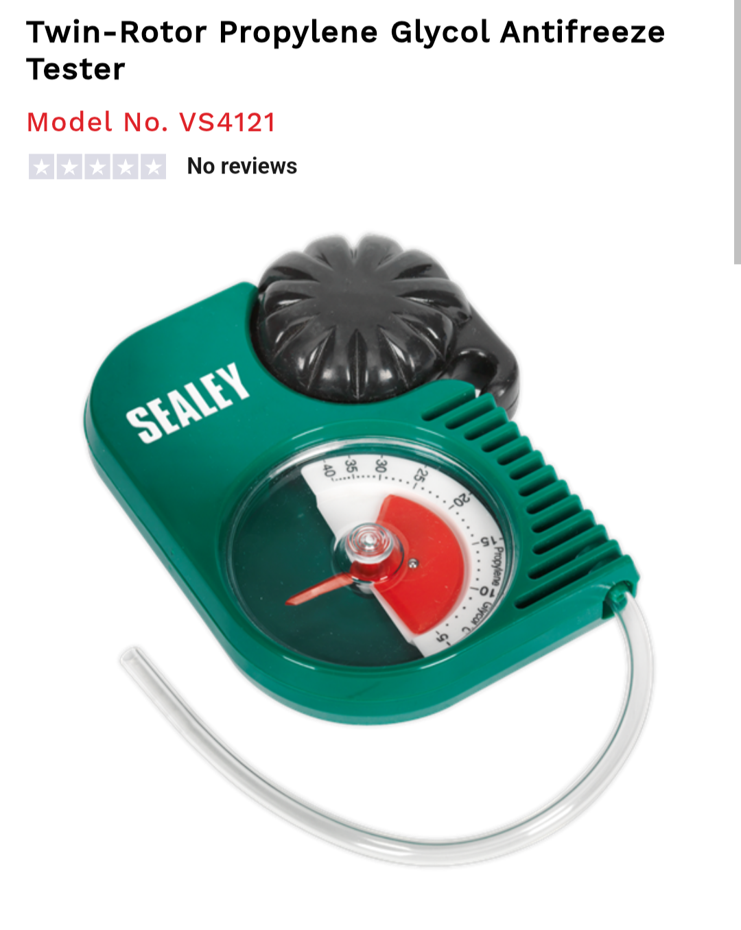

More common and Toxic Mono ethylene Glycol
Requires a different tester to
Less common and less toxic Mono propylene Glycol
Both available as red OAT antifreeze
