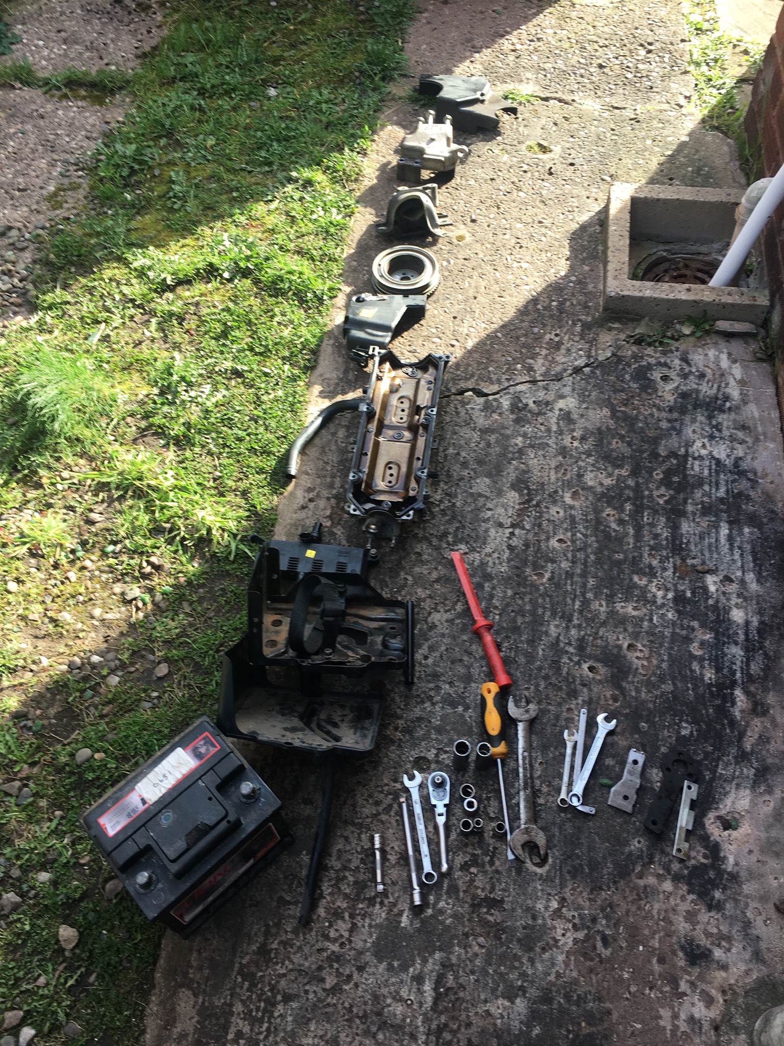

These are the bits required to be removed to replace the belt.
