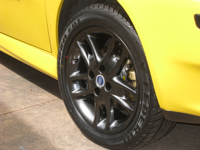

Just in case I can inspire anyone reading this thread and wondering "can I do that?", I painted my Punto wheels myself last month. Spent days on the preparation (repairing all kerbing damage and sanding back to the factory powder-coat), then shelled out for the proper paint system (PPG Shadow Chrome). I have a nice gravity spraygun & big compressor, but you wouldn't really need anything more than a small compressor and spraygun of any type.
Black basecoat goes on first, then light coat of translucent chrome silver (too much and I found it just went matt silver - I practised on the insides of the wheels), and finally several coats of PPG clearcoat. I think all up the cost was $350 (about 140 pounds) plus about four days of labour, so not a cheap project :)
Well worth it though as the colour hides the brake dust so much better than silver (y)
-Alex
alexGS - Them alloys in that attached thumbnail are amazing, how much were they to be done? and what type of paint has been used? was thinking about doing this to my Yellow Fiat Punto 1.2 16v, cheers:)
