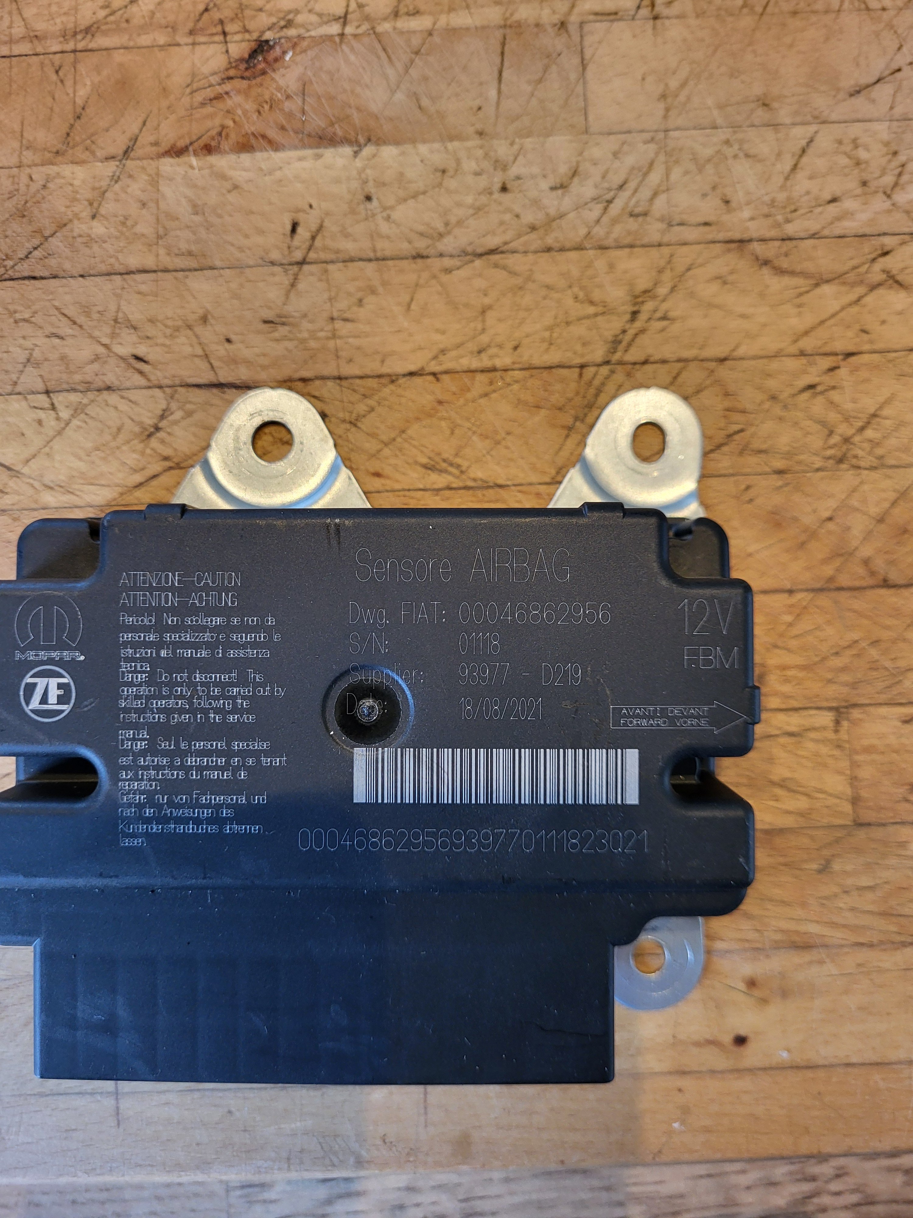

I attached a photo of my ECU showing s/n dates etc. I've got a 2022 fiat Ducato based motorhome. In true form the 2year warranty has come to an end & the dreaded warning light is showing in amber on the dash.

I would ask Fiat, they may well do a "good will" replacement.
If it's any consolation, I've just replaced one for a friend (2017 van), the local dealer has sold 52 airbag modules so far this year!
