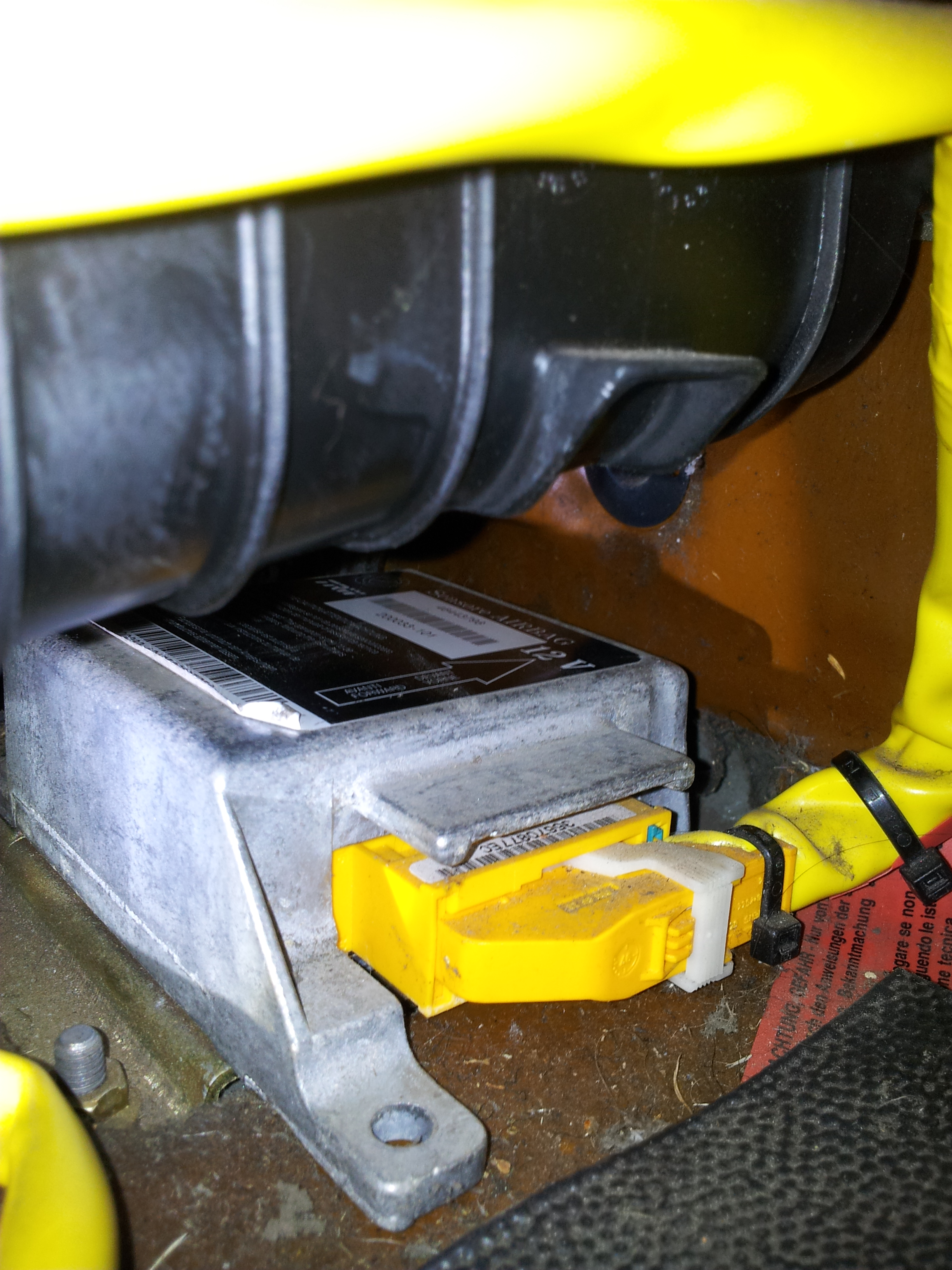

Hi
I managed to use a torch and my phone to take a picture of the unit from the passenger foot well without removing it. Zooming in on the label clearly showed the model number etc.
Hope this helps
Bryan

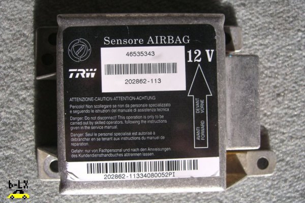

i have been watching this thread and i have a question : my car as a TRW airbag module number 46535343 my car as the 3 pin plug and i have sucessfuly conected the blue vagcom with the 3 pin cable and multiecuscan (free version) to the engine ecu . pluging the cable under the gloove compartement plug is it possible reset the airbag ligth with multiecuscan off this specific airbag module ??
