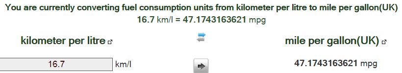

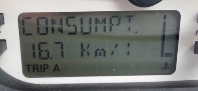

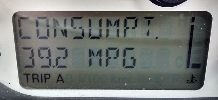

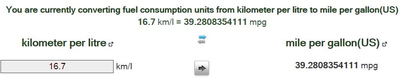

On this subject, I've done a little bit of a test with a full tank. In the images the readout says 16.7 km/l and when converted to miles, 39.2 MPG.
I used an online converter (below) and converted 16.7 km/l to MPG-US and MPG-UK. It truly is the US Gallon!
The car actually did 940km for 60l, which is 15.7 k/l or 44.3MPG-UK which isn't as good as the km readout says.(n)
https://www.unitjuggler.com/convert-fuelconsumption-from-kmperl-to-mpgimperial.html?val=16.7

I expect the programmer just googled litres to gallons and had no idea there were different sized gallons!
