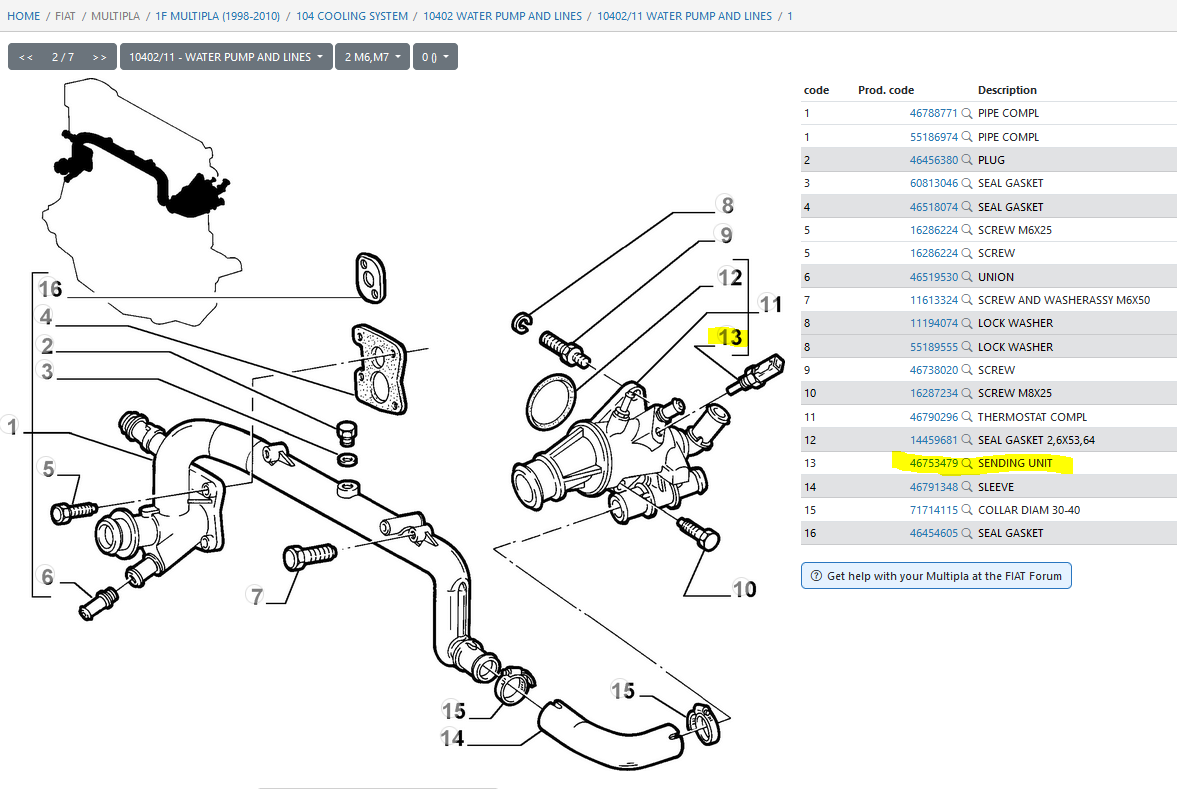

We came 4m out our drive, the alarm came on, said" cool high temp" " turn engine off" so immediately checked water / leaks ,nothing. So we carried on checked again after 10 Kms, engine hardly warm.
We went everywhere no probs.
There is a red light and the guage is on max.
So please, where is the sensor and is it easy/ cheap to change?

And that's the ePER diagram with the part number 46753479:
There's another 115 HP diesel marked as 'Depot Belgium' with the engine coded as M87, but the temperature sensor is the same. As think the CF3 / CF4 correspond to the emissions EUR norm.
