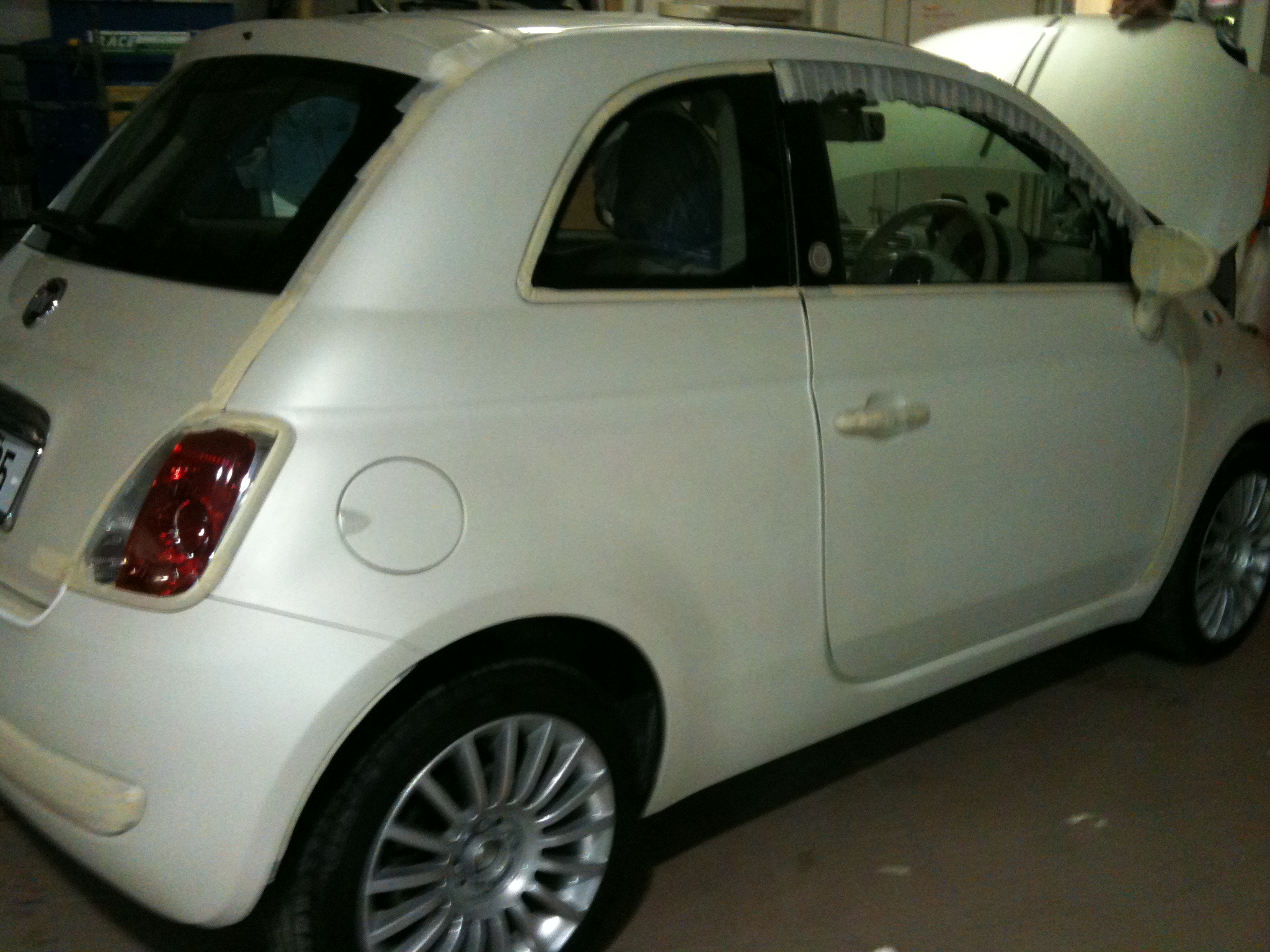

Paid a little visit to the repair shop today. It's been 3 days now. Pictures below were were taken late in the day before going into the spray booth. They spoke about 'baking' it afterwards. Hopefully all the prep and leg work will produce a good finish. To think that a little bump has involved so much work.
[insert your favourite expletive] what a lot of masking off :eek:. Just how much of the car have they resprayed?
Shows how much work is needed to rectify even minor dings when you're working with fancy paint.
He mentioned that he would have to 'blow' the side of the car (he's not doing the front wing) in to get a match on the paint. The back bumper has a scratch and 'good and all that he is' he thought it would be quicker to blow that in as well.
As you've rightly pointed out it is not possible to 'touch up' pearlescent paint. This is not a paint finish for Learners.

because the final paint & lacquer layers were semitransparent & if these weren't exactly the right thickness the repair stood out like a sore thumb...
Got the car back at midday today. Bodshop repair guy said that it spent quite a lot of time getting the paint on the car with all the various coats. First being the base coat of which he said was the most important bit since this is what gives it its colour. 2nd stage with some pearlescent mixed in with lacquer and then a clear lacquer coat.
Comparing this with what I got of the web somewhere...
Funk white is a three layer pearlescent which means a large area of the car will have to be resprayed even if the initial damage appears minor to allow the colour to be blended in seemlessly on other panels.
The three layer process is very labour intensive so repairs will be costly as there is a base coat application which is then flatted and a second coat of colour is applied. The laquer is then flatted and a second coat of colour applied in a different direction, flatted then a second coat of lacquer is applied and flatted.
A final top coat is then applied in a third direction, flatted and a final top coat of laquer applied. This process gives the paint it's depth and pearlescent effect.
