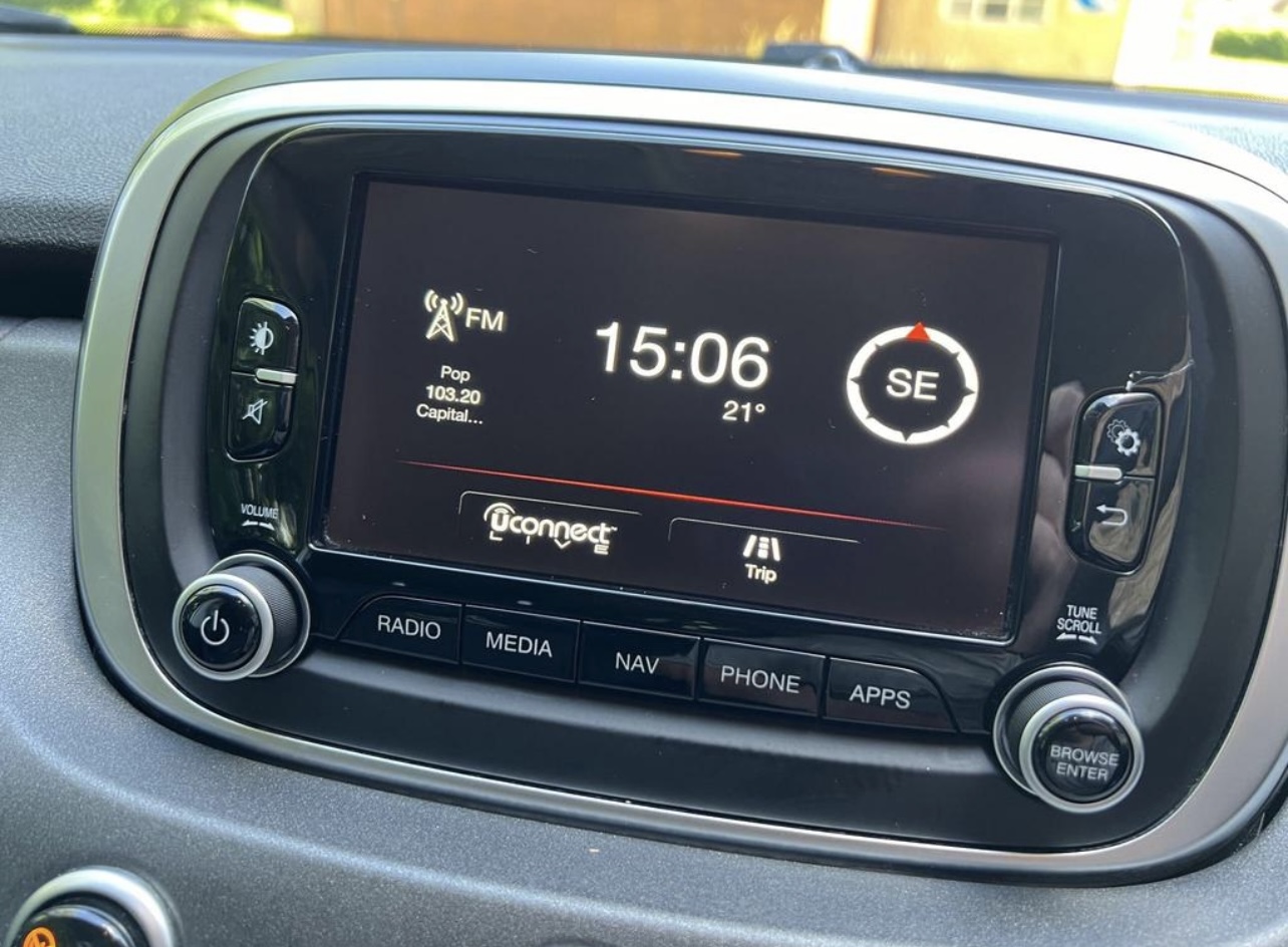

Hi,
I am currently looking at buying a Fiat 500x 2015-2017 diesel for me and my wife to share (looking at this as it sits within the cheaper road tax band in the UK).
The radio system on the 2 cars we are looking at do not have CarPlay on them (as far as I know), I’ve attached pictures of the units from both cars. Can I buy a newer circa 2019 500x radio unit which has CarPlay and replace plug and play? Or are there retrofit alternatives which anyone can recommend? Or do any of the radios I attached have CarPlay on them already?
Thanks in advance.

Hi.
So I checked the connections behind the units and they are the same, so it should work the same.
What I would recommend is to buy the new unit on Ebay with return waranty, so if it doesn't work, you can just return it.
Keep us posted if you managed.

I've spent so much time researching this prior to my recent purchase of a 500x 2017 diesel.
I bought mine with the 6.5 inch display, not the 5 - this is important because it gives you the option to install a CarPlay hardware add-on while using your original screen. I just purchased one through the website https://eng-custom.com/
I am yet to receive it in the next days, but this seller seems the most reliable + well priced.
I lost a month and a half trying a cheaper solution - a whole multimedia replacement I bought on AliExpress - that turned out a total disaster and I returned it (still waiting for refund). Although there are many sellers of similar devices, none of them seem very reliable.
