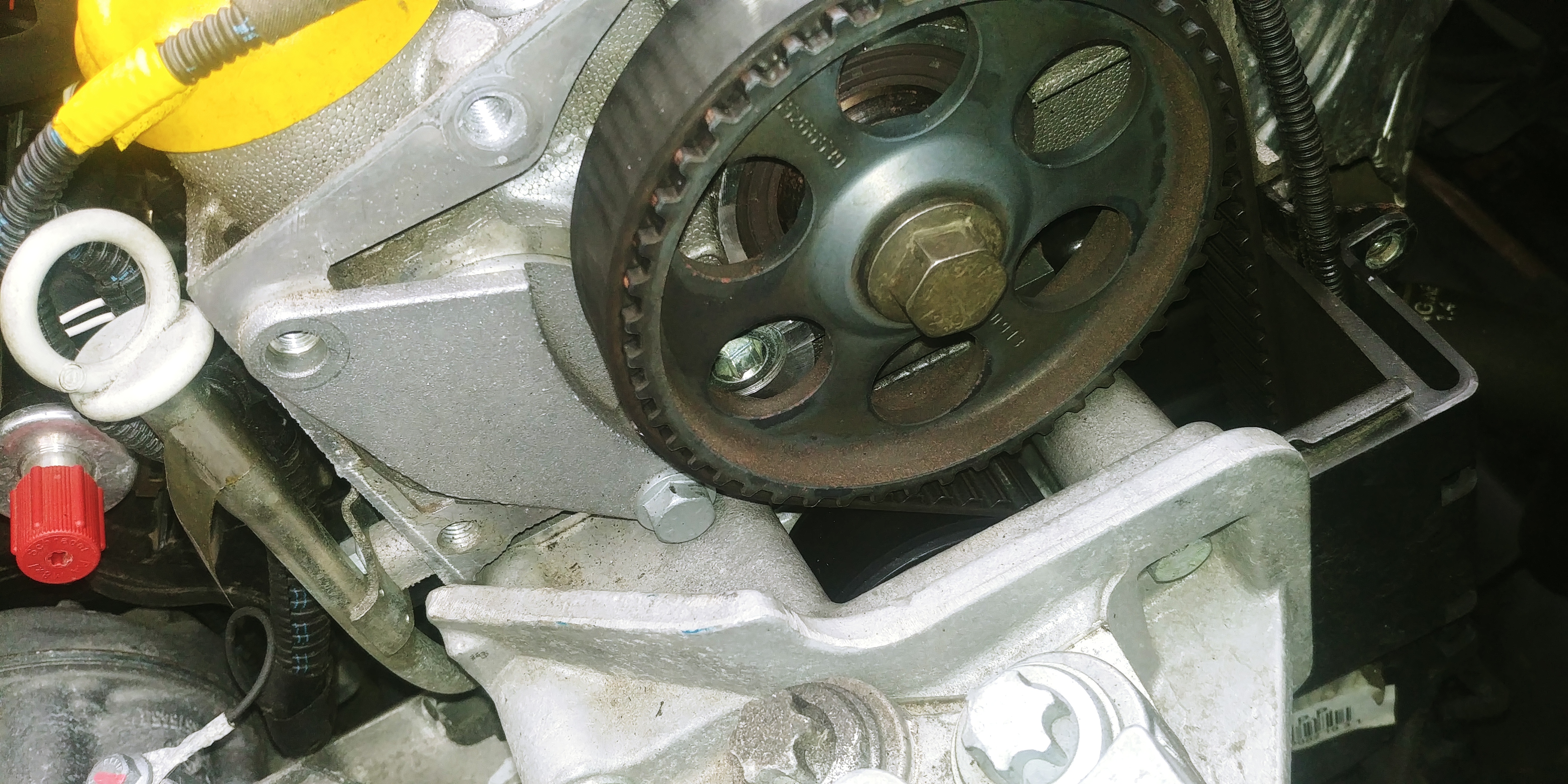

Yes, the pictures of a new one on this thread give an indication of the amount to use and where to put it. I'll probably give it a go, but not for another year!
It appears they have changed the design of area on later engines that makes accessing the filter very hard seems to be some sort of additional plate covering the area that you can't remove the bottom bolt from without removing the engine mount
