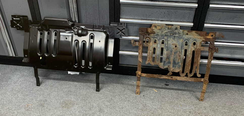

Tonight's entertainment! Getting the old one off. Gold star to anyone who can tell which is the old one and which is the new one! 🤔
As for the bolts about half came out after a soak in plusgas for a while. The other half sheared or were already sheared and the thing held on by zip ties 🤬
Apart from one of the ones in the locating brackets at the front the ones that sheared are the four towards the rear end. The two on the sides were amusing as they came out nicely but they weren't actually holding anything on as you can see from my picture!
The one that is on the front brackiet I think I may have a go at myself as I should be able to get the bracket off. I can then do it on the bench and also give the bracket a clean up and paint.
The rear 4 that are into the subframe I think I'll ask the local village garage to drill out and retap or put a helicoil in as I don't think I can get decently underneath and use a drill properly with it just lifted on my drive (I'd jacked it and put the front wheels on kitchen worksurface cut offs then chocked the rear wheels).
So, in conclusion, some annoyance but it could have been (a lot) worse.

Well, to draw this one to a close. Sorted.
Got the front mounting brackets off easily and drilled out the stuck bolt in one of them. Derusted them and gave them some paint (found some black POR15 I forgot I had).
With the sheared bolts I ended up grinding the flange of the rivnuts into the chassis off and punching the remaining bits through, even managed to get them all out so no rattles. Popped new rivnuts in and gave the area a bit of paint. Covered the new sumpguard in stonechip paint then bolted it up with new stainless fixings and lashings of anti seize.
