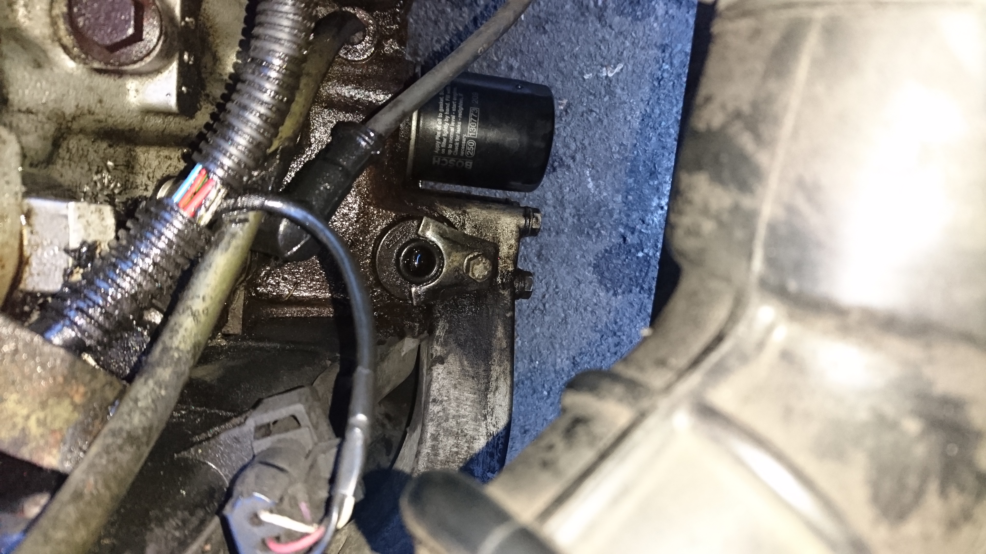

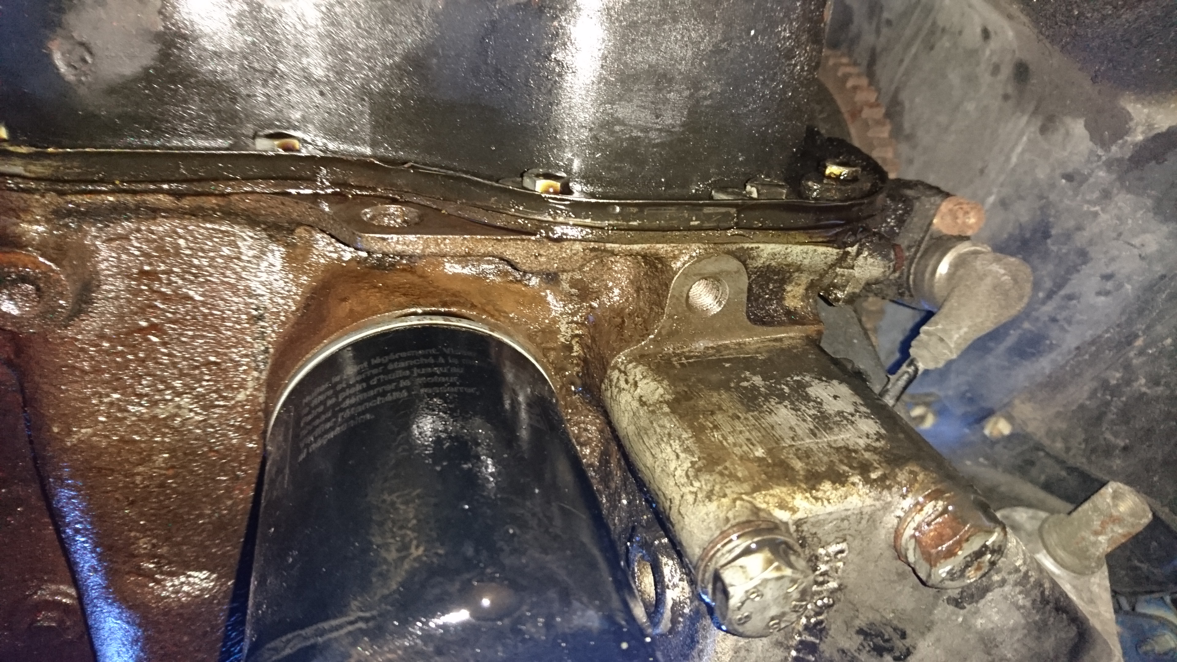

I got around to cleaning down the engine last week, as you can see it is pretty... uhm... oily.
The leak is bad enough that even after being sat outside in the same place for about 8 hours it had a damp oil patch under it
Just beneath the cam cover gasket it is oil free and completely dry, it starts somewhere beneath that, the entire front of the block is fairly evenly covered in oil though, it then ends up clinging to the sump where it eventually drips off. Since these photos I've cleaned it up with countless cans of brake cleaner (my favourite thing ever) so I'll see what gets dirty first.
I'm wondering if it could be a blocked breather, it goes from the bottom of the block out into a Y piece one of which goes into the intake hose and the second goes into the intake plenum?
See here, the blue goes to intake hose and red skinny one ends up at intake plenum, any idea why it has both since they end up in the same place eventually?
Well obviously I'm a bit crazy because I spent Christmas Eve morning out working on the Punto, new spark plugs and leads fitted as its Christmas present :)
I took the complete airbox out, the coil pack and the battery out to get as much room around the engine for some cleaning, I think I may know the culprit of my oil leak at last! It looks to be the oil filter seal :mad: Something extremely simple but I imagine explains why its getting flung around the front of the block but not really anywhere else, I guess I'll get another oil filter, clean up the sealing area when I remove the current one and see what happens :eek:
