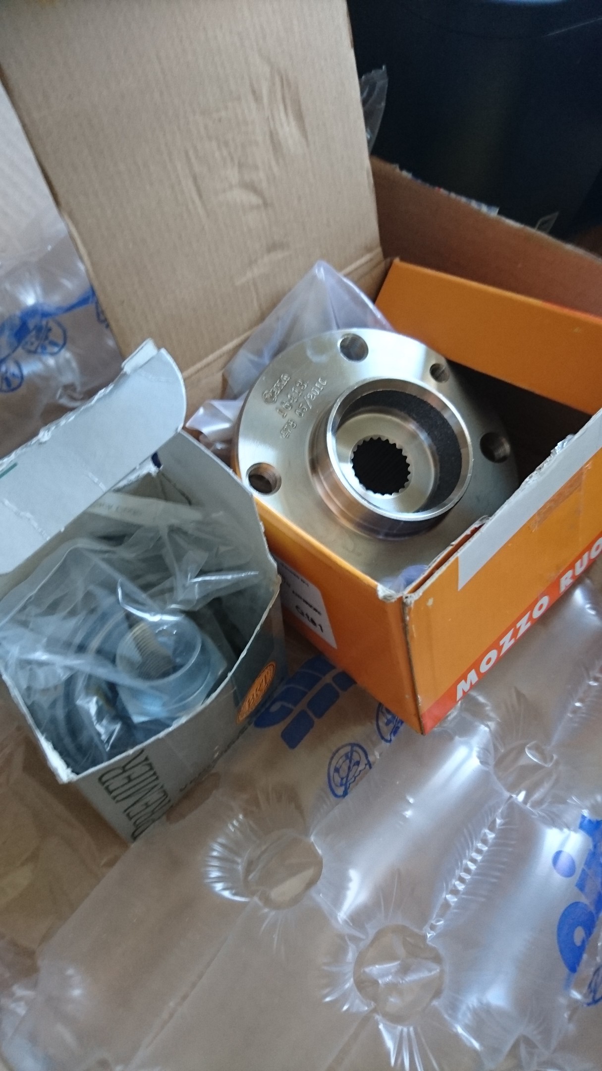

Done about 800 miles now, first thing to report, new parts! Yay :woot:
Wheel bearing kit and brand new hub to be fitted next week (y)

In good news, I have a new MOT woo! And no advisories (thats a first for me), new hub and wheel bearing fitted, rear brakes needed to be balanced but everything else is 100%
