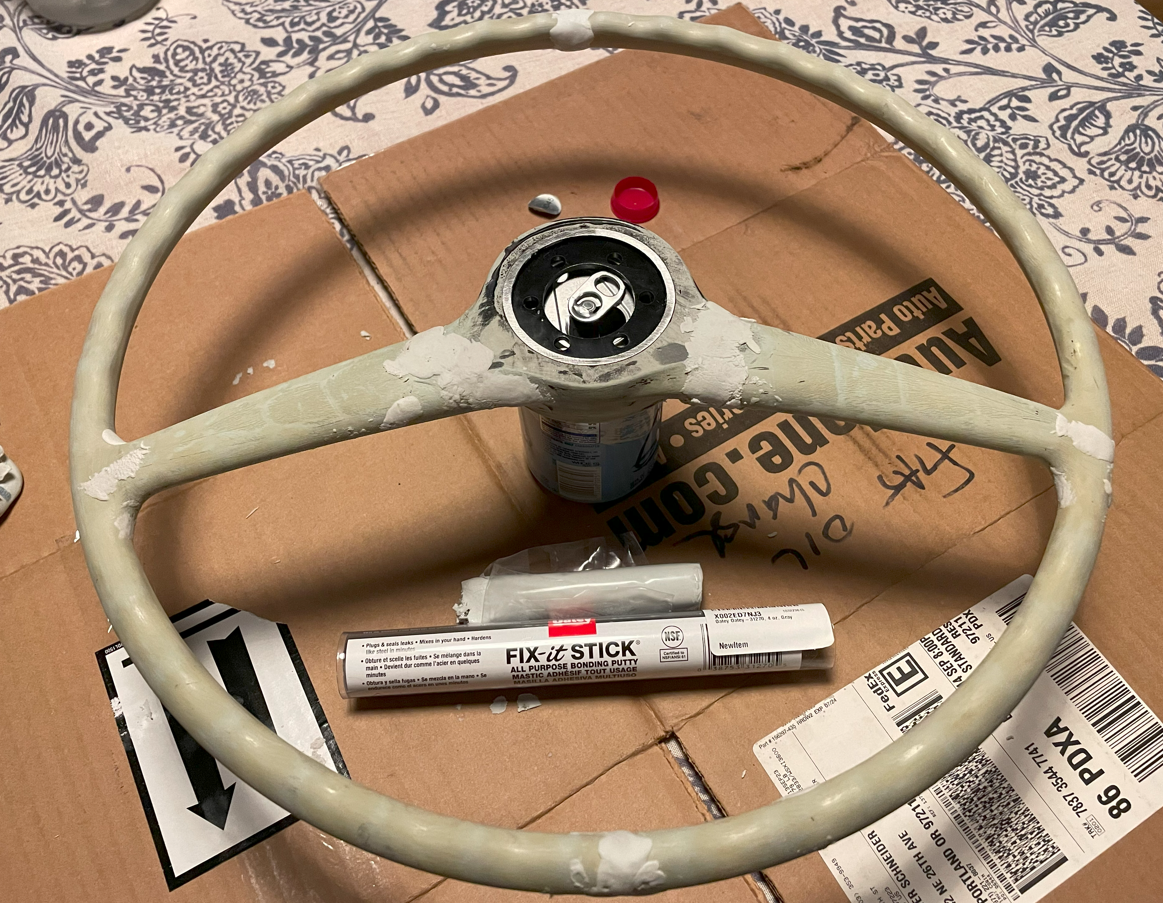

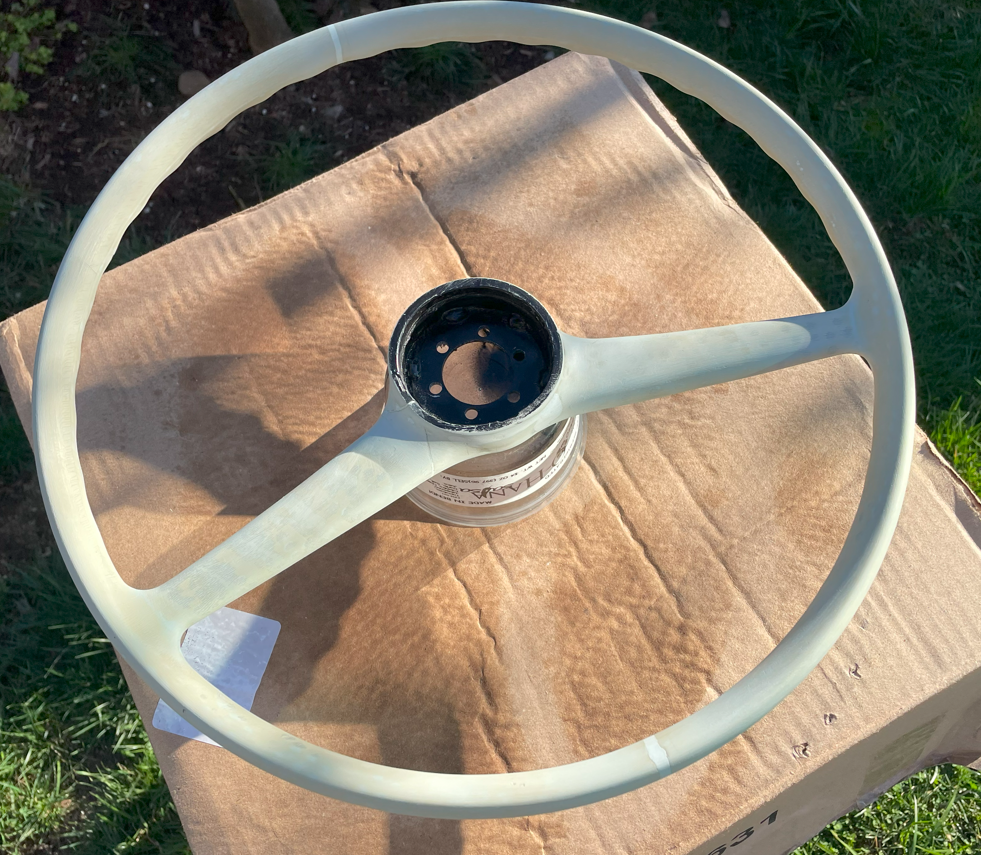

While I wait for the spring spacers, I am getting after some details like the steering wheel and trim bits. I watched a great video on how to refinish a steering wheel and basically followed that process. First, clean it up and scrap out any loose junk in the broken plastic. Second, fill the gaps with a 2-part epoxy filler. Third, sand. Lastly, paint. Simple, right? Well... here are my progress pics.
After filling with the Oatey Fix-it-stick:
Sanded and ready for paint:
And after priming and painting:

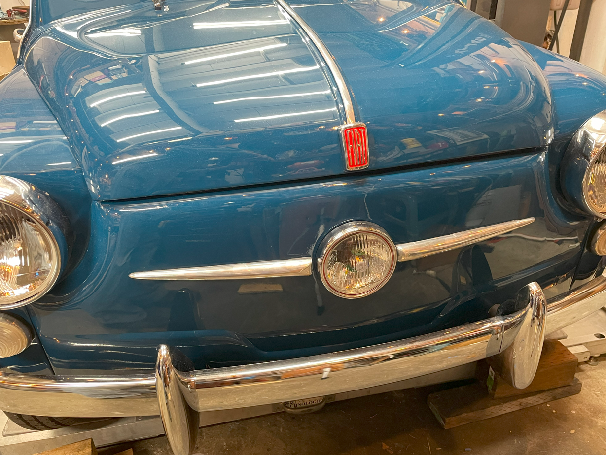

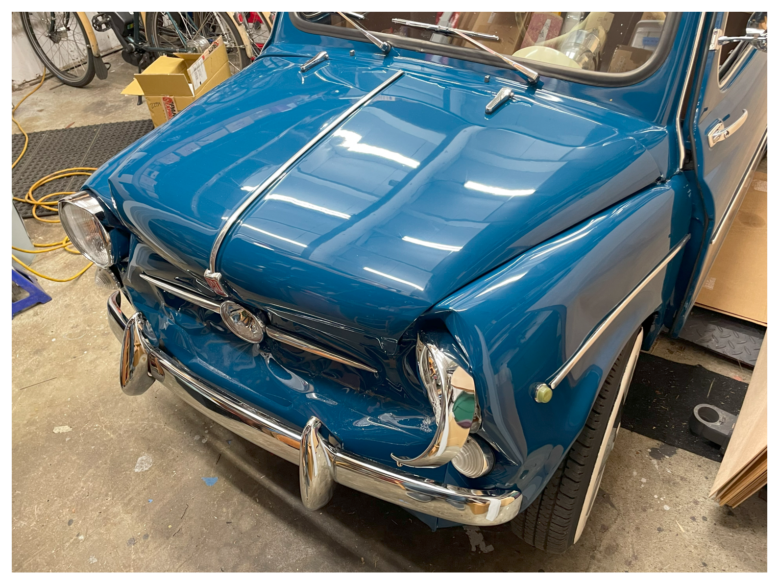

In better news, I cleaned up the badges and trim and started preparing them to put back on the car. I repainted the Abarth badge that came on the car and the Fiat emblem on the hood; they both looked tired. When I was doing body work on the car, I closed up all the trim holes in the doors and hood. I had planned to use molding tape instead. Then i saw @Bounding Bambino thread on using magnets to hold the trim on. I considered this but decided against it for fear of the magnets attracting debris and eventually messing up the paint. So, back to my original plan, which requires filling the inside of all the trim bits with epoxy so the tape has something to grab. I filled the hood trim, side trim and the nose trim. Here is a pic of the nose trim after filling the inside cavity with epoxy:
Then I put molding tape on it and stick it to the car. Easy-peasy. Here is how the nose turned out:
I think I am going to leave off the smaller trim bits above and below the mustache for now. I like how clean this looks.
And finally, here is the back:
Its really coming together!

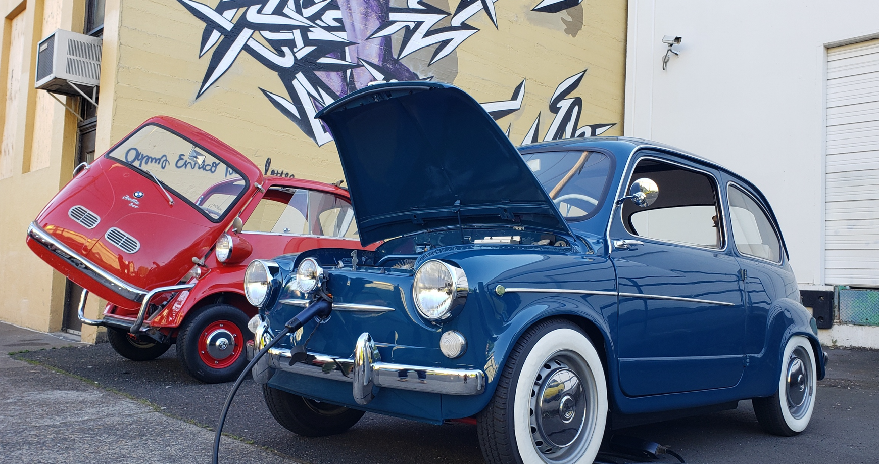

Hello all... I have been zipping all over town in this little blue gem. It now has 199 miles on it and its a hoot. I have been shaking it down, working through issues and continuing to add finishing touches. With a few of those finishing touches, I now consider the outside of the car complete. I also have been working on interior bits, continuing to tune the brakes, brake pressure regen mapping, accelerator mapping, charging, etc... First up, the outside finishing touches, such as the mirrors, trim, and wheels/tires. As it goes on this project, the side view mirrors (specifically suicide door mirrors) did not fit on my doors. Why? no idea, but its a bummer. The door frame was too wide.

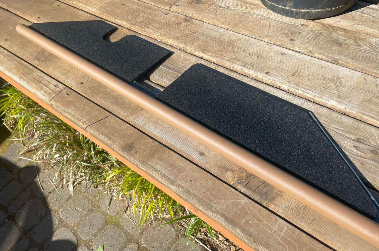

The convenience shelf was easy enough. It consists of a wooden dowel (closet rod, actually) wrapped in vinyl. My awesome neighbor has an amazing woodshop, and he was kind enough to run a relief cut down the length of the dowel for the shelf on his amazeballs table saw. The ABS shelf I made slips right into the groove. Like this:
I added some left over carpet to it for extra luxury. I cut a relief in the shelf for the steering shaft and the future heater tube. I didn't even have to fasten them together. The cut was precise enough, it was a perfect press fit with the vinyl in place:

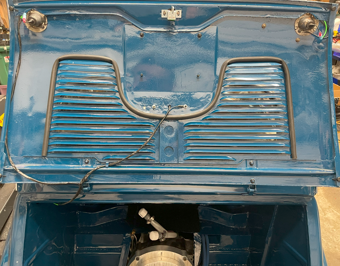

I also attempted to seal up the boot lid louvers. I did this with some left over weather stripping and a piece of ABS that attaches to the same bolts that hold on the license plate. So far it keeps water out only OK:
but the fiat now hauls groceries like a champ!
the finished trunk is certainly nice enough. I added a basket to the motor cover, so its at least somewhat useful, and I turned it into a "hood" of sorts so I can check to make sure the motor is still there:

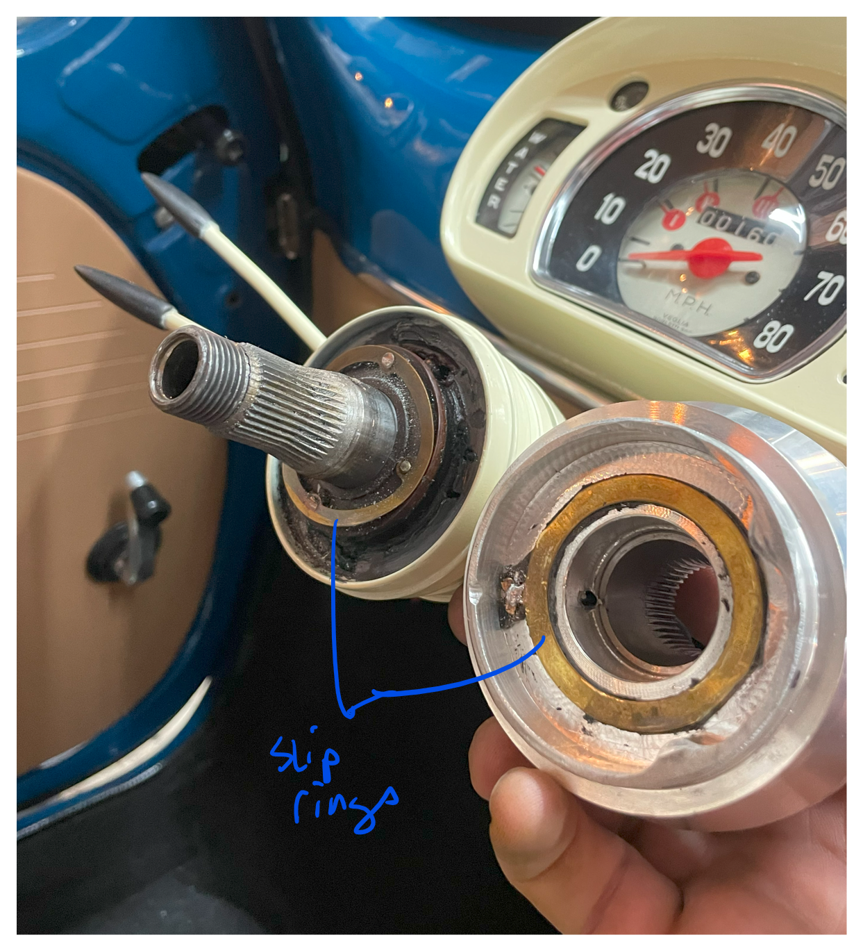

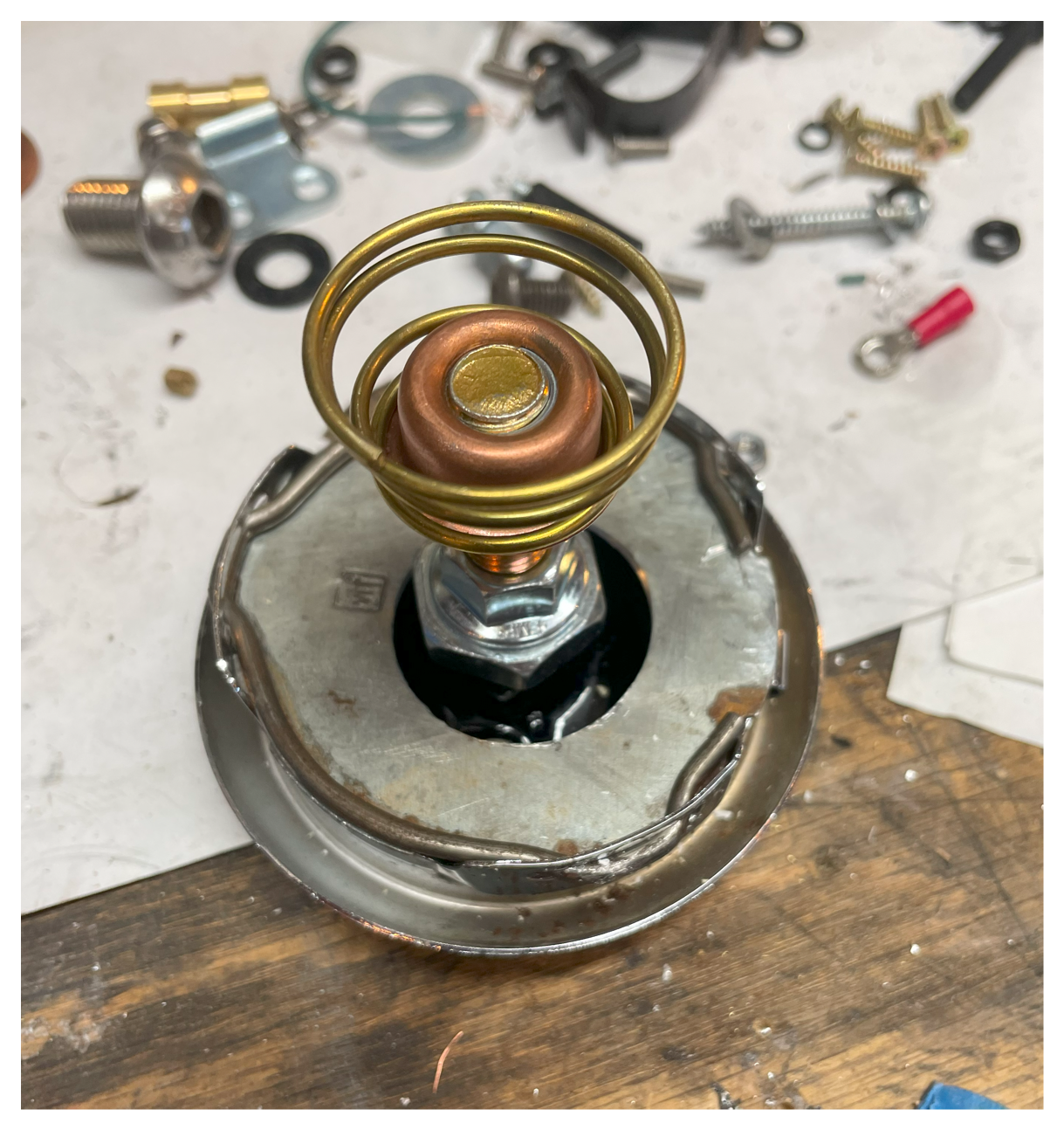

I was driving around without a horn for a bit, and I was surprised at how often I needed it. Mostly to beep back at folks excited to see the car, but also to let huge-ass pickup trucks know I was there. Also, the previous owner had 5 horns in the car. I do not know if he used all of them at once, or if he added one if they stopped working. Whatever the reason, I now had a variety to choose from. So, the whole fam gathered round to test our options and we decided on what I call the "Cadillac horn". It's a horn that has no business being on this tiny car and its very loud. All good, from my perspective. I had already plumbed wiring for it and got to work getting the steering wheel modified. The horn button on this car is the grounding type... meaning there is only one wire that has to pass through the rotating bits. The horns always have 12V on them, and the ground wire is what is switched through the relay. I think most cars are like this, actually. Its clever. The first step is to get a slip ring connector between the steering column and the steering shaft. I did this by harvesting the parts from the old steering hub assembly. I put the brass slip ring on the new hub and with some drilling, ran the wire out to the front. Like this:
the wire is connected to a sst flat head screw that will be located in the hole of the steering shaft:
I used a screw so I can adjust the distance, or the "throw" of the horn button. Here is right before assembly:
And with the sst flat head in position:
Now, on the steering wheel side, I needed some spring loaded button that will touch that sst screw and connect it to ground. I am assuming there the ground connection through the steering wheel connection is adequate. This required that I take the Fiat center button apart and re-organize it. I drilled a large hole in the back plate, epoxied in a nut to the actual button, and now I can add a bolt to reach down and touch the sst screw above. Like this:
Then I added the copper lug and spring that was inside the horn button to the bolt and there you have it!
I snap that back into the steering wheel and adjust the sst screw in the steering shaft to get the right travel. So far it has only gone off twice without me touching it. I suppose I will be adding more gap to it soon. We have a family legend about when years ago, on my 1977 Datsun, the horn button broke and activated the horn continuously.... for the entire drive home... with my 8yr old in the car. He was so embarrassed! I could have pulled the fuse, but it was just so funny.

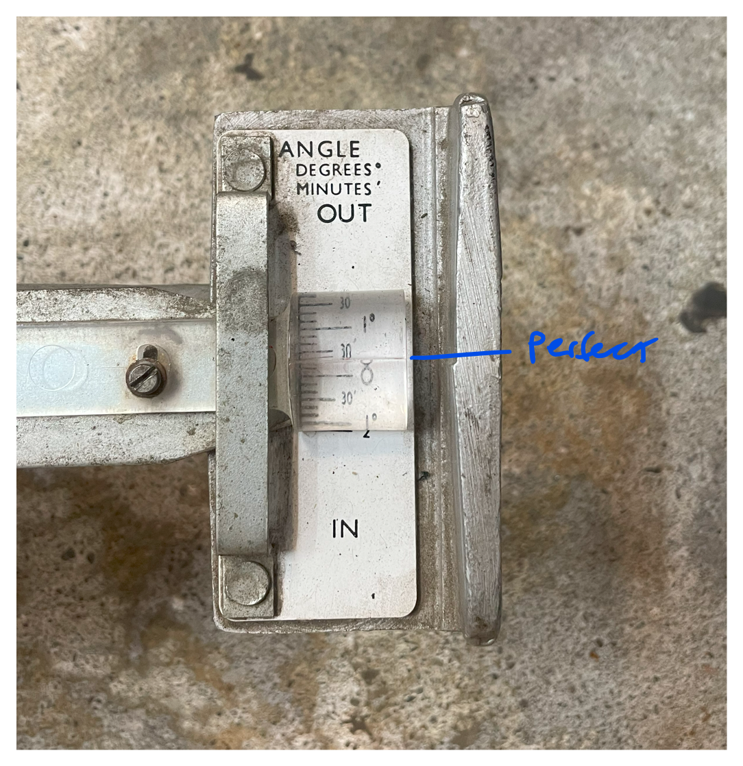

Now... the alignment. As with most things on this project, getting an alignment was not easy. Why? Well... the damn car is too narrow to fit on a modern alignment rack! I called around to a few places, included my favorite local shop, but no dice. So now I get to learn how to align the car myself! I borrowed these fancy alignment thingies from a friend and started with the front. They look like this:
They are really clever. You set them up for the rims you've got, so they touch on the bead edge (not outer lip). The floor doesn't even have to be perfectly level. My friend says they use these at the racetrack to make quick adjustments during testing. Once you have them setup on both sides, you peer down this periscope looking thing and use some guide marks to determine the toe. The opposite side actually has a mirror, so when you adjust the dial to determine the toe, you only have to adjust the side you are looking through. So easy! I eye-balled the fronts a while back and wouldn't you know it? they were off... over 1.5deg of toe out.
Adjust the front is easy enough. Its a big trickier to center the steering wheel, which requires trial and error for me. So after a few adjustments and some driving to center the wheel, we now are aligned (toe only) and centered. It has the tiniest bit of toe. less than 0.5deg.

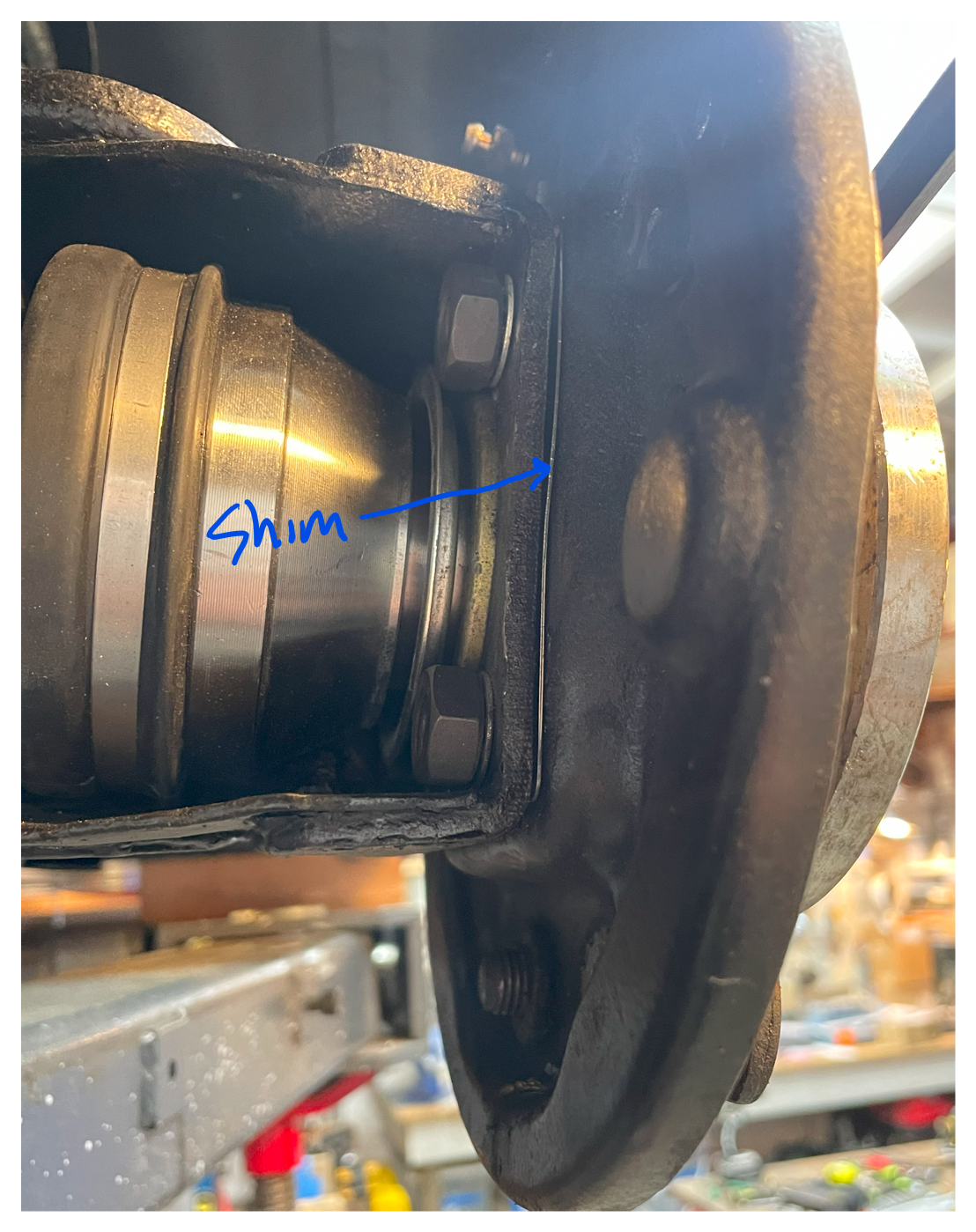

The rears are not easy. Maybe some seasoned Fiat owners know how to adjust the rears, but I dont. I know there are a bunch of shim-like washers at the rear swing arm pivots. I assumed they are for dialing in the alignment. When I first measured the rears, they had 1.5deg of toe-OUT. This explains why the car was hunting all over the place on the freeway. The back tires really wanted to steer the car. So, first, I climbed under the car and removed all the shim washers (which I installed in a somewhat random way, just what was easy). I now biased them all to the outside, in an attempt to pivot the wheel in, adding toe-in. It did nothing at all. My measurements before and after were the same. I had to CAD up a shim to put under the bearing block. Some quick math said I could order 0.02in sst shim stock, and each shim would adjust the wheel less than 0.5deg. I ordered 4 from oshcut.com and they arrived in short order. I figured I would need to add 3 or 4.
And when they are slipped into the back half of the bearing block, they should rotate the rim and add more toe-in. It looks like this:
I added two the right and one to the left and now have just under 0.5deg of toe-in in the back. Perfect. I decided on adding a bit of toe-in in the back because I think this is the more stable setup. Any toe-out is bad news, so better to error on the safe side.
A keen eye may notice that the dial reads nearly 30min OUT... thats because its opposite when these are used on the rears.
Now this alignment does not check for camber, caster and the other more refined adjustments. Nor does it check for "jacking"... where the front and back wheels are not aligned with each other, and the car appears to drive crooked down the road. I will likely adjust camber when I can borrow an inclinometer and spend the time leveling the car. Then I get to adjust the toe again... its a fun game. I will also probably drive behind my gal while she drives the fiat to make sure the car doesn't look too crooked and call it good.

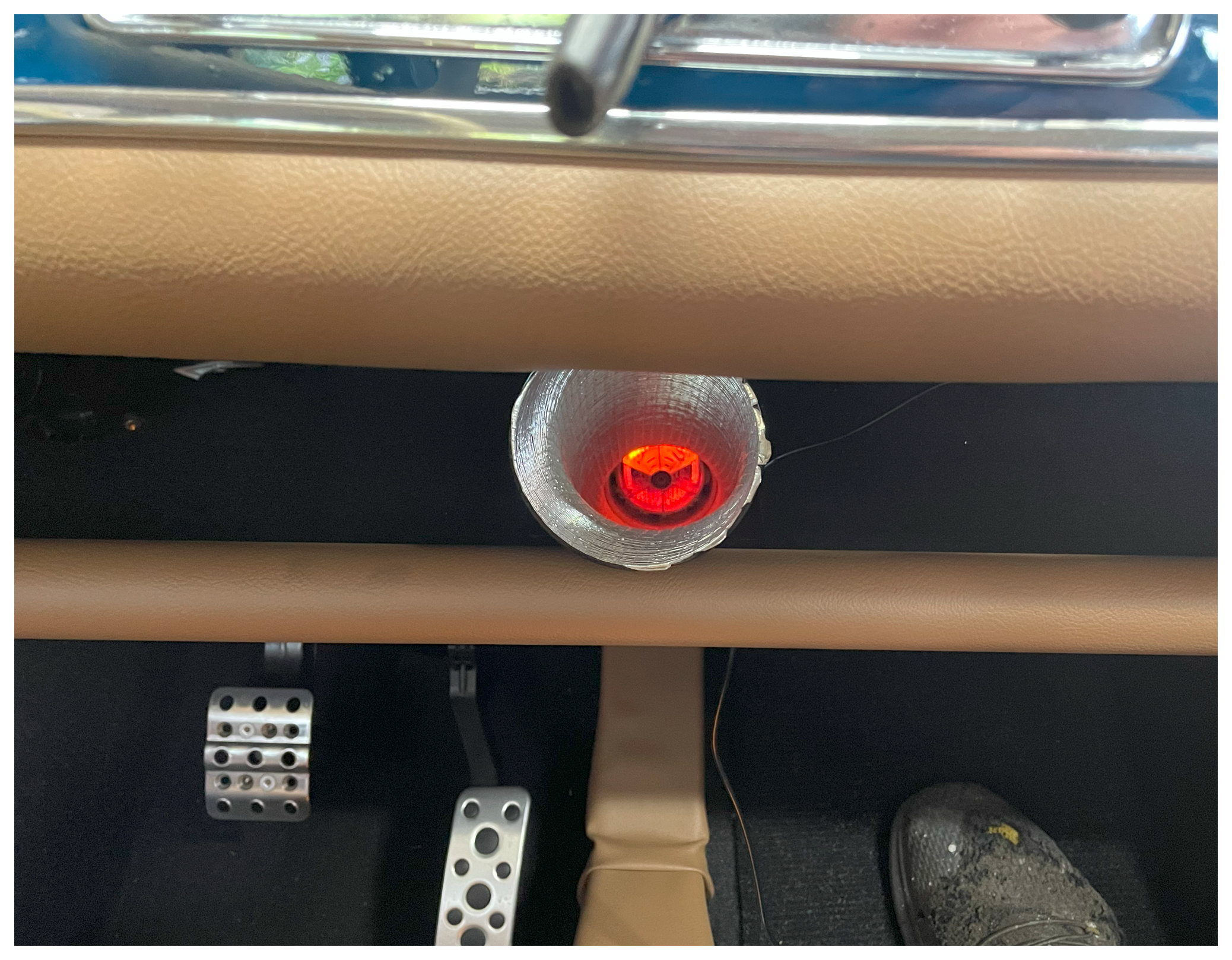

It works! works so well, in fact, that the cabin was WAY too hot after about 3 minutes. This heater is too big. And it gets way too hot. The air flow over it is barely enough to keep the element from getting too hot and the tube and surrounding stuff was getting quite toasty. What to do? I had two options:
1. Get a timer thing that will basically PWM the heater, using the high voltage contactor that connects the heater to the traction battery pack.
2. Get a lower wattage hair dryer element.
The problem with option 1 is that the HV contactors are expensive and not designed to toggle constantly. They have a life of 1,000,000 cycles (mechanically, likely less electrically). I guessed I would have it on 50% of the time... the math said I would have 800hrs of heating, max. That could last a few years, but not long enough before buying an expensive replacement contactor.
The problem with option 2 is that it's hard to find lower wattage hair dryers that have an element that will fit gracefully in the space I have allocated.
I ordered parts for both. I found a 1000W hair dryer. If there was a competition for the cutest hair dryer, I am pretty sure this little guy would win.
But... does the heater element fit? turns out, YES. thank goodness. With some trimming and add screws, I got the element to fit into the exact same housing of the 1800W heater.
and it fits well:
I can say it's just about perfect. I ran it for about 10 minutes and the cabin was nice and warm (it was about 49F in the garage). It also looks way more reasonable... not nearly as hot:
I have it wired so that if the fan is turned off, the heater is also turned off. In other words, the heater can't be on if the fan isn't on. Same for the A/C.

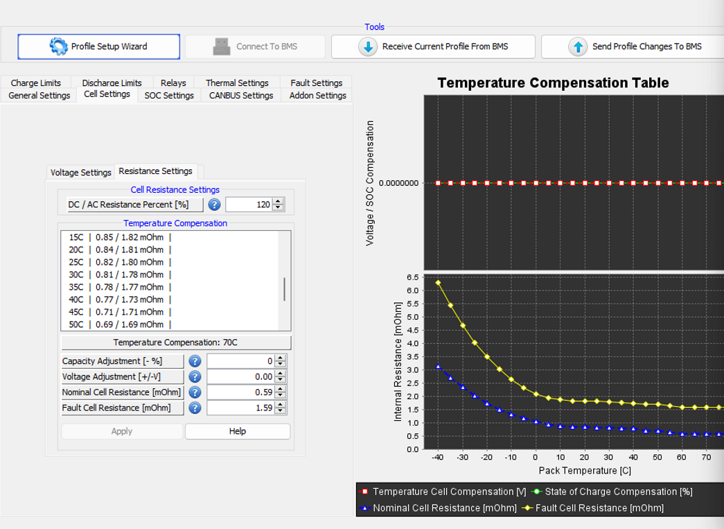

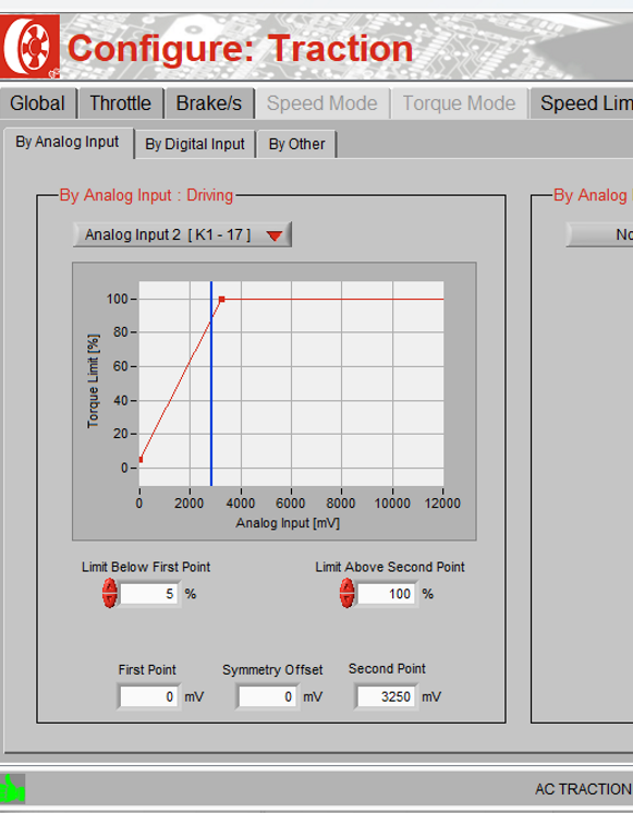

Doing a range test is extra handy since it allows me to really refine how the car behaves at very low SOC. Thats when stuff gets really interesting. The battery manage will reduce the allowable current to protect the batteries when they get low. This reduces the power, of course, but is gradual and I know its coming. The tricky part is getting that information to the motor controller. I think many conversions would have the motor controller and batter manager communicating over CANBUS, and the motor controller would just get info that way and reduce the power used. My setup does not support CANBUS communication between the two. Luckly, the BMS (battery management system) does have an analog output that is scaled with allowed discharge current. 0-5V, where no current is allowed at 0V and a full 500A are allowed at 5V. I just need to hook up that analog output to an input on the motor controller, and that's what I did today. Then its all about setting things up correctly, which requires the batteries to be very low. Here is my process:
1. Change the setpoint on the plot. This is the linear derating of allowable current that my motor controller follows.
It is setup so that when the BMS reduces the allowable current and the analog output says 3.25V (down from 5V), the motor controller starts to throttle how much current it pulls. The key is match up the slope of that curve with the behavior of the BMS.
2. Next i drive around, and floor it. I observe the current limit reported by the BMS. Here is an example plot the BMS can generate, real time:
The blue spike represents flooring the car and the current demand, and the red line represents the "allowable current". If i have done my job right, the motor controller will pull less and less current so that the BMS never faults and cuts power completely. This is the desired behavior, since i always want to get off the road or somewhere safe, even if slowly, when I am completely out of juice.
3. I repeat this until the battery is dead. Hopefully this is at the exact moment I pull into my driveway. It worked this time, but hasnt in the past. I had my tow cable in the car but didn't have to call my gal, unlike previous attempts. She is so supportive and jokes "you aren't having enough fun unless you've had your annual tow home, am i right?" . I am so lucky.
4. I then adjust the programming that controls my "gas guage" to make sure it reflects below E when the car is limiting current like this.
In addition, I adjusted some of the internal resistance settings to reflect the older batteries. The software allows all sorts of adjustments, and really trusts you to do things right. Adjustments need to be taken with care as to not ruin the expensive batteries. Here is a setup table and plot of derating the cells as a function of internal resistance and temperature. The cells behave differently at different temps, and this BMS allows one to program it. Its very powerful and fun.
i think this is a blast. I was also able to attend a car show this morning and it was very fun to see people's eyes get huge as they realized what this little car is all about.
The fiat looked huge compared to that Isetta (which belongs to a neighborhood friend).

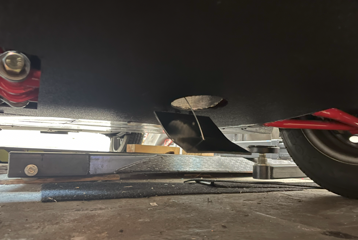

I purposely lined up the outer most fins with the truck/rear panel lines. The motor and controller did not overheat, so things are looking good!

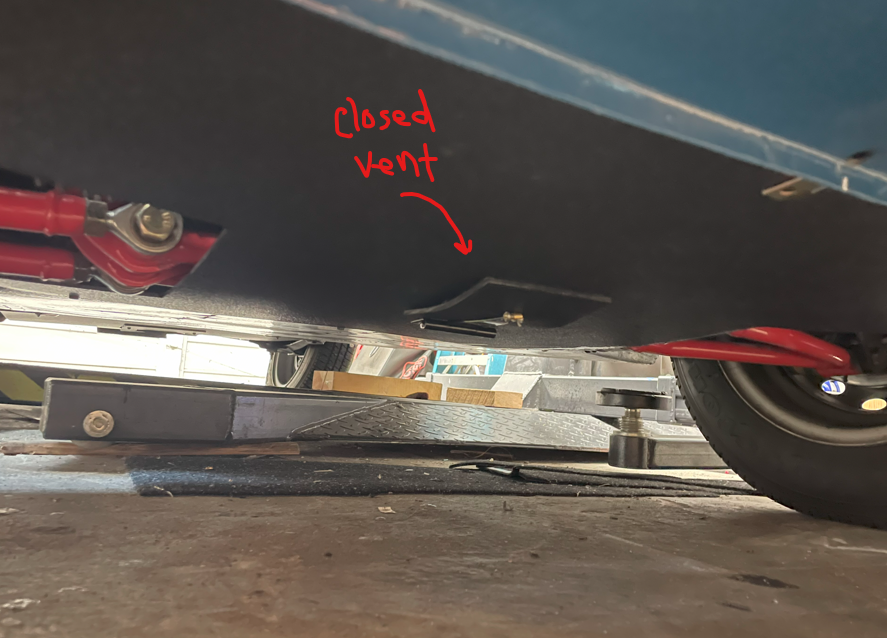

I also decided to add a trap door vent to the front. It is actuated with one of the sliver levers inside the car and allows for fresh air to travel to our feet when cruising on the highway. Its very cute and i have only torn it off once so far.
Closed:
open:
it works pretty well.

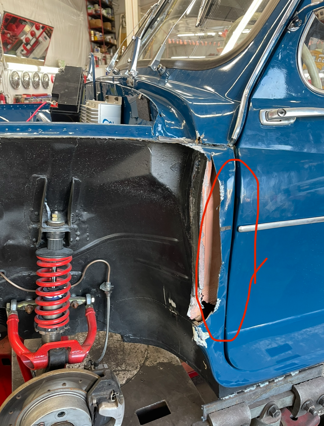

Recently when driving this car around, someone flagged me down and said that my brake lights were not very bright. That was very nice of them. I had already put bright LED bulbs in the car, cleaned up the reflector and contacts, but they were still no match for the sun. So, i hunted for even bright bulbs and added a 3rd brake light. I ordered these in red and despite their length, they do fit in our little tail light lenses:

Hey all. Ive got some crummy news. My wee fiat has crashed. This happened a month or so ago with only 1500 miles on the clock. I am sorting out what to do next but my intention is to repair it. Sadly, the insurance company declared it a total loss, so this little guy will now have a branded title for the rest of his life.
I have ordered new body panels from Ricambio and started taking things apart. I have some inner fenders to straighten out, which has me worried. I also need to assess any impacts to the frame, which appear minimal, but its tough to tell at this point.
The biggest issue I see so far is some buckling of the cowling just under the windshield. Not only will this be a pain to repair, it points to some unibody movement that may impact my recovery effort. We will see.
I now have a winter project.

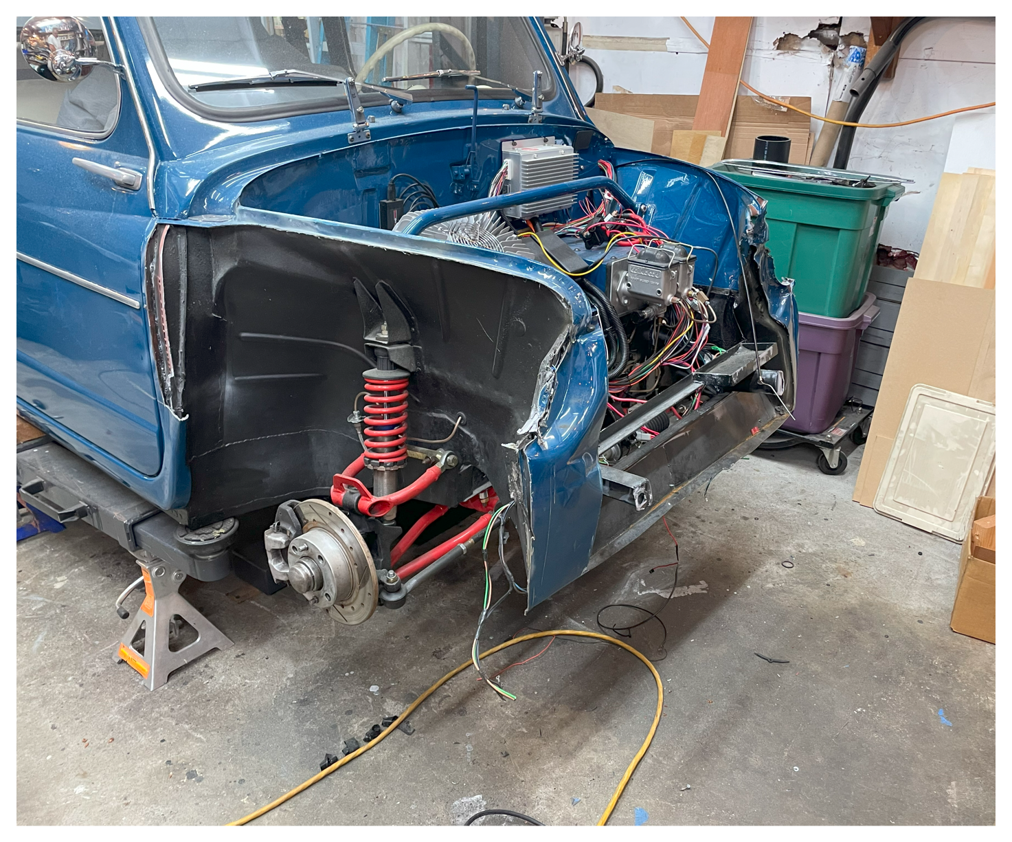

and now with some stuff cut off:
Wish me luck.
Wish me luck.

Good news: I found a local shop to attempt some frame straightening on the 600…. Goin Straight Alignment on E Burnside in Portland. Seems like a great shop and so far have been doing a bang-up job. They got a start on it last week and invited me by to see the progress. They also seem quite charmed by this little guy.
The car looks like a toy on this frame rack:
This has been a tricky one for them… perhaps cuz it’s a 65yr old, cheap Italian car? Made worse by the fact that I rebuilt a bunch of it so some of it is as strong as a truck while other parts are… well… frail? As they were tugging on it, much more of the car was moving than just the front fenders. They got creative and managed to get a bunch of it straightened out. Pictures don’t do it justice, so just know that this drivers side door was nowhere near closing when I dropped it off. The fender overlapped the door by about 20mm.
They said the drivers side front wheel was pushed back about 15mm. They got that pulled back into position. The cowling is way better and the inner fender wells are about as good as they can get.
Next up to so work on the drivers side door and get it to sit properly in the door jam. I dropped off the hood for them to fit check. If all goes well, I’ll have the car back on Wednesday and the rebuild can begin.
