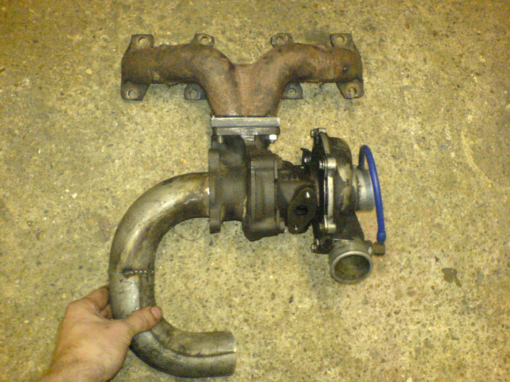

got the turbo exhaust flange made today, need to drill the exhaust pipe hole in it and attach the pipe next, 1.5" pipe i guess? any ideas where I can get the elbow to come off of the flange? To make this sort of thing https://www.fiatforum.com/attachment.php?attachmentid=30904&d=1185470882

Got the exhaust flange hole drilled out today and picked up some 90 degree elbows, bored out a bit of steel on the lathe to join the 2 elbows, I'm off for a shower now but then i'll take some pics of what i've got so far so y'all can see :)
thanks again for all your ongoing help and support!
