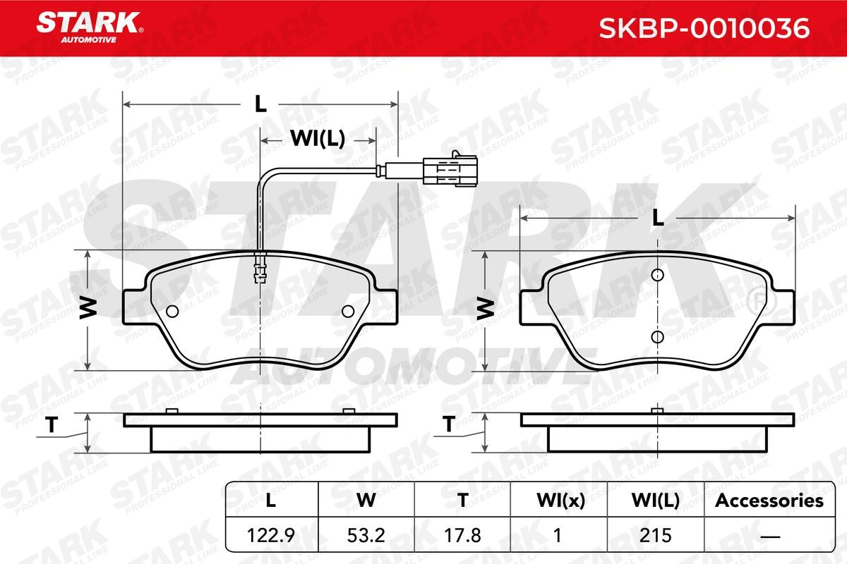

Ordered these pads from Autodoc (who clam compatibility) STARK SKBP-0010036 but they do not fit in the caliper, which i only found out after i fitted the new discs.
The width is to... well... wide by about 10mm.
The inner pad hits the hub of the disc, and the outer hits the pad holder preventing it from being seated.
Could someone let me know which pads to get please.
Ta very much.

Assuming we are talking about the fronts
There three different pads fitted
2 different ones on the 4x4 depending on year
And 77366134 on the 2wd multijet 1.3
Did you compare the discs before you fitted them I wouldn't totally trust autodoc website

Ta for the info and part number.
Yeah the fronts.
I did compare the discs before fitting and they're good.
