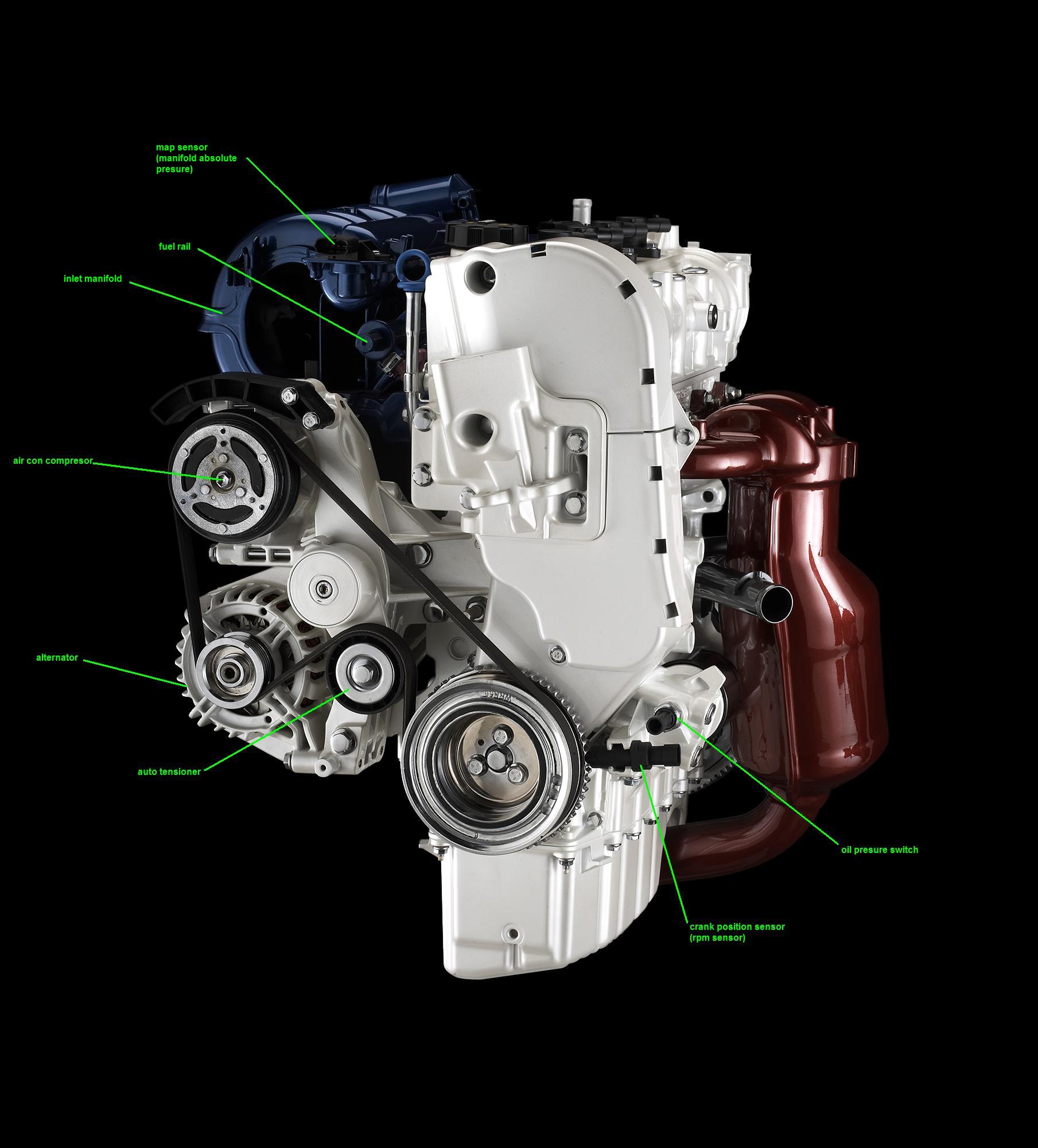

Hello,
I am trying to find out the location of the core plugs on my Fiat Punto.
It's a 1.2 16V engine it has the code 188A500
Can someone help me with this? Some photos would help me to.
Thanks

I was just wondering about the location to check on them.
As I am going to replace the timing belt I am wondering why the cautionary warning about not messing with them?
Are there any downsides about not changing them preemptively?
Having had leaking core plugs on my last punto, I can say, leave them ALONE!!. I filled mine with liquid metal to stop the leaks, but it was very messy and I would not advocate it!!
On the first photo, you can see one plug between the water rail (black pipe behind exhaust) and the green note line. - theres three in a line behind the exhaust - four at the back of h engine in a similar position and nearly impossible to get to.
If the ones at the font behind the cat don't have a rusty, water coloured mark on them, leave them well be.

So there are a total of 7 plugs? I was thinking there would be more.

There is at least one more behind the bell housing between gearbox and engine for me to know of. From doing (or more correctly, bodging) mine, they are not really a serviceable part without a massive expense as the engine ideally has to come out for them to be pressed in. There may be ways of doing it in situ, but it wouldn't be easy!
