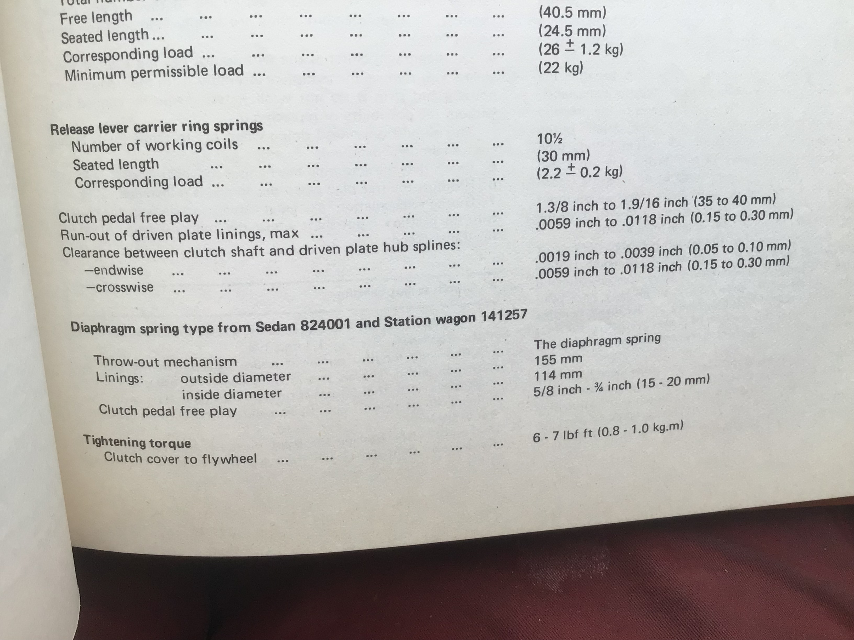

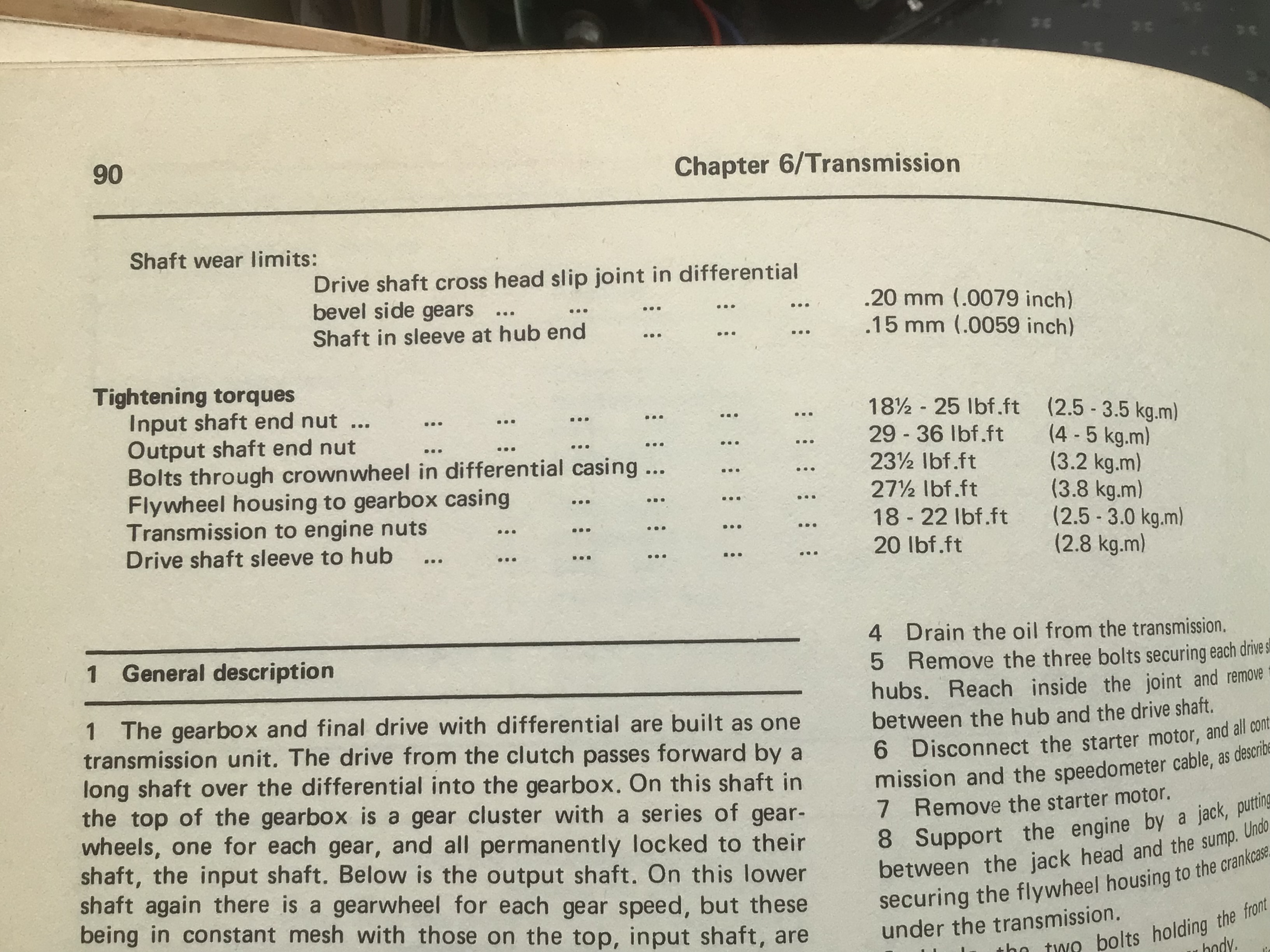

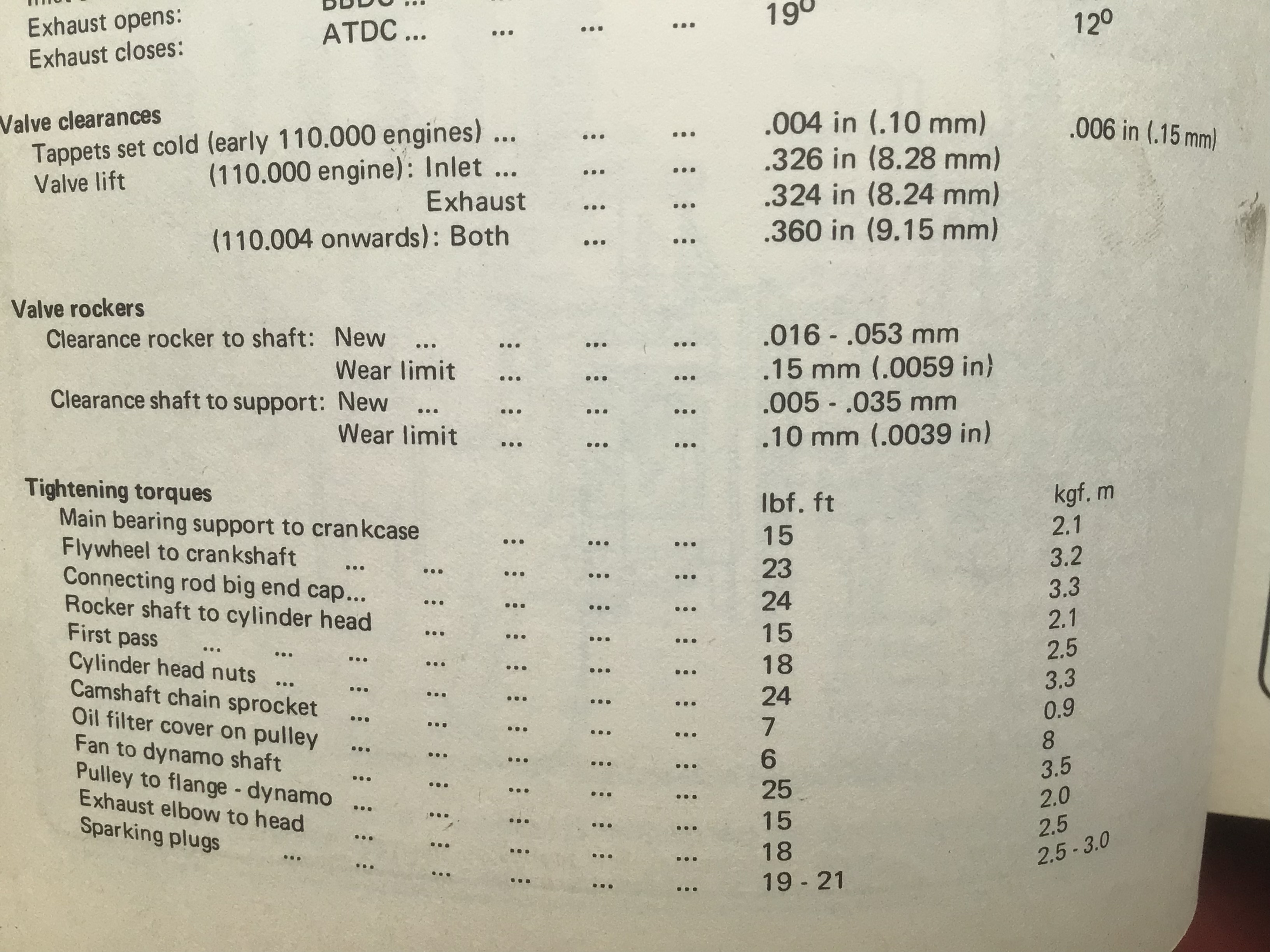

If you would like to contact me direct---
[email protected] I will give you all the 500s engine and gearbox torque settings. It sounds as if you don't have a 500 W/Shop manual; may I suggest that you try and lay your hands on one---a 'Haynes' manual will be perfectly satisfactory if you can't find a 'Pukka' factory manual.
