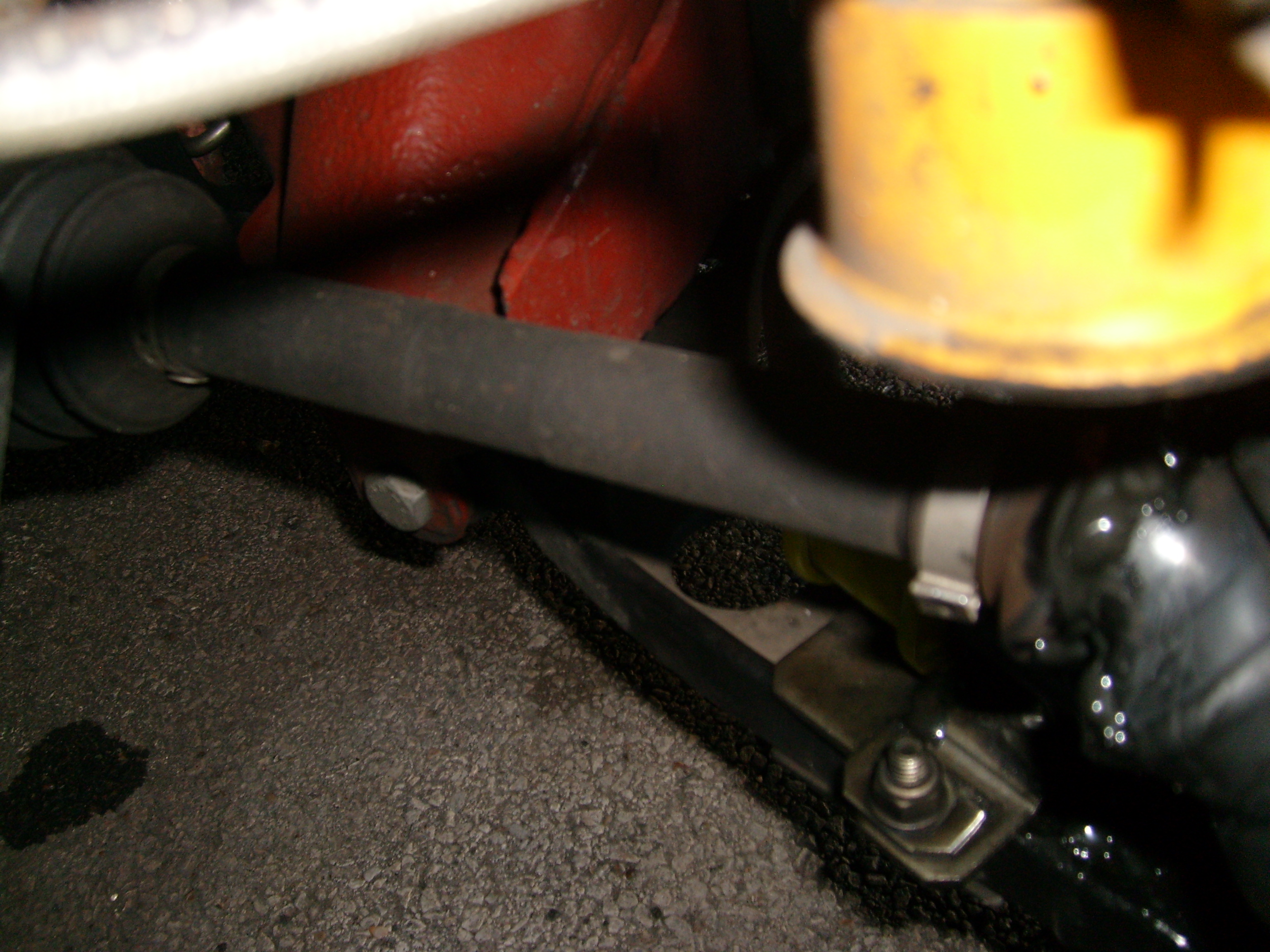

Had one of the strongflex anti roll bar brackets shear off today. The roll bar hit the CV boot and ripped the crap out of it throwing grease all over the place.
I only replaced the boots 3 months ago for genuine fiat ones as the after market's split within a year of fitting.
I'm thinking that there may be a weakness in the bends on the bracket, So will get genuine fiat to compare.

Fiat brackets and boots are now on order.

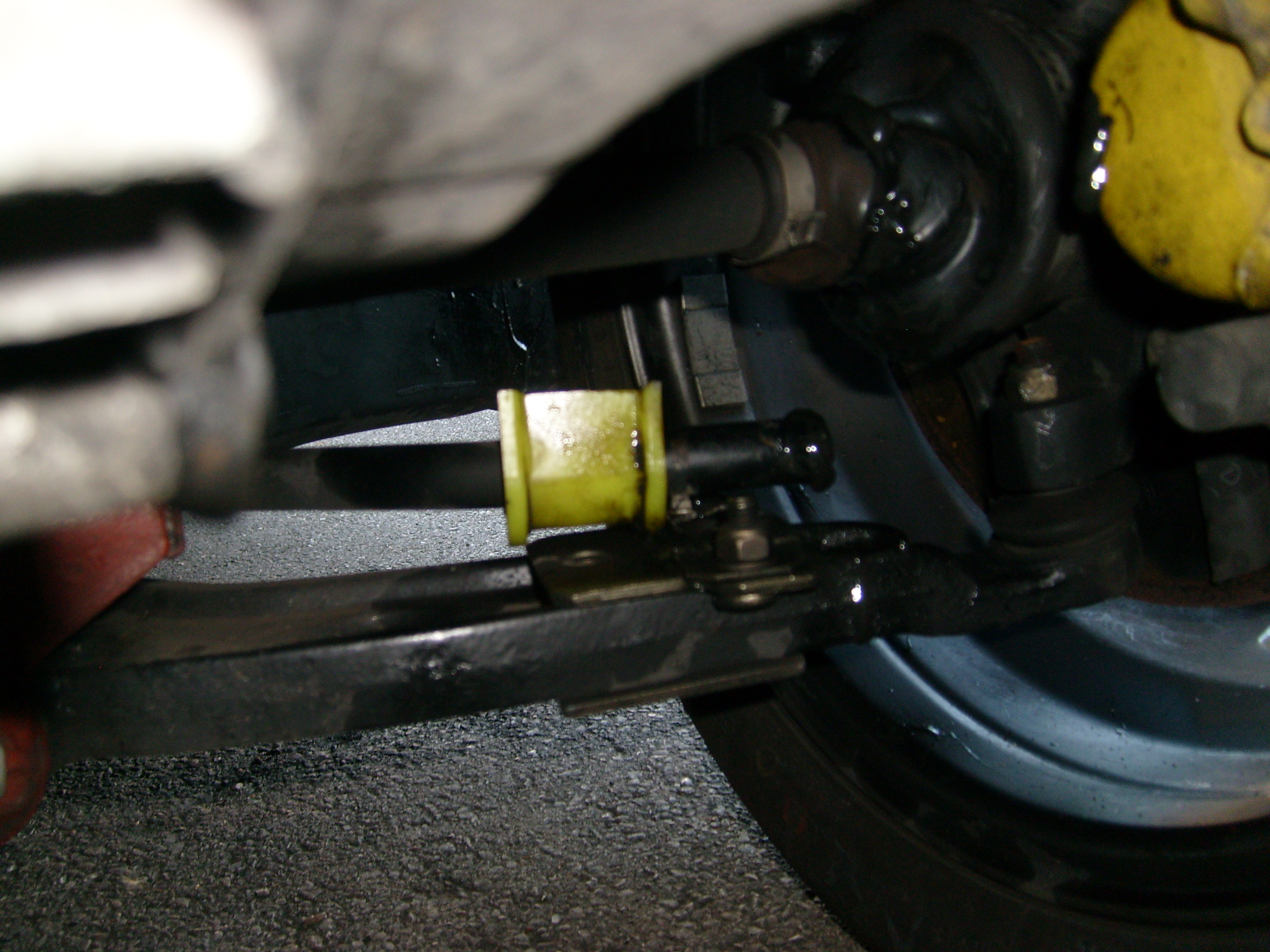

The damage:
I think the stiffer springs put extra strain on the brackets and the damn speed humps.
The arb is central. Camera angle not good. I remember going over a speed hump with the drivers wheel and hearing a ting ting ding ting, sort of thing:eek:.
I hope your a speed bump crawler, and not one of the plonka that race over them at 30mph. I don't go any faster than 10mph over them :D.
Impolite people can break their cars and ovetake me, I'm saving my suspension and chassis for future reference :D.

i had my first set of anti roll bar brackets snap and i contacted the polish guys at stongflex and they said they have made a modified set of brackets as they had alot snap so they send them out free of charge and were here in 5 days and they are a bit thicker than the originals they sent and so far so good:D:D
