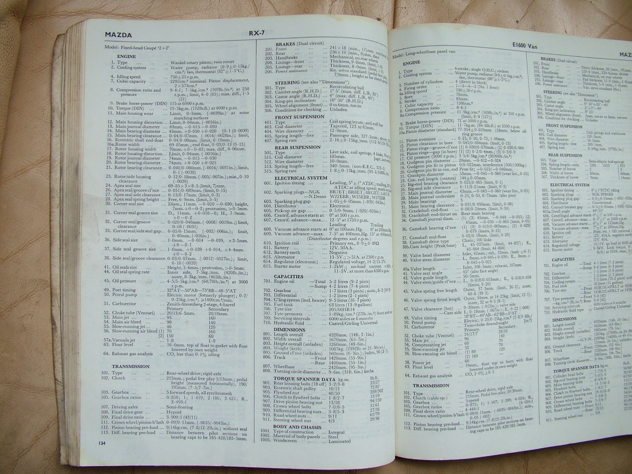

Did find this in Palgrave Technical Service Manual 1985 on early RX7 giving a compression of 107psi at 250rpm (minimum 85 psi) so easy to see why not a lot of low down torque perhaps and why it could be harder to start when worn.
