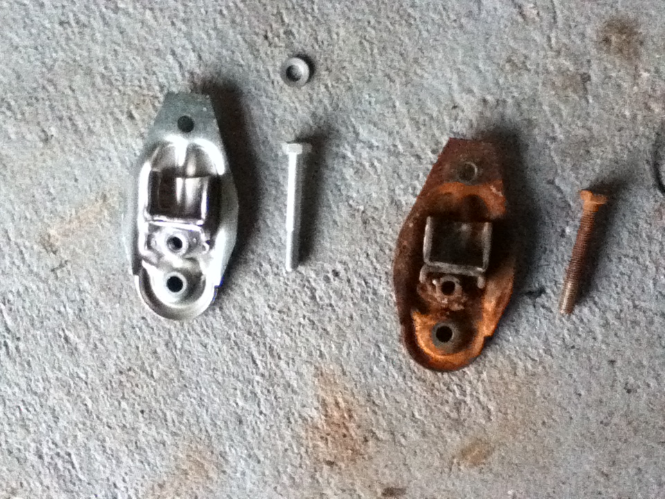

Replaced the engine mount - the new one has bits the old one must have lost. Also replaced the engine mount..... mount. The sagging was indeed due to the (poorly) re-welded captive nut breaking at some point during a bodge-a-rama. There was even a weird-looking bracket which was used a repair washer.

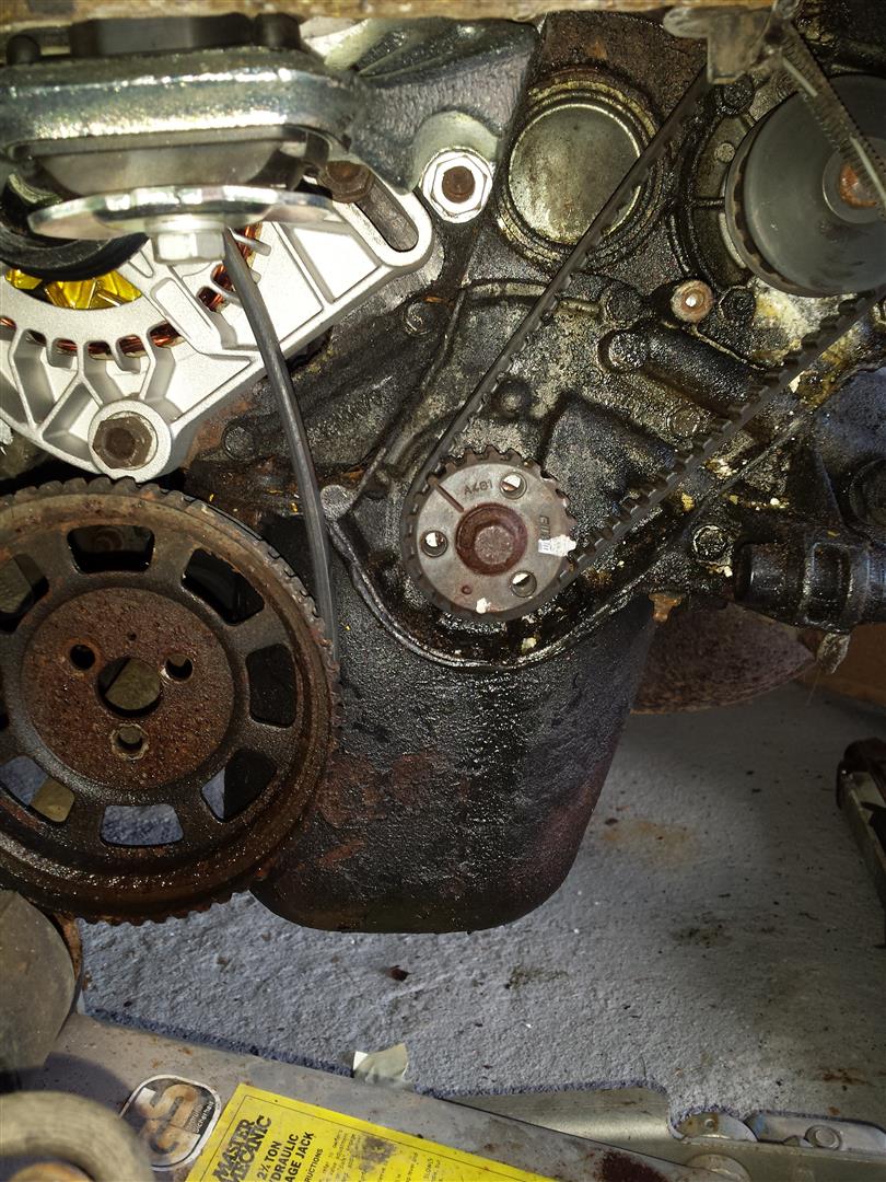

After getting a persistent "random/multiple misfire" error with my reader, a little forum search revealed that this is possibly down to a cam to crank phase issue.
I have removed the cambelt upper and lower covers and firstly, using a crank datum photo from the forum, I did my best to align the pulley with correct point on the casting:
The new engine mount can also be seen here (I forgot to get a picture last time).
The resultant cam pulley marking with the head datum looks bang-on:
As I found the crank position to be a bit ambiguous (and I was constantly checking the cam pulley for confirmation), I decided to use the flywheel timing mark to get a second opinion on this:
The cam pulley, depending on viewing position, could be 1-tooth out? Is this a parallax viewing error or does it look correct?
Perhaps the easiest way of checking is to advance the cam pulley by 1 tooth and retest!
