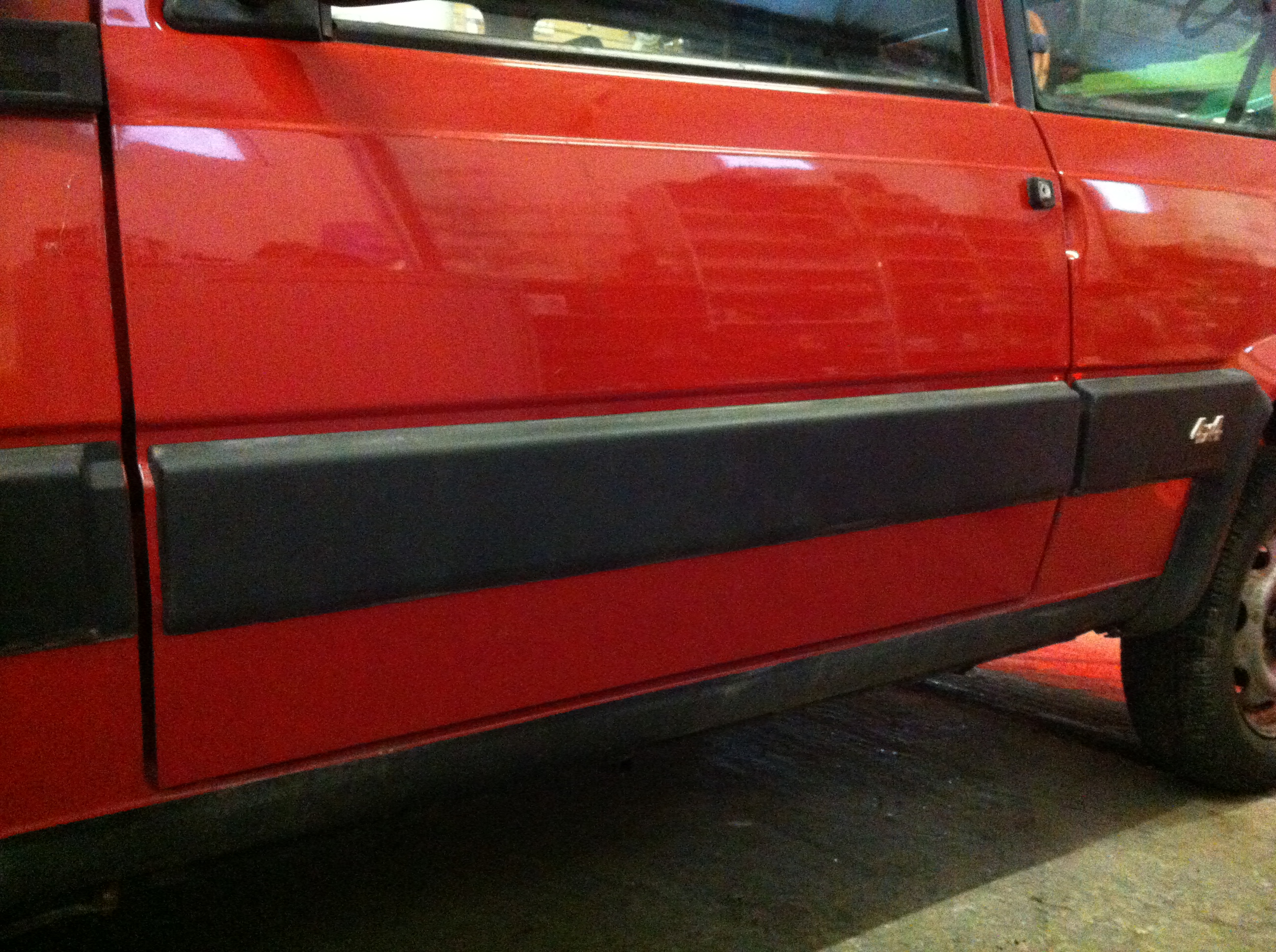

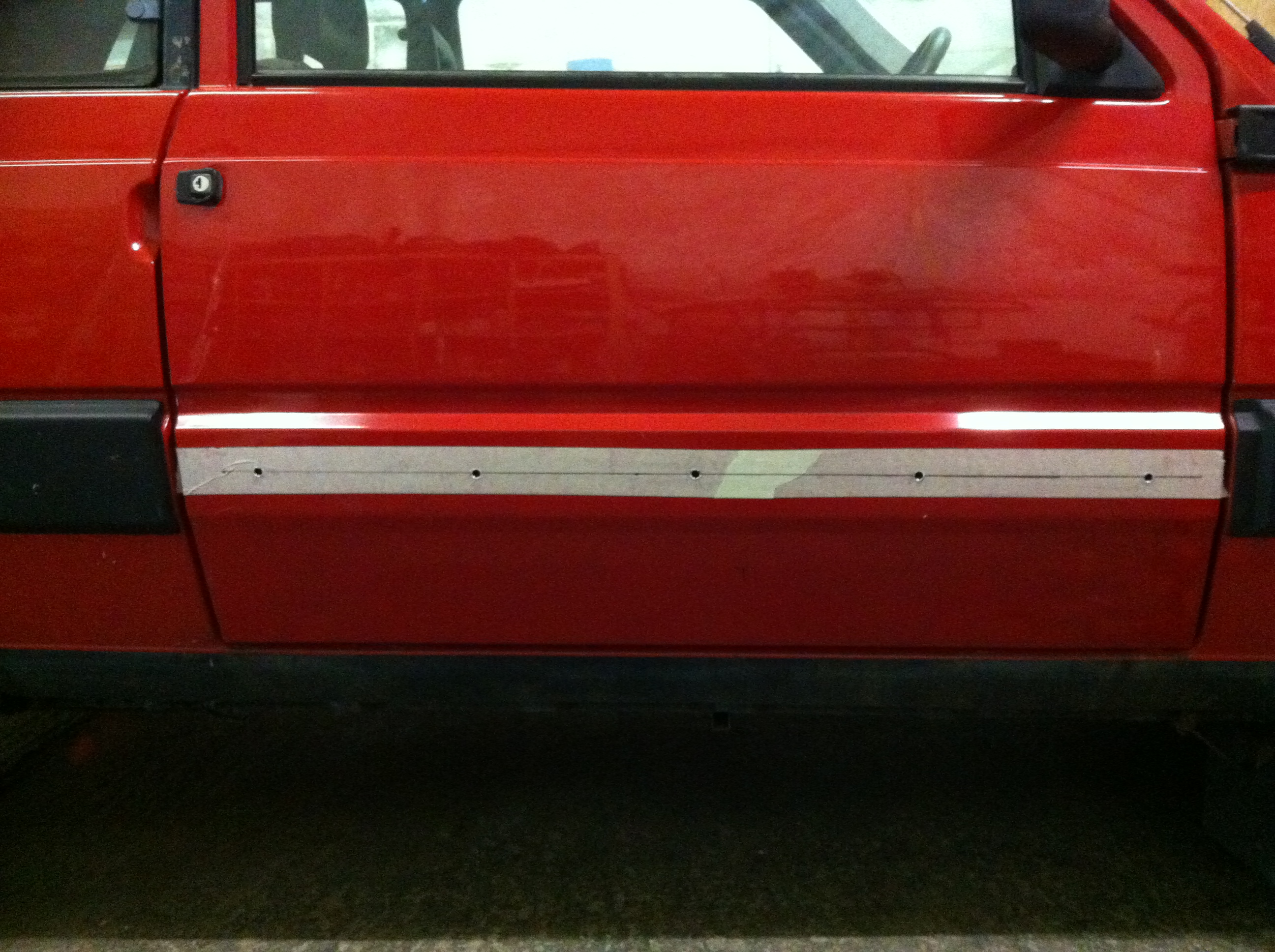

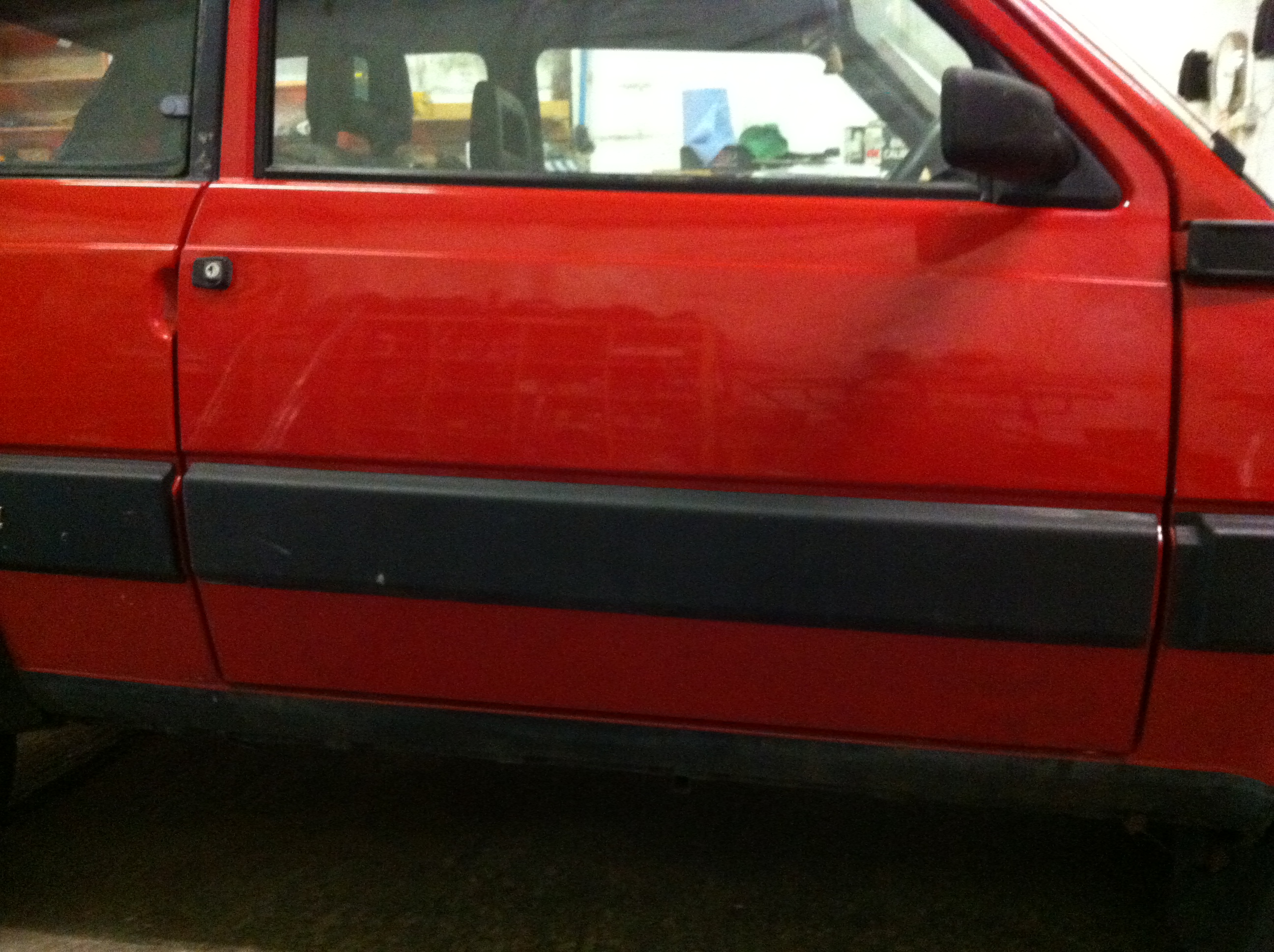

We put the better doors on today as it seemed to be the safest place to keep them. They came from a 2wd of the same colour so I was hoping for a good colour match. The 2wd Panda didn't have side trims so I had to drill holes for the trim clips, It didn't have a door pocket on the passenger side either so I had to fit new inserts for the screws too.
Once I polished up the body a little either side of the doors I could see that the colour match is great, as is the condition of the new doors, if only it could be that cheap and easy every time.
I still need to add the black areas around the windows and will renew the black around the rear side windows too as it's a little tatty, but not a priority at this stage.

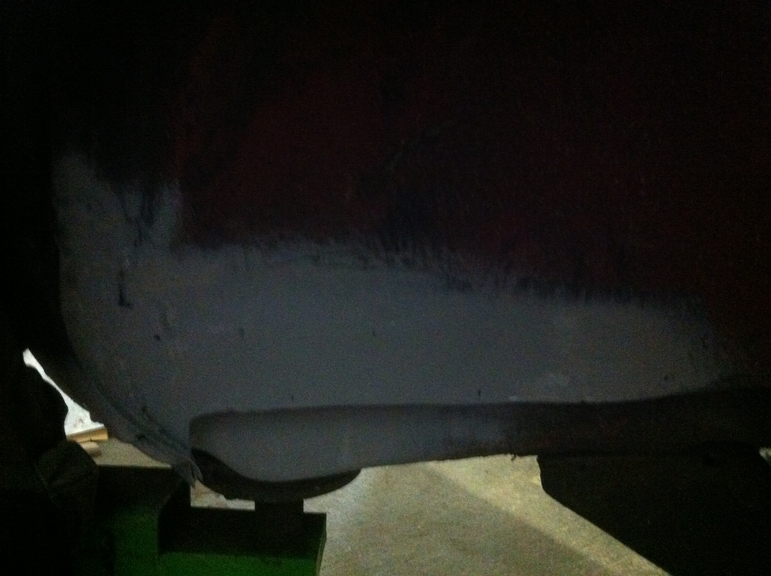

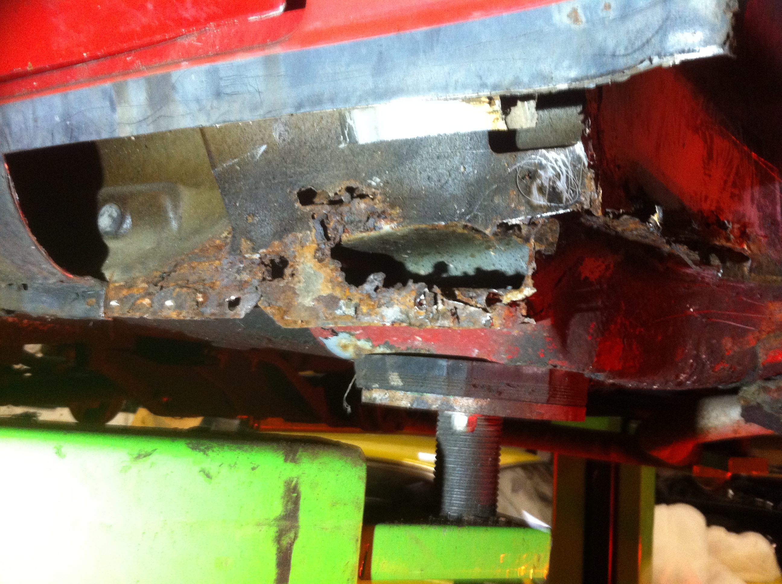

The o/s sill was not quite as easy to repair as I'd hoped......
Appologies for not having more pics but my head was down at this time and I kept forgetting to take them.
A service and a new ball joint was about all that was needed after the welding to get an mot. :D

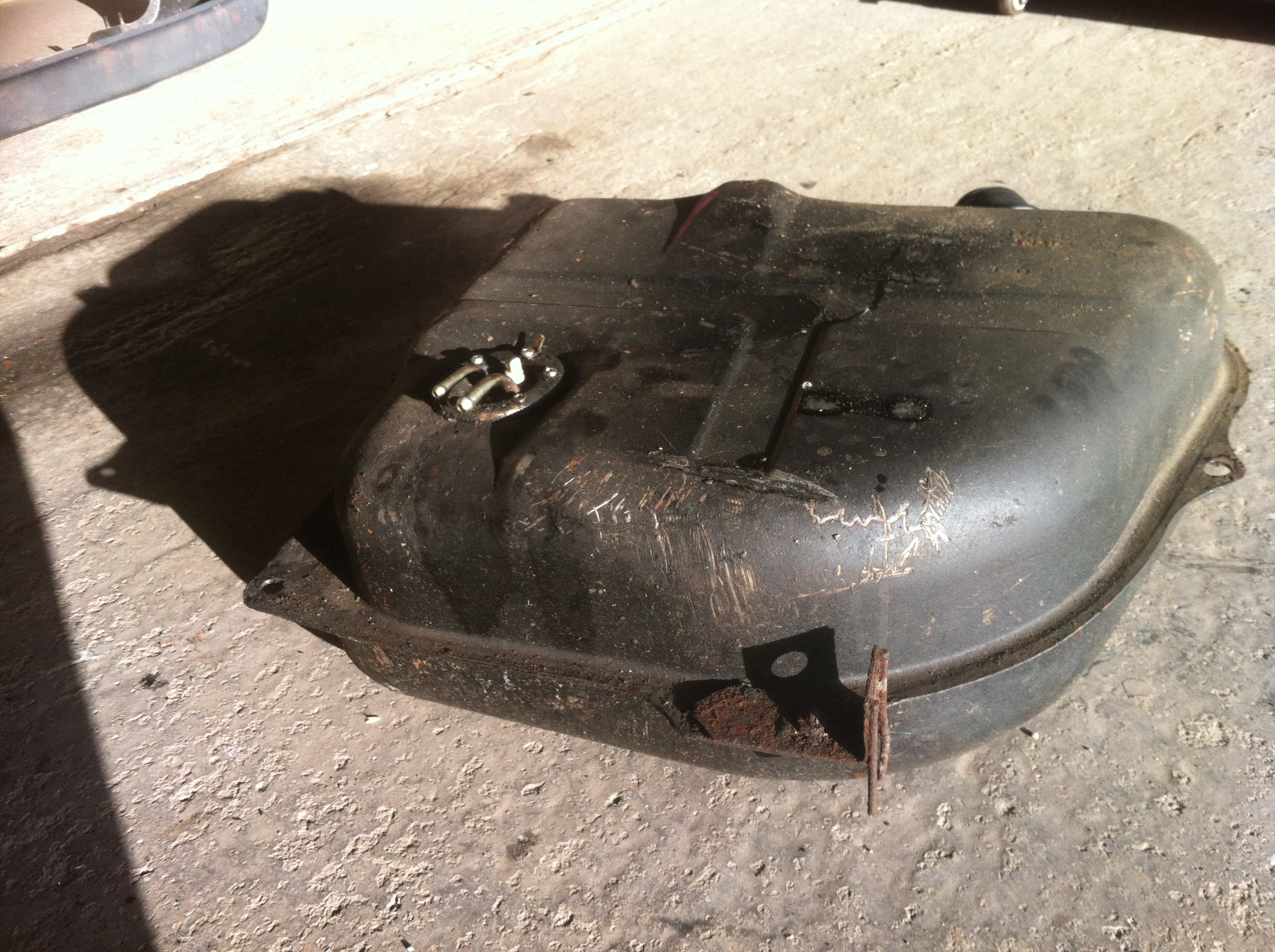

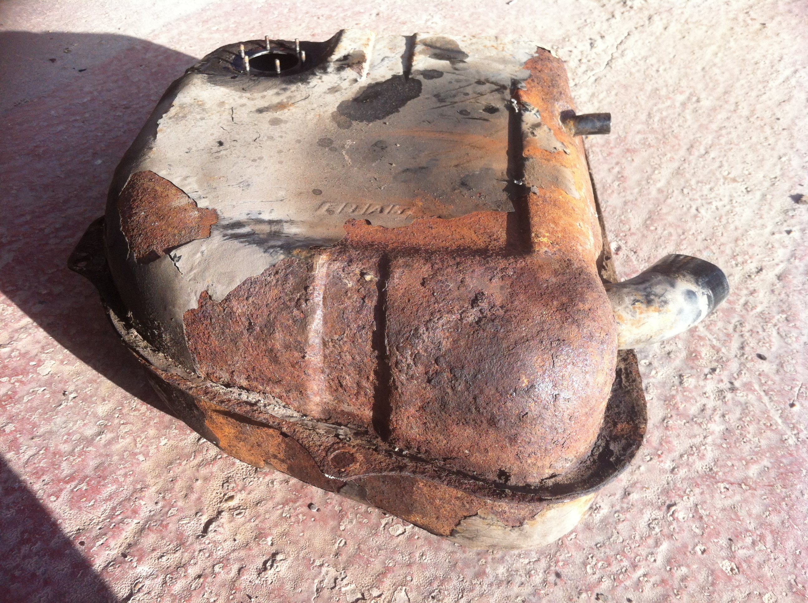

The fuel tank was looking rusty, just surface, so I thought I'd clean it up and protect it. It didn't take long before I discovered a few pin holes, I then had a leaking tank :bang:
Fortunately I had a spare.....

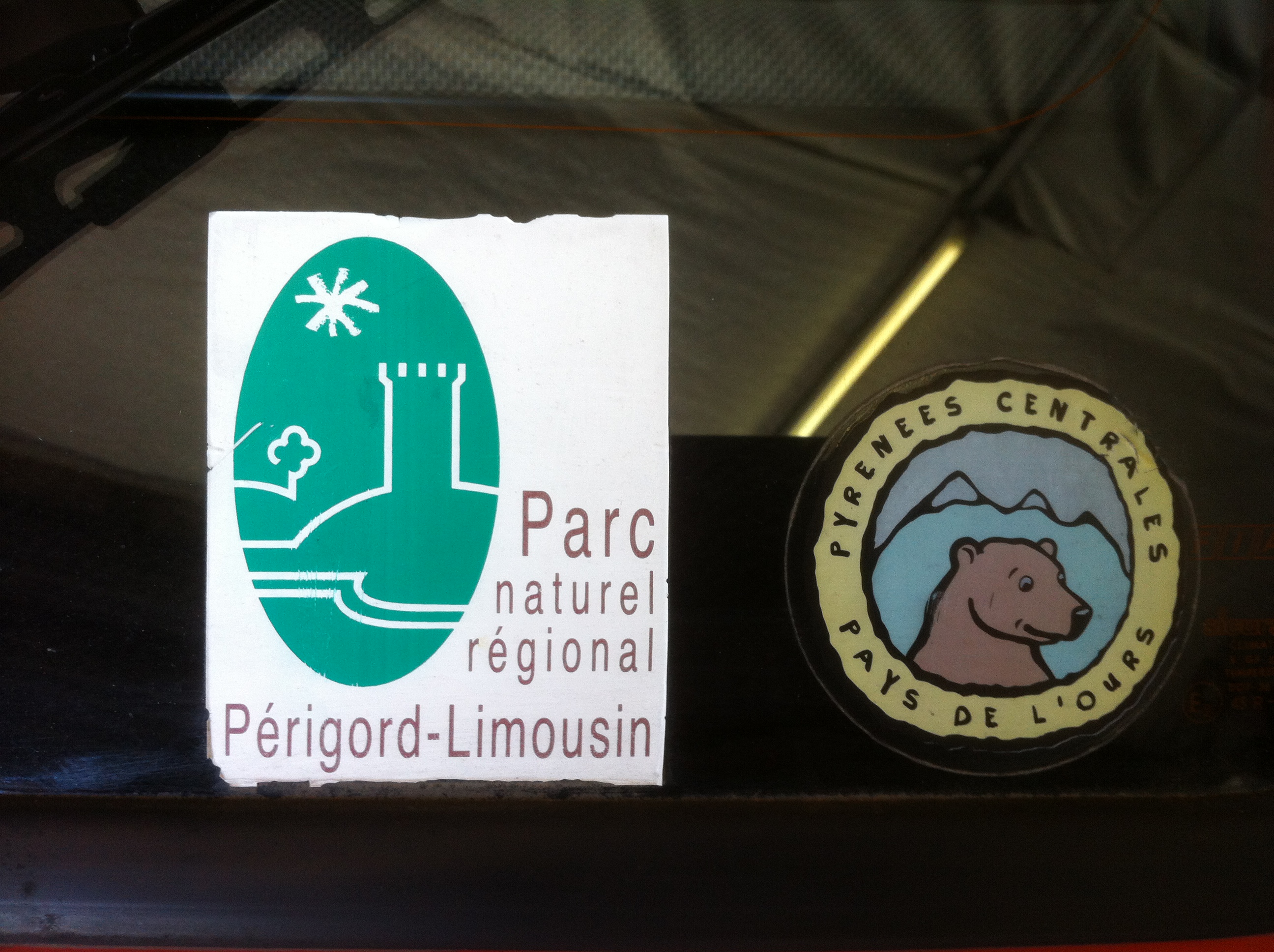

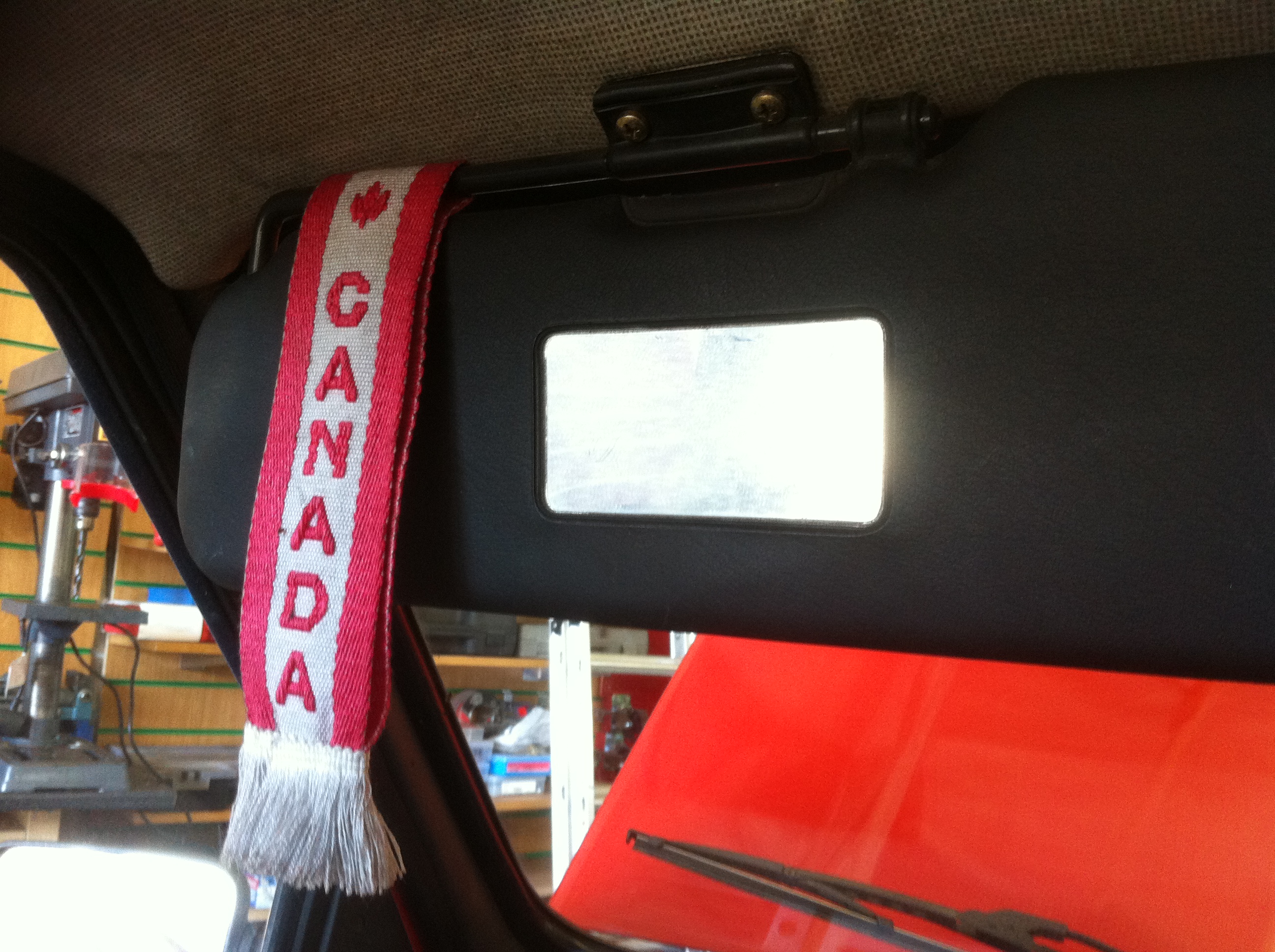

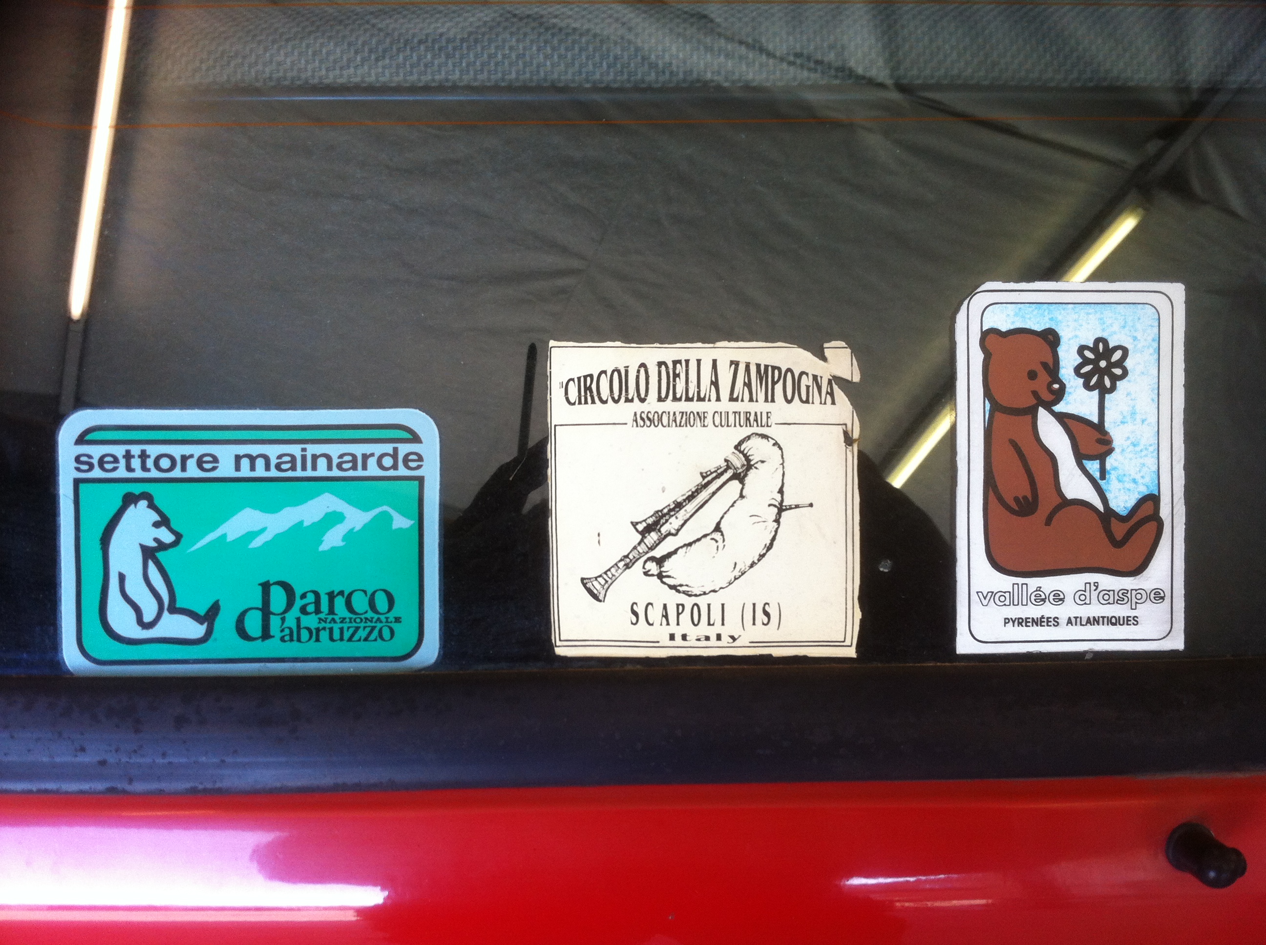

There are quite a few stickers in the windows that Peter collected on his European trips. I hope future owners keep them as they are an important part of this cars history......
The Panda has never been to Canada of course, Peter Derow was Canadian.

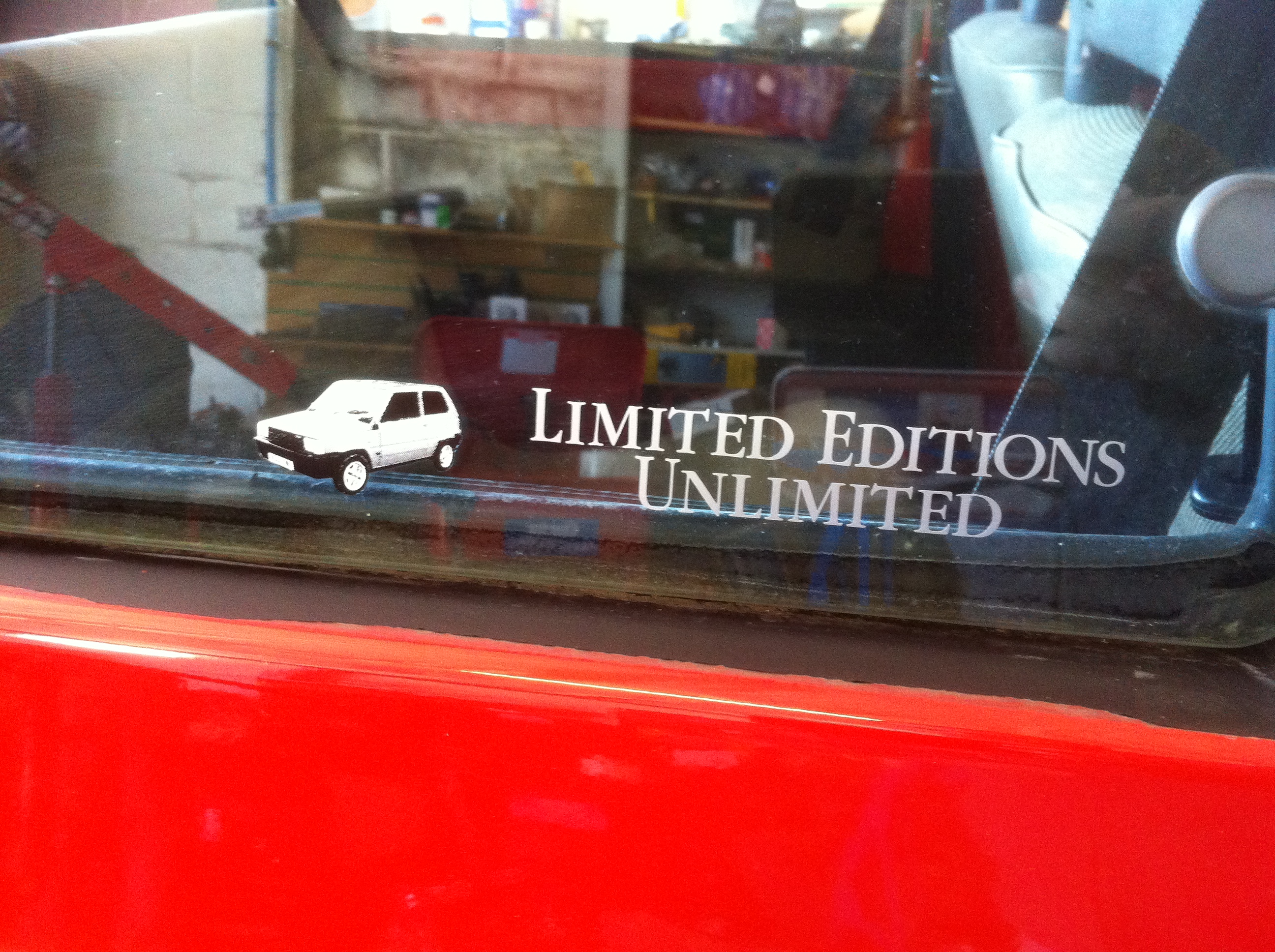

I had to add a sticker of my own.....

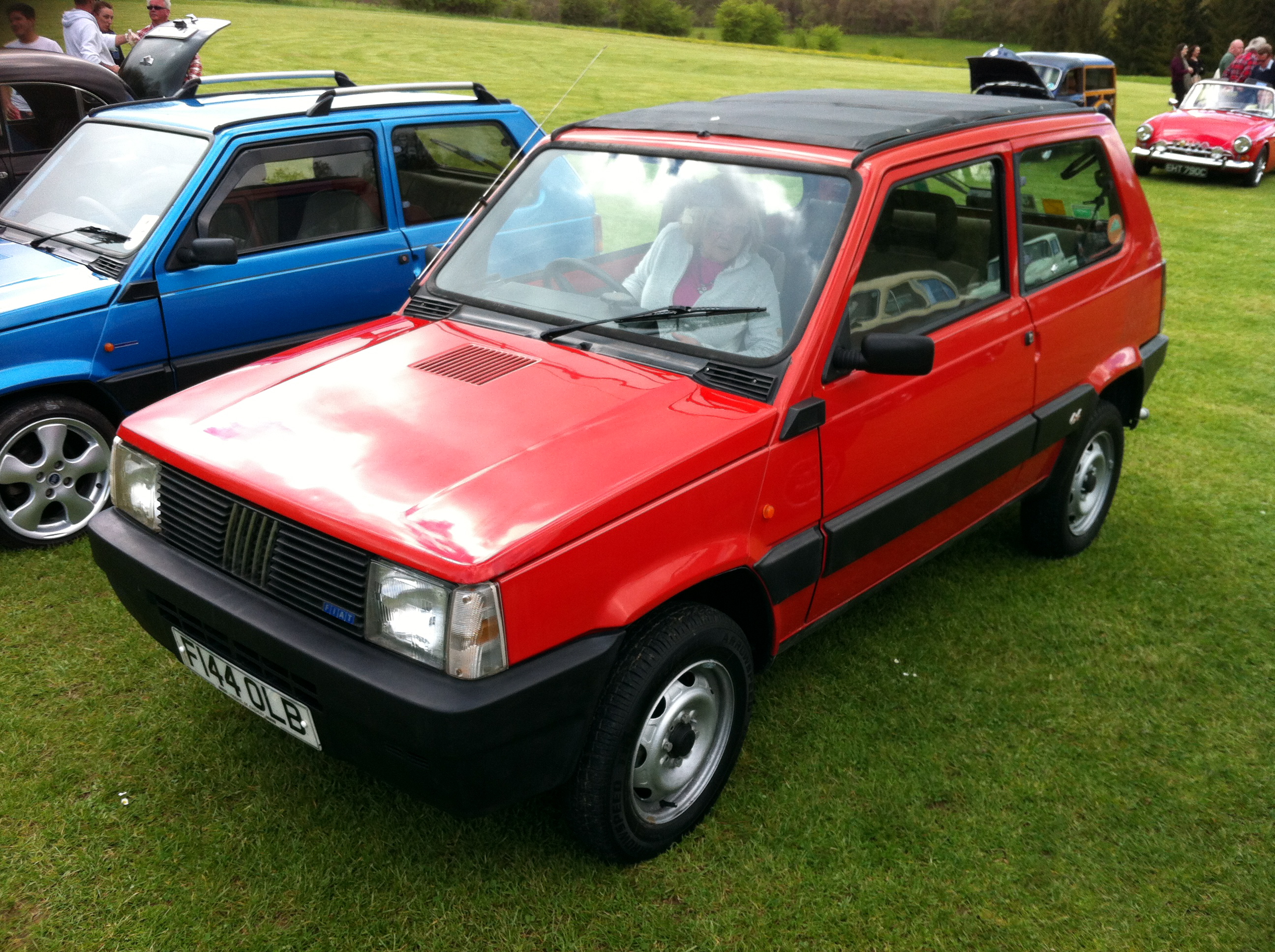

Today was probably my only chance to take him to a car show. It's a very local monthly meet and Pandas tend to go relatively unoticed but it was nice to see him there anyway......
As you can see the front bullbar and spot lights are no more, they were far too rusty to be refitted, I could probably have the bullbar repaired but the cost puts me off for now.
A new owner should be picking him up soon, and I'm sure will continue to keep us all up to date with this lovely Pandas progress.
