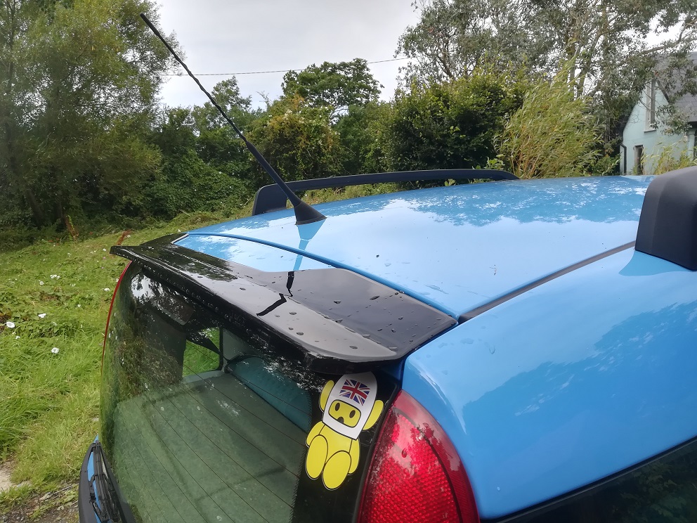

Whilst treating the rear axle, I noticed the outer skin of the exhaust back box had rusted away, so wire-brushed and painted it black, and thought it looked a bit odd so added a chrome tail pipe tip. I never thought would ever do such a thing, but so many cars have them now that I don't think it looks so daft as I would have thought 10 years or so ago. Finally, I couldn't resist the urge to try the junior rally look with some decals. This is my first Italian car, and I've long wanted an excuse for a Magneti Marelli sticker! I wonder if their ignition will be more reliable than the Lucas & SEV Marchal I grew up with?;)

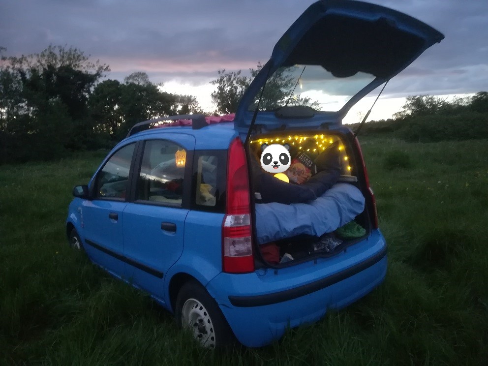

We've used our Panda to go camping by removing the rear seats completely, folding the front seats flat and plonking an air-mattress on top. It was, er, cosy! I did sound the horn with my foot in the middle of night once or twice. But it was comfortable.

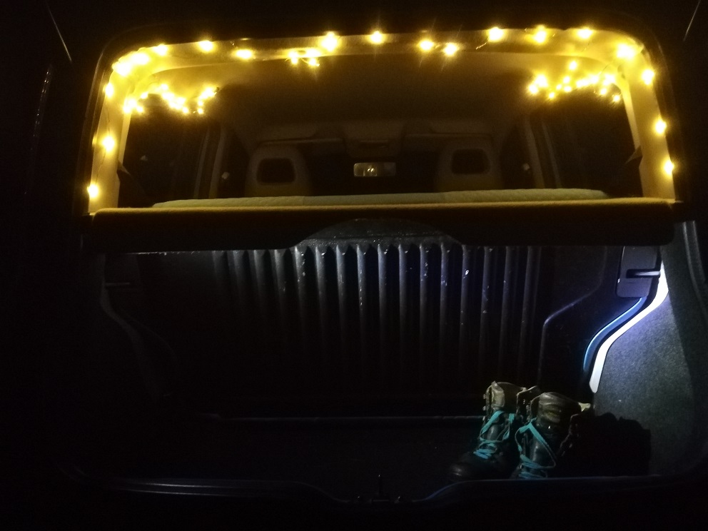

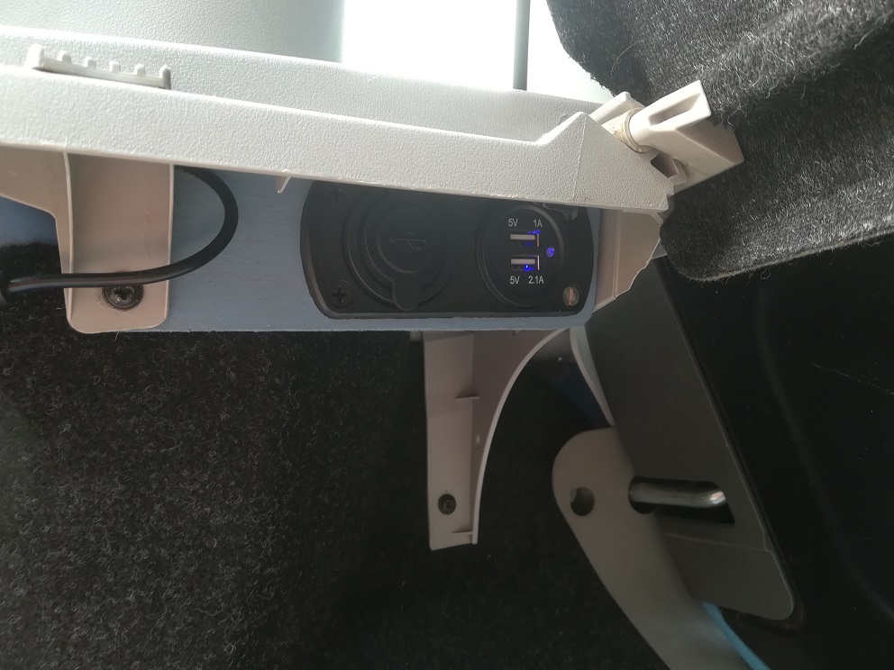

The only other conversion for camping was adding interior lights to the rear, which I did by connecting a dual USB socket to the boot light wires. Of course this only gets power when the boot is open, and even then switches off after a few minutes, so it's not much use for devices, but it does give options for USB lights to be connected to illuminate the boot.

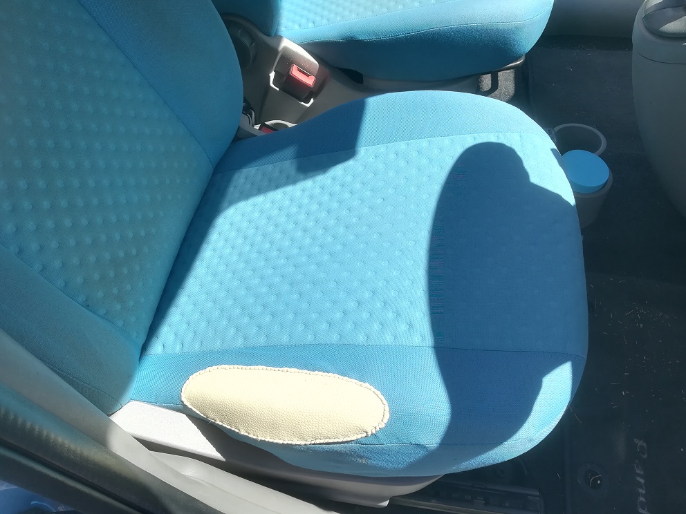

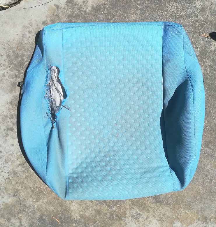

The rip in my driver's seat was getting worse, and I was worried it would soon reach the point of no return so I felt I really should clean and repair it.
As you can see not only is it filthy, there's a bad rip in the side, and there's a cat on it (no, that's not a big black stain). Before and after pic:
It's actually a bit too clean now and making the rest of the interior look dirty. Will have to do something about that.
Step 1: Remove cat. Difficulty level: very.

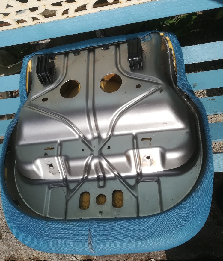

Step 2: Remove seat base. Difficulty level: not. Two bolts and the seat base comes out. This is going to be easy!
Step 3: Remove cover from cushion. Difficulty level: yes. Maybe someone knows the correct method, I prised the black plastic clips out with a screwdriver and some swearing. I damaged all of them, but they didn't break and went back in OK.
Step 4: Trim frayed material, neaten up hole with my best* blanket stitch and bung in the washing machine.
Step 5: Cut patch and stitch in place. Difficulty level: at this point I thought it's best to get a replacement seat from a breakers instead. Still, this piece of attractive ivory leather will hopefully be harder wearing than the upholstery fabric.

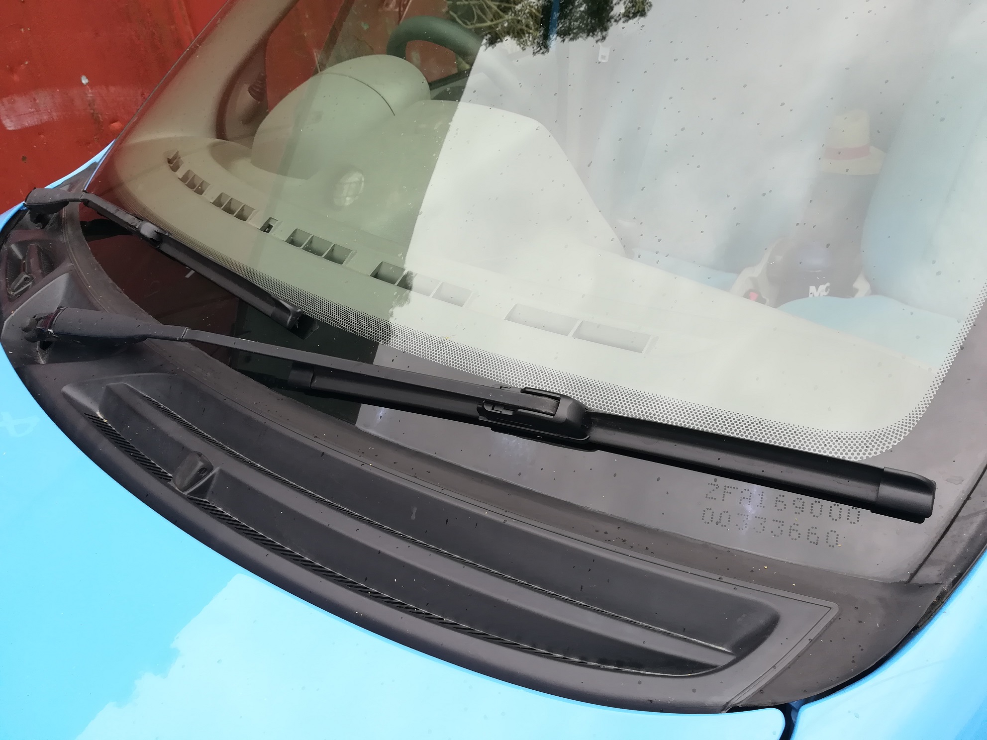

Now I'm living by the coast I'm keeping a closer eye on potential rust areas (sump pan, coolant pipe, springs & shocks, rear axle, brakes, rear sills)
The first victim was the windscreen wiper arms which rusted heroically quickly. I needed new wipers anyway, so instead of looking at rusting orange blobs I thought I'd go for aero wipers - less likely to rust I figure.
One of the many joys of living in remote rural Ireland is lack of parts - our local motor factors haven't been able to get any of the parts I've needed so far.
Delivery from the UK was prohibitively expensive, so I decided to get some cheap Chinese copies from AliExpress. 22" & 16" for about £5 delivered... https://www.aliexpress.com/item/32804926695.html?spm=a2g0s.9042311.0.0.3e664c4db9Moq7
...except of course they're for LHD cars, and so they're upside-down:eek:
So I've ended up with more of a Gurney flap. Still technically 'aero' I suppose...

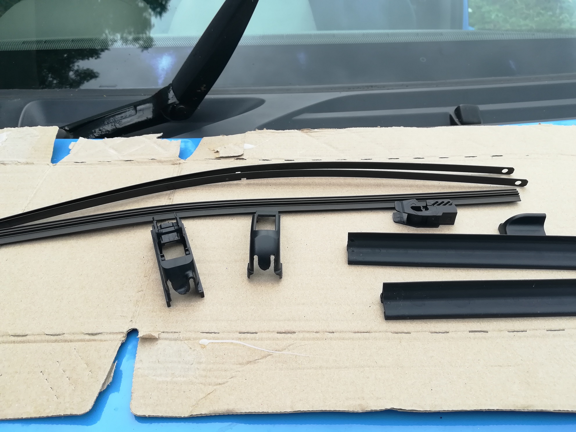

For Bosch, I think you can swap the mountings and fairing around to switch between LHD & RHD.
So I carefully stripped, swapped & reassembled... and ended up exactly where I'd started:spin:
The slots in the mounting determine that the fairings can only be installed one way, so out with the junior hacksaw for some new slots.
Fixed! You can hardly tell the difference if you don't look at it:eek:
