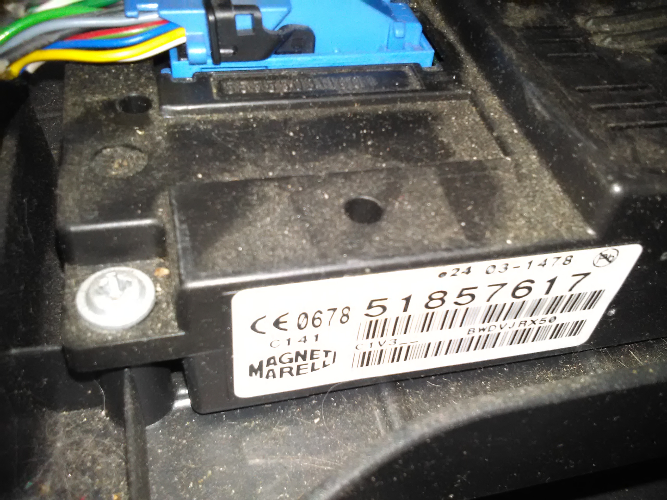

My B&M is Gen 1 (still trying to establish if dead) and have been told these cannot be fixed. In the event of replacing, can I use a Gen 2 in a Qubo (2010) or do I need a Gen 1?
Pic of serial nos. on mine attached...

2010 was just on the cusp of changeover from Gen 1 to Gen 2 blue and me modules and I have had to deal with both modules in vehicles 2010 and 2011 even 2012 in respect of campers.....it appears the point of factory line manuafacture is most relevant rather than a registration date or sale date.
I really only get involved in the module updates for installing TomToms to some of the cars and campers that had the useless MagnetiMarelliMAP sat nav so predominantly deal with gen 2 modules.....I have never attempted changing over the module in a vehicle from gen1 to gen2 or even know if the harness connector is even compatible so it is something I would avoid....
I have removed gen 1 and gen 2 modules mainly to check the connections when presented with a dead blue me system and went further on following the internal clean up too of connections and been successful in getting the module working again so not sure why anyone would state they cannot be repaired......
Revtronic is a company who do module repairs so you can google them and I believeupfrontwav has some leads from ebay who does a no fix no fee repair.........to do a full function repair process you would need a test bed mule to prove full functionality which i do not have but sometimes the connections cleaned up is all that was needed.....replacing the circuit boards can be an option but installing faulty microchips is just too difficult as pins are so small.

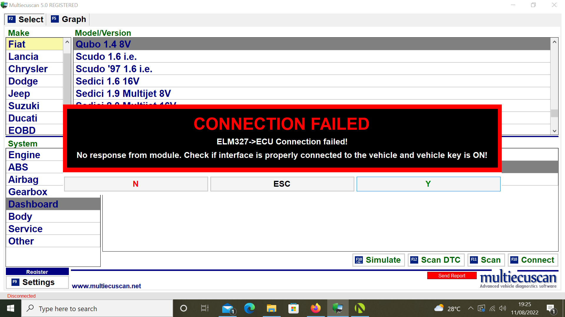

Bought MES from Gendan + Red and Yellow cable. Ran a scan, cleared errors then performed Proxy Alignment (Report3 attached). Mileage stopped flashing but no B&M.
Tried to connect to B&M module and got error attached (B&M_Error).
How do I connect via the flash drive?

To connect to the BM module to see what level software it is or extract the BMConf file from the module you place a few files (special from blueandme.net web) onto a USB flash drive place this in the cars USB and it extracts the contents of the configuration in a file back onto the USB which can be analysed or uploaded to the BMwebsite to get later files for updating.......
Gen1 modules couls only be updated to V5.6 but Gen2 modules were able to go to the last available V10......it is V10 that is required to run a TomTom2 which is why i have to update the cars......
I doubt if the BM module if it is faulty you will get a response but is always the first thing i would do to check there is a communication link especially on Gen 2 modules as it displays your vehicles unique BDAddress code to read write to.
I you want to try it though I can send you the files and process
