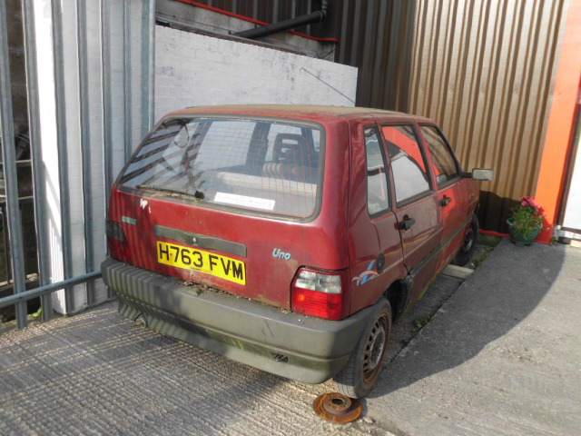

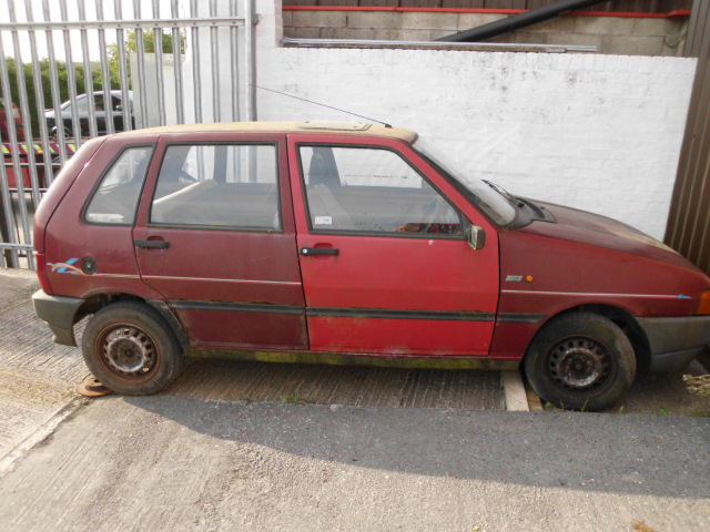

My latest fiat addition to the family !
I dont know if this is savable or not yet until I get the time to have a good look at it , its been stood outside a closed down Fiat garage since 2008 when it was parked up because the clutch was slipping.

It was stood at the side of a Fiat dealership that closed down many years ago and I remember the mechanic who owned the garage driving round in it years ago, he parked it up as the clutch was slipping and never got round to fixing it , I have kept driving past it for years looking at it so eventually I got someone who knew the owner to go round and knock on the door and ask if he wanted to sell it, apparently other people have tried to buy this car but he was not willing to sell it at the time but as its now been stood since 2008 I guess he thought it was time to get rid , I paid £200 for it.

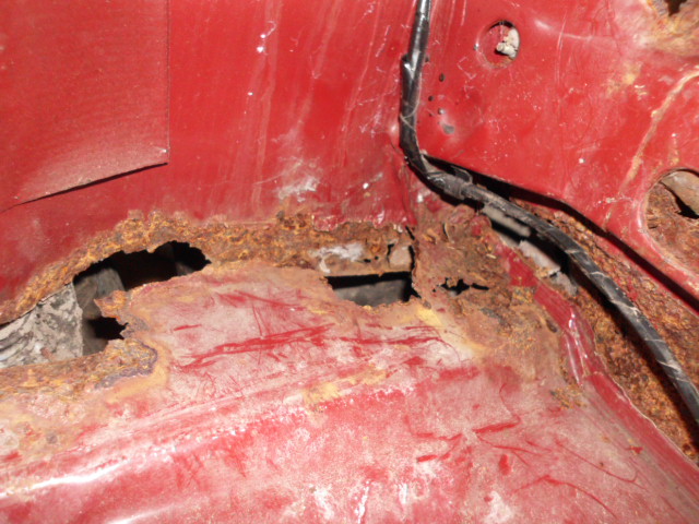

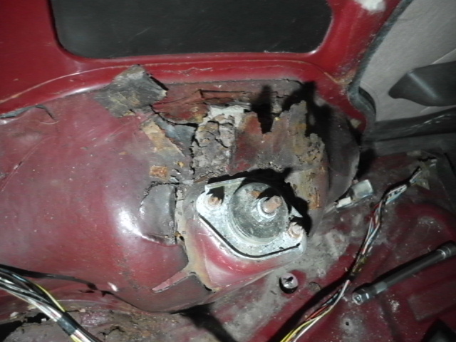

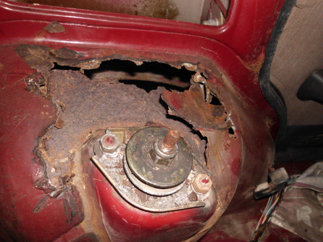

Decided to have a look in the boot first, took out carpet, seats, seatbelts , found a bit of surface rust around the shock absorber top mounts and the boot floor !
Dont know if this is saveable or not but I am going to have a good go , Im not a welder but I do have a gas mig and done a little bit of mig welding before but this is going to be good practice and test my skills to the limit !
I have seen other people restore cars as bad as this so watch this space .

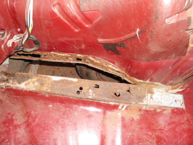

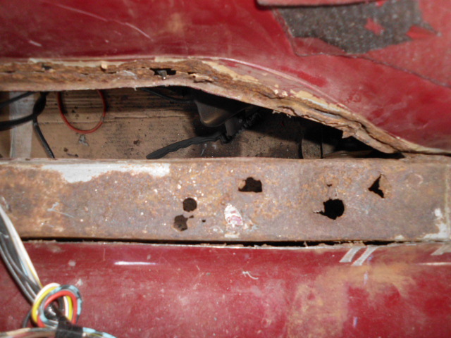

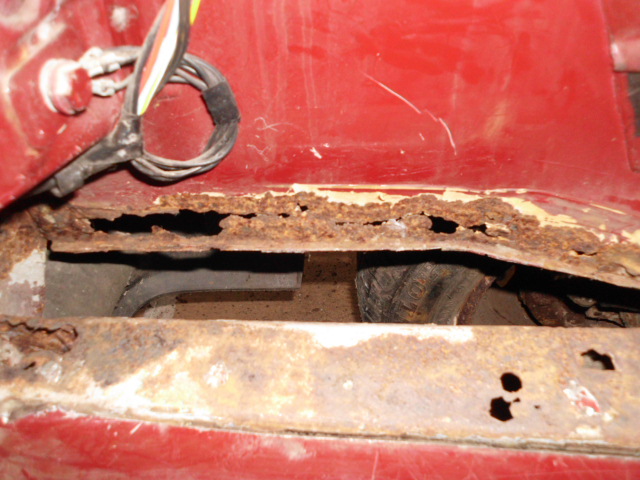

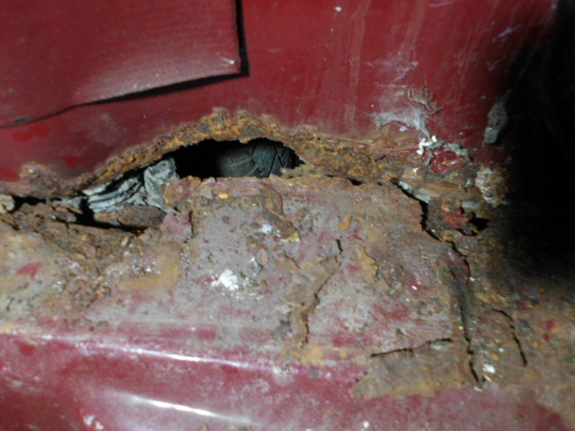

Boot floor one passenger side cut out ready for welding,wheel arch needs a piece welding in as well, the bit underneath is the boot floor strengthening beam which also need attention. need to get the bumper off now for better underneath access.

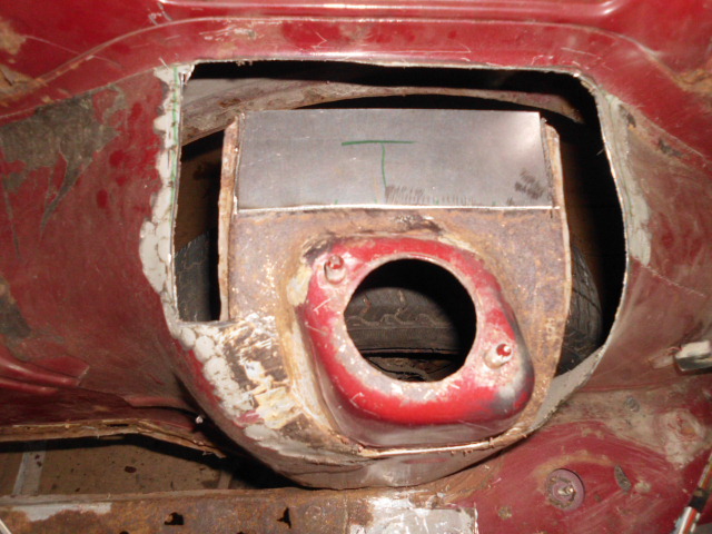

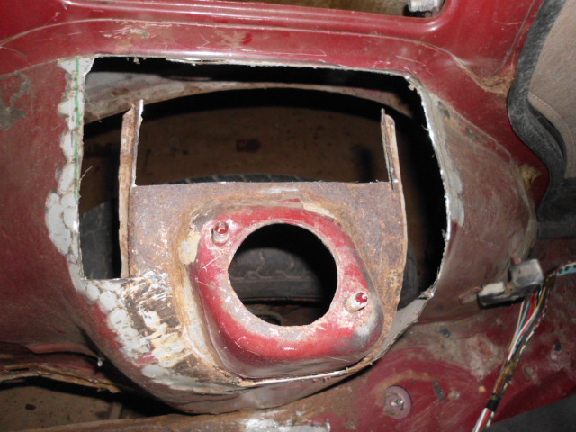

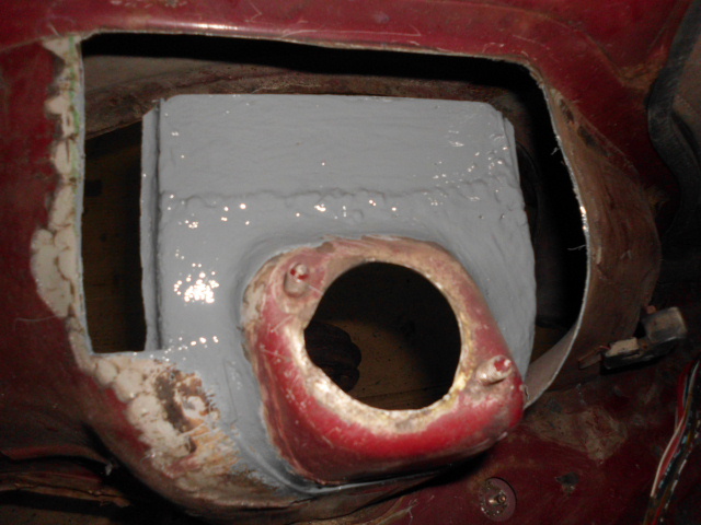

cut out the rusty bit of the suspension turret to get better access to the strut strengthening beam, the rear arch and strengthener are available as an aftermarket part for £109 but I thought better to put to use all the tips I have picked on wheeler dealers and have a go at repairing the old bits !
new part made ready to weld into the top of the strengthener beam, perfect tit, then get all the surrounding rust dissolved with rust remover, paint with weld through primer and then make a top for the wheelarch.

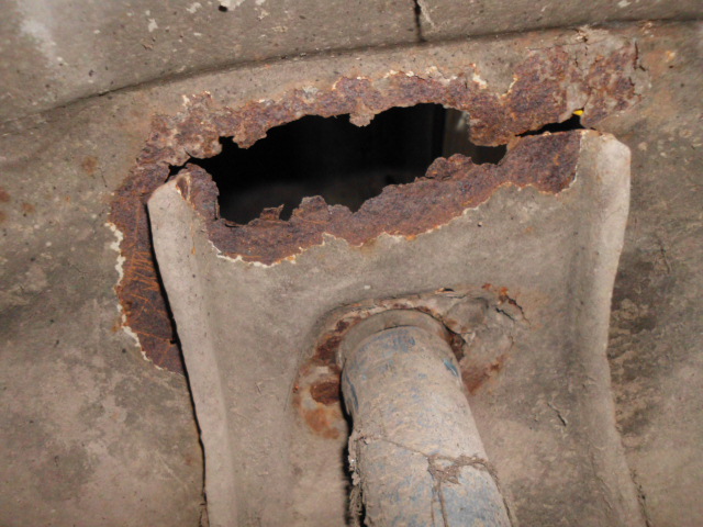

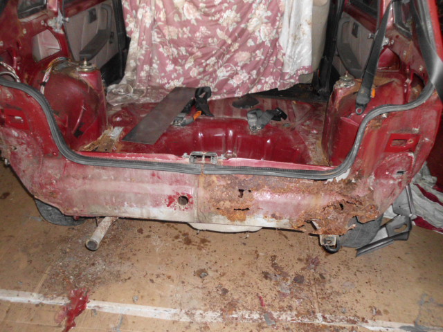

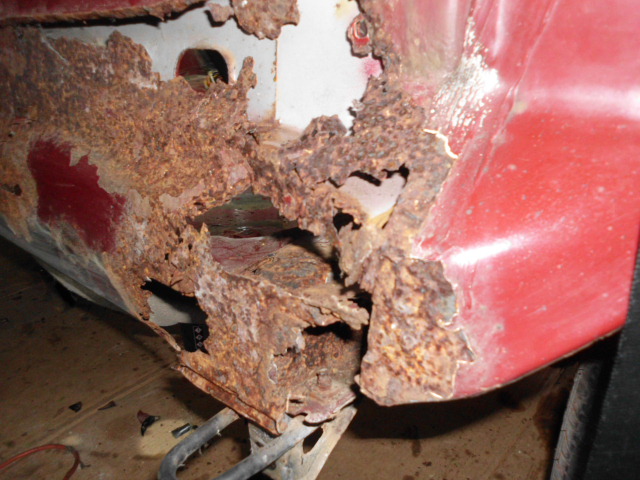

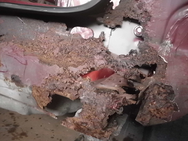

Got the rear bumper off , oh dear, found a bit more rust, I think that because the car had been sitting for 9 years facing down hill water has accumulated around the rear bumper, surprisingly enough though the rear valance in made in 2 half's and the left hand side is perfect.

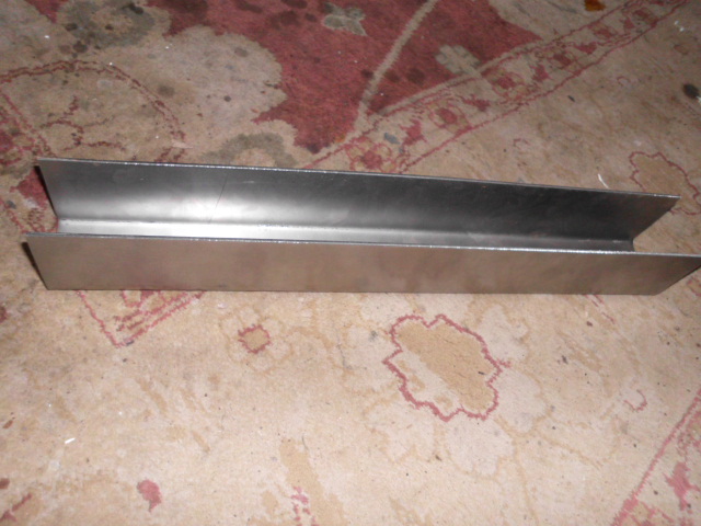

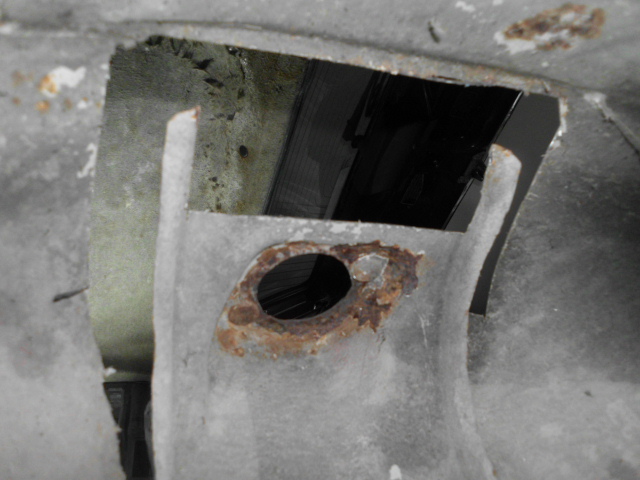

New part welded in, just got to make a top for the turret now, boot floor cut out reveals boot floor strengthening beams have also rusted right the way through, 2 x new ones fabricated in 2.5mm mild steel, thats the advantage of having a fabrication/metalworking workshop just down the road from me I can get parts made up to order!
