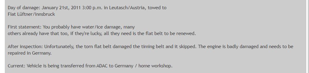

In this 2011 thread entitled 'Water, ice, timing belt, engine damage' from wohnmobilforum.de Fiat contributed 90% towards the repair:
This is the description of the original damage in the thread linked from the thread above. There are other examples in both threads dating back to 2006.
So Fiat do know about it and have contributed towards repairs in the past.
