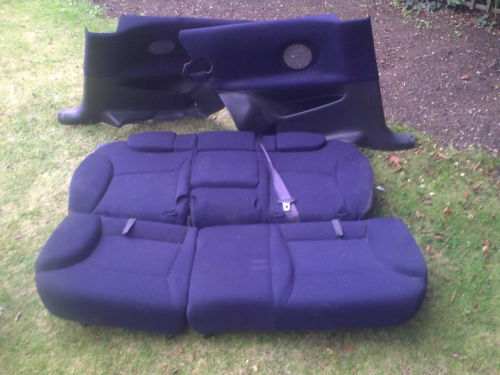

i've go 2 photos below regarding the fitment of the rear seats, and whether its a straight swap or not. the blue cloth one is the stilo and the black one is the 147. what do you all think? they look pretty close to me? although i think the split folding part seems to be the other way around? :confused:

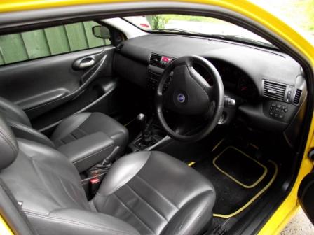

hi im very interested in this thread as tan leather would look awesome in my red stilo. anyway just sent an email to some 147 owners to see if they could send me some dimensions and pics of attachments on the rear seats see what they come back with fingers crossed
I brought some 147 sport seats lastnight. From looking at the runners it doesn't appear that they are completely the same. As one of the back blots on the seat is at a different angle to the ones in the stilo. The other three just bolt down intothe floor which look the same on both.
My next thought is whether the runners can be swapped from the standard seats to the alfa seats?
If you pull it off would you do a guide as my seats are haggard and I love the alfa ones! Also are you doing fronts only? I might just retrim the rears.
would be gd to know bout the rears as theres a set on ebay im looking at just lot of money to spend if they dont fit. i know some people have done the fronts on here before should be able to swap the runners over i did it before on my m8's punto with subaru sti seats anything can be made to fit (y)
