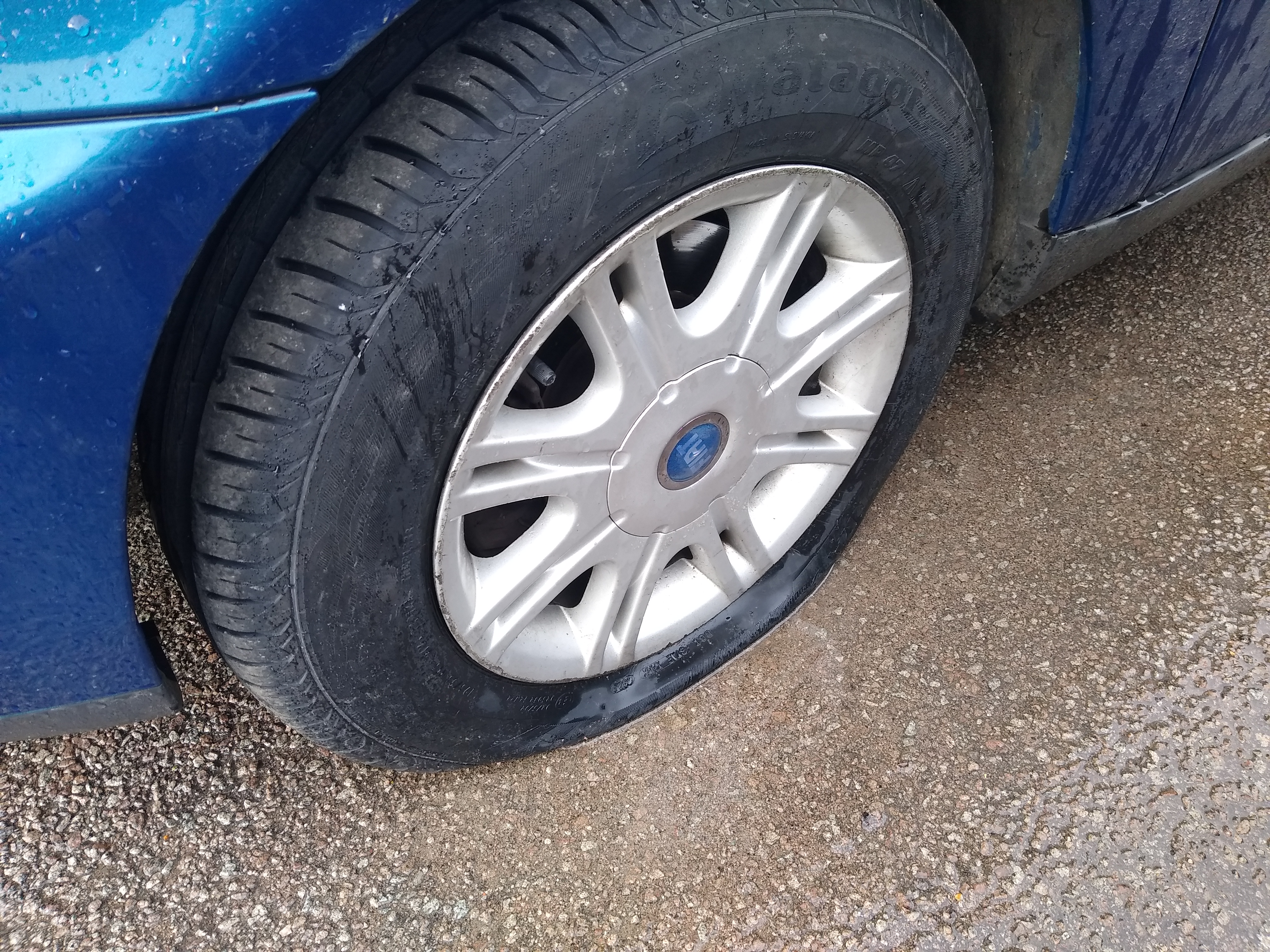

Having gone outside to wash Glopsy this morning I noticed that the OSF tyre looked a bit soft but on closer inspection the tyre was badly worn on its inside edge.

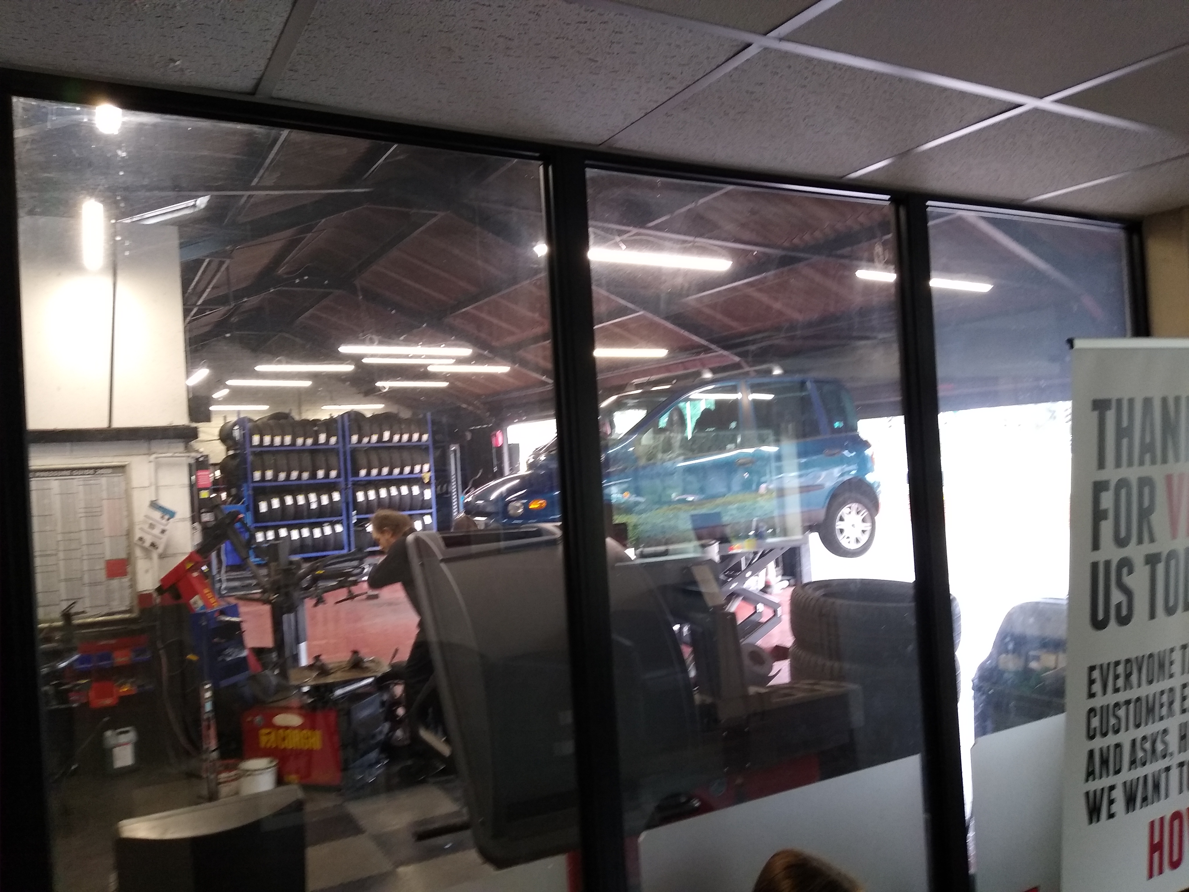

Quick call to my local tyre place, and they had a couple of my size in and if I could get there asap they'd fit me in.

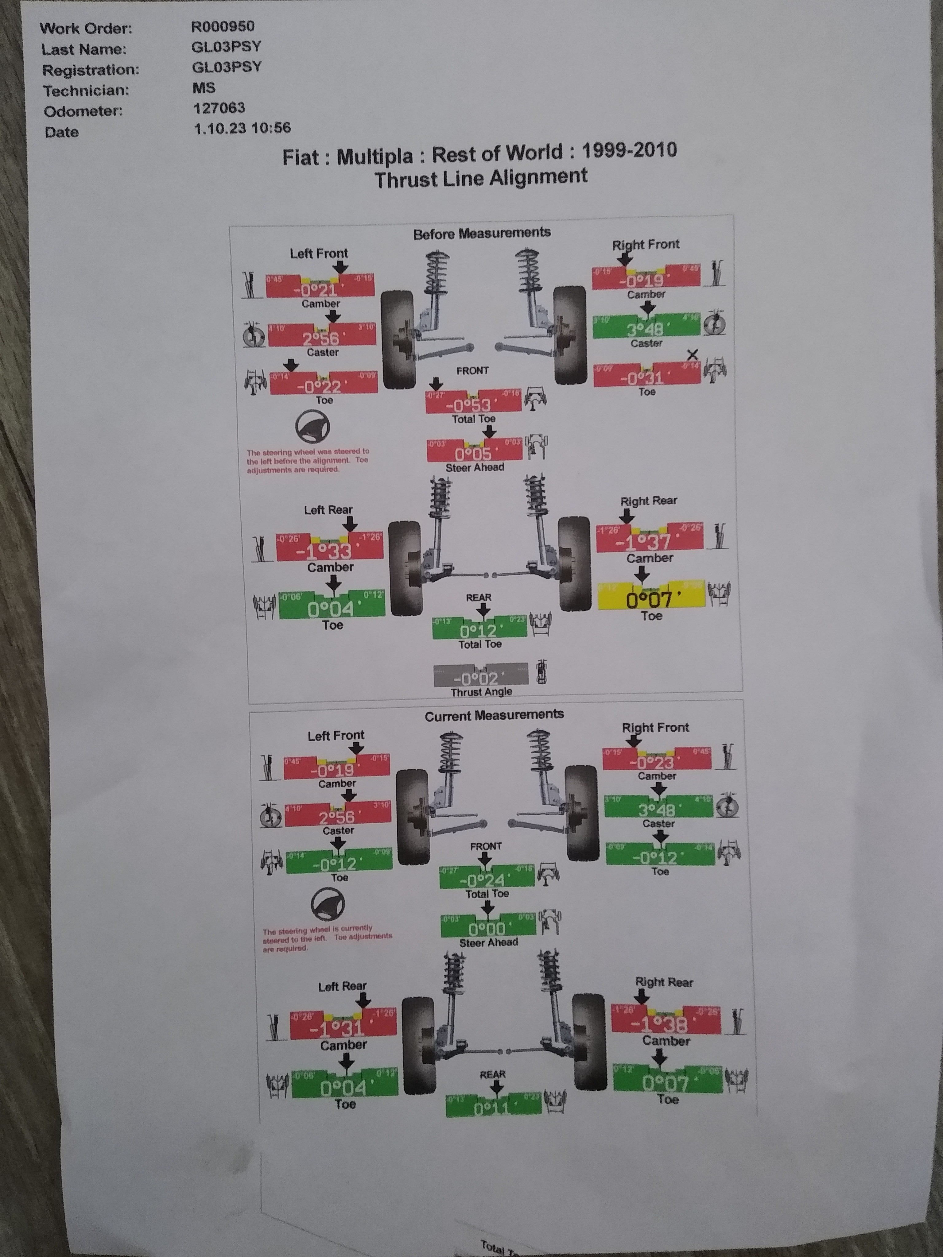

The cause of the wear was quite apparent when they checked the tracking, but all is where it should be now.

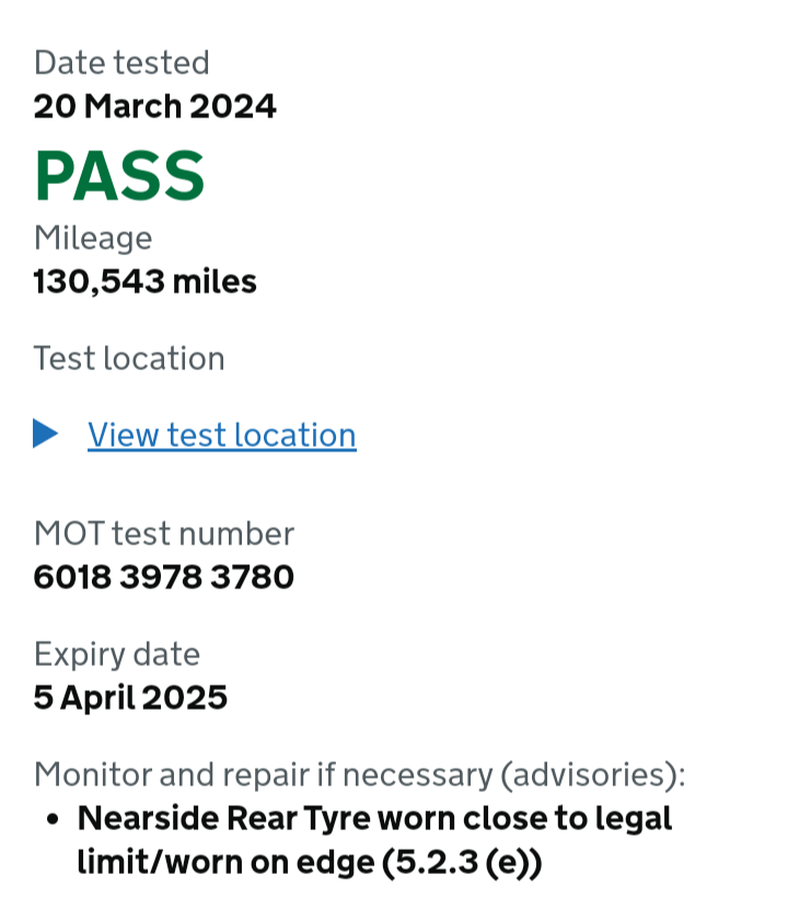

They did advise on the rears being a few thousand miles left and my front brakes will also need attention soon, which is already on my list of things to do.

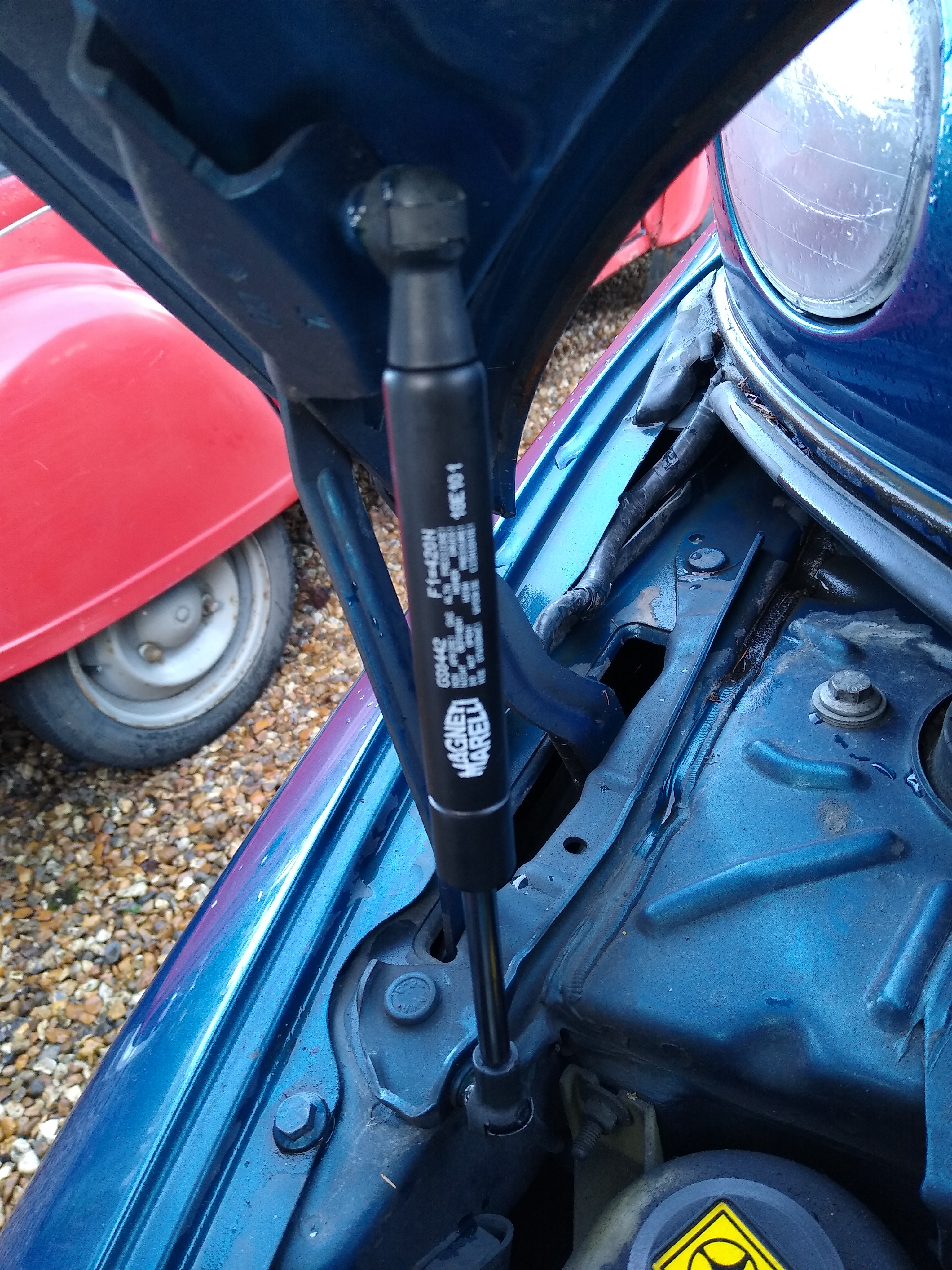

Another little job ticked off today, replacing the bonnet struts,as I had got bored of taking my life in my hands every time I opened it.
Straight forward job,which should've taken 10 minutes,but actually took 30,as one of the sprung clips pinged off onto a gravel drive!

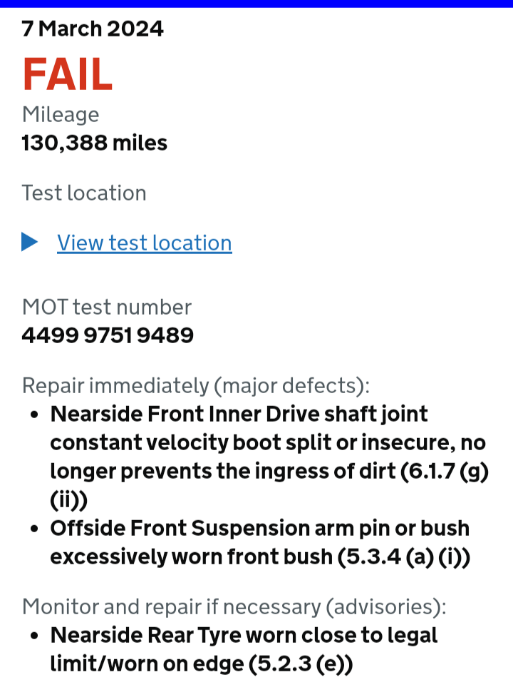

Hi,
Not bad at all.
I found getting the drive shafts off a little painful....one option is to leave inner cv attached, strip the outer cv off , slide new boot along shaft and refit outer cv.
I have the inner tripode type cv joints.

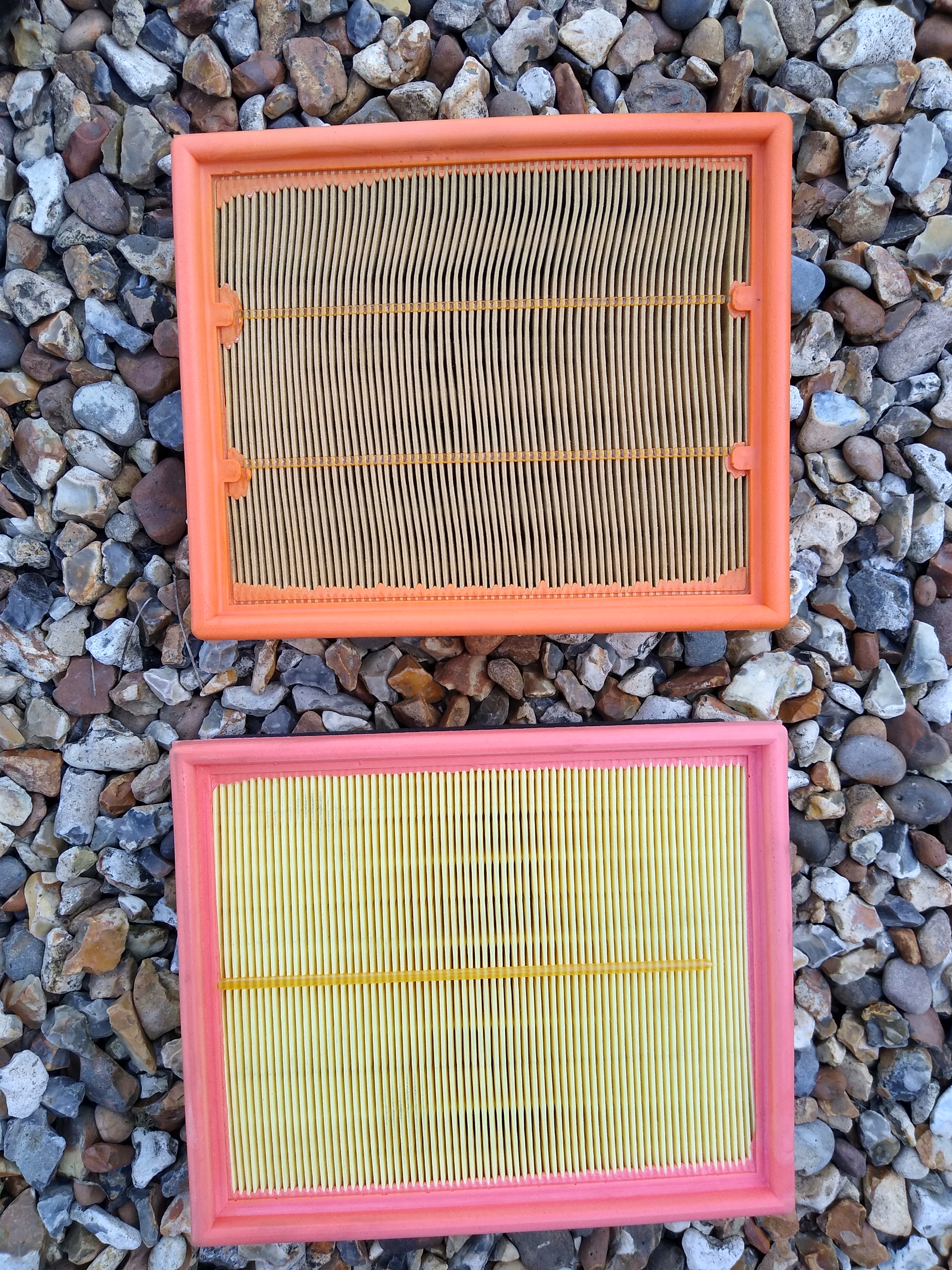

Well, as the sun has finally come out I can crack on with a service.
Only had a few minutes free today though, so just changed the air and pollen filters.
