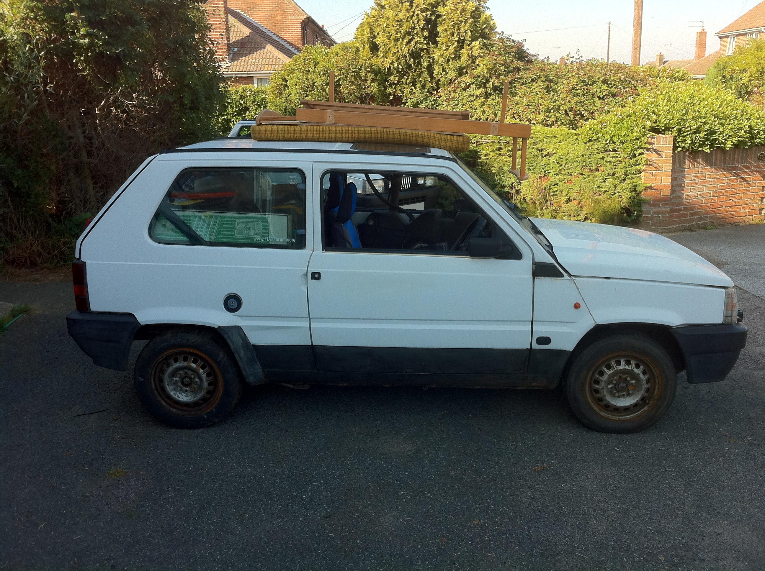

So today, I thought I'd start with the bodywork. Badly faded and oxidised paint, to the point where I though all was lost andgreen growth down one side of the car due to nearly 4 years worth of attack from the elements, but with a good wash, I could already see lots of room for improvement Next came the Clay Bar, doing it bit by bit, followed closely by T-Cut, again bit by bit - took me a while to work out how best to use the stuff, but my god is it good! - and then finished off with a layer of wax.
So we started off with this
attachment.php
attachment.php
attachment.php
attachment.php
A close up of just how bad it was :eek:
attachment.php
attachment.php
The Badly faded paint, the bodged wheel arch, and a nice none faded bit from where I've removed a broken piece of wheel arch trim.
attachment.php
So I started off by hand washing the car with some B&Q Car Wash Detergent I found laying about in the outhouse, and its surprising the different it has made.
The washed section on the right, and unwashed on the left.
attachment.php
And from a different angle, you and see the cleaned section closest and the line between the two going through the reflection of the butterfly.
attachment.php
attachment.php

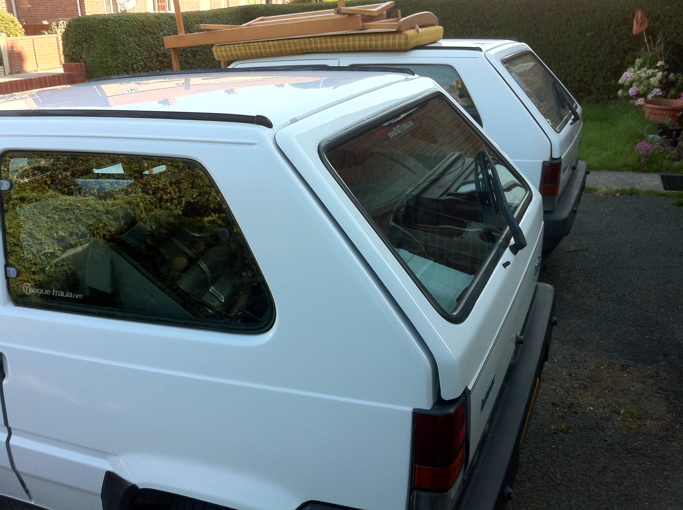

Then I started with the Claying, T-cutting and Waxing.
Here are some after shots, first the roof - Pictures don't do it justice.
attachment.php
And in comparison to the top of the boot.
attachment.php
Then I decided to do the boot - By far the worst panel on the car.
First the top section T-cut'ed
attachment.php
Then the rest T-cut'ed
attachment.php
And then the whole boot T-cut'ed and Waxed
attachment.php
A comparison with the Side of the car.
attachment.php
Then I moved onto the rear side panel.
attachment.php
Then drivers door and wing.
attachment.php

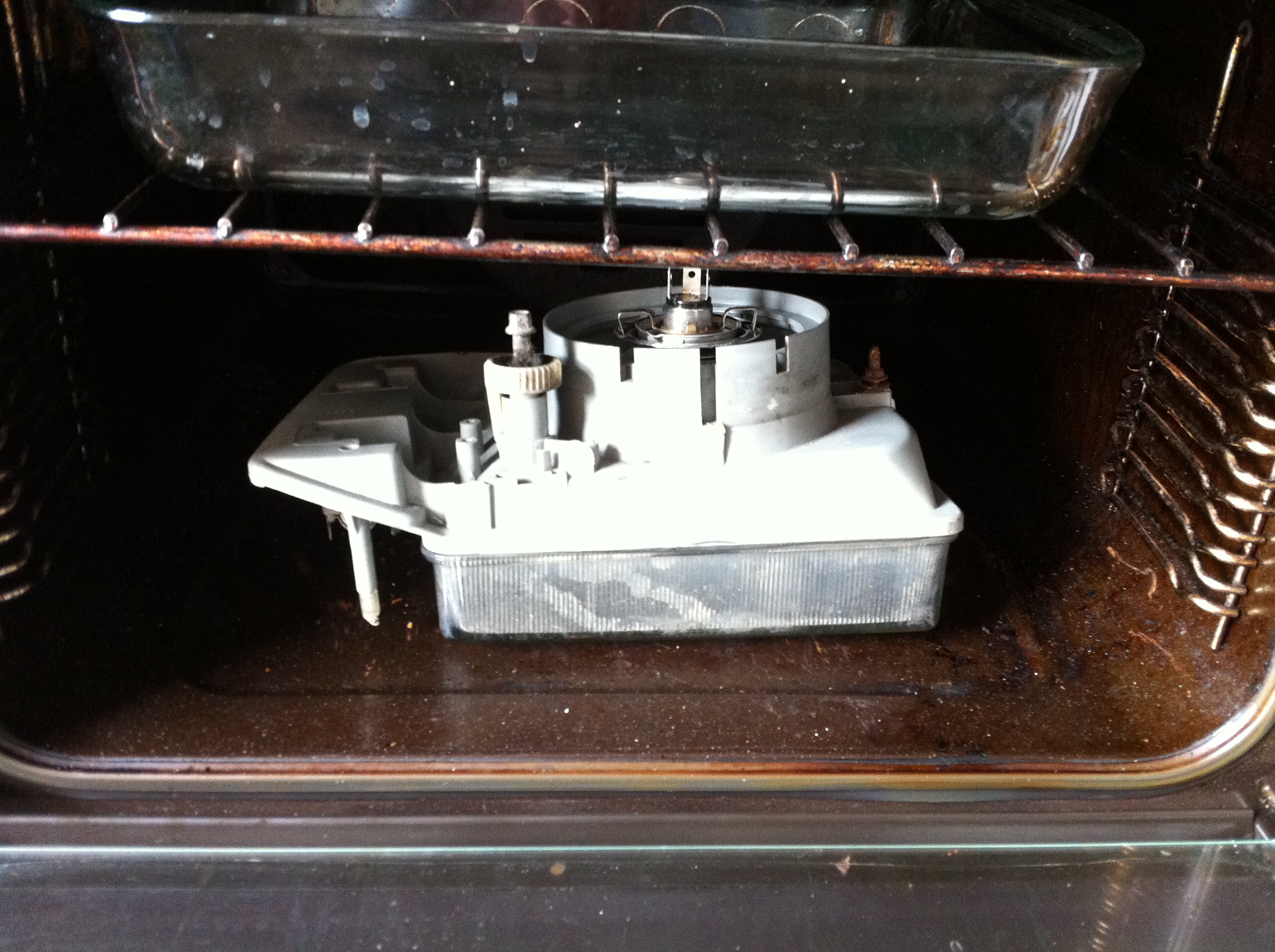

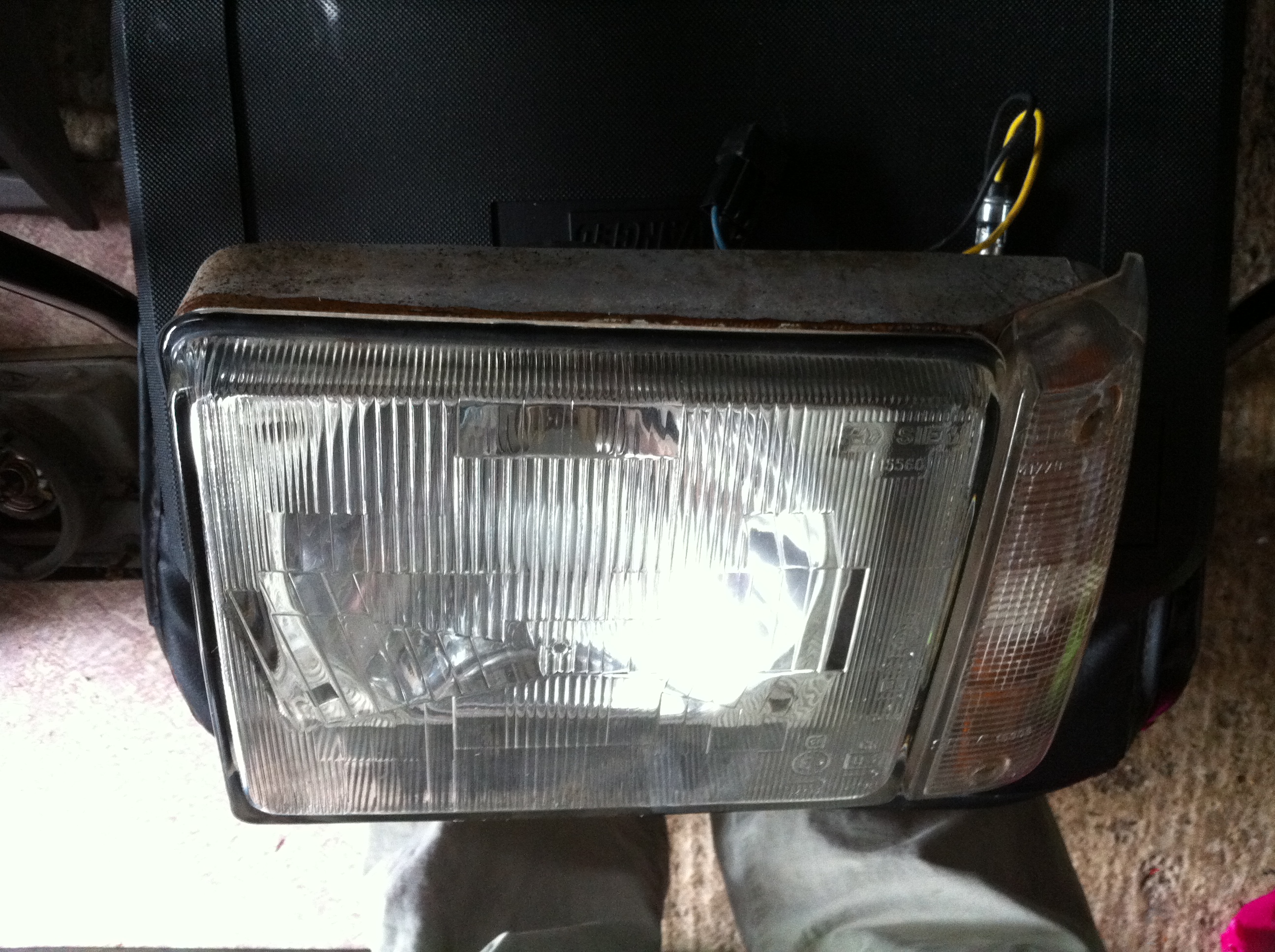

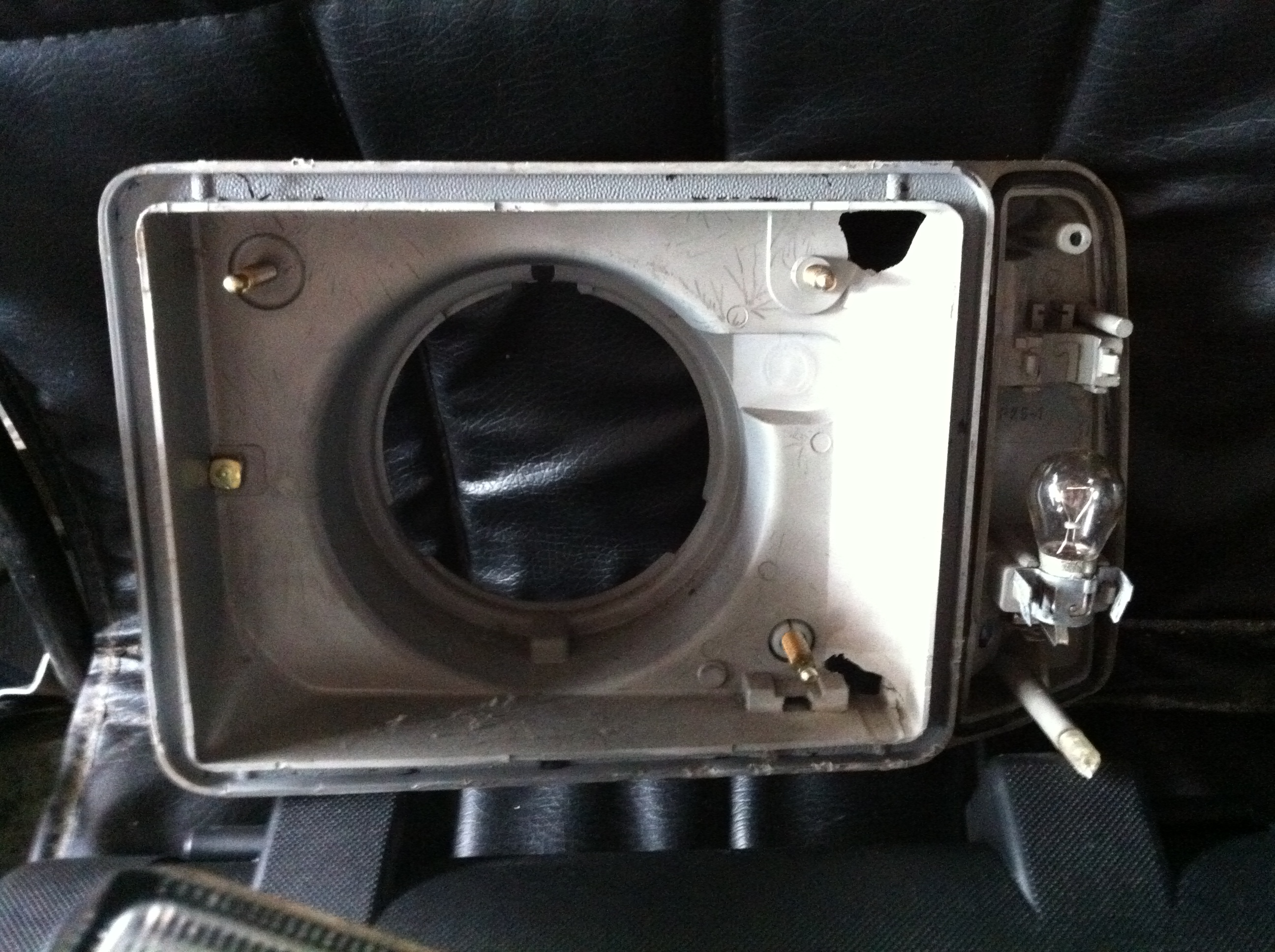

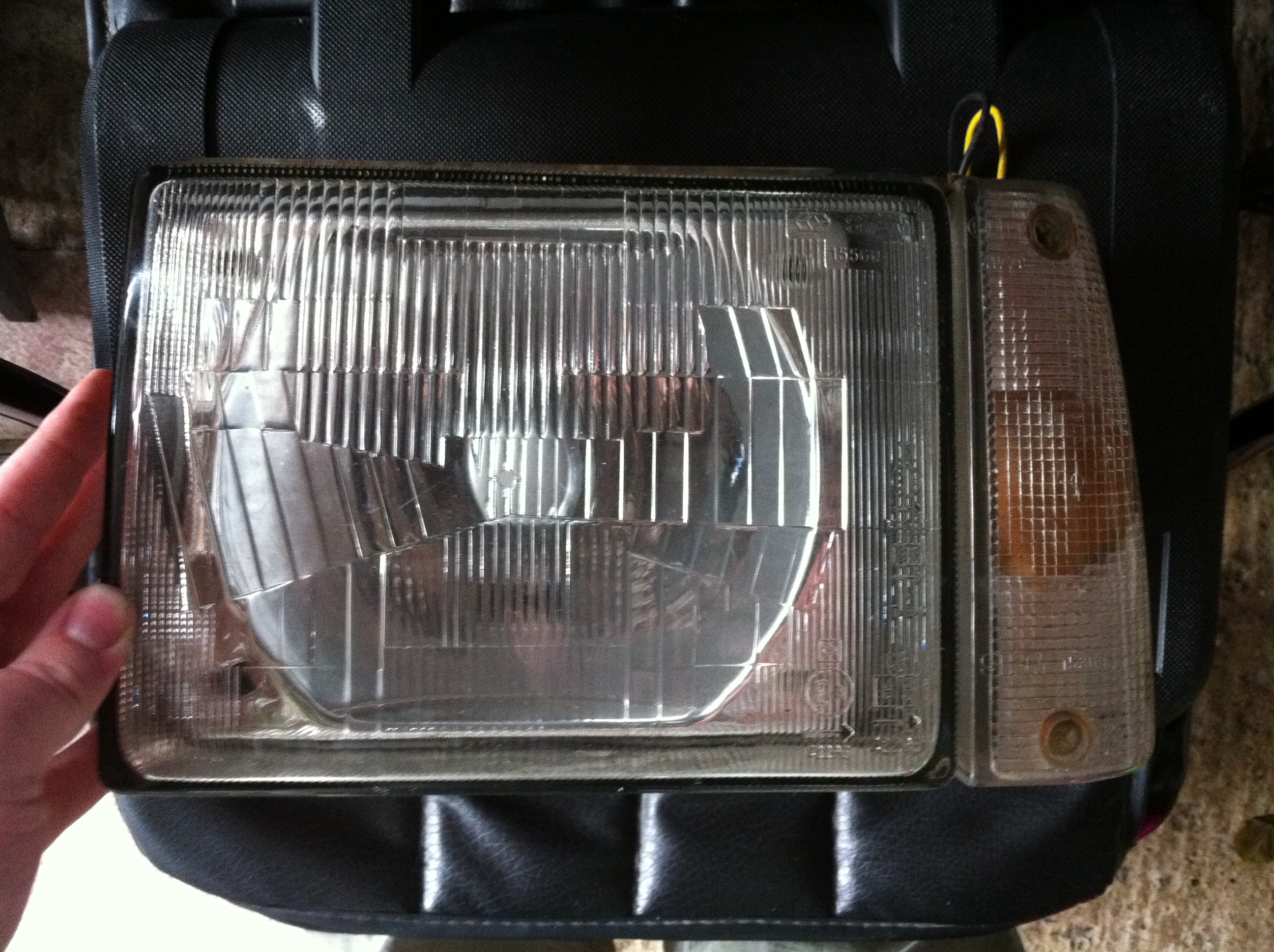

Here's some pictures of the headlight transplant I done at the end of August.

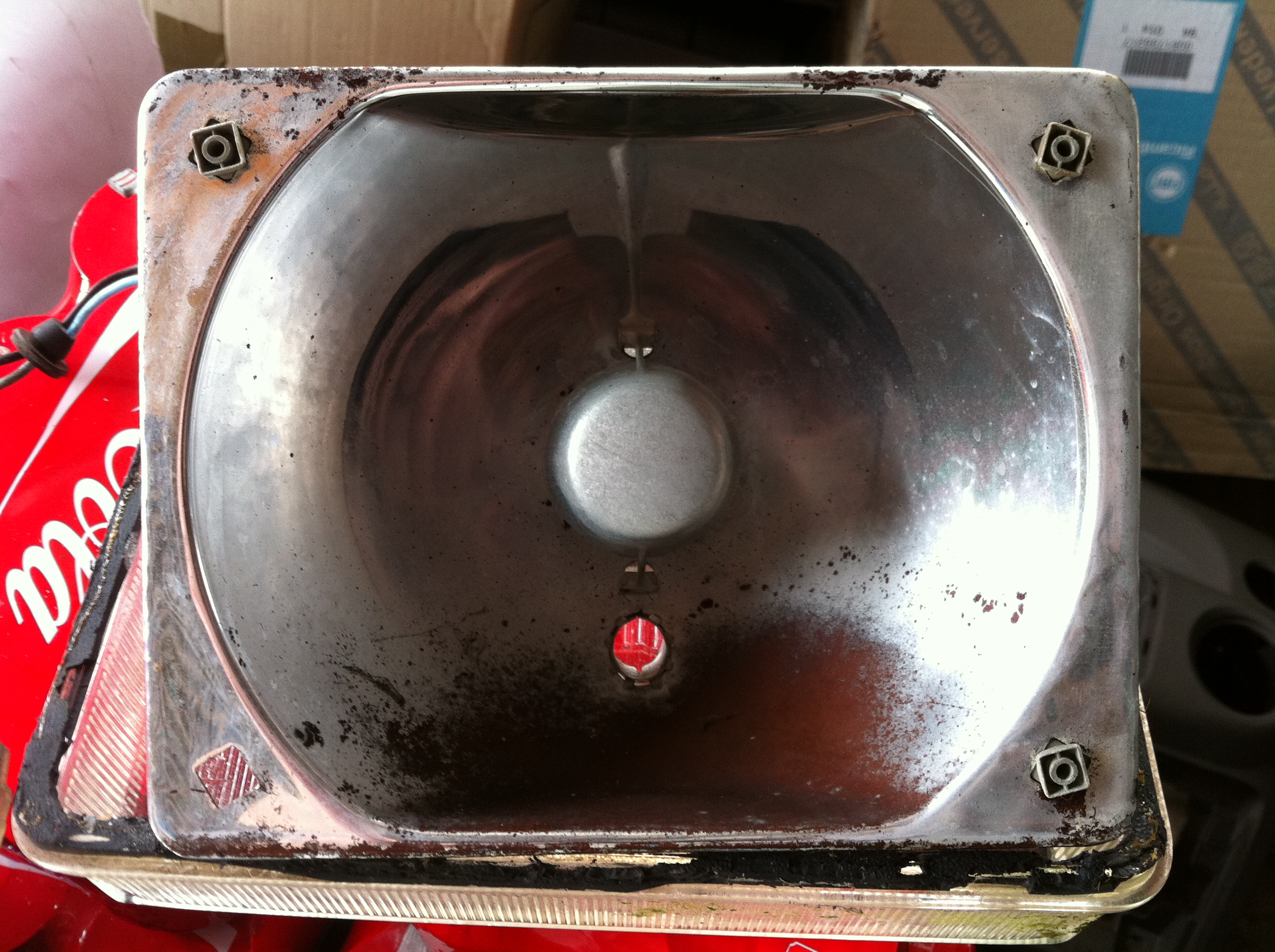

The Old Reflector
Replacement Reflector Fitted
Damaged Old Rear Casing - Donor Light Unit

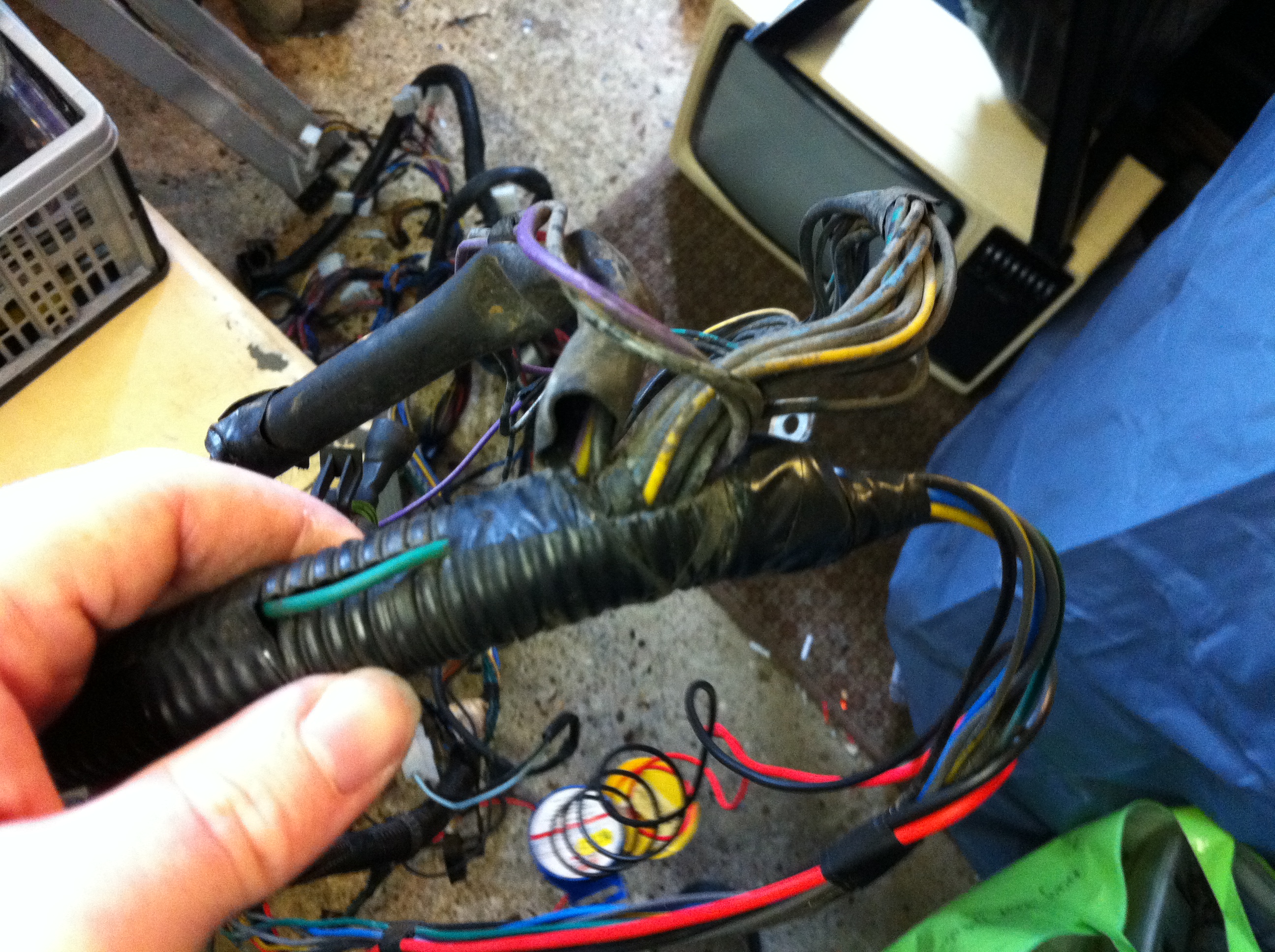

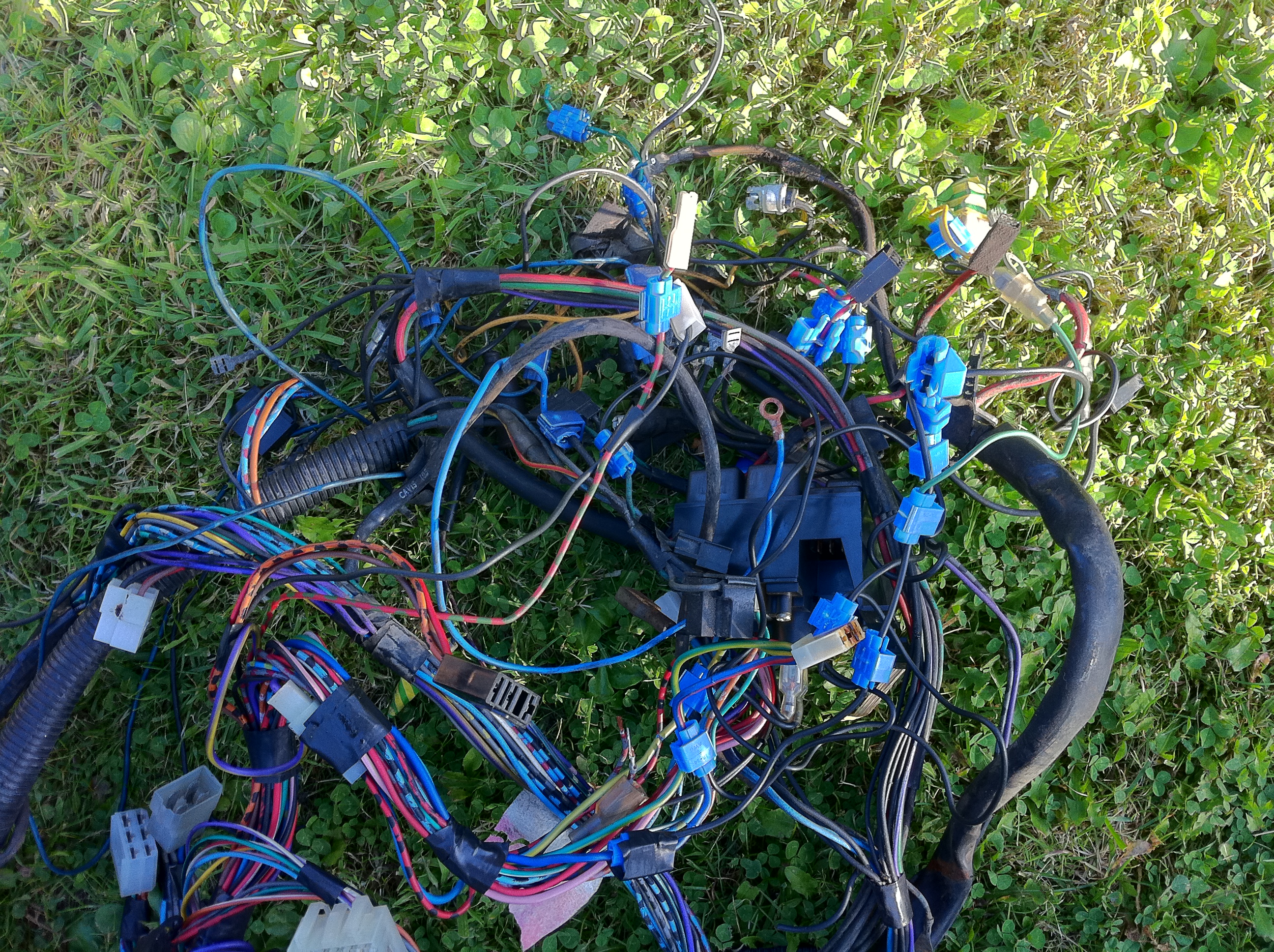

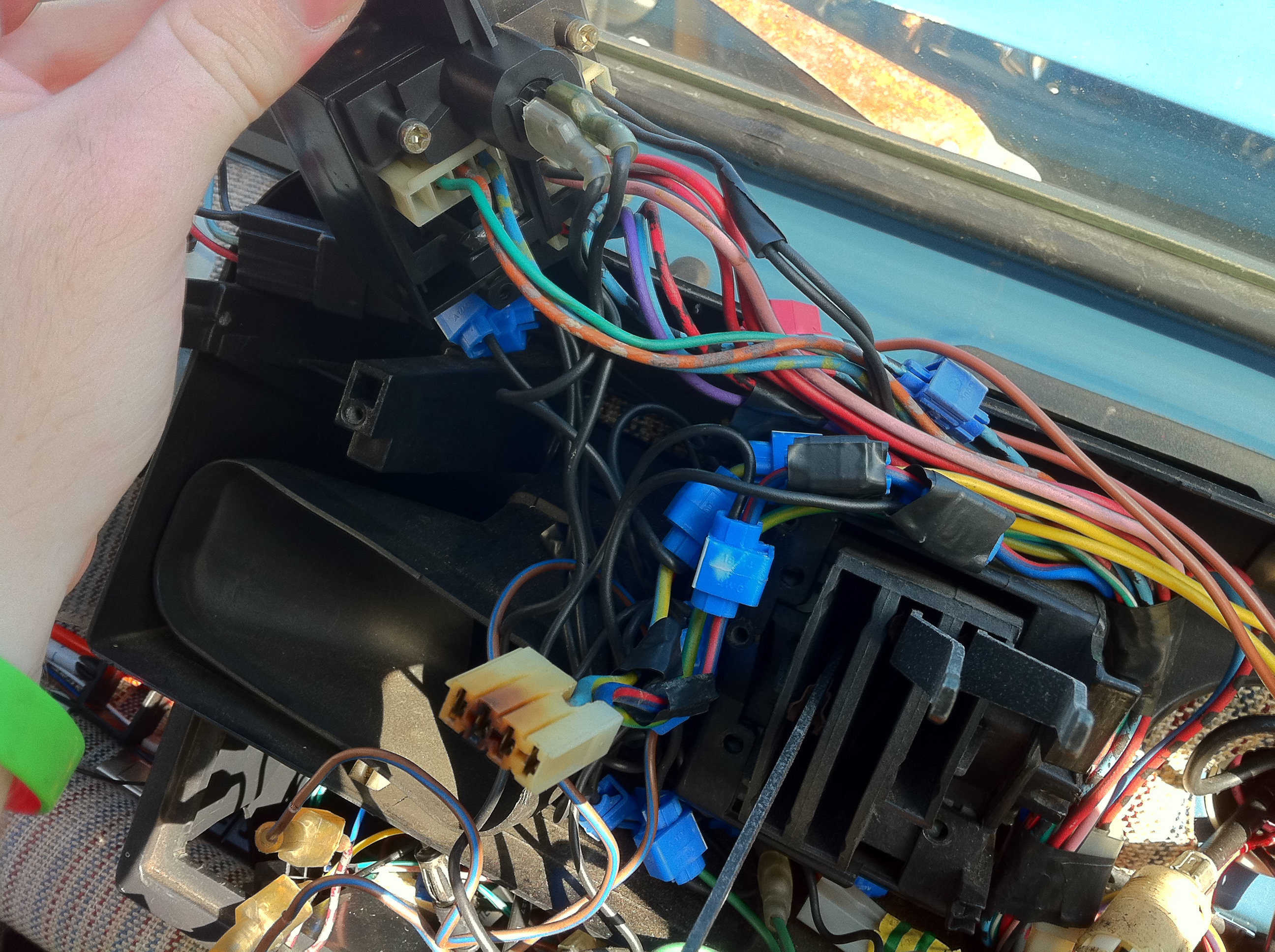

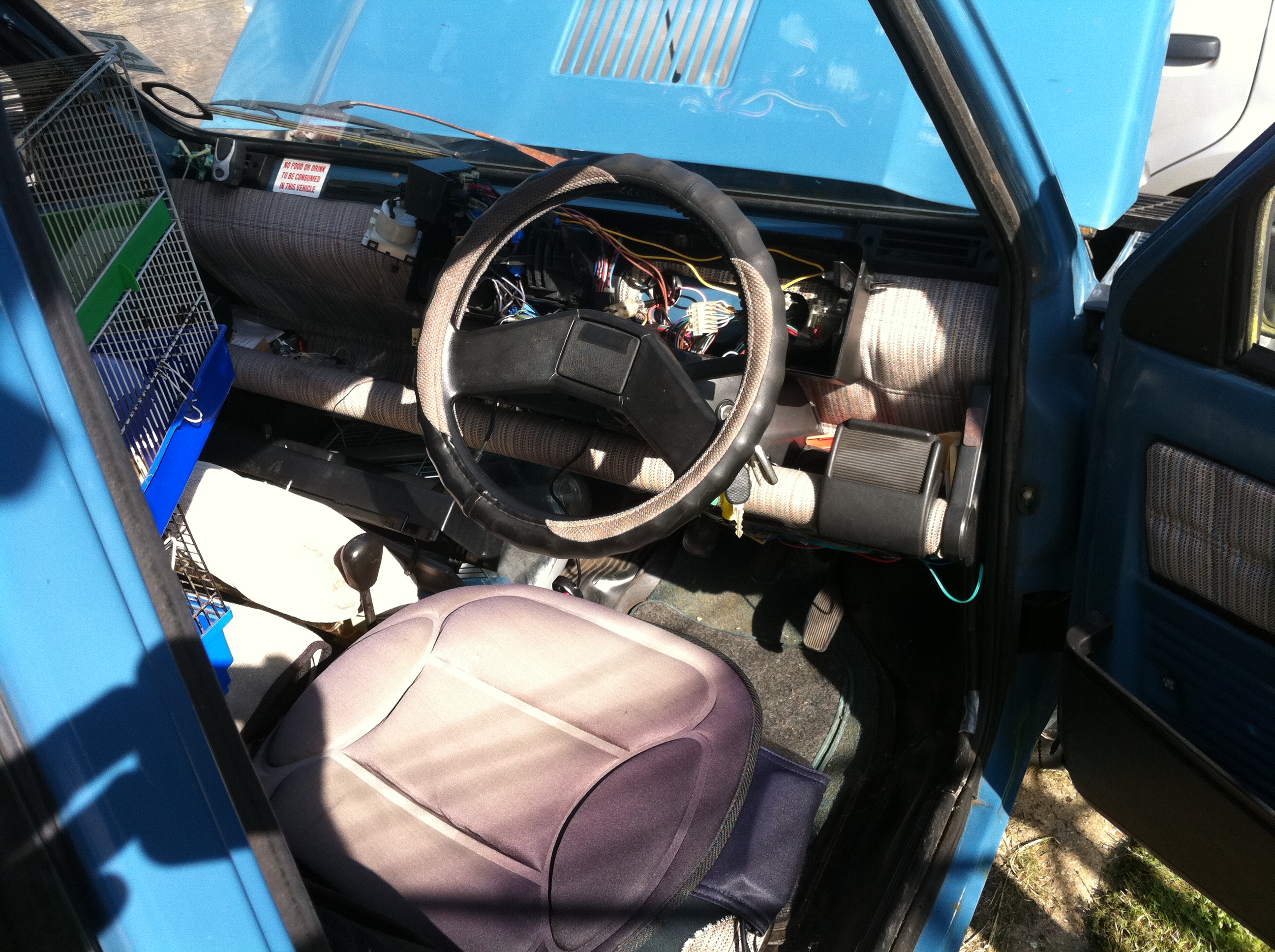

So what I've done in the last week or so is remove the engine bay wiring loom. Plan is to replace it as its been bodged and hacked so much due to earth problems etc in the past that although it all still works I'd rather tidy it up, and know exactly what I've got.

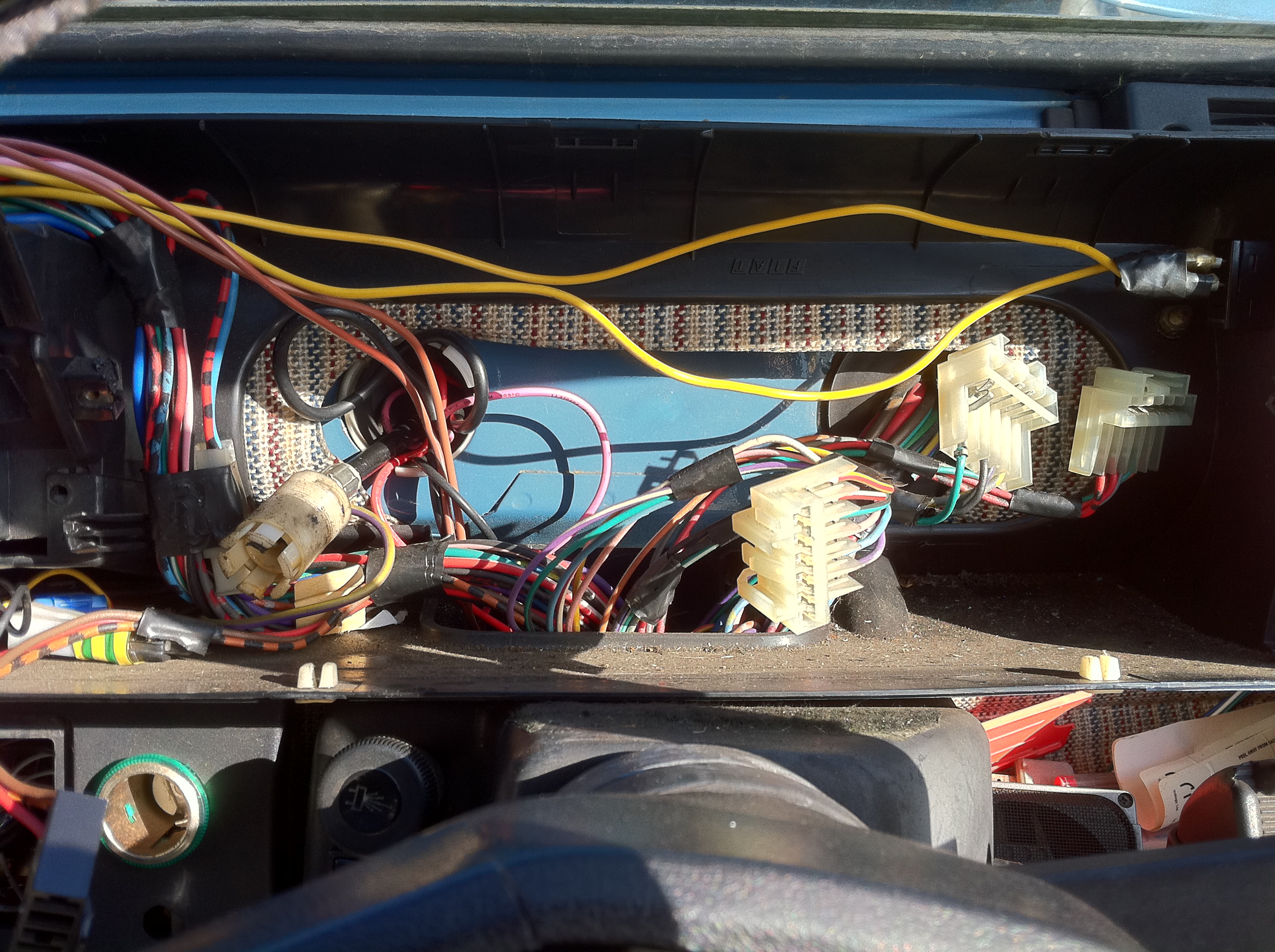

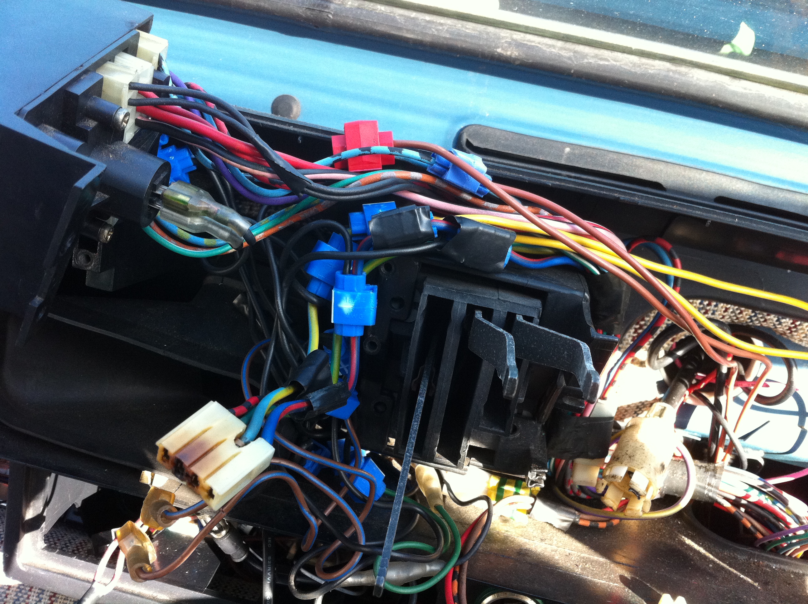

So started in the engine bay, and then removed the Dash Panel from inside the car to access the wiring that goes into it, and the Fuse board below it which all make up the main part of the cars wiring loom, incorperating the engine bay loom.
A few Skotch locks from modifications in the past

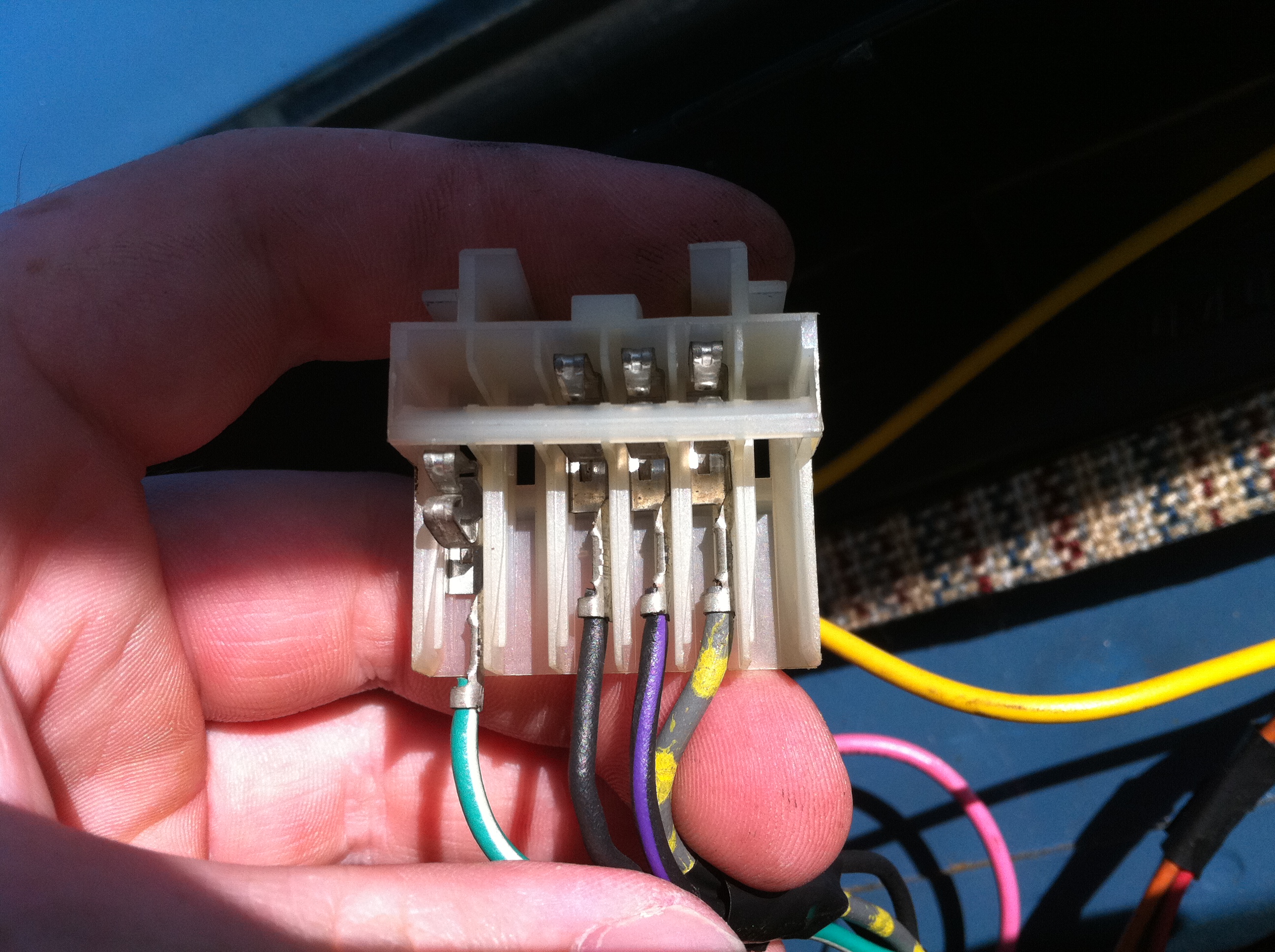

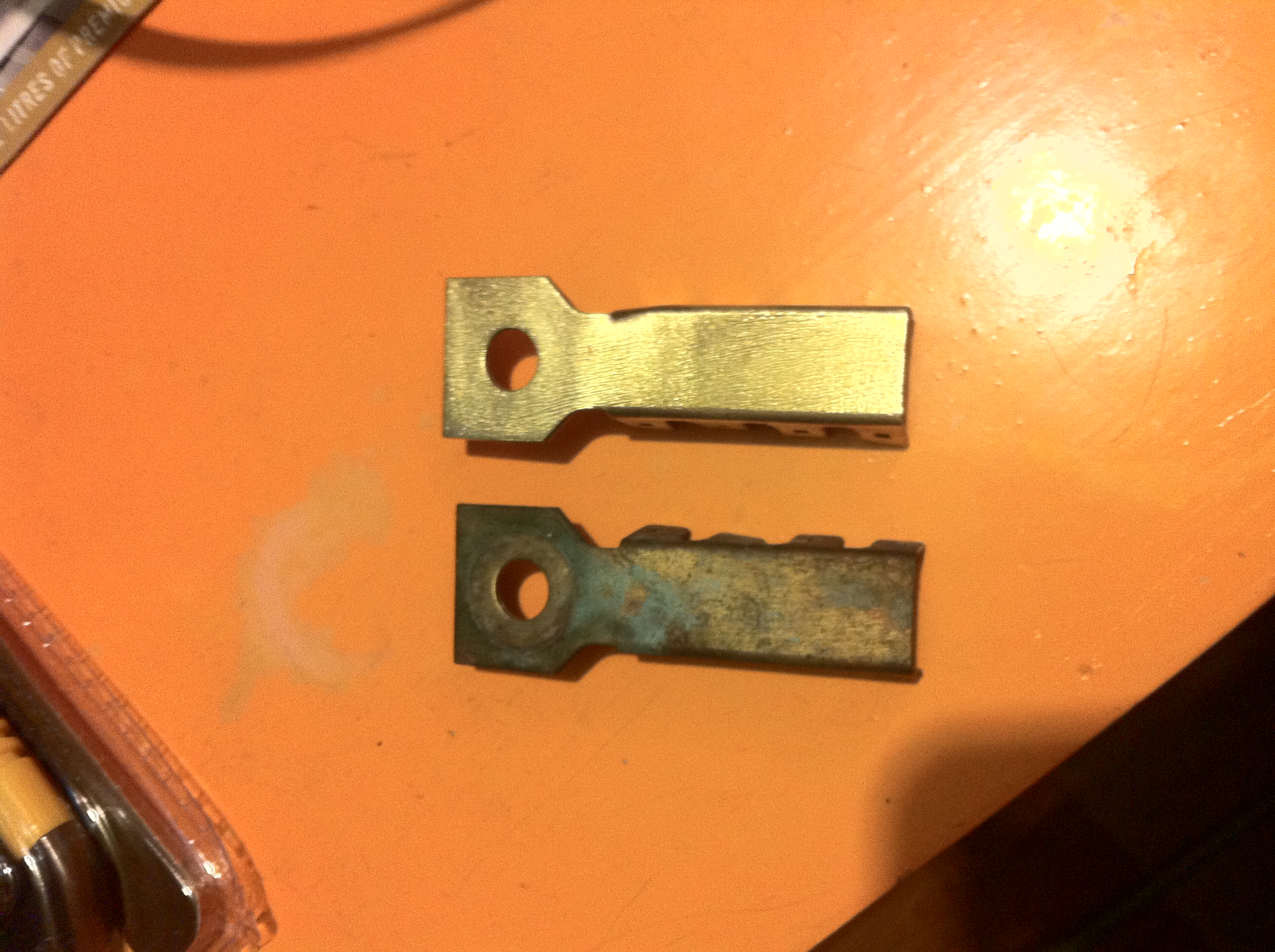

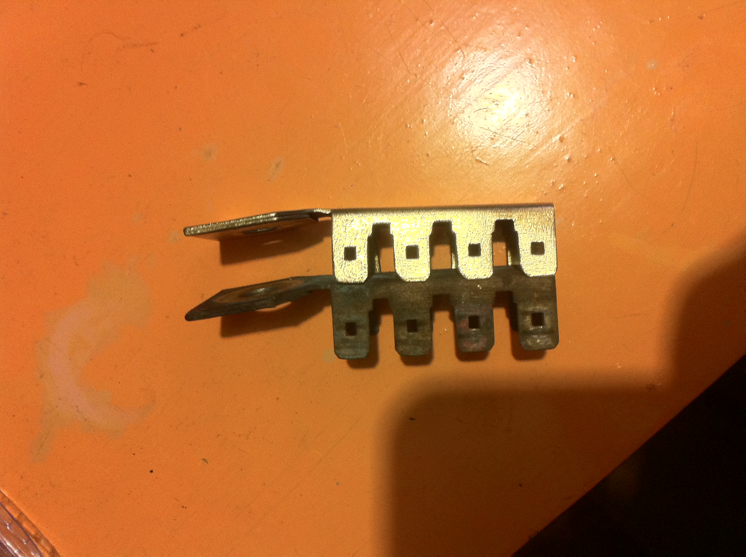

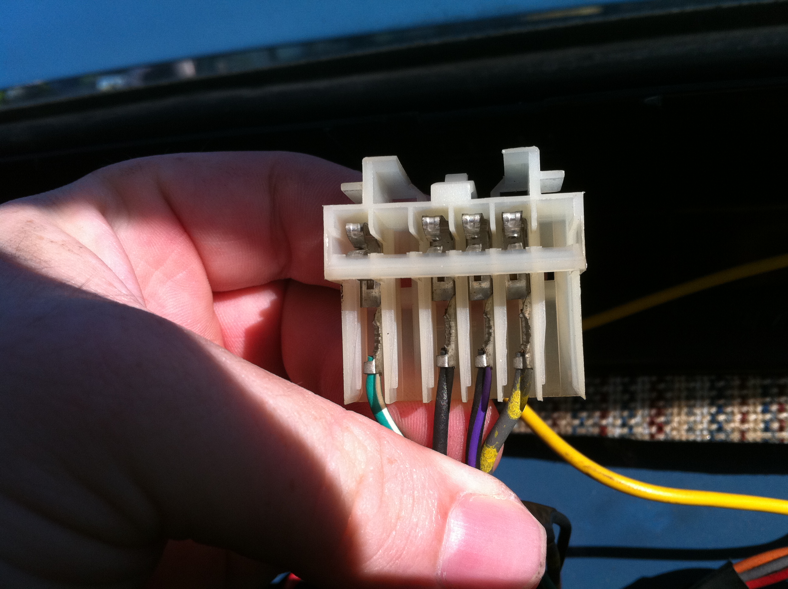

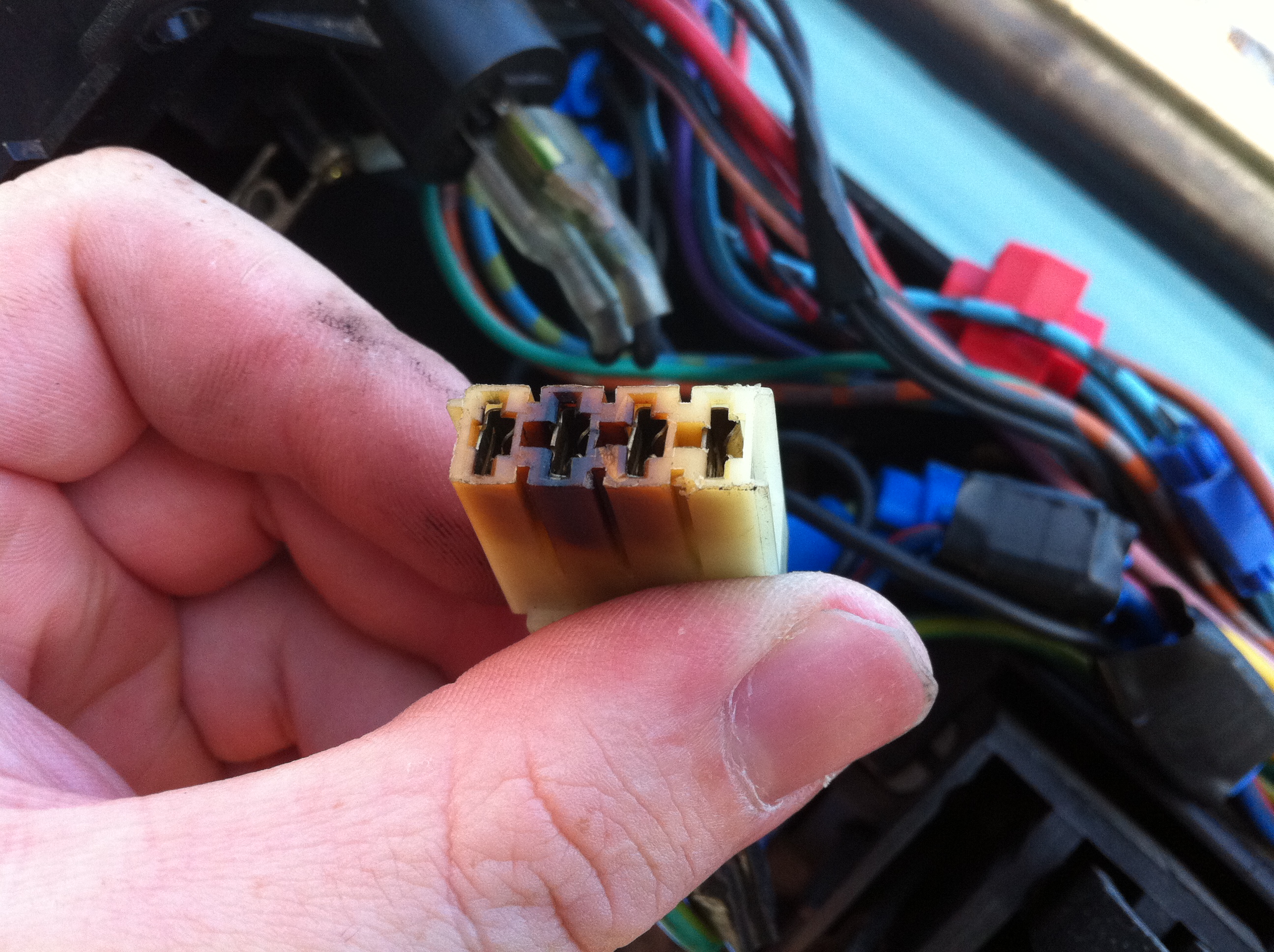

Evidence of previous overheating of the headlight switch, which I know has happened twice since we've owned her.
Turns out doing this job allowed me to fix another issue. The infamous none functioning temperature guage.
Now Fixed :D (although these plugs are replaced with wiring loom anyway, but at least I know why it wasn't operating :)).

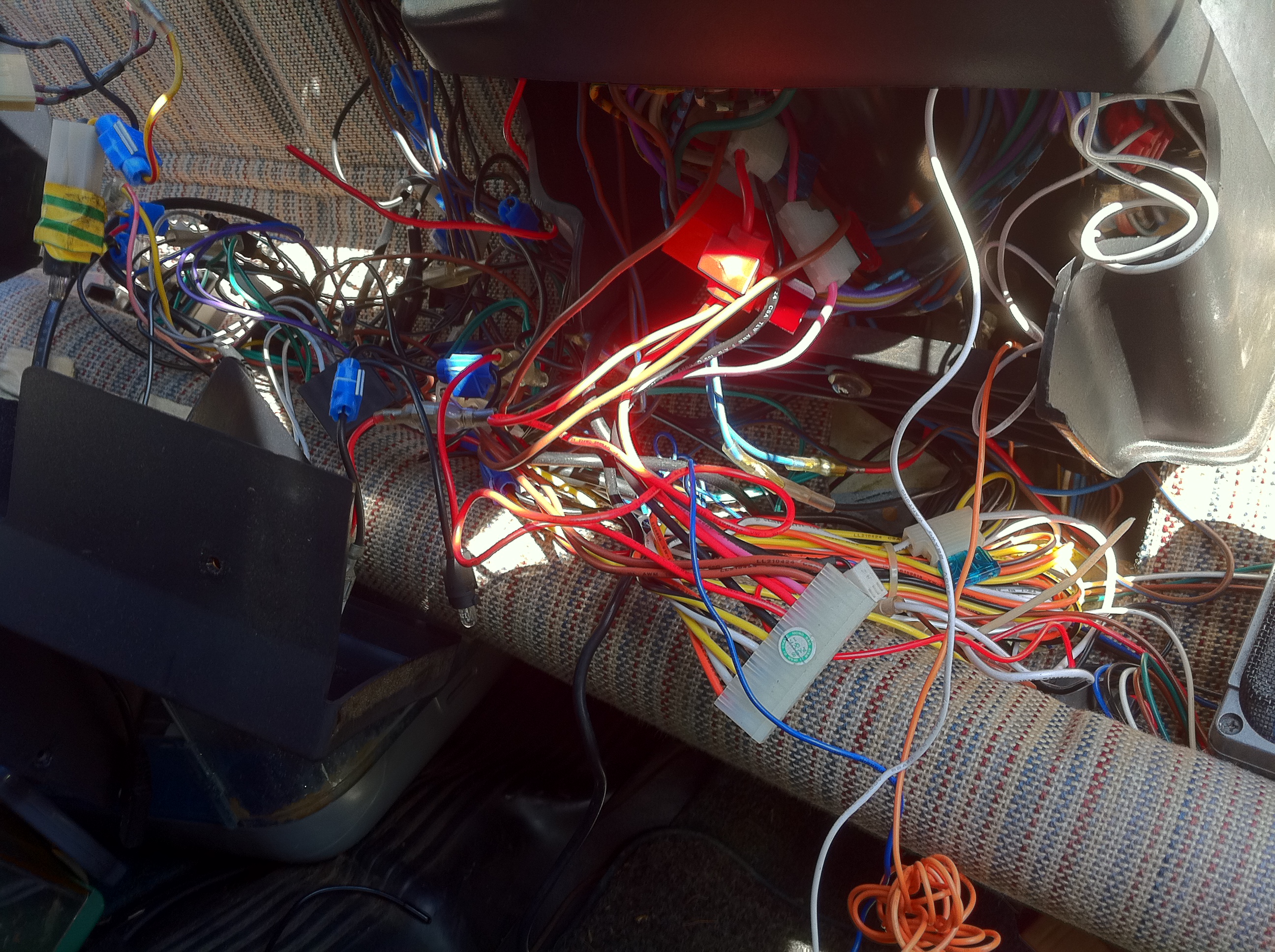

Lower dash dropped shows the mass of other wires :p

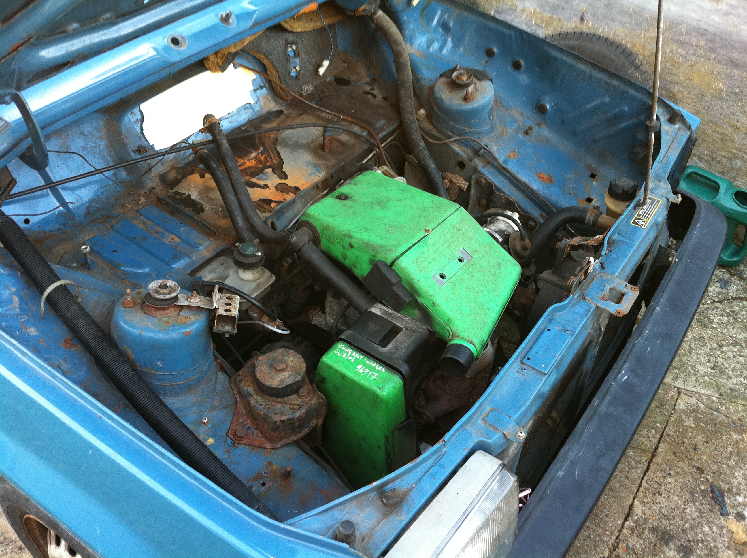

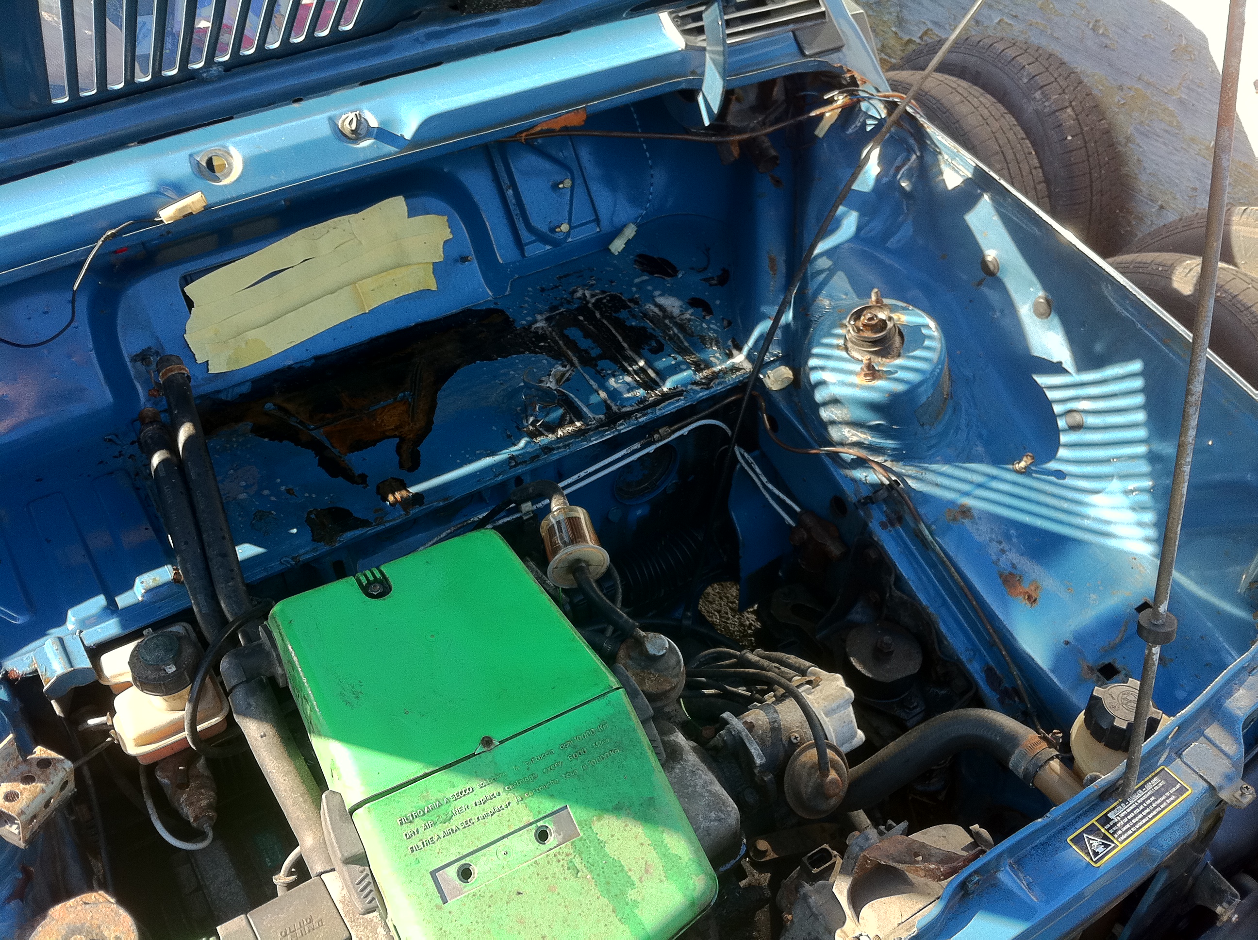

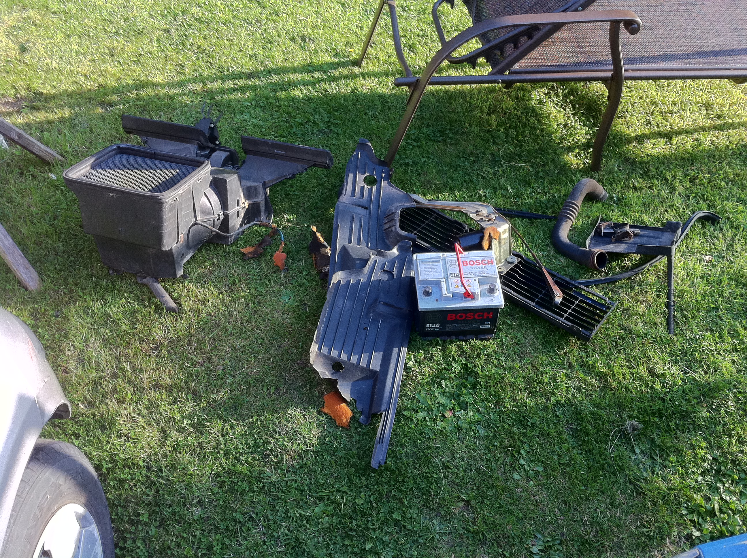

So - The engine bay :rolleyes: :eek:

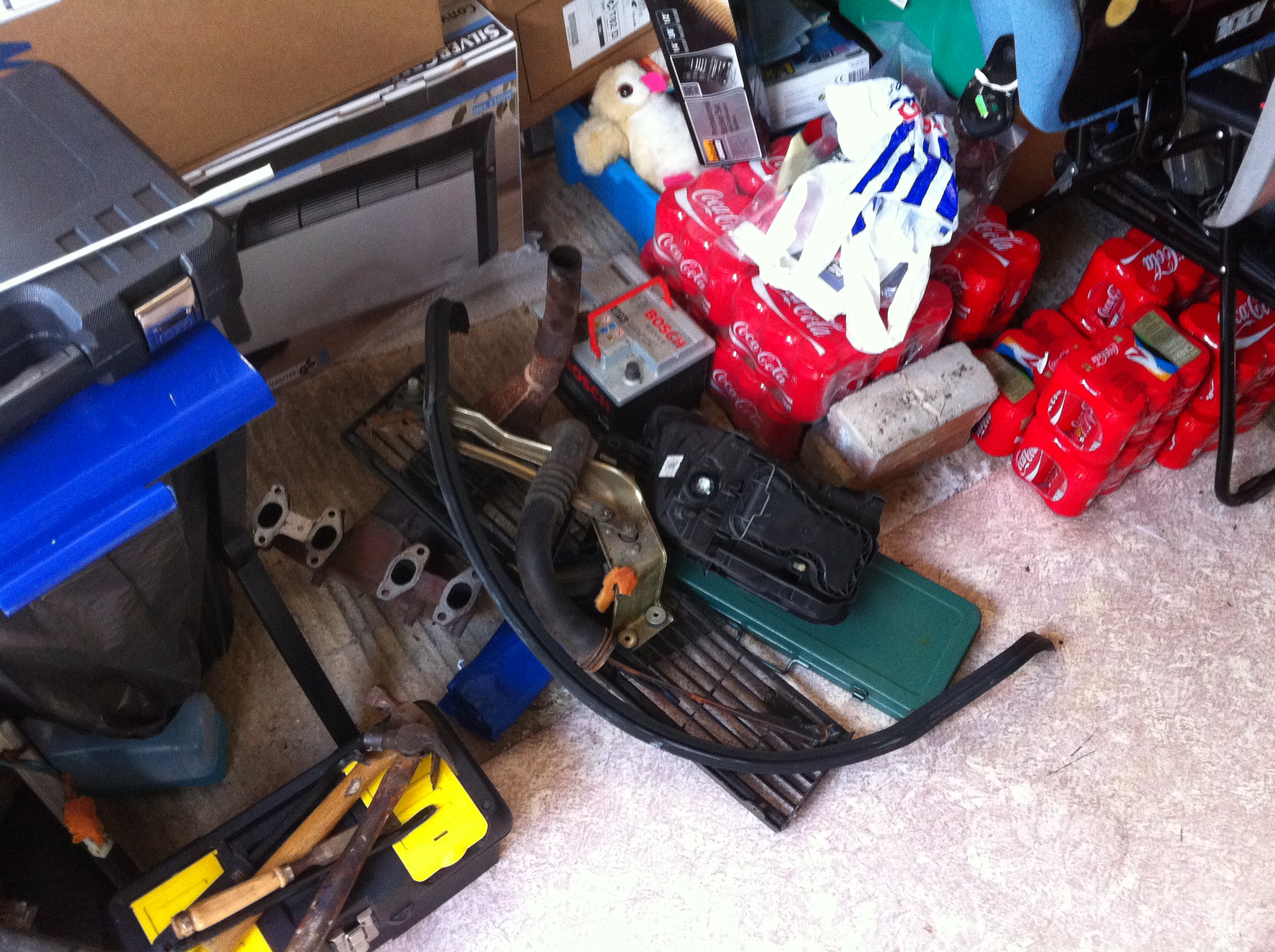

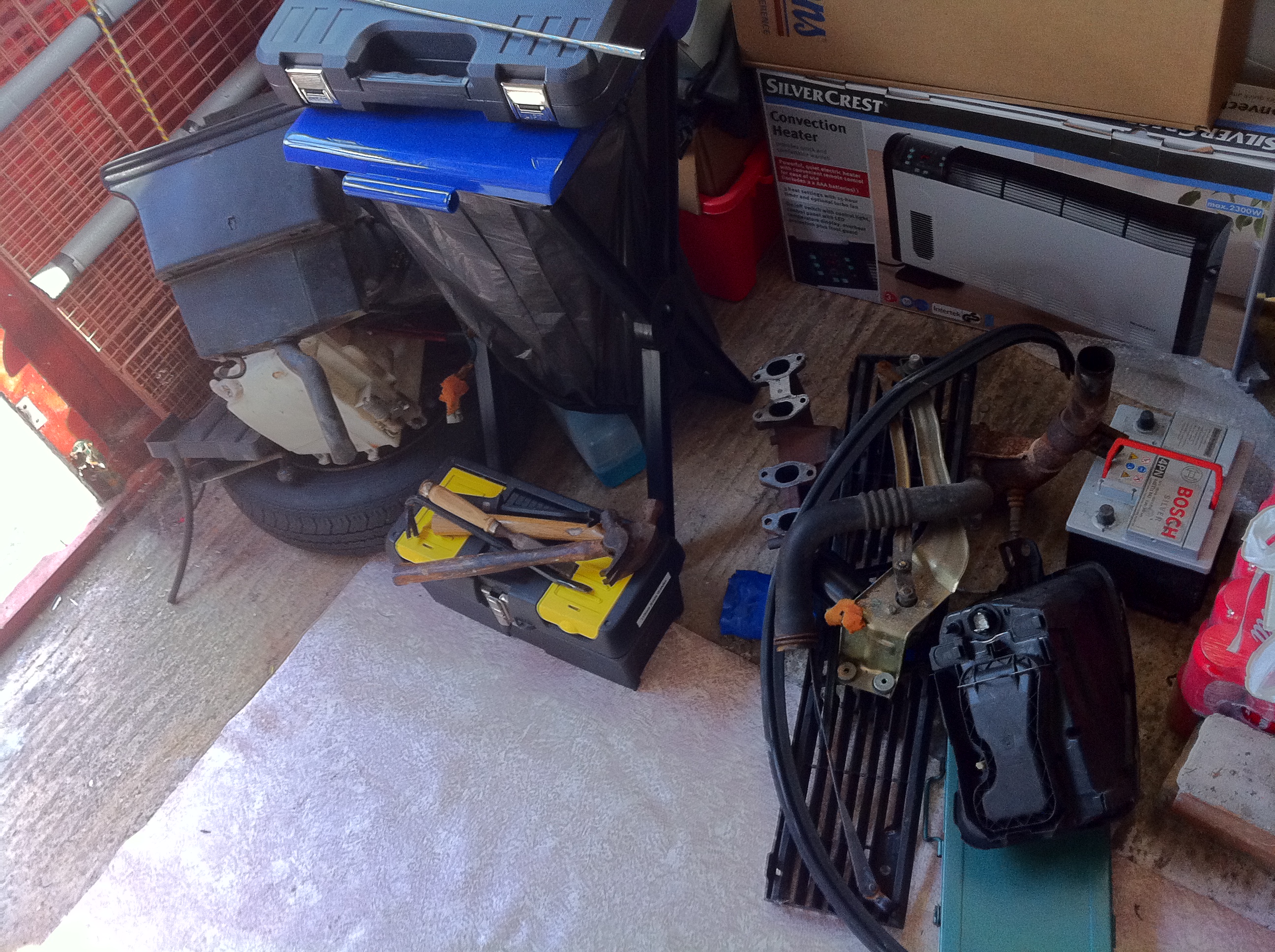

The ever increasing pile of removed parts :cool:

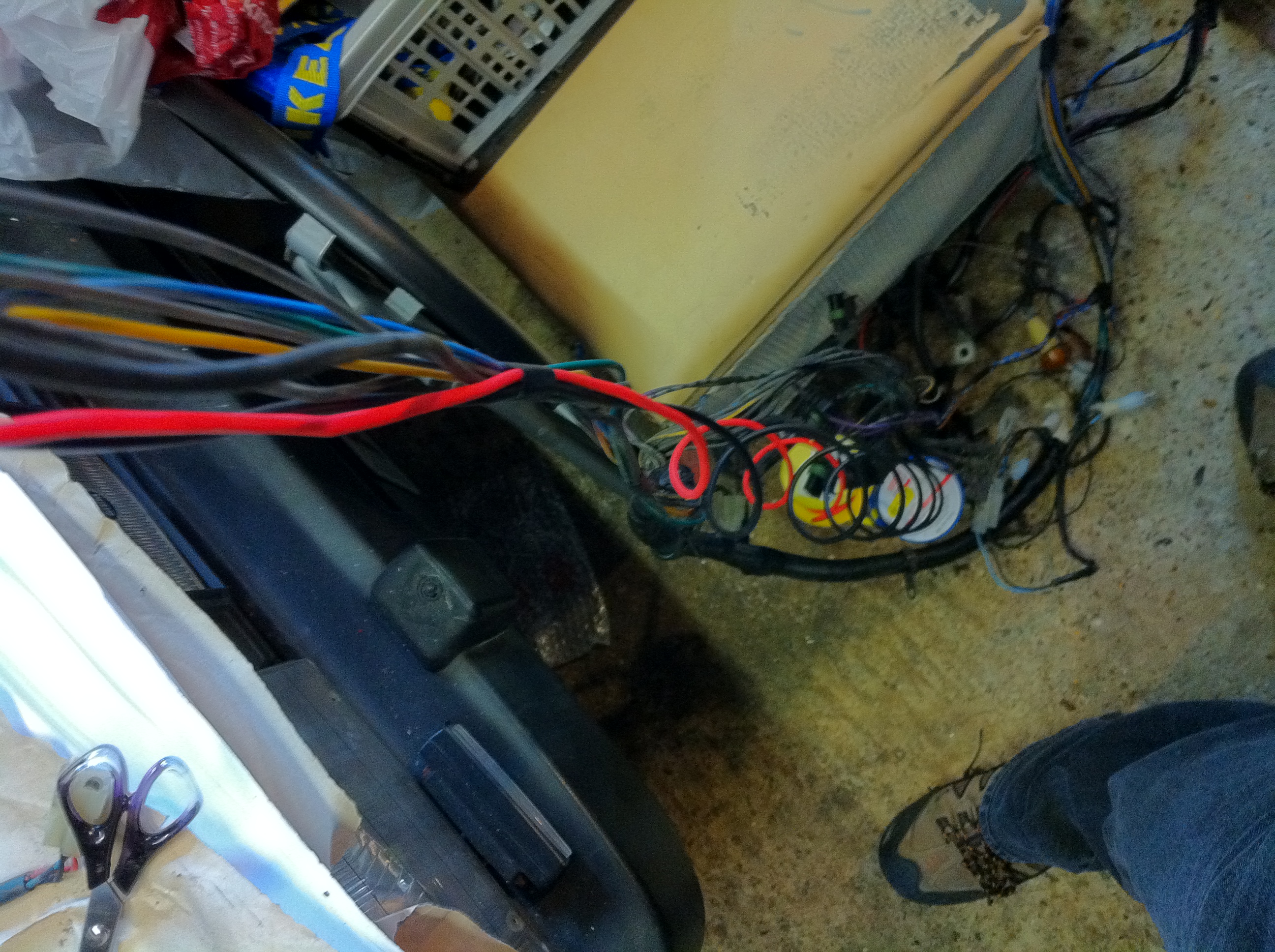

Wiring loom fully removed - How many Skotch Locks can you count :confused: :p :eek:

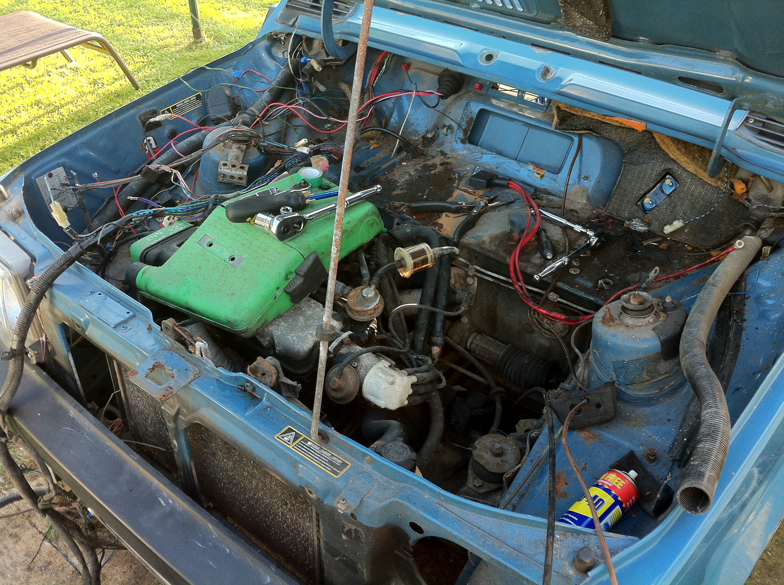

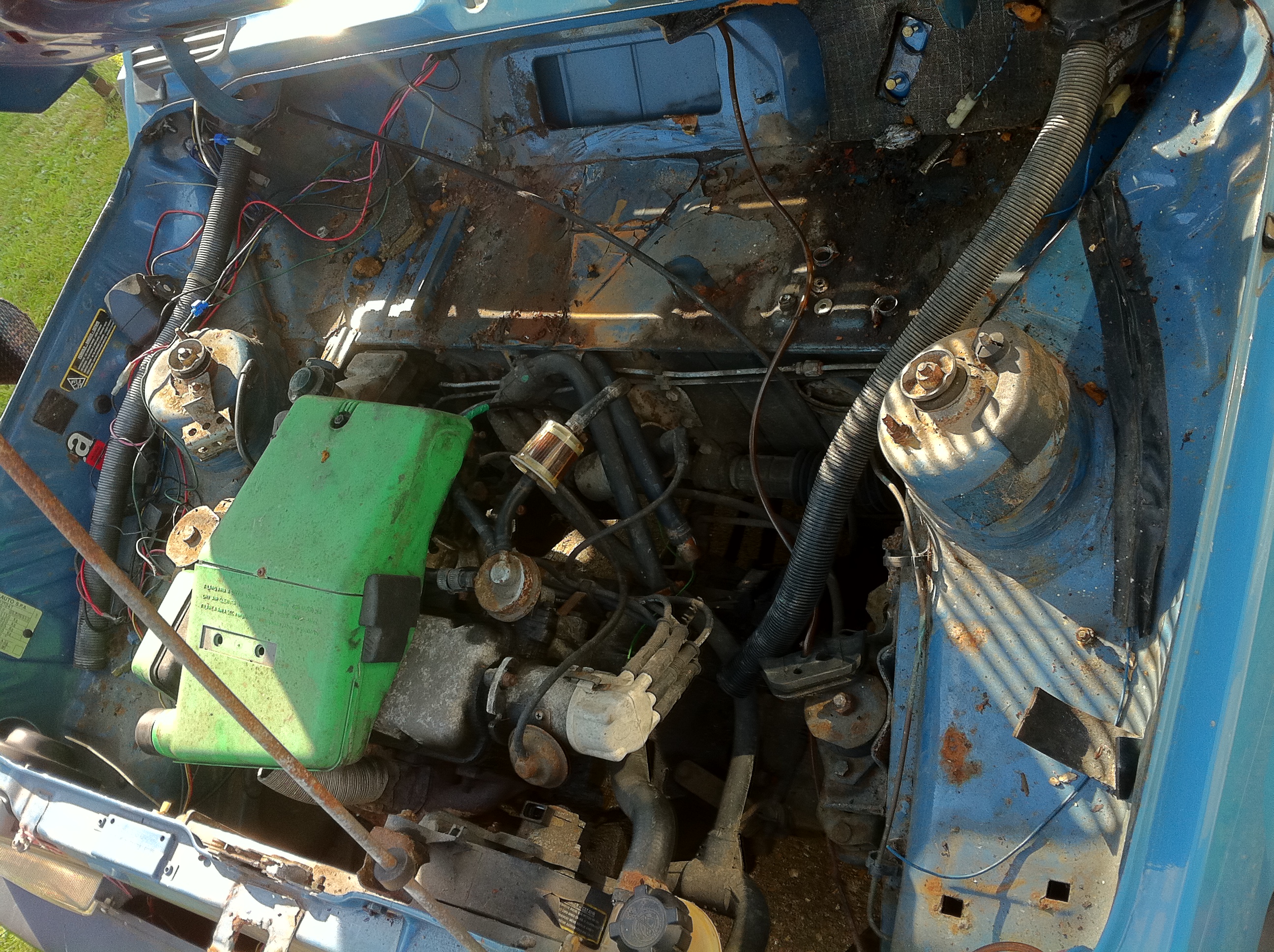

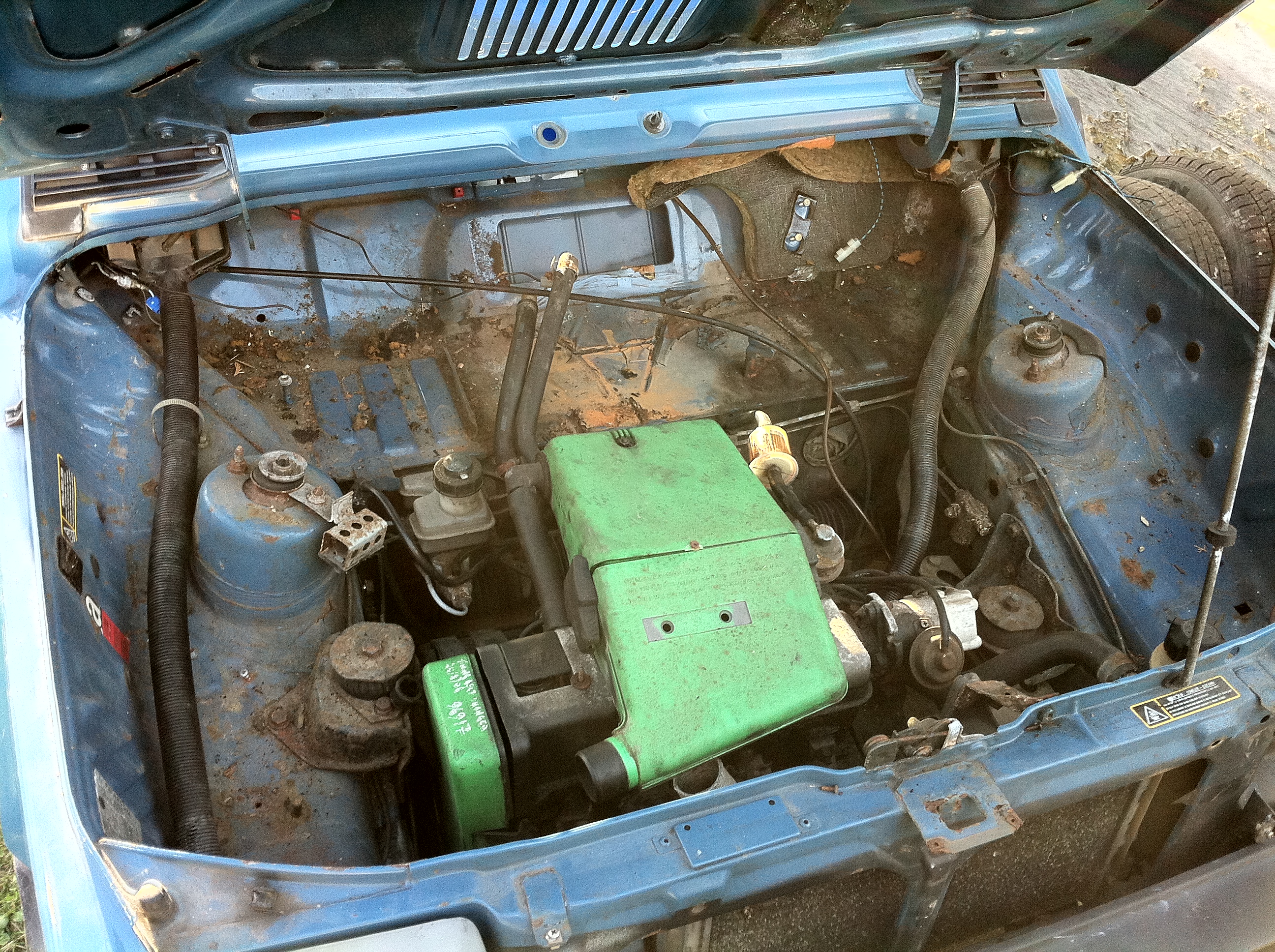

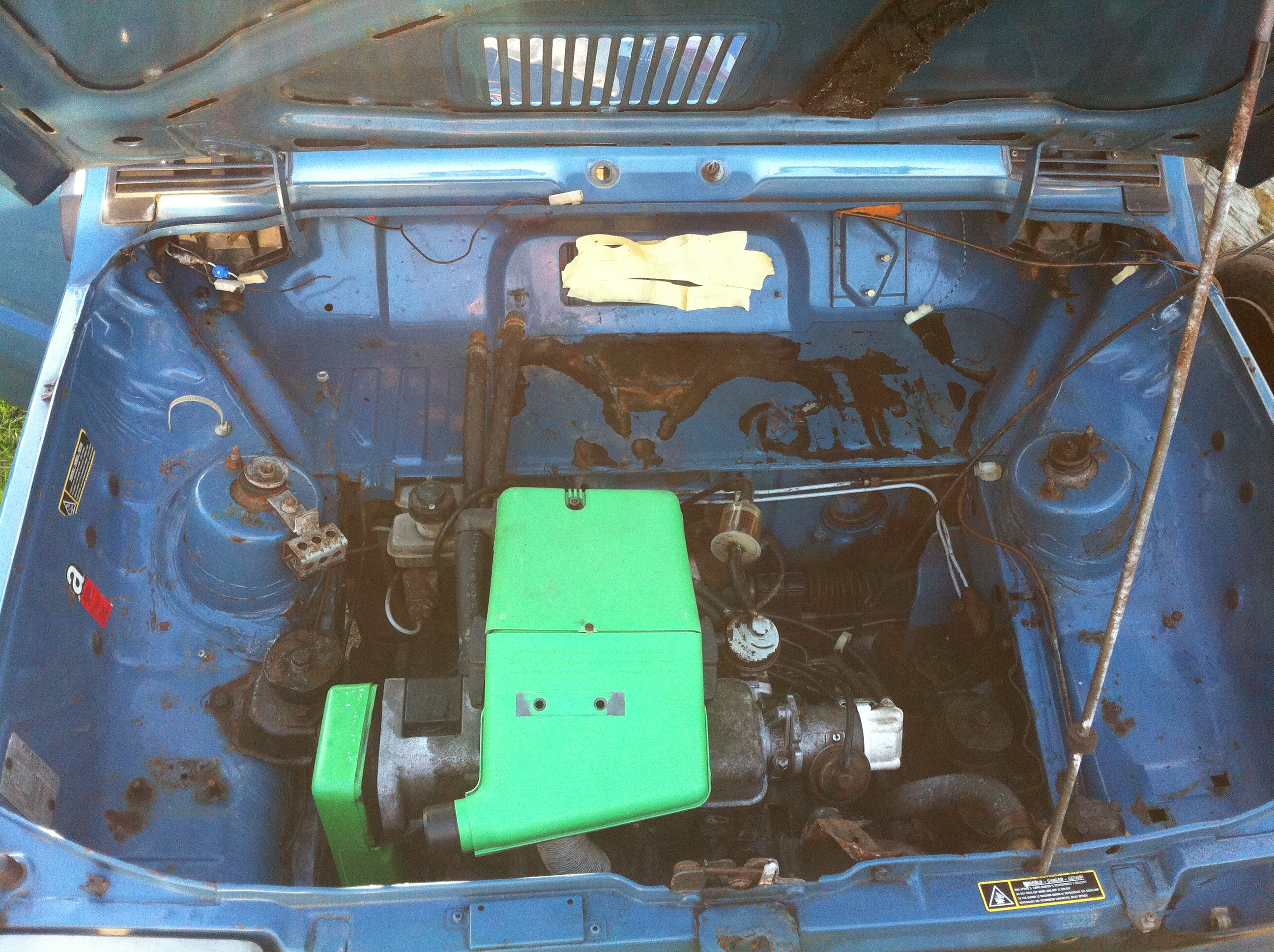

Gutted engine bay ready for cleaning out.

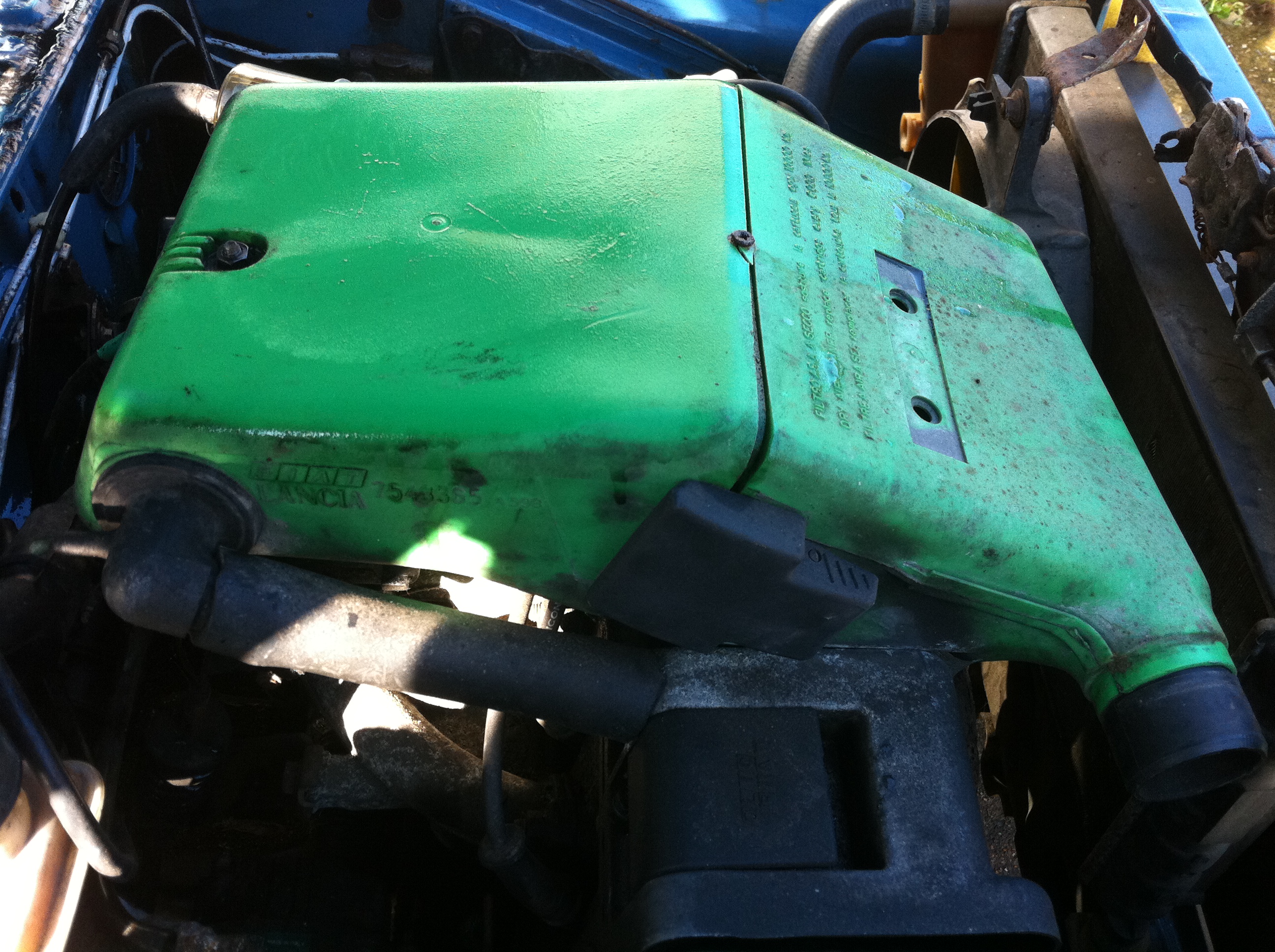

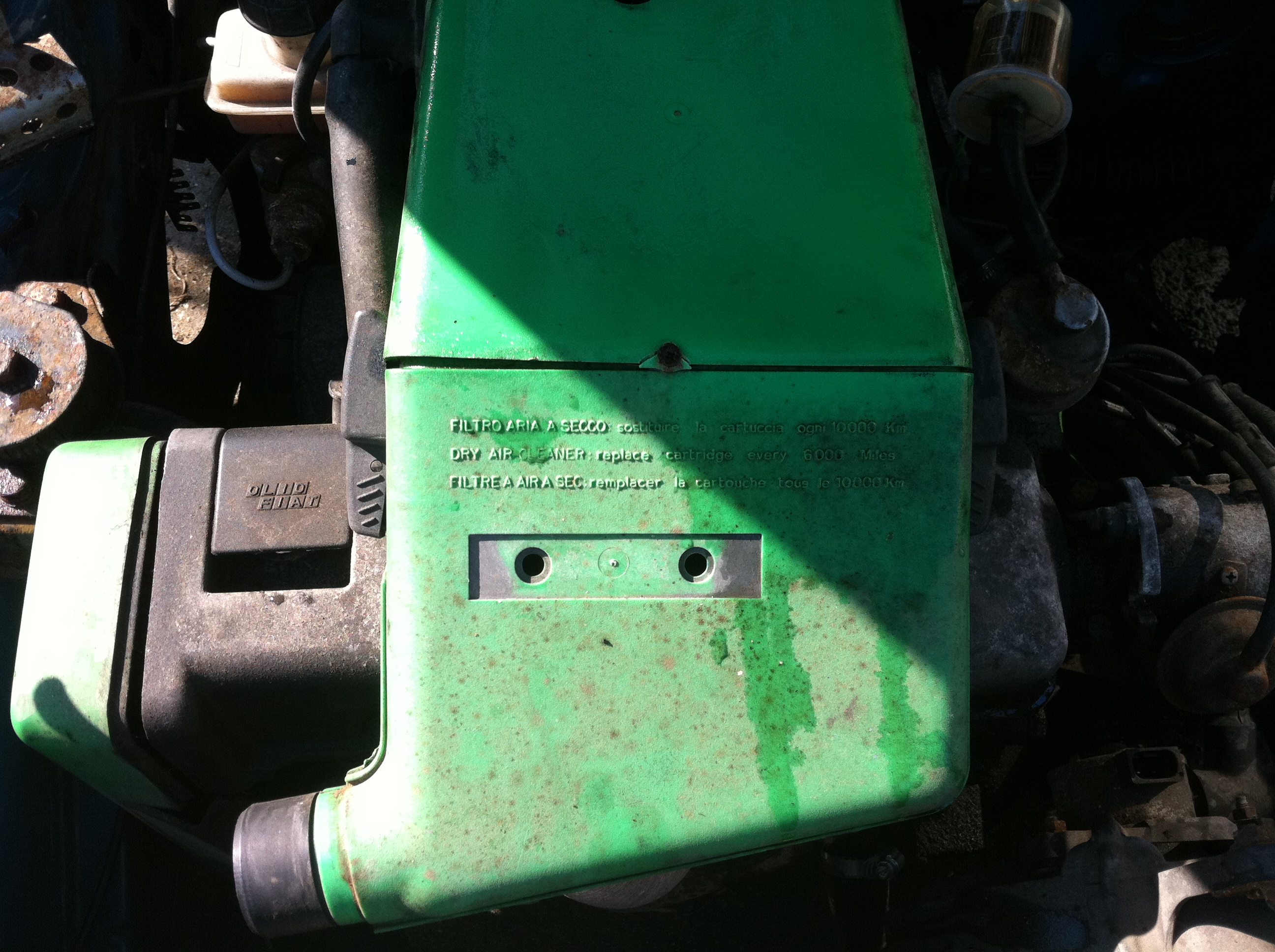

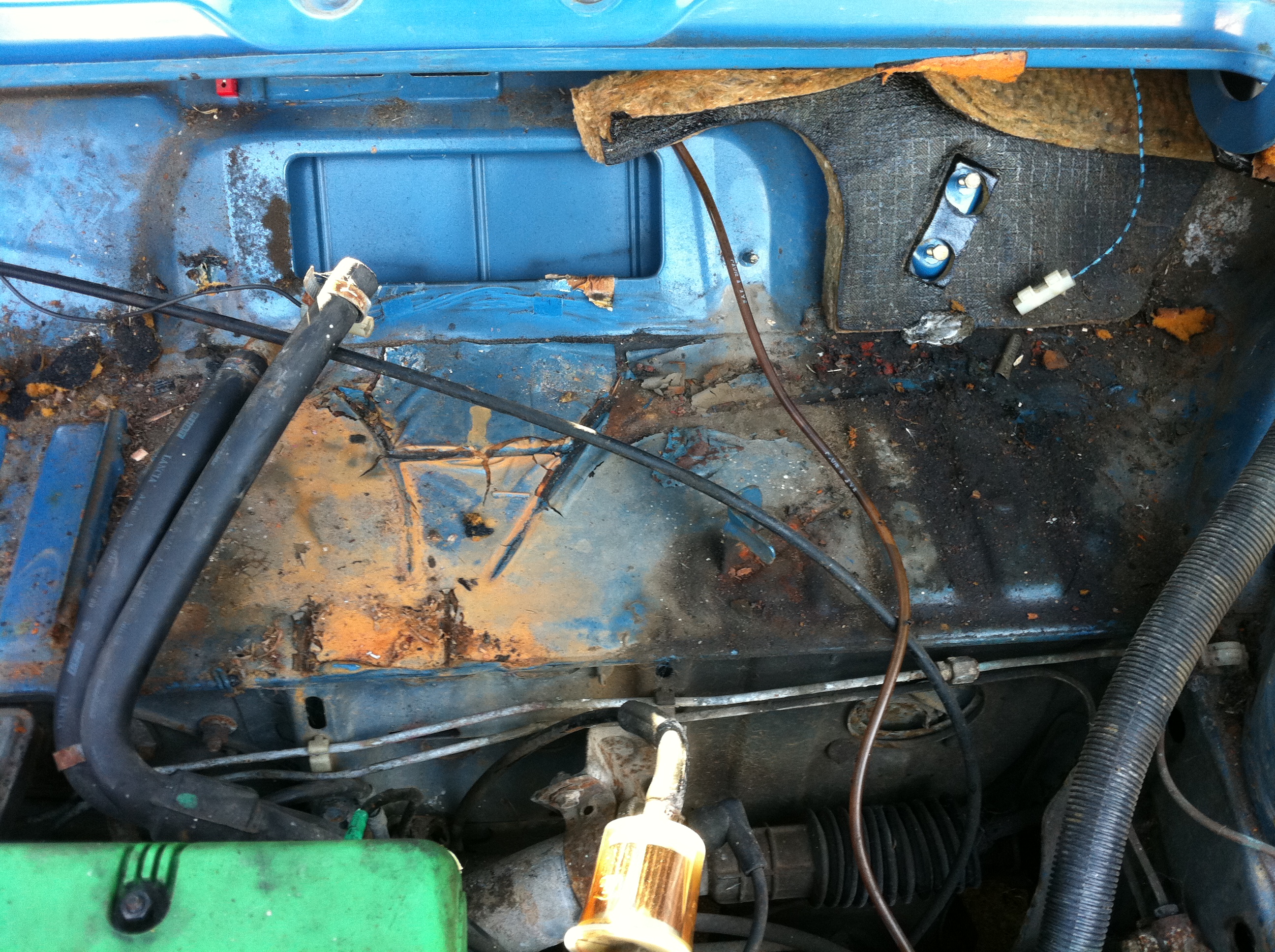

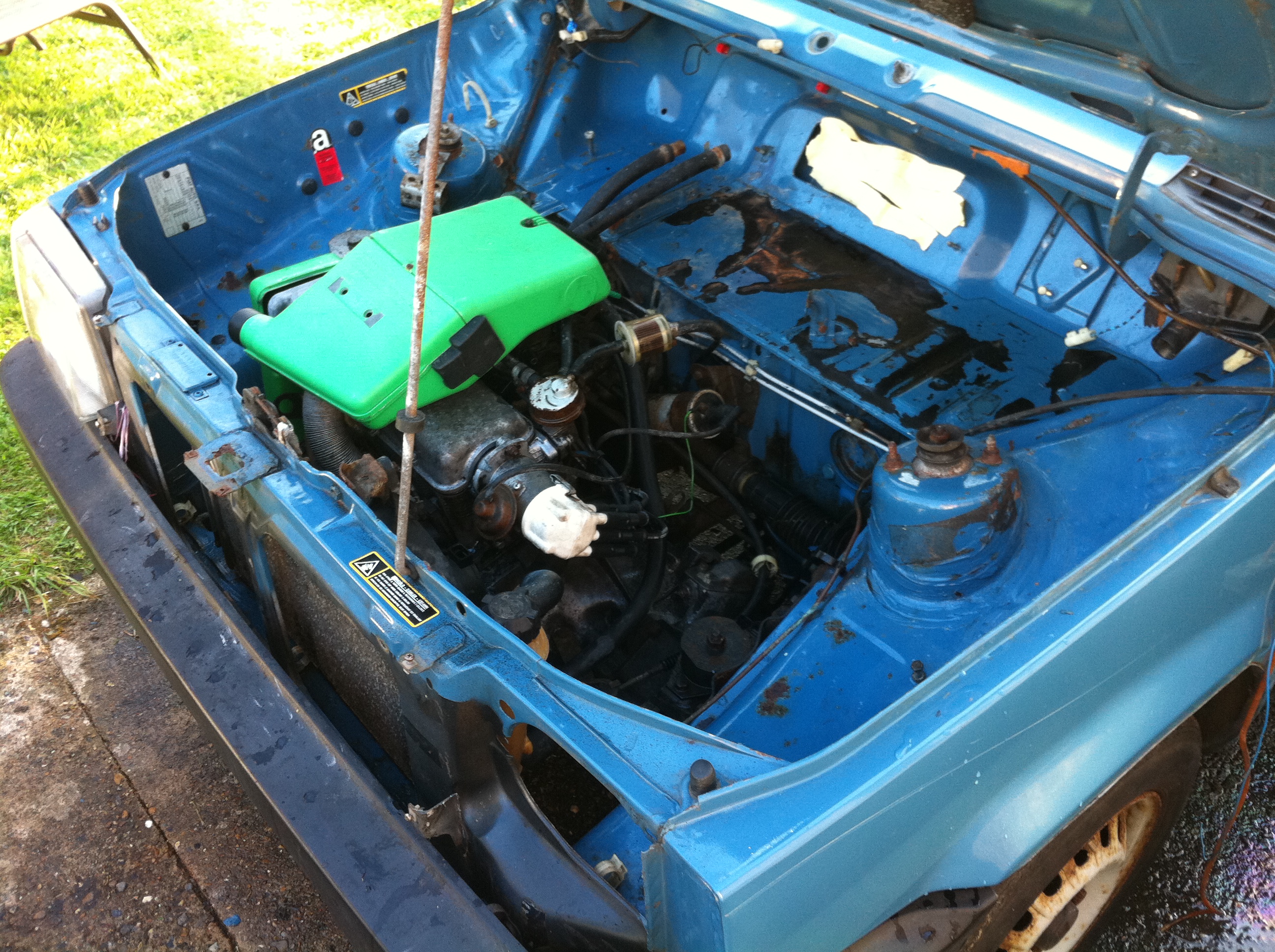

So first part of cleaning the engine bay out involved using my air blow out tool to remove all the crap - Was also handy for seeing where the rust was and how bad it is as removes the paint from above the rusted area's.
Started to de-grease the engine bay. Done the top part of the air box and was really impressed with the results - more pic's of both parts done further down.
De-greasing the bulk head. Used to store a 1L bottle of oil between the spare wheel and the heater box. Spilt about 7 years ago and never really got moped up :p :eek: so the de-greaser got to work :)
Cleaner bulkhead

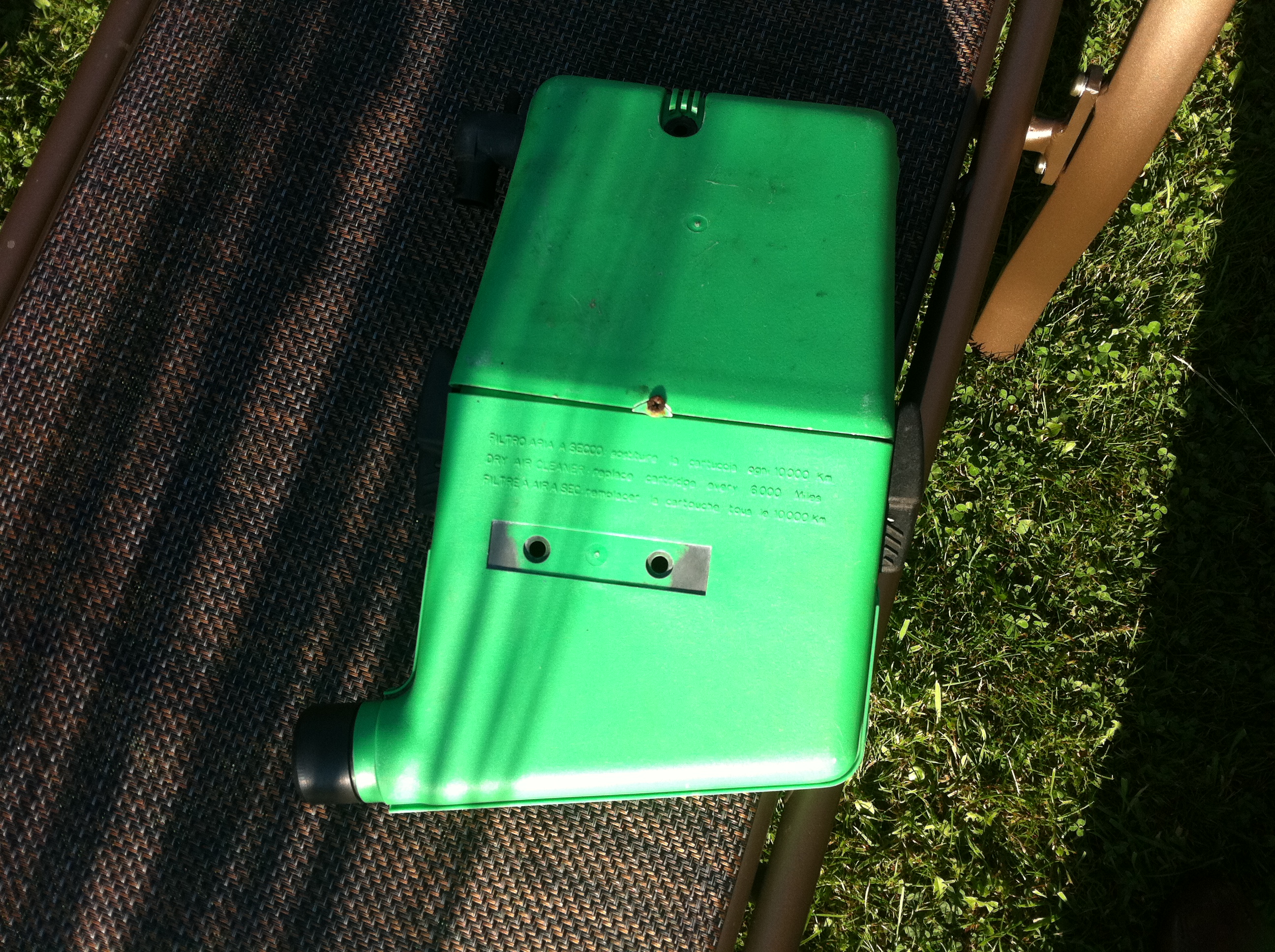

Fully cleaned air filter housing :D
Finished engine bay clean :)

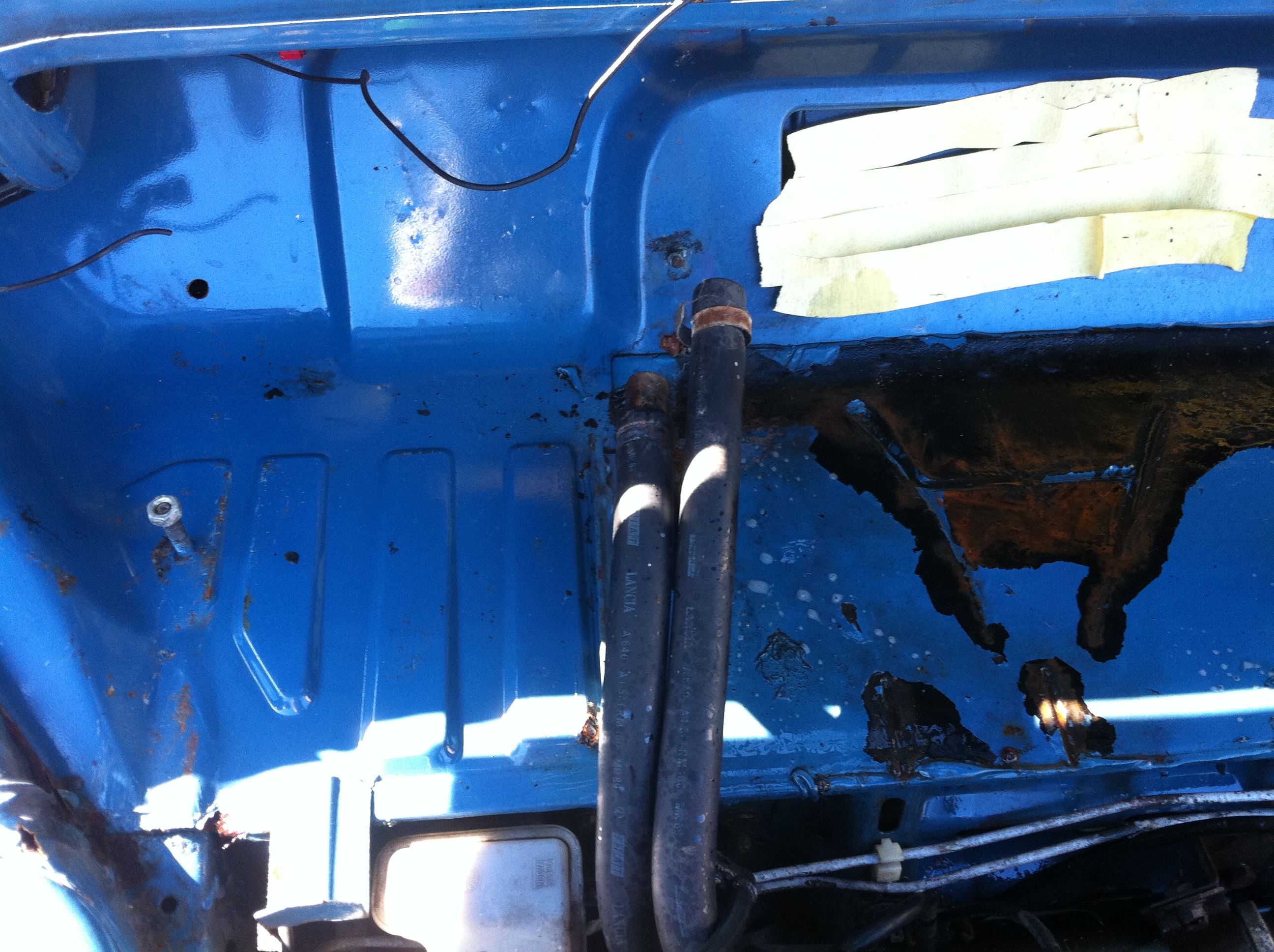

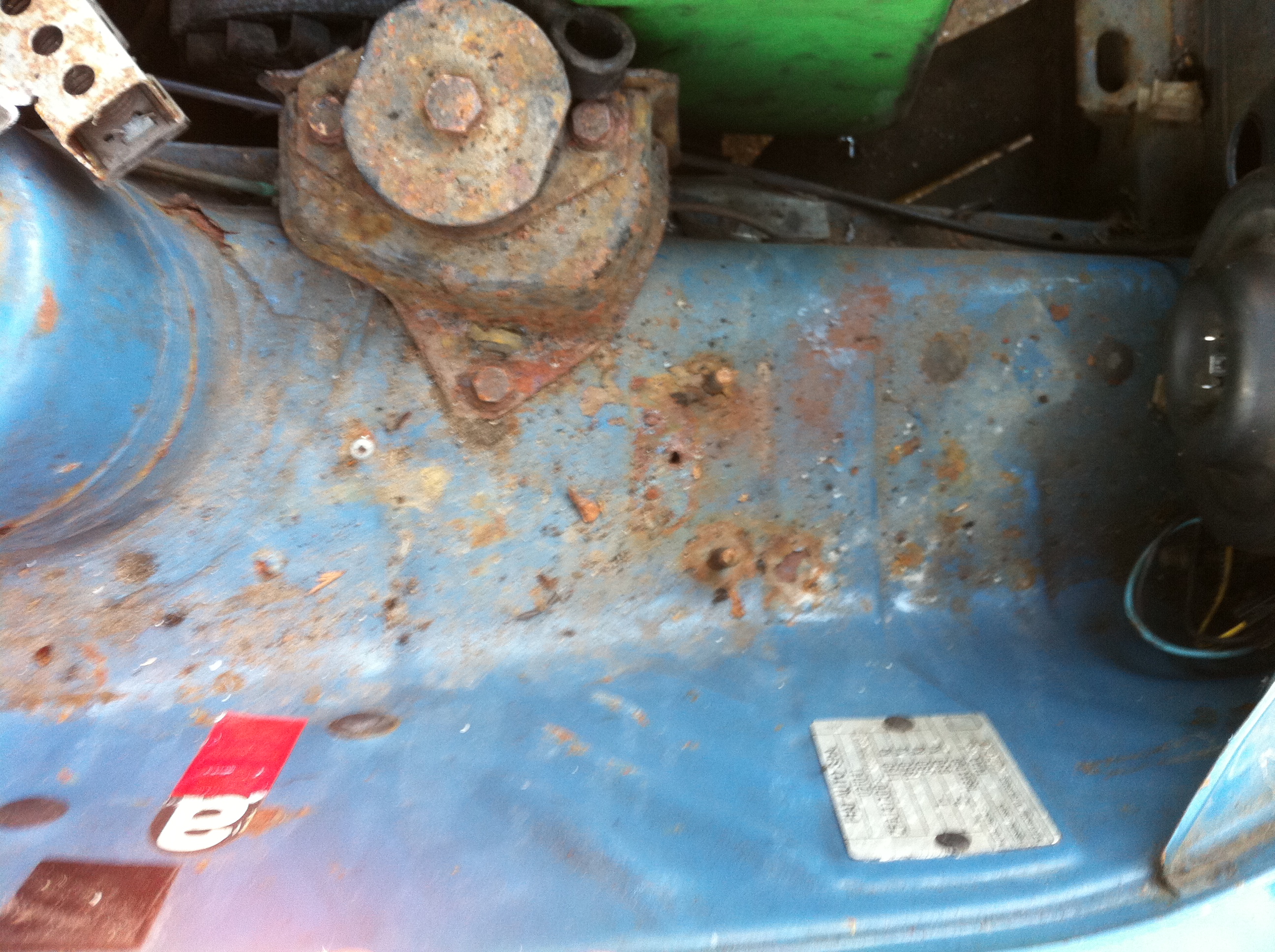

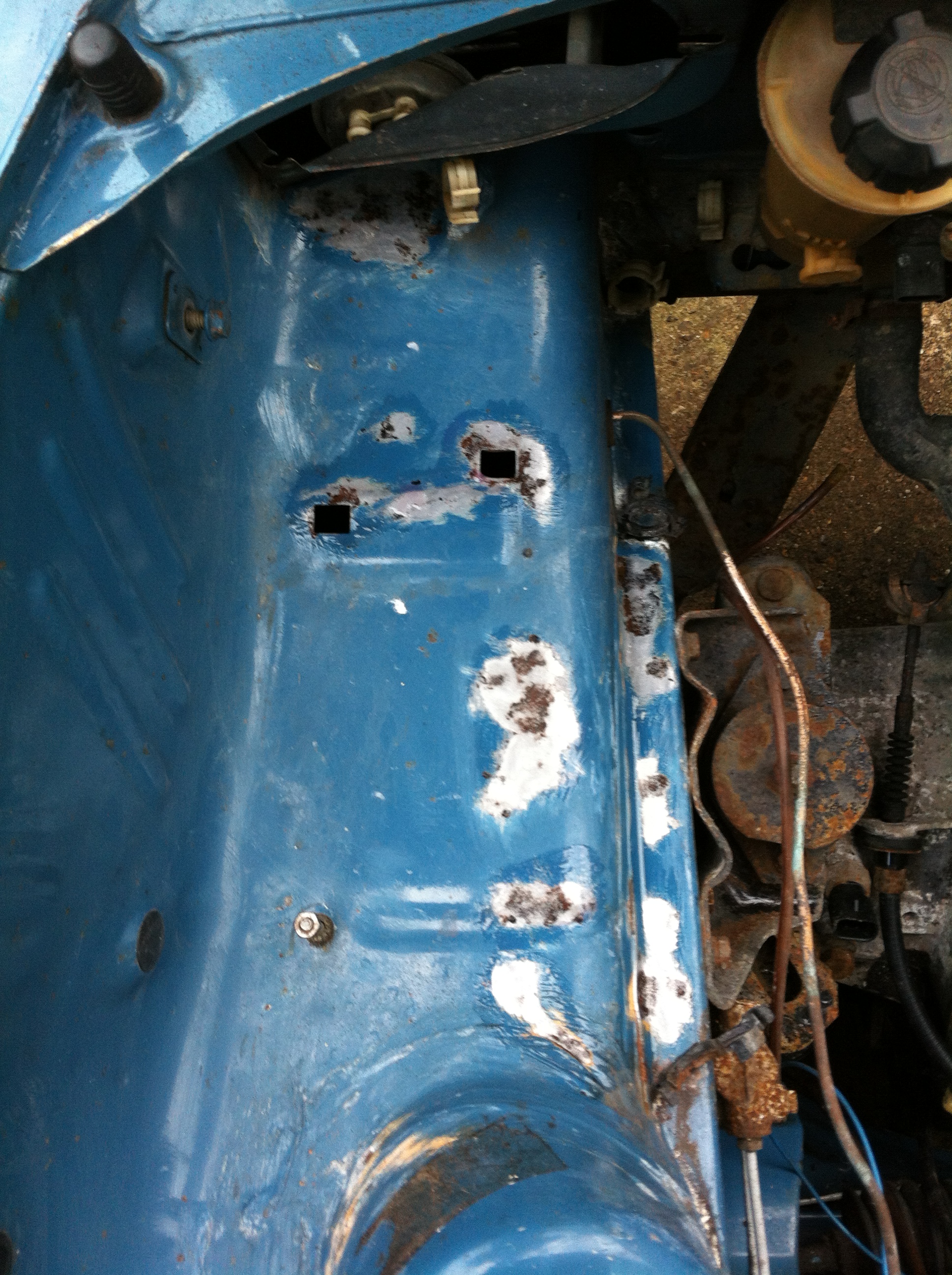

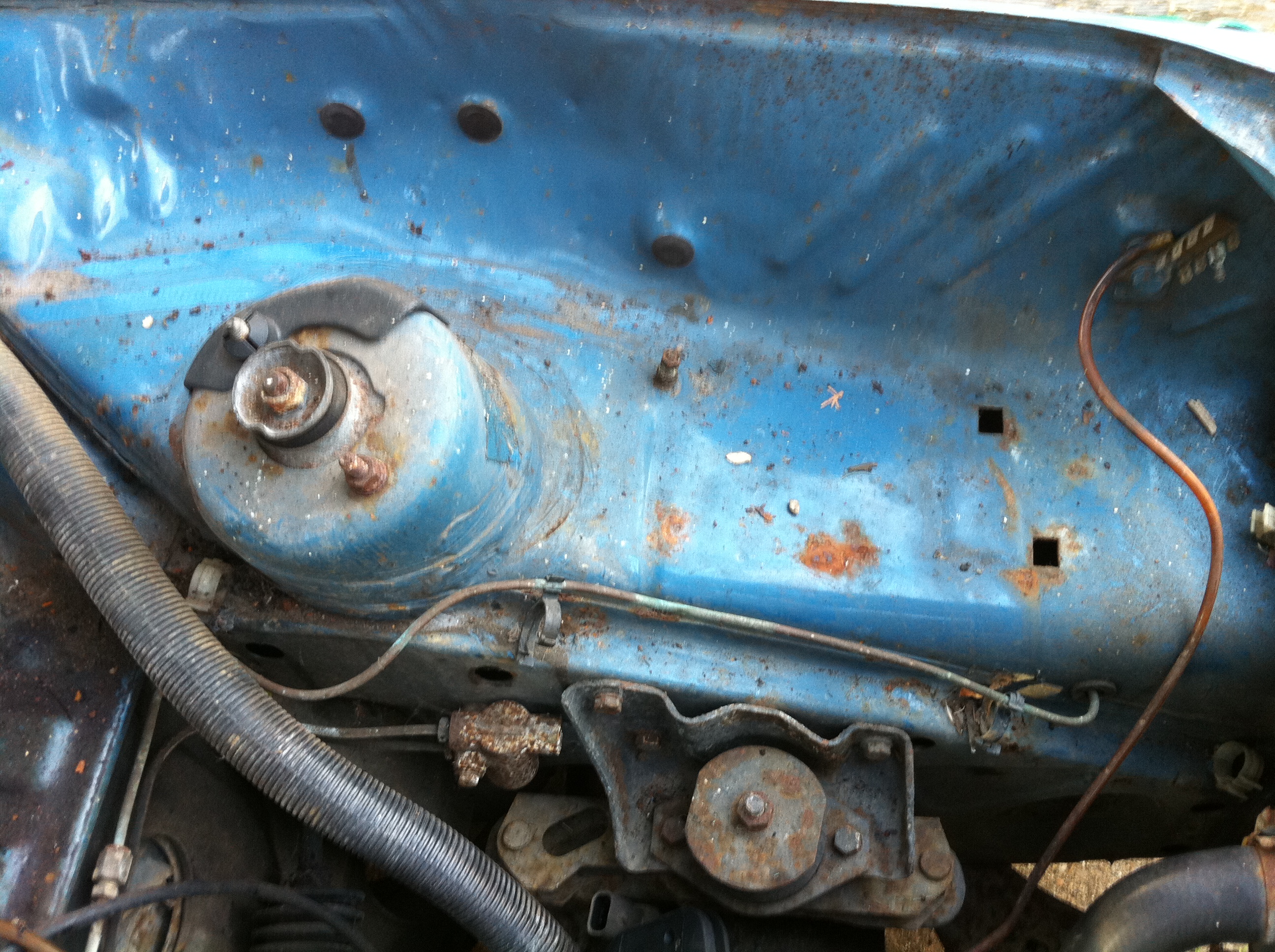

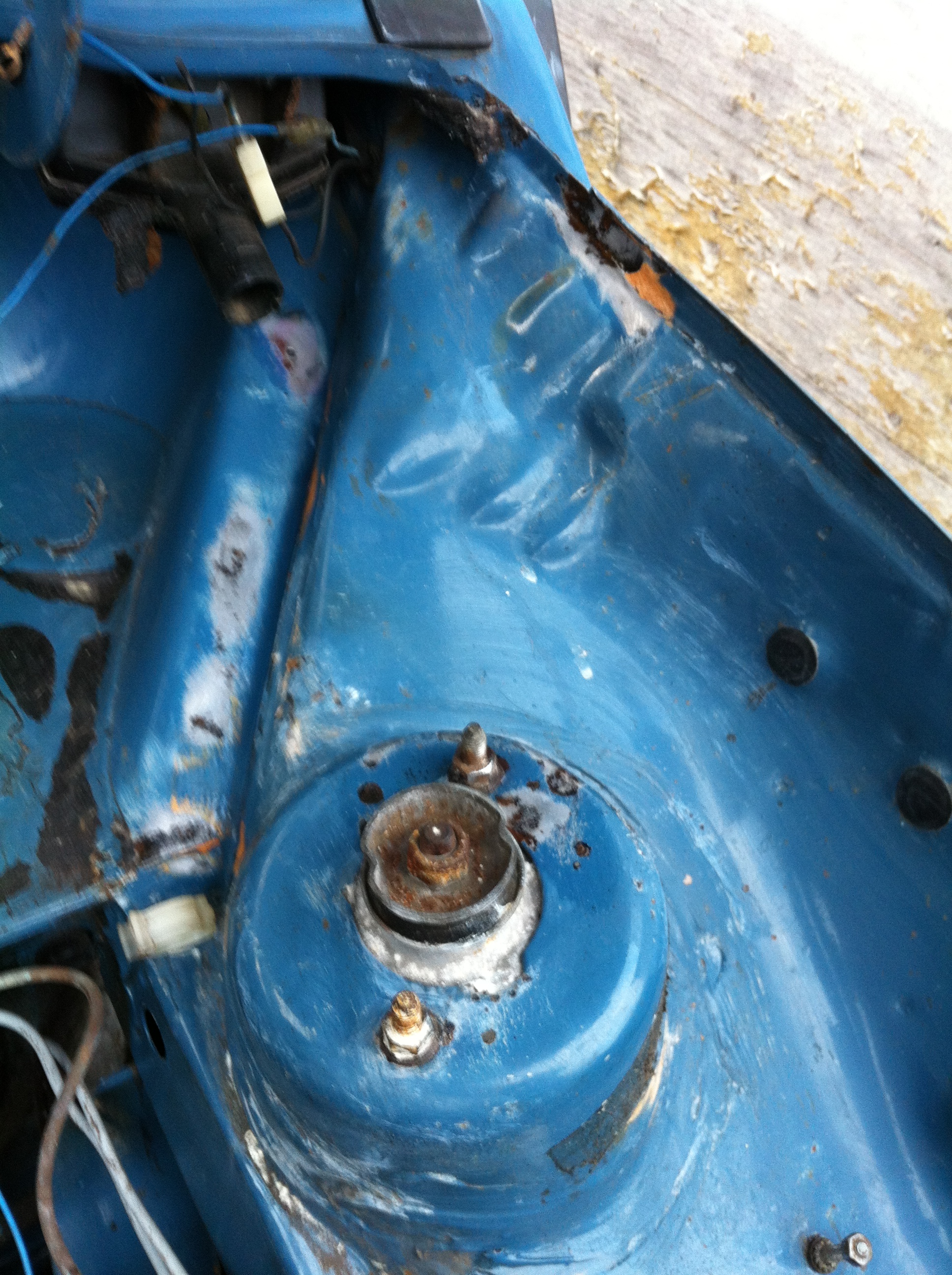

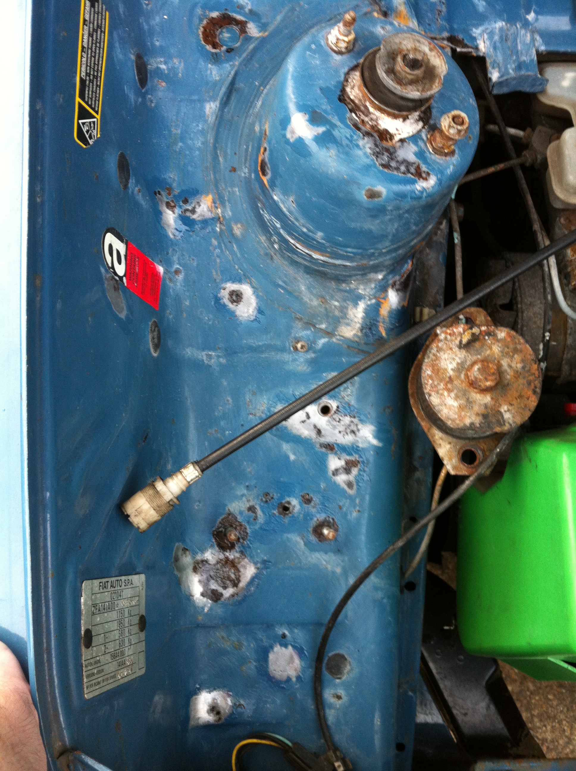

Then went on to clean the rust up and treat it. Now just needs re-painting but haven't got any pic's of that yet, and I think we've had enough for now :eek: :p

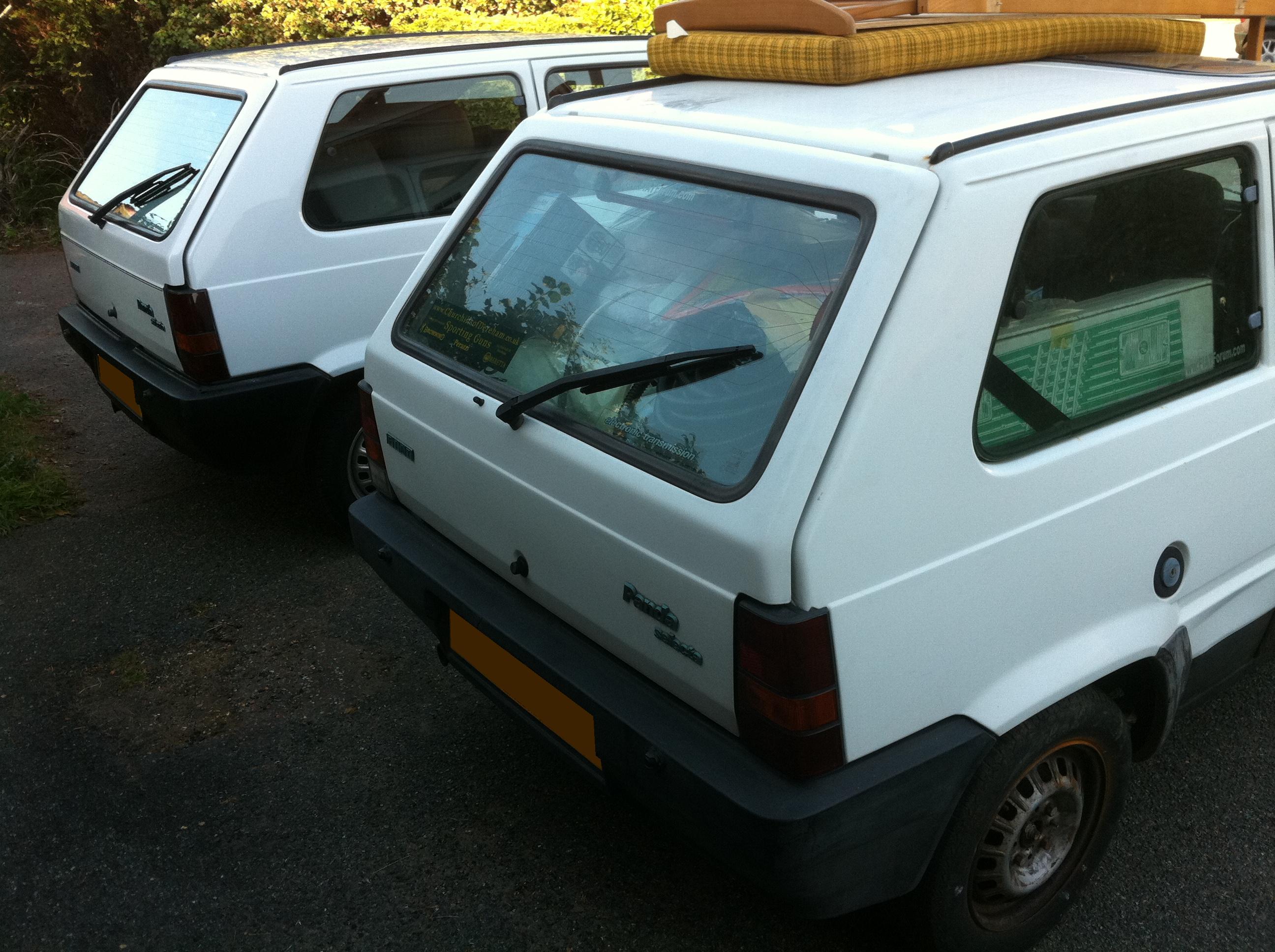

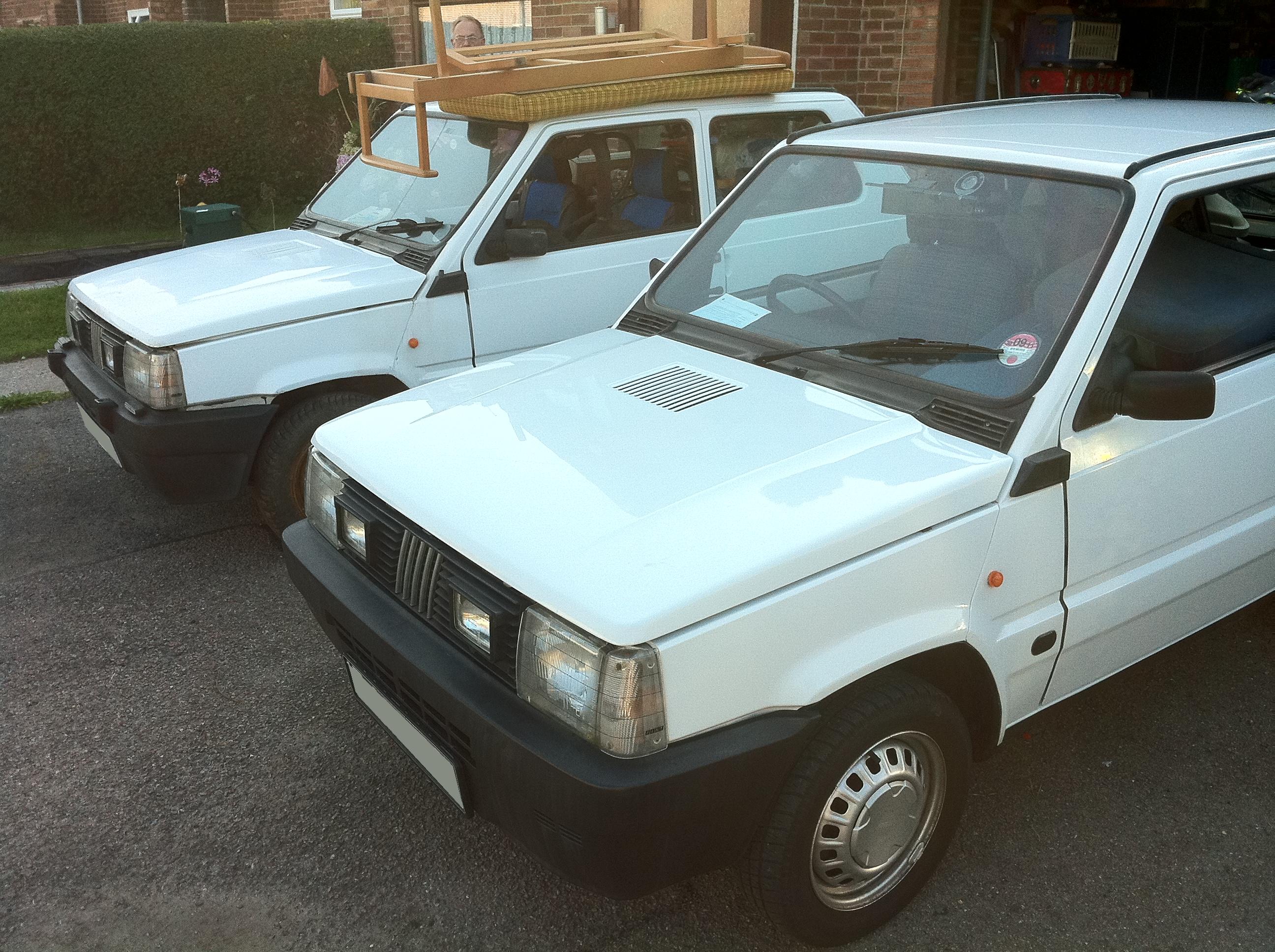

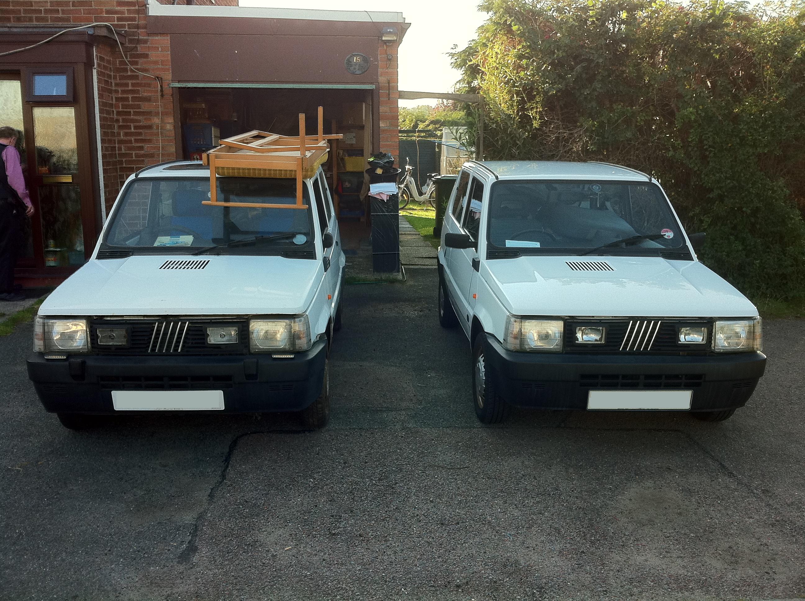

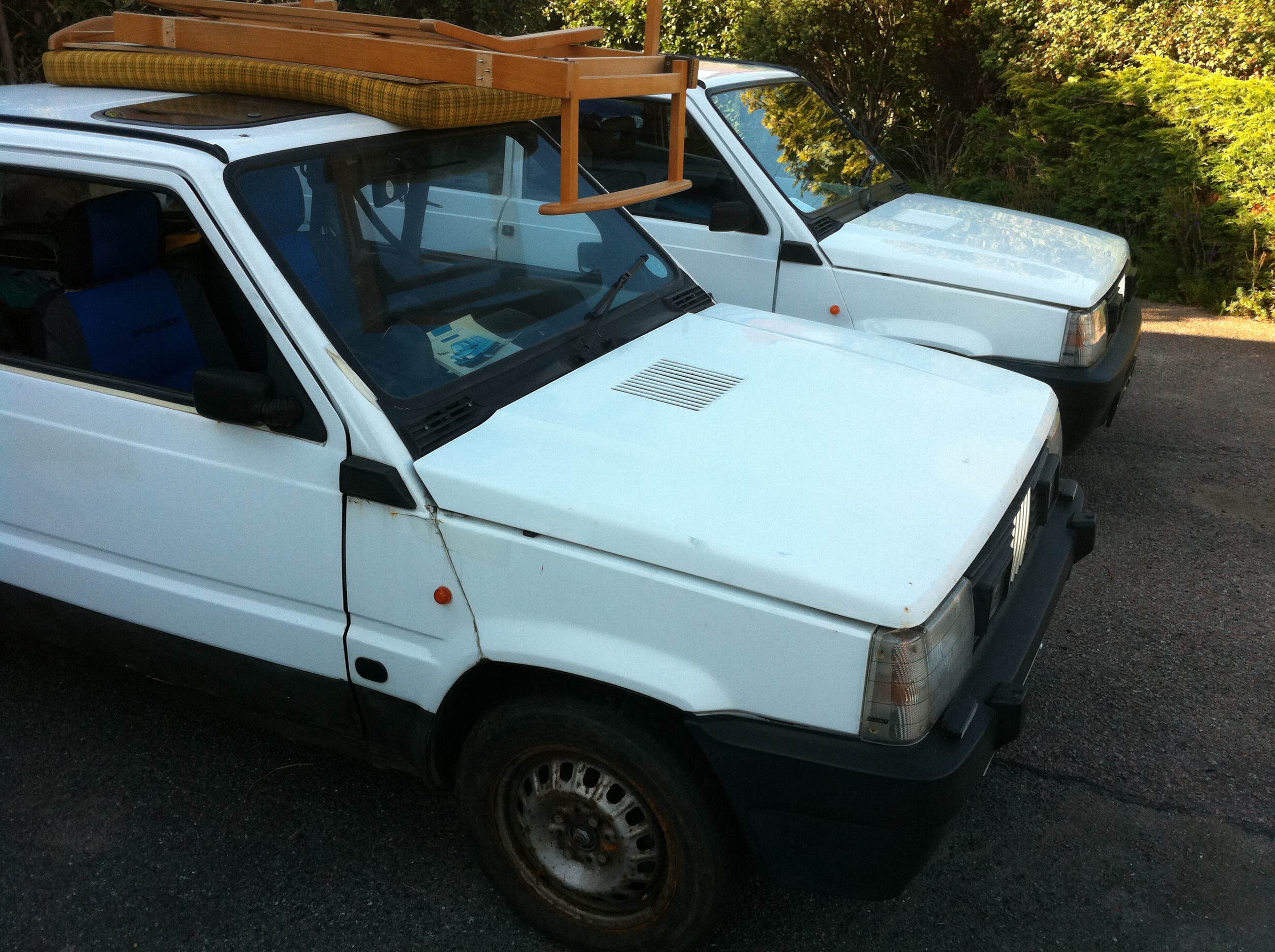

So, first of all, on a slightly none 750L related topic, here are some pic's of our 2 Selecta's I took with them together when swapping the not so mint one from one garage to the other and putting the Mint Selecta away for the winter :( :)

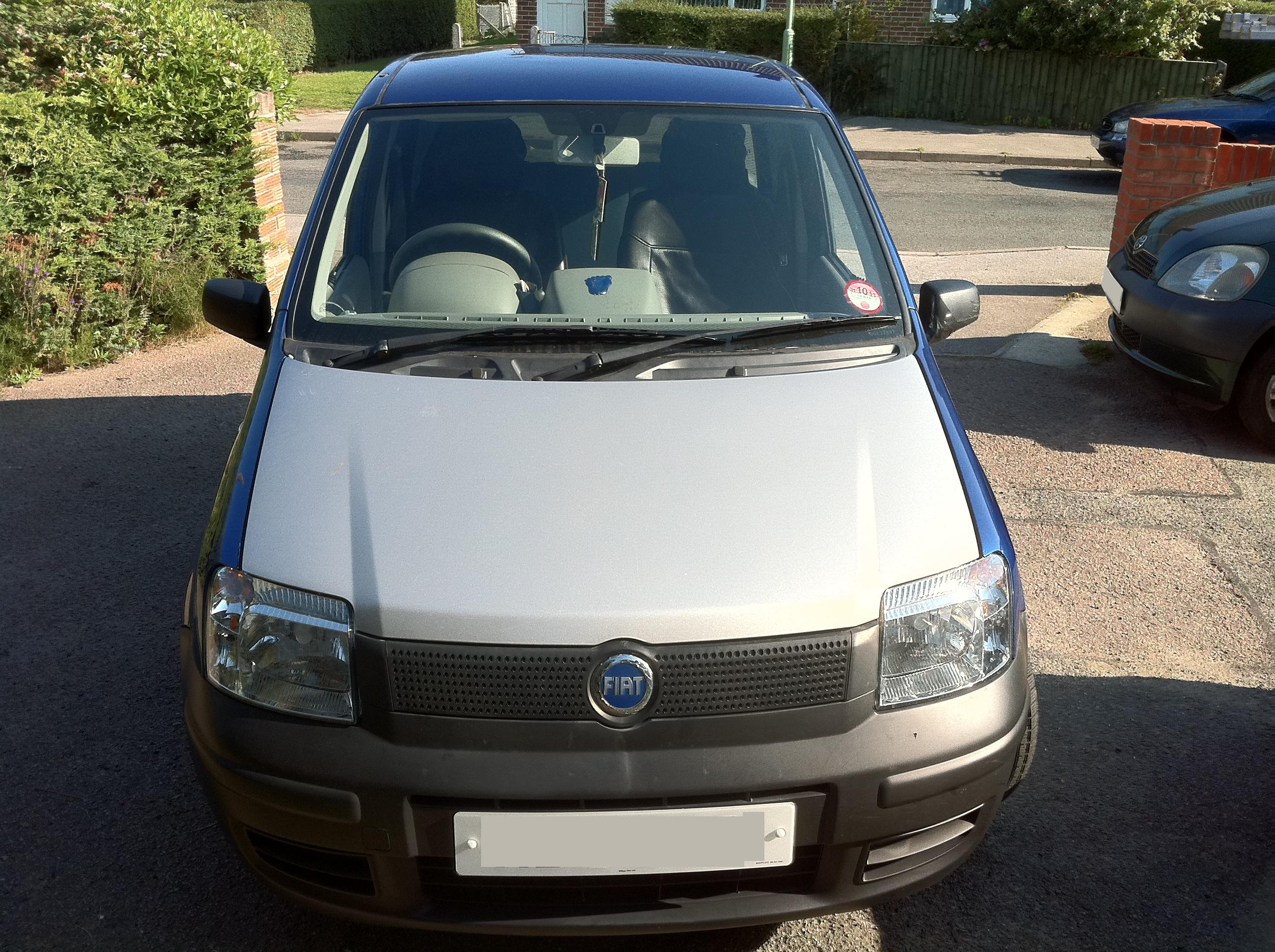

And on an even more random note, Silver bonnet on a blue mk3 - a temp measure when repainting the origional bonnet on sisters mk3 :ROFLMAO:

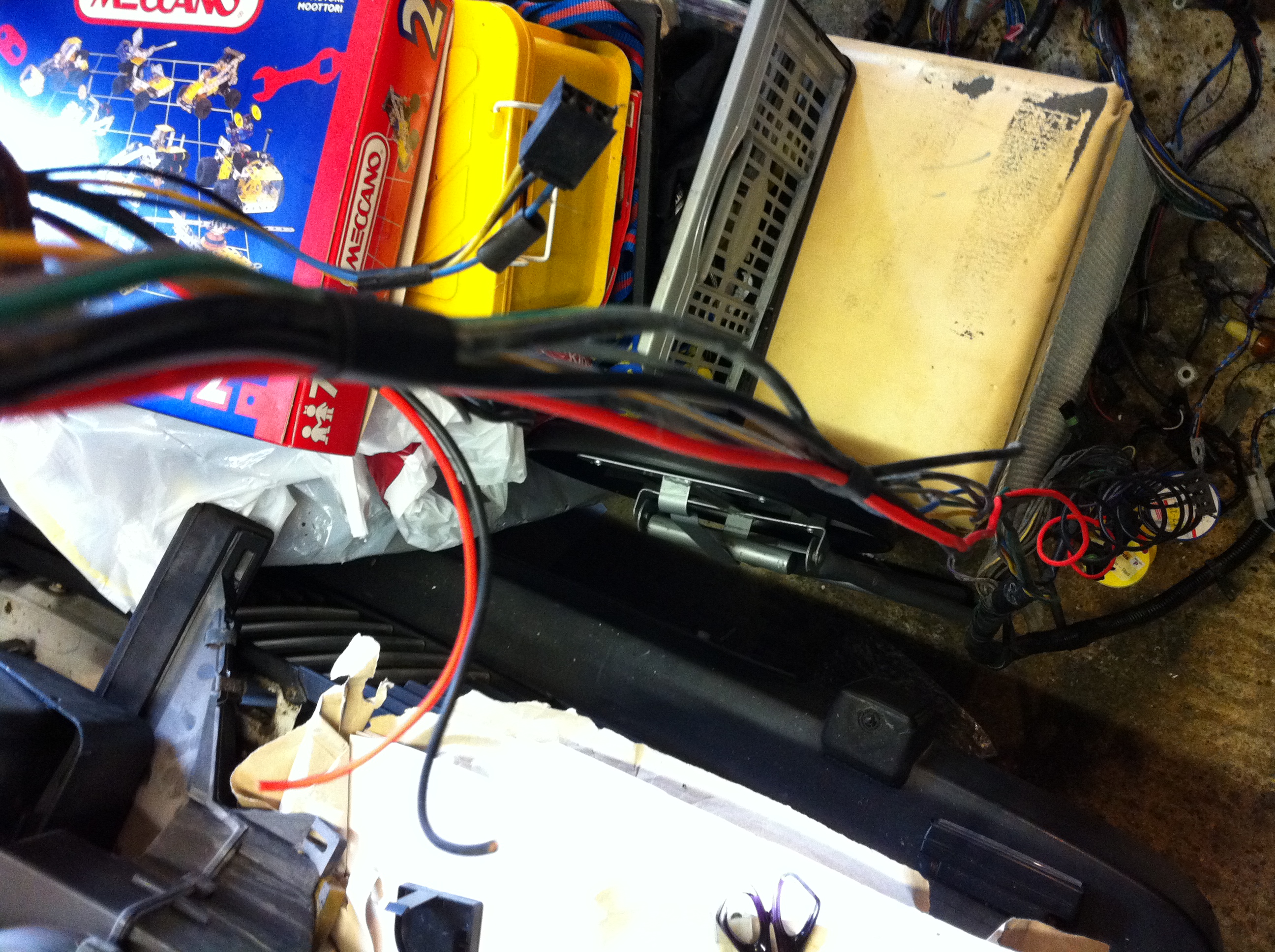

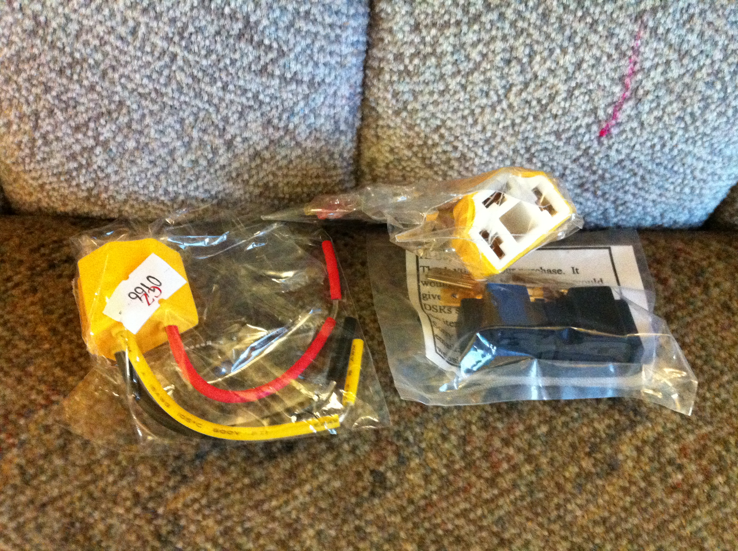

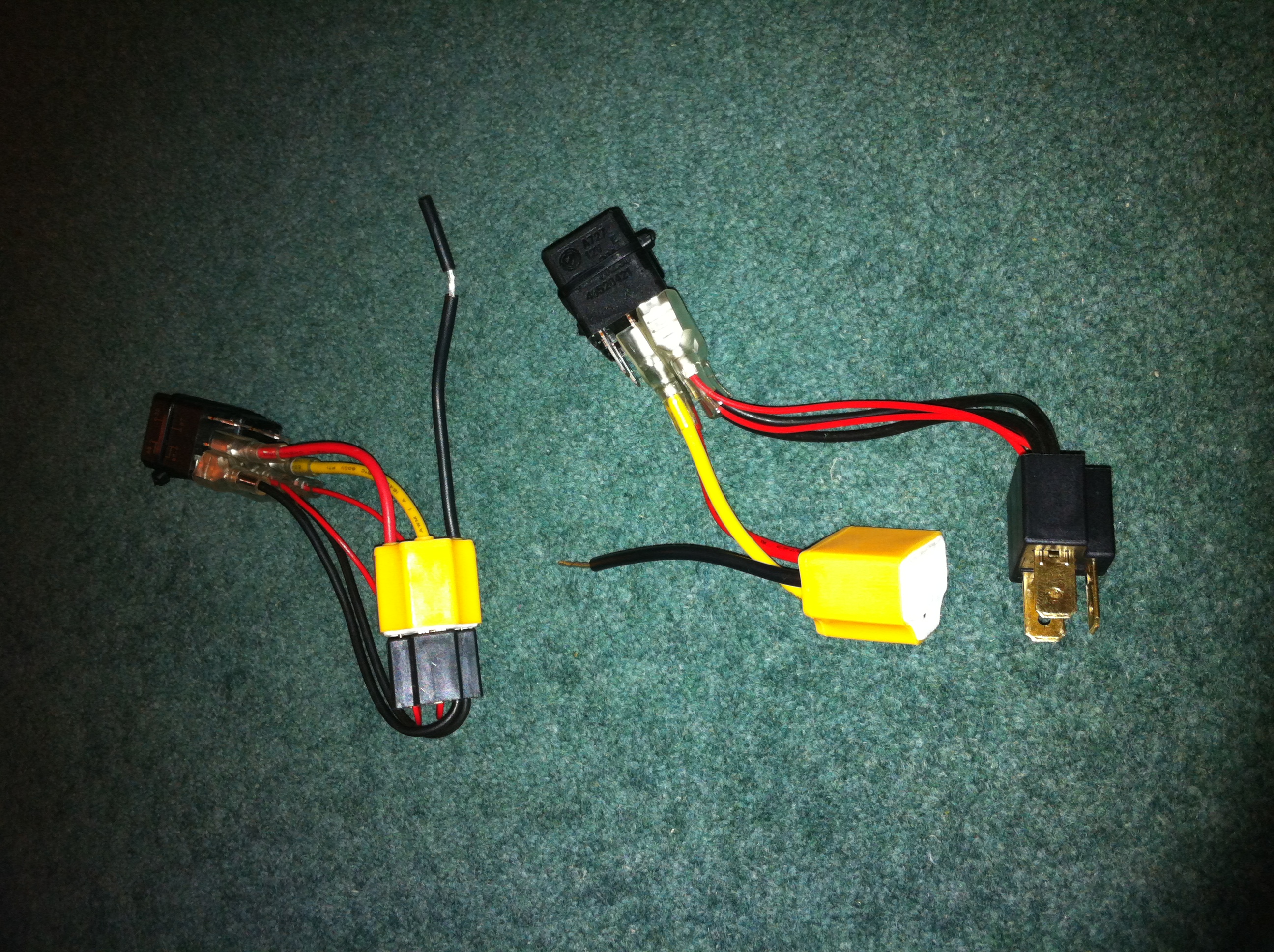

I've made up my headlamp relay systems, should do the job nicely of stopping any new issues with the headlamp switch :D Here are the parts as ordered
And once my creation had been completed - idea being they just plug into existing wiring loom so there is no chopping up needed, and connect to the fresh +ve and -ve feeds I've run to each headlamp unit.

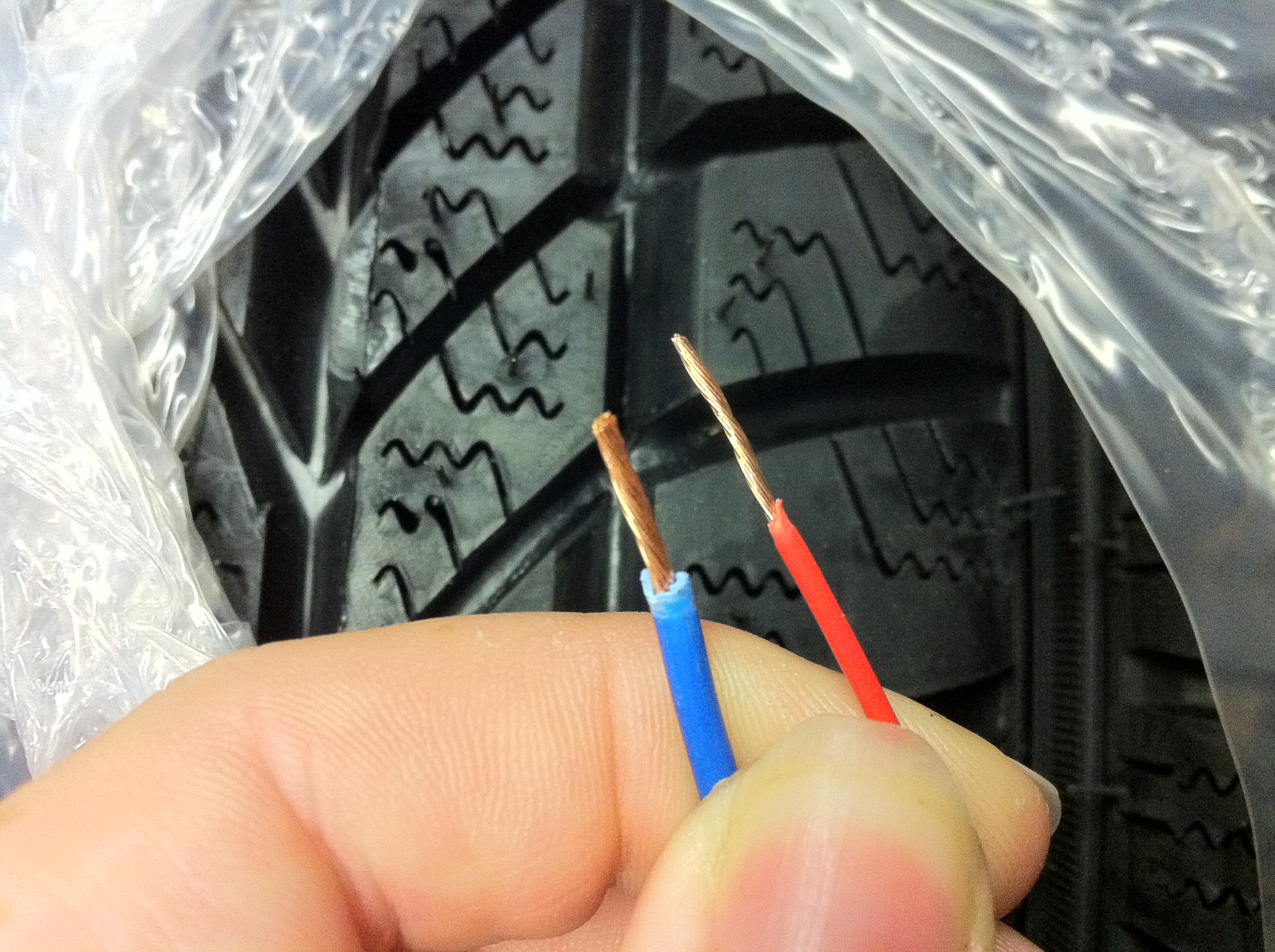

I ordered some 11amp wiring, ample to provide a +ve feed to the headlight units, cheap on eBay, a bit of a mistake though as I didn't hold much faith in its quality and thickness in comparison to 17amp wiring, even though I measured it and it is correctly rated. So for piece of mind I used 17 amp wiring :eek: :spin: Here is the red 11amp next to a piece of blue 17amp.
I've also installed the new wiring to the new headlamp relays, a fresh +ve feed to both headlight units from the battery, and new earth from each to the NS earthing hedgehog (y)

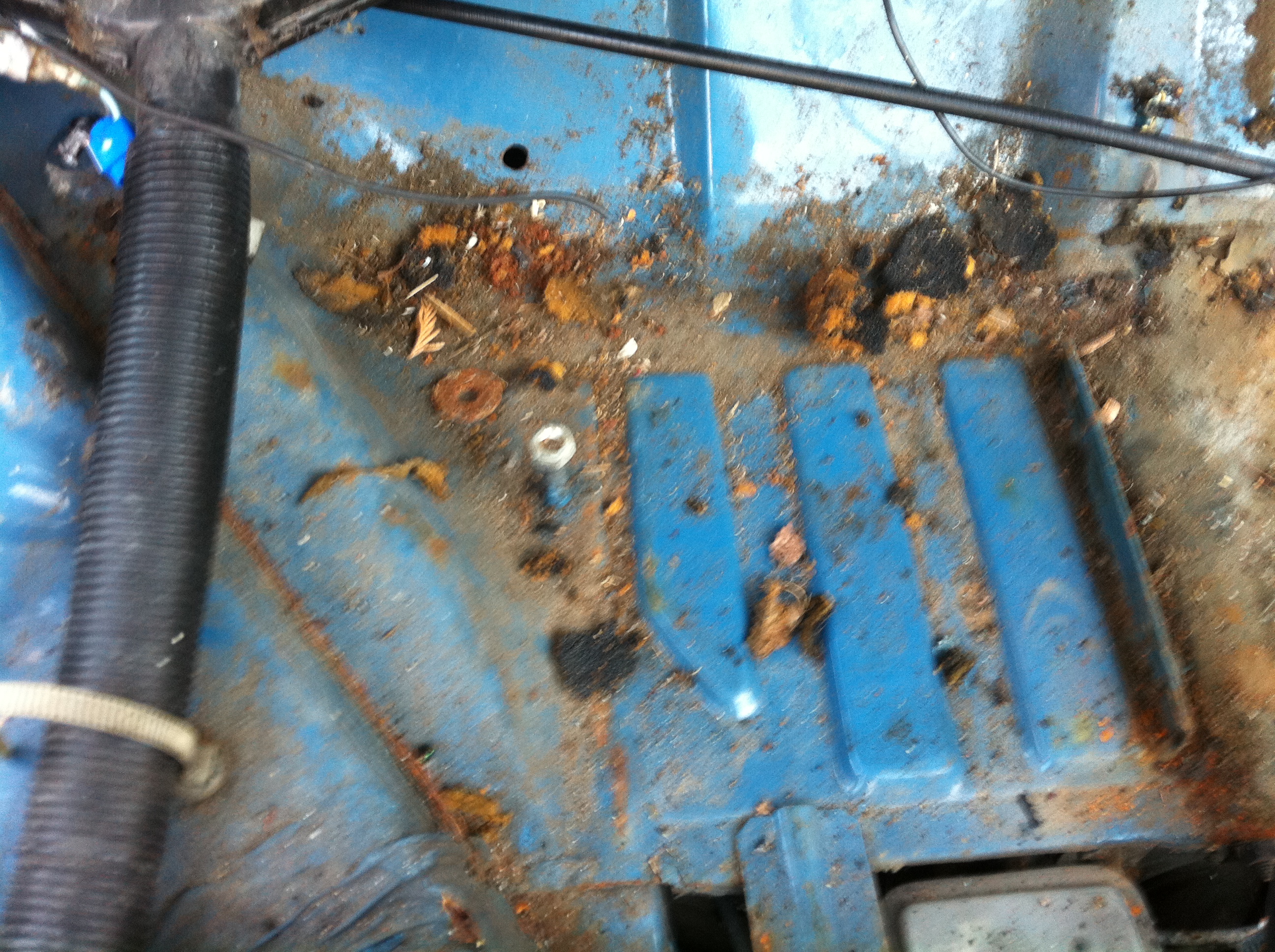

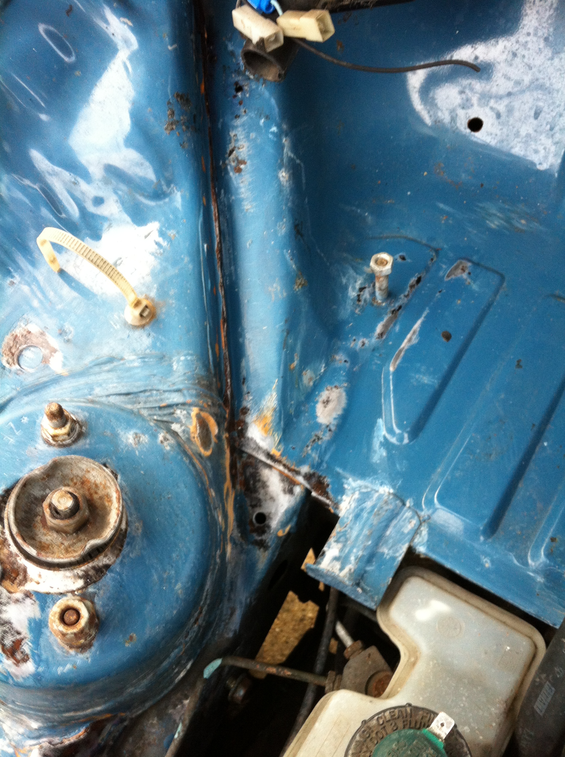

Here is a bit of a half finished job of the rust spots in the engine bay. None were serious, all only surface luckily. Will upload some more pics of it a bit more completed at some point.

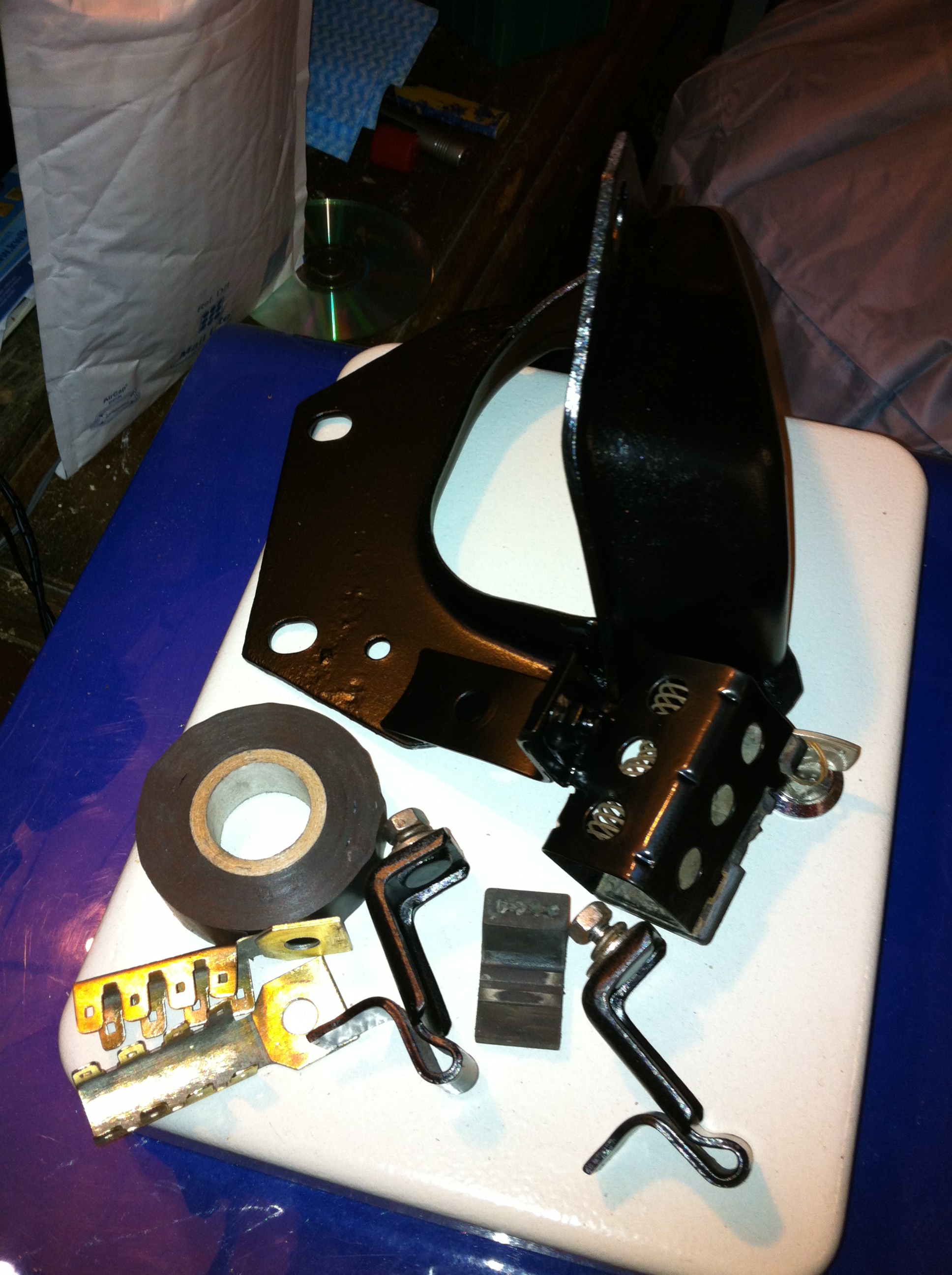

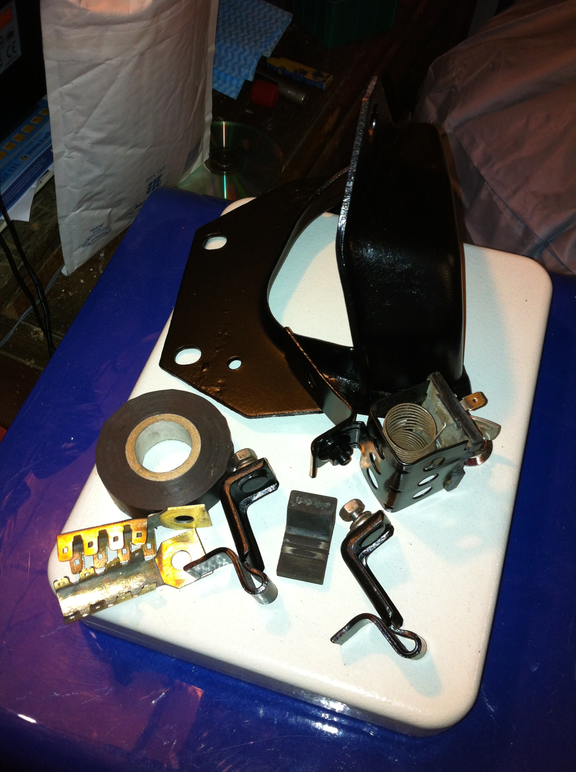

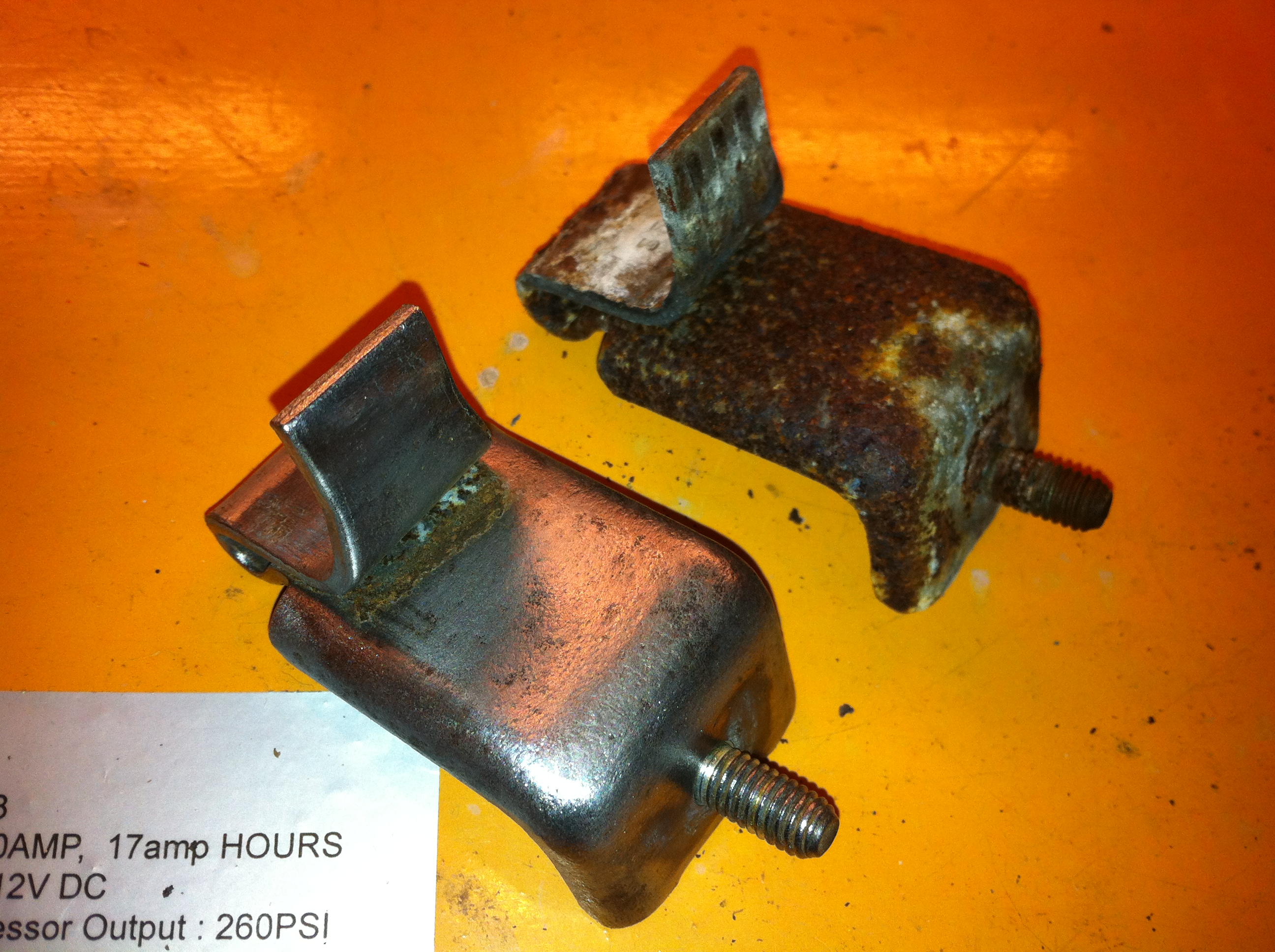

And heres some of my black bits :eek: I've removed and cleaned up the radiator and fan mounts, OS engine mount bracket and a few other bits and sprayed them black :)
The Radiator mounts, one cleaned and one its its origional state :yuck:

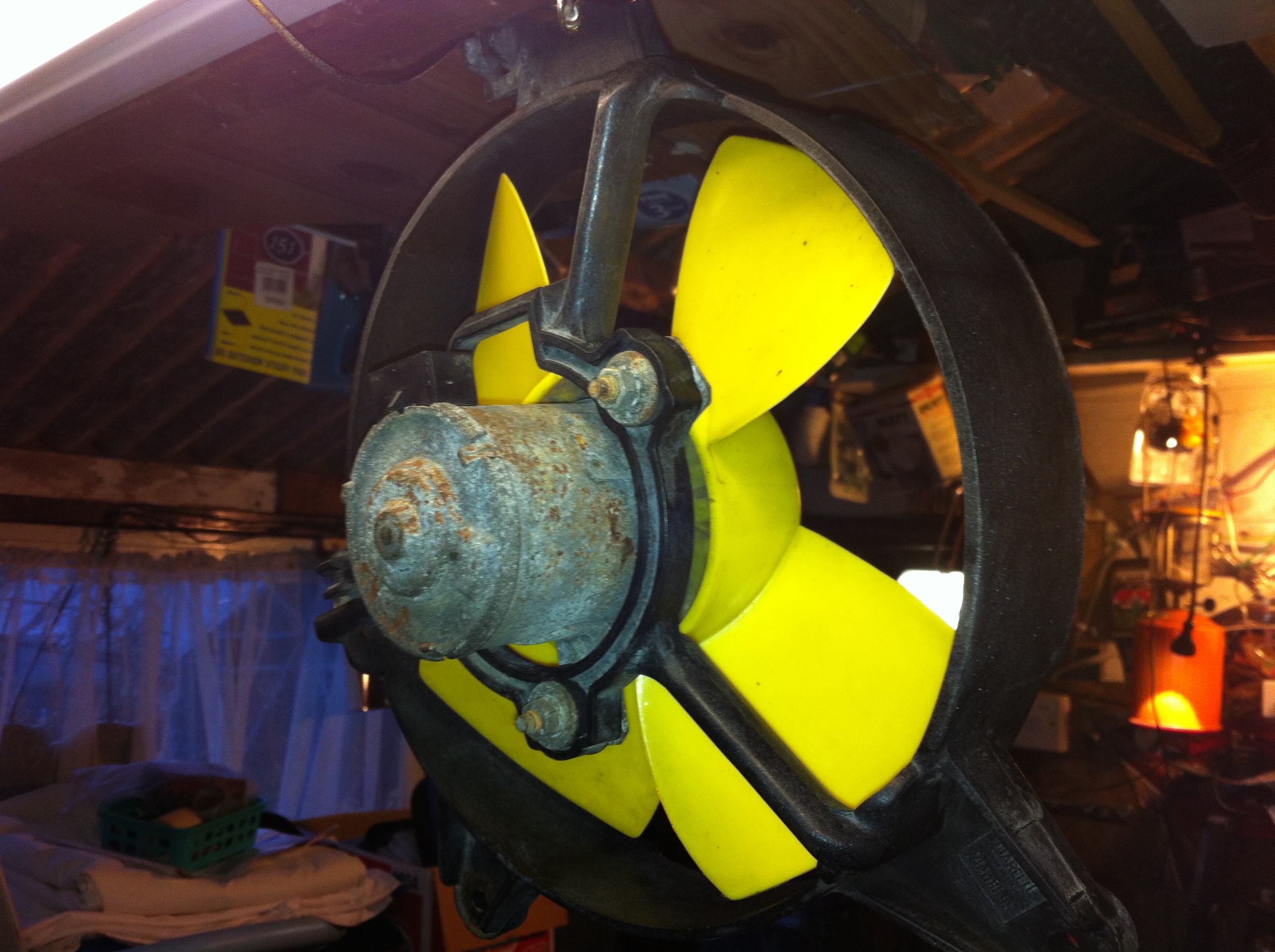

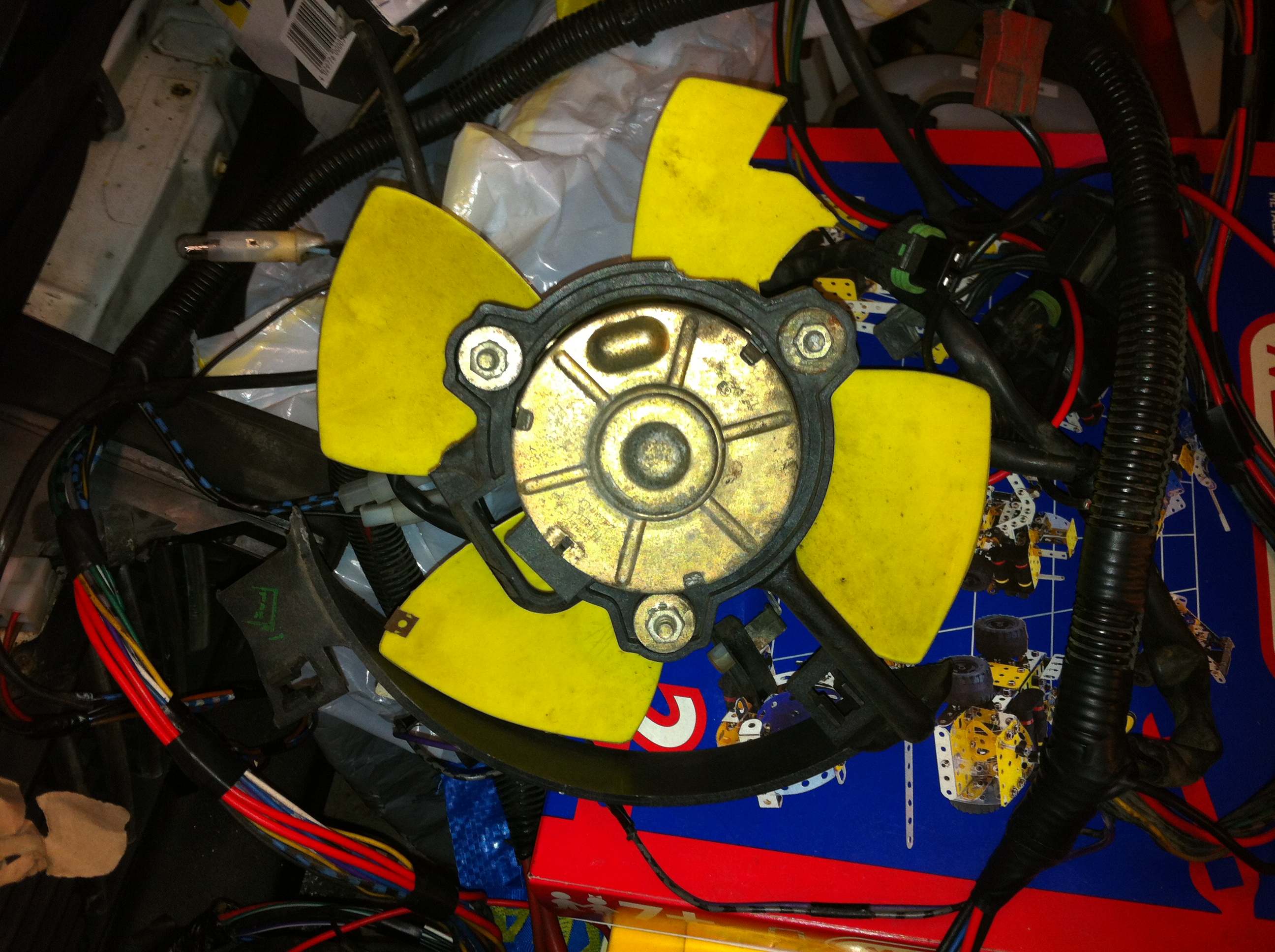

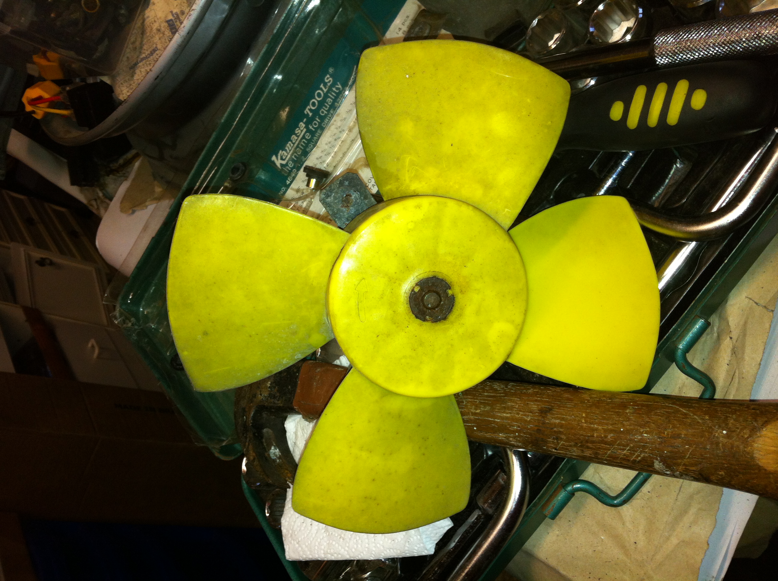

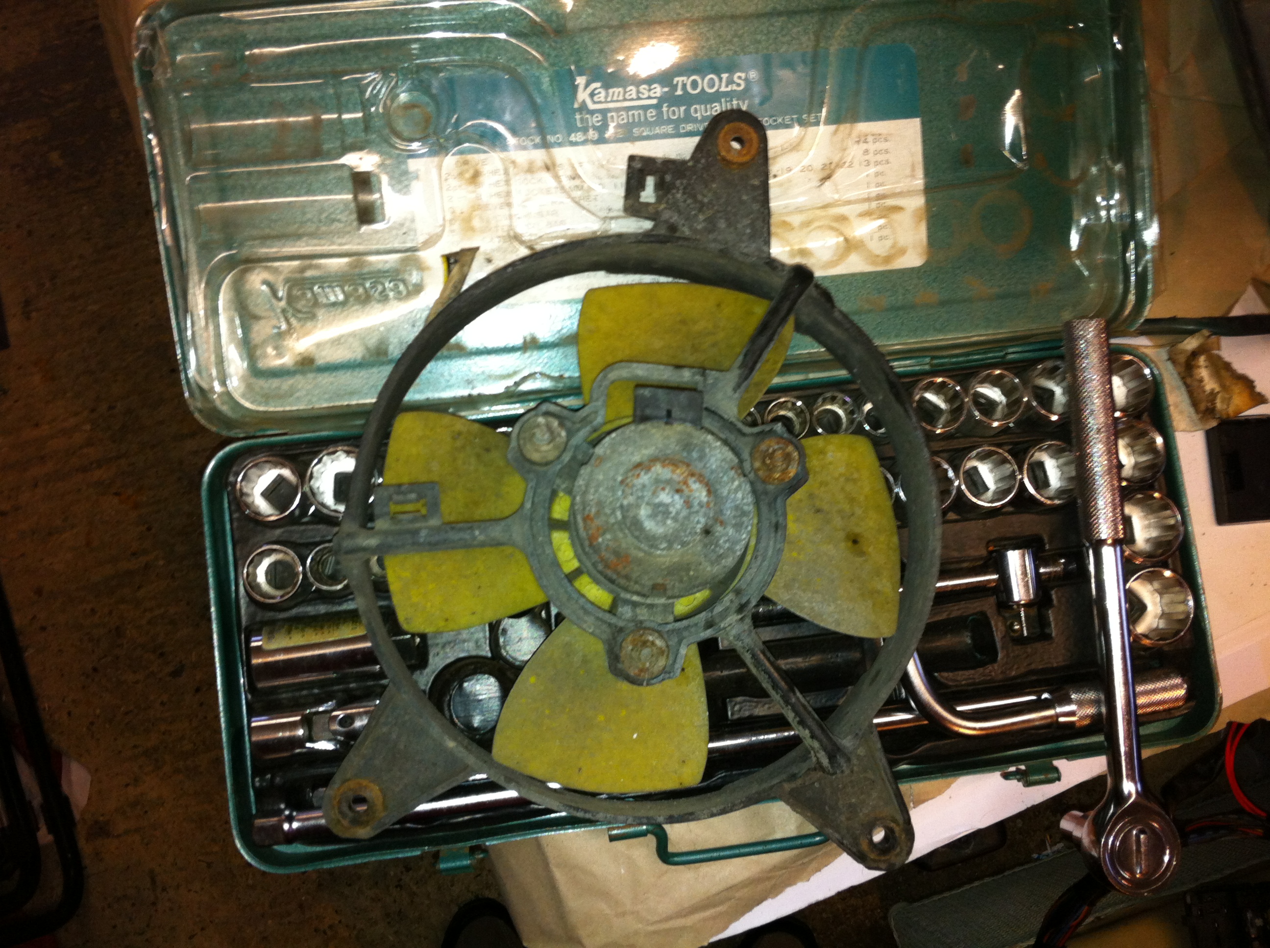

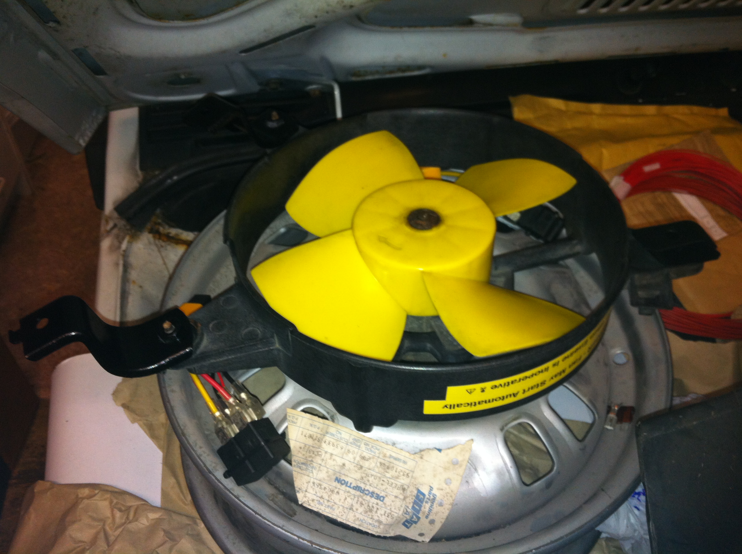

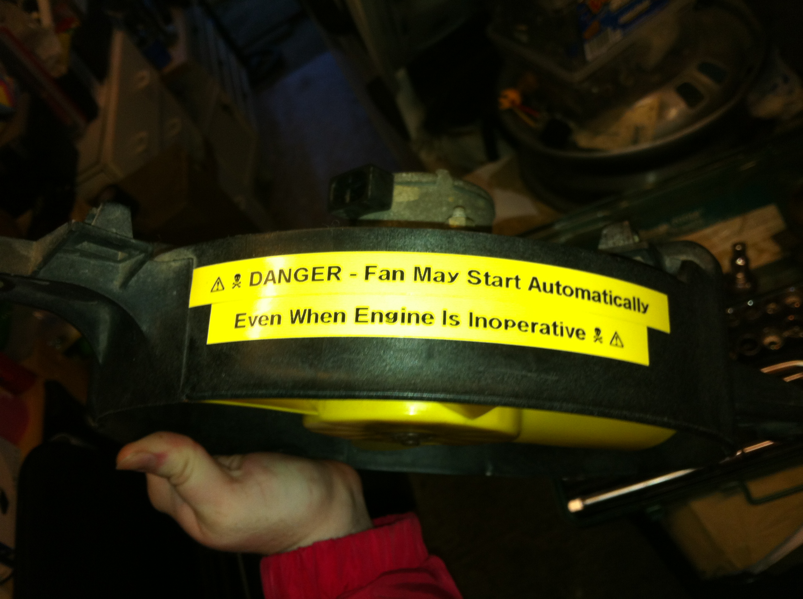

And I've removed the cooling fan and cleaned it up, origional plan was to use the cleaner motor off of dad's written off Selecta in the 750L but the blades just wouldn't come off of the existing motor, so used the if it aint broke don't fix it view and didn't force it too much.
Before the clean-up
The prefered cleaner motor
Progress, the cleaned fin at the 3 o'clock possition looking an improvement on the rest
One Newish looking fan :yum:

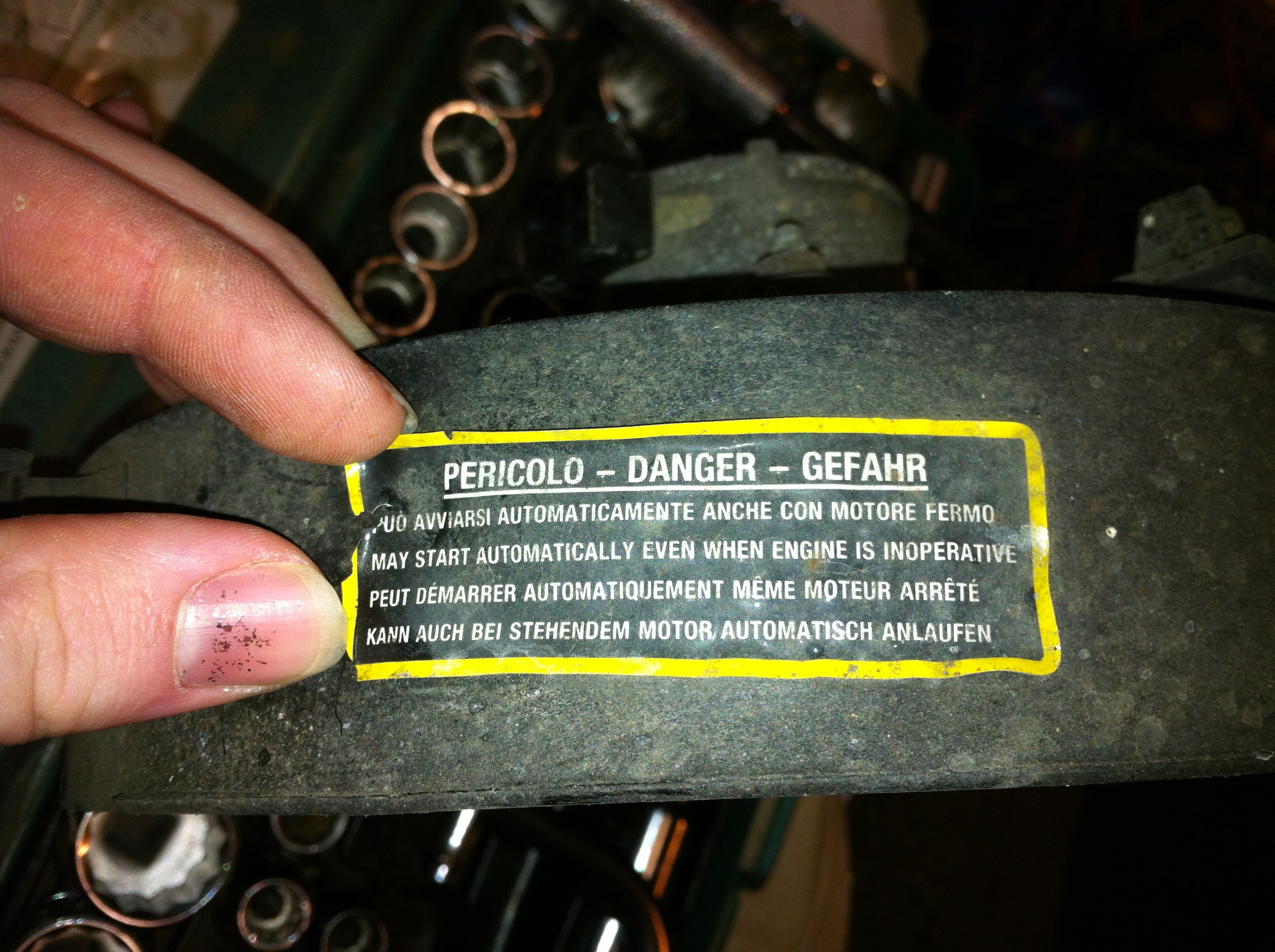

Unfortunatly I had to remove the origional warning sticker as it was dog eared and I couldn't clean the housing with it in place, but I've made a replacement :p
And the cleaned mounting brackets in place :cool:

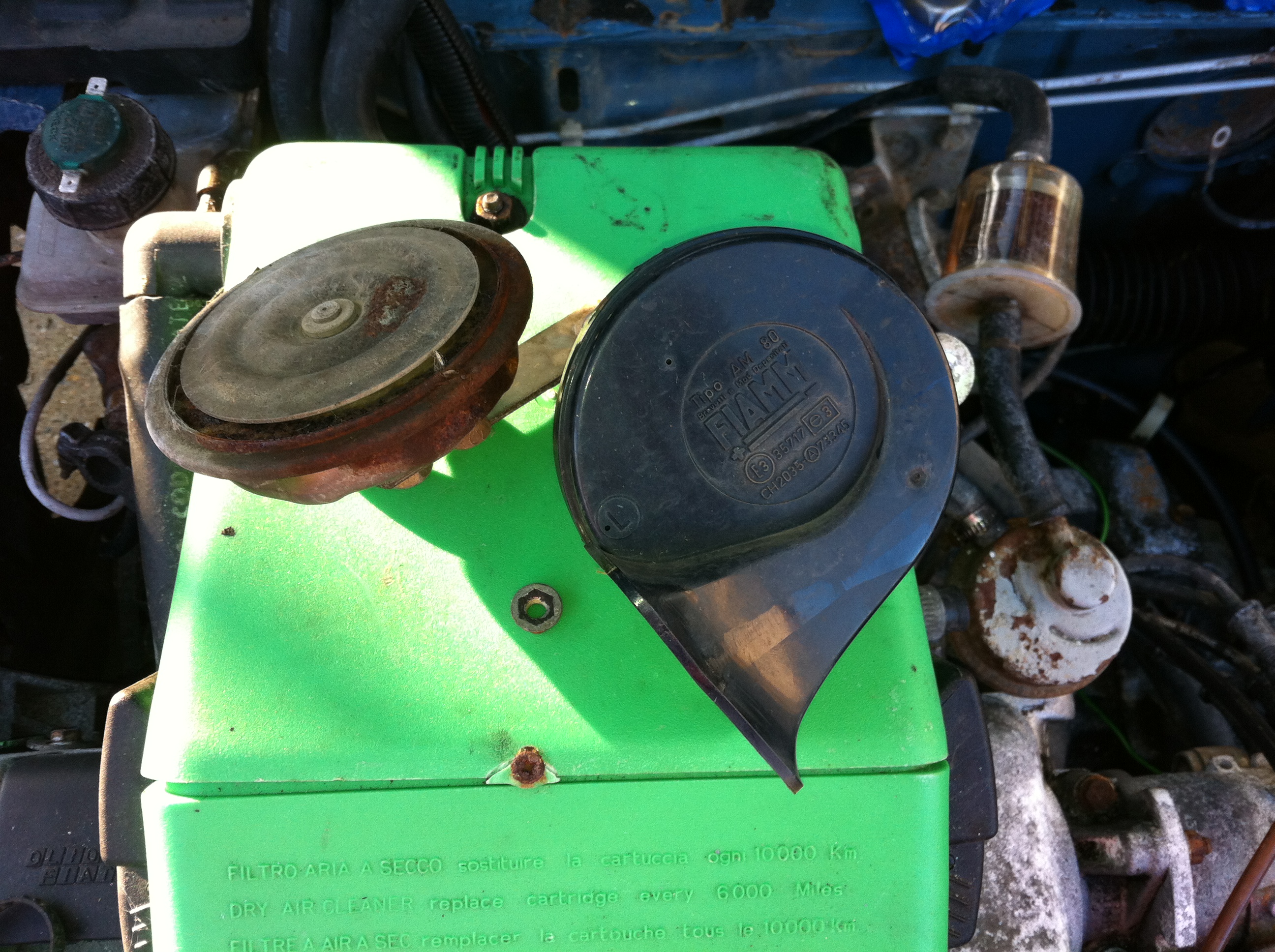

And a minor horn upgrade. Air horn FTW :slayer:

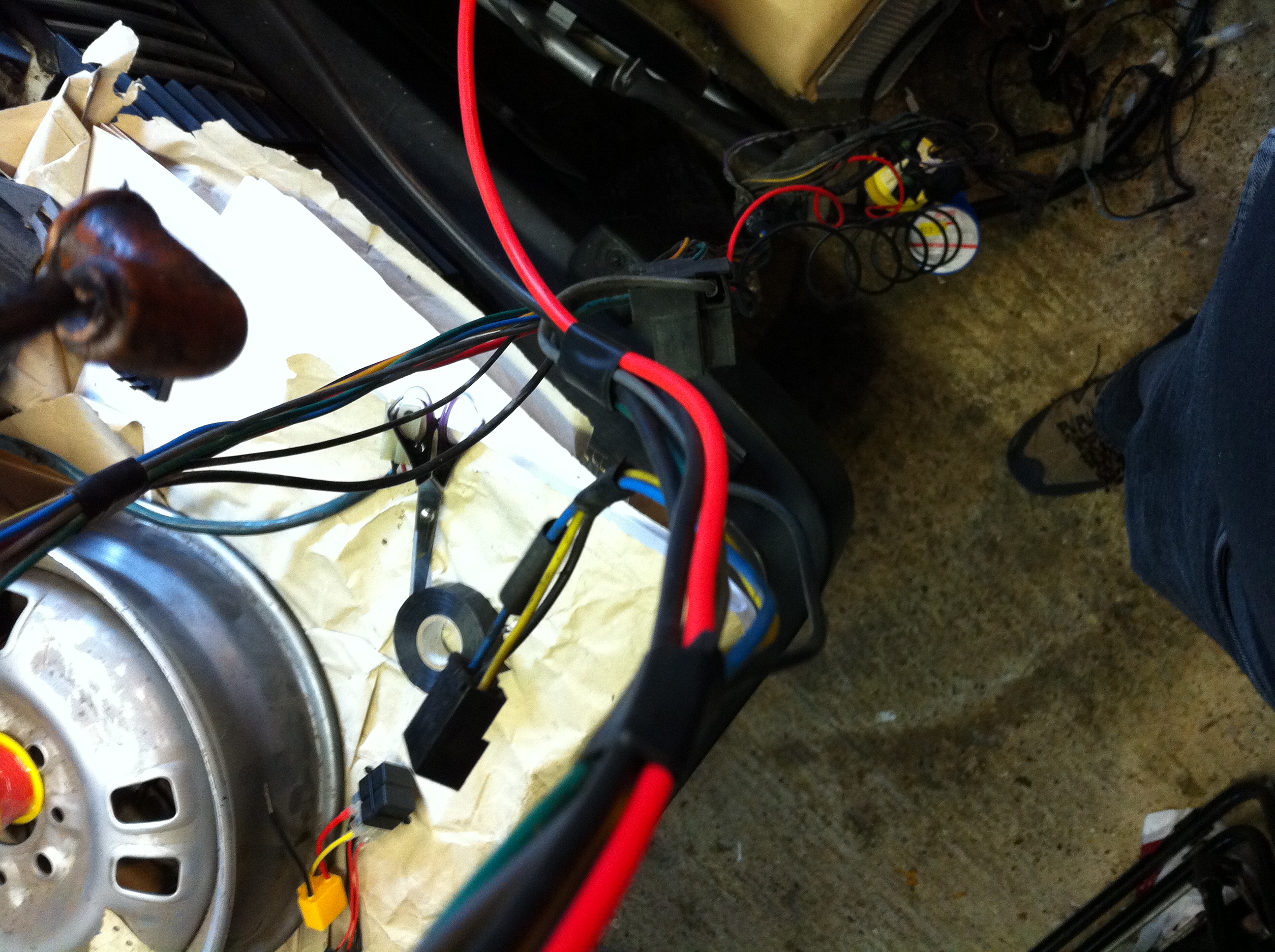

Forgot to mention that on Wednesday I got the wiring loom back into place. Everything connected up, turned over and no spark :bang: Then noticed the lead from the wiring loom to the coil wasn't connected :doh: one nut later and up she fires, first time after sitting for months :slayer:
Swapped the horns around and just need to be a bit of tidying in the engine bay before getting all the dash back together and bits inside the car. Although the engine bay wiring loom is from another 750L, it was removed from a 1992 J-reg, and it would appear the interior light wiring was run through the rear loom up the 'B' pillar, where as on Victoria the wires run up the 'A' pillars from the engine back, so some minor additional wiring has been required. Also means one of the two plugs for the connection to the rear loom won't marry up (n) So I've got to make a minor modification to that :rolleyes: :)
Thought of offering a kit for the lighting?? I would buy one and I'm sure others would too....
I had thought about it. Will guage interest :)
Give me a bell some point tomorrow and we'll discuss it, I'll advise of the provissions you'll need to make (no different to as discribed above mind).
The only thing is you will loose the dim dip feature unfortunatly. Works as either sidelights or full dipped beam.
