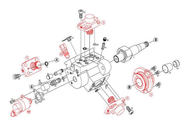

... right, car's fixed. They've had to remove the pump and send to local diesel service for sealing. They didn't have to touch pressure sections, but only replaced the outer O-ring on the shaft.
This pump is pretty simple design and if it leaks it can be fixed pretty easily as a DIY: https://autodieselparts.com.pl/1176...0445010318-0445010319-0445010320-pd-5697.html
Schematics: http://www.dieselcatalog.online/en/bosch/04450/0445010320.html
It sometimes leaks from the "pressure" sections, there are 3 of them. It's apparently important to tighten them back with a proper torque (8-10NM, don't quote me on that, check manual).
