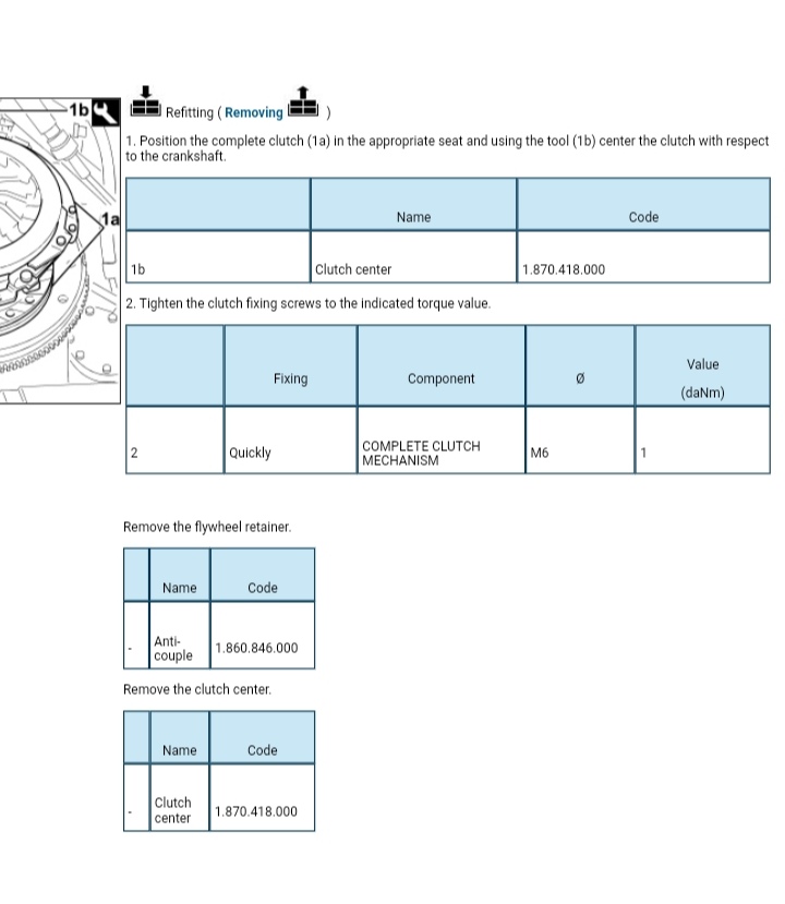

Many thanks - that's clear enough, presumably from the genuine FIAT repair manual!
Yep it's freely viewable online

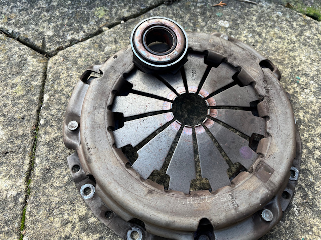

The new clutch is in, thankfully with some help from a chap called Dave. The new Ridex clutch works beautifully, with a nice light pedal action.
The old AP clutch, most likely original, still had a good amount of friction material left, but the release bearing was quite knackered - very rough and noisy, even though I had not noticed any particular noise when the clutch was operated, just the very heavy pedal. Dave noted the wear marks on the old pressure plate:

The heavy pedal is a sign the clutch wear is causing the pressure plate spring to move too far. It’s angle gets steeper as the clutch wears so it gradually gets harder to open/release.
