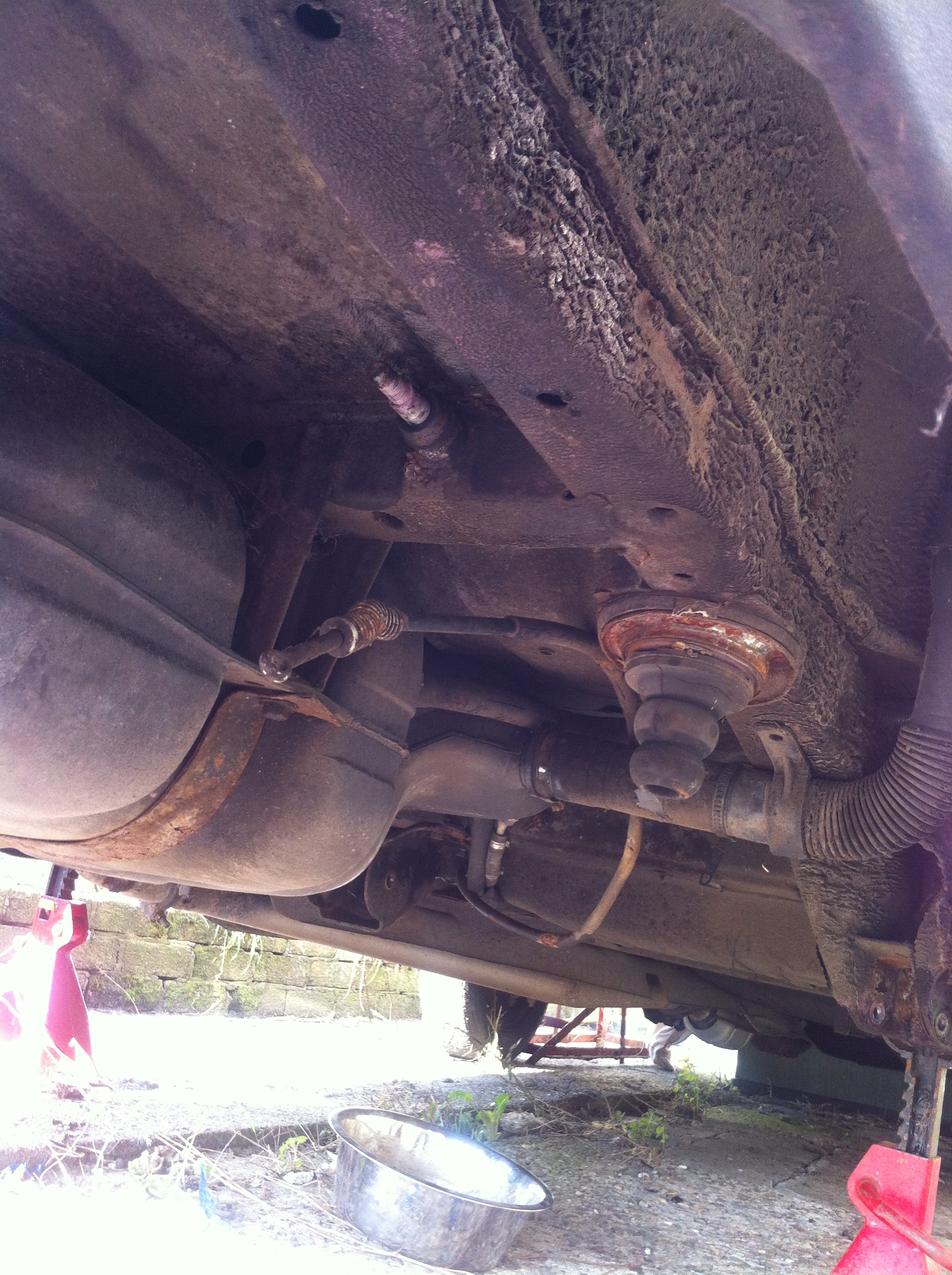

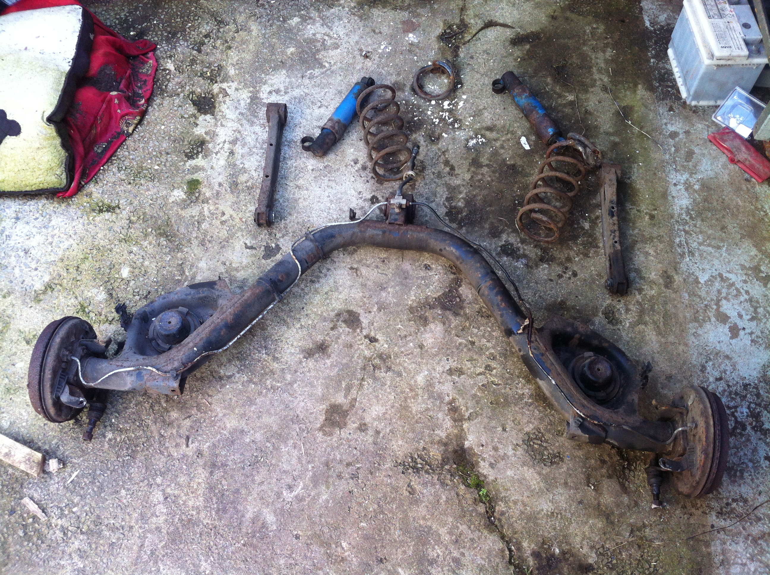

well it currently looks like this , dropped the rear beam off , ready new brake lines bushes and ill be replacing the brakes too.
also got a few pictures of the underneath to show how solid it is .any idea where i can get a replacement centre rear beam bush , like the last one attached?

Hi Chris, nice looking car you have there(y)
As far as I know the official line from Fiat was always that the bush on the beam was integral and replacement means a whole new axle. The good news is that Partsworld are knocking out the whole axle at £100 on ebay which is waaaay cheaper than list. It's a massive bush so I suspect a real challenge to fit a new one even if you can get one separately, and it's a lovely shiny new bit to start your resto:yum:

Thanks for the advice , I've got a press so fitting a new one wouldn't be a major issue but I've made an offer on the axle on ebay anyway as it's a lot less hassle and it seems way too cheap to ignore.

Usually it's the spring cups which rot through - I guess you just had to be different!
yeah spring cups are solid on mine , tbh the bush looks pretty solid from what i can tell but from the knocking it seemed to be making when it was on the road i'd rather change it , as once it goes back on i dont wanna have to remove it again....ever! haha

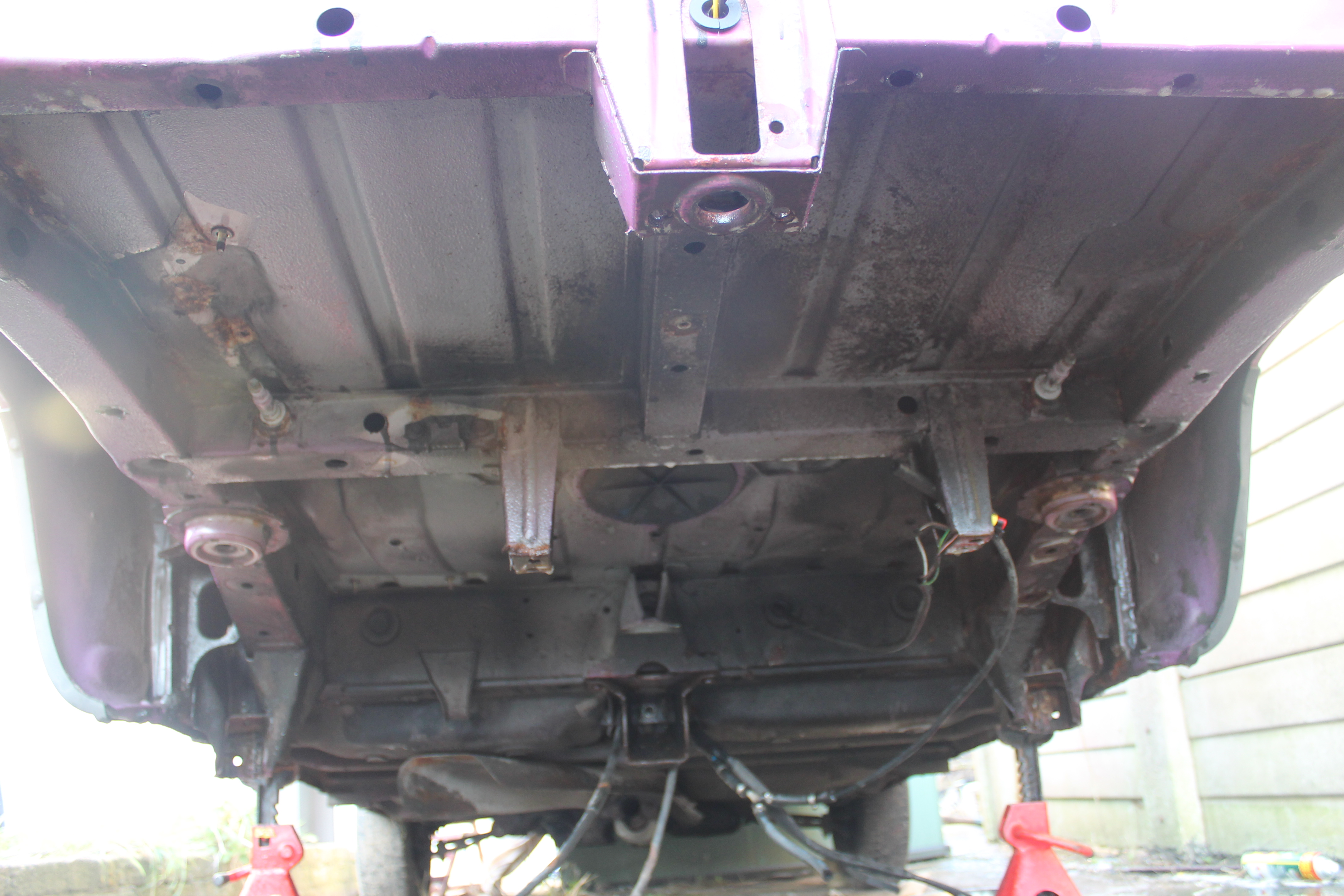

well seeing as the weather was good again i got busy,
fuel tank out! , ill be getting these made up in stainless steel to avoid them looking like this again.

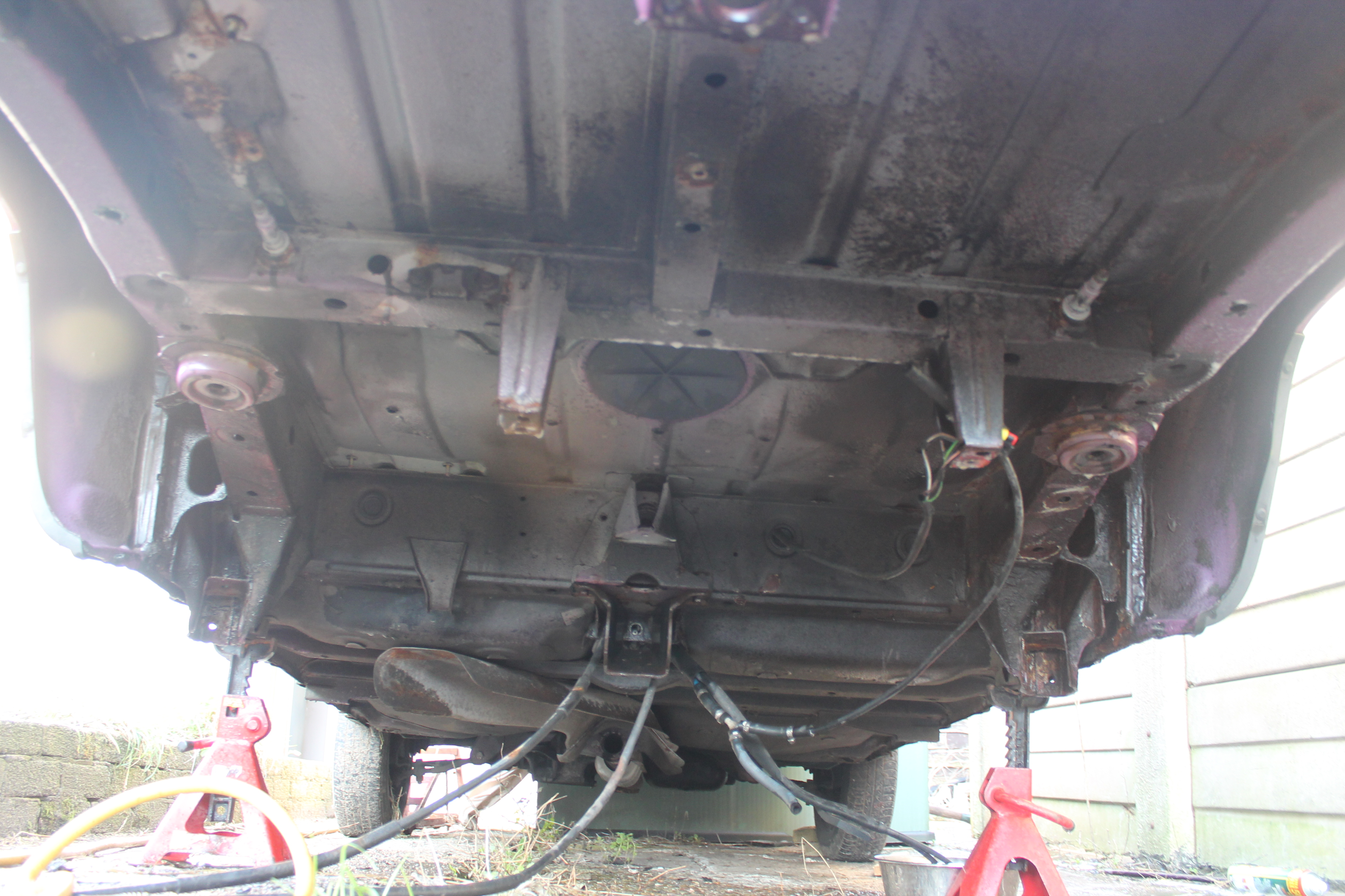

removed the rear bumper , exhaust and heat shield
then got busy cleaning the wheel arches and the underside

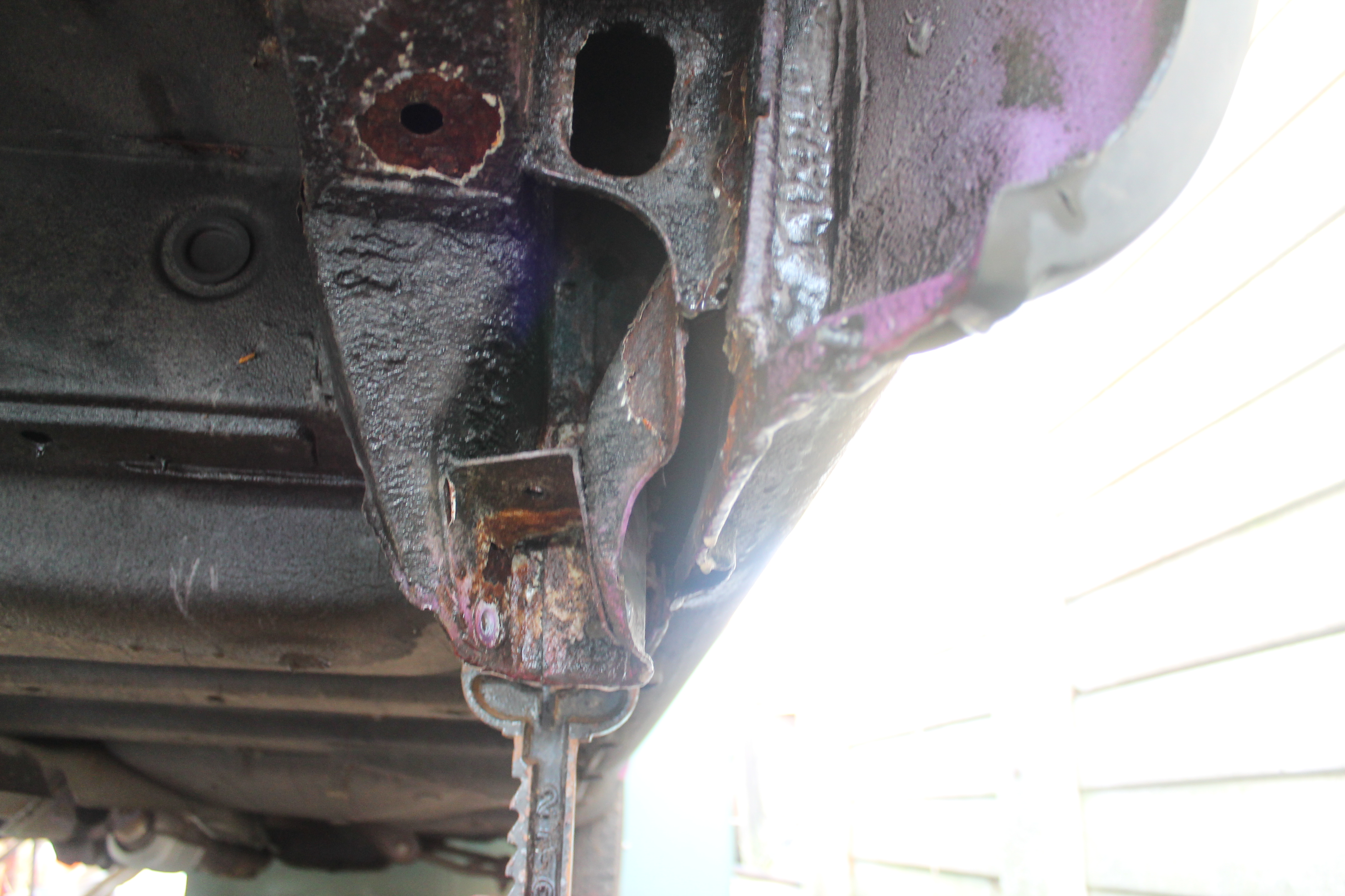

found a little bit of a whole too , only seems to be on the drivers side so the welder will be out next weekend to get that patched up!

Seems odd to me that the bush would be gone at such a low mileage, especially since it is solid now you have it off the car. Are you sure it was not something else making the noise? Exhaust? Or a dodgy damper maybe?
yeah i think it must have been something else as all the other bushes are in a right state but this one actually doesnt look too bad and doesnt have any obvious play, and seeing as the offer i made on the one on ebay was declined ,( put in a cheeky offer of £75) i think ill just refurb the old beam and try my luck with the old bush.

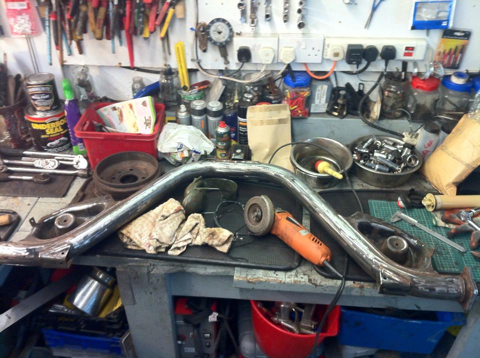

started cleaning up the rear beam ready for paint too
the beam , trailing arms and anything else will be painted silver
