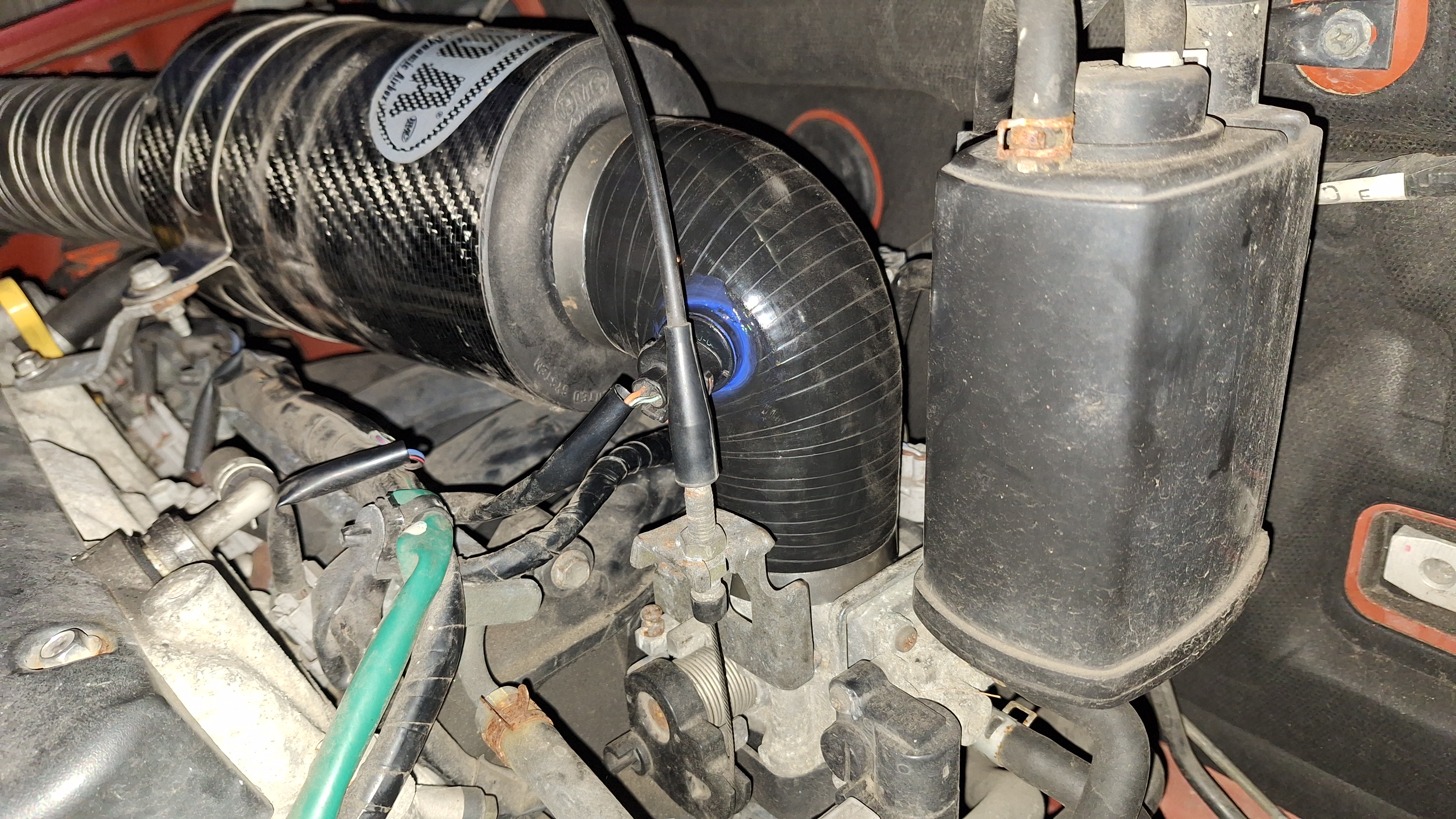

Other random stuff thats happened along the way.. the intake pipe split, my silly homebrew intake clearly was pushing on it more than i thought. Hey-ho, 21 years isnt too bad for a rubber pipe i don't suppose.
Fixed with a reducing silicone elbow - the sensor is air intake temp sensor for anyone wondering. And it did seal with the sealant but why not smidge of silicon'carne as well, tis post filter afterall - yes on reflection i should have grabbed the tube of black stuff, nevermind lol.

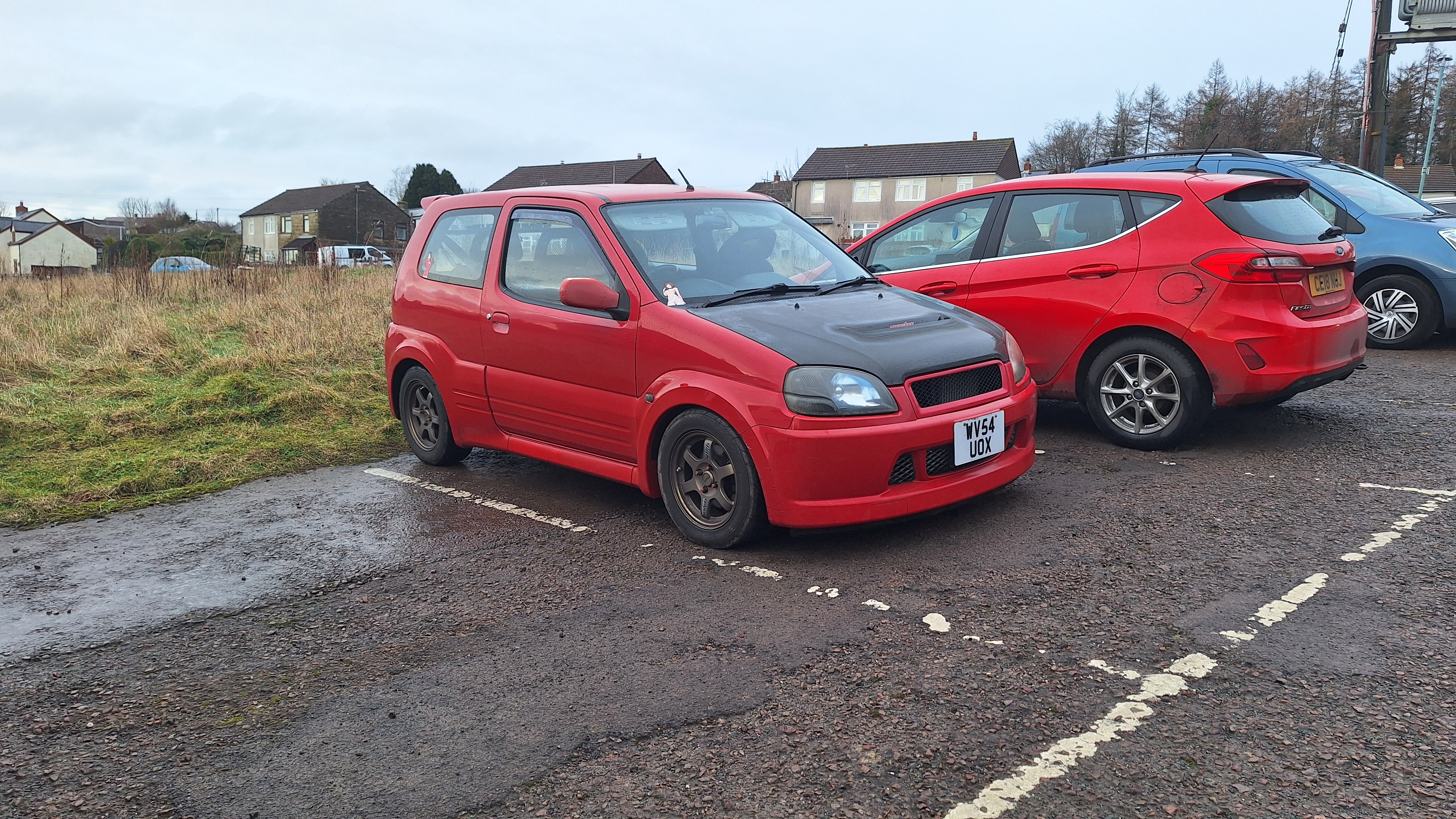

Cube ate another top mount so cars been doing the daily school run, its gross and needs a wash but this is as of today
Next, once cube is fixed its just wash & general service time.

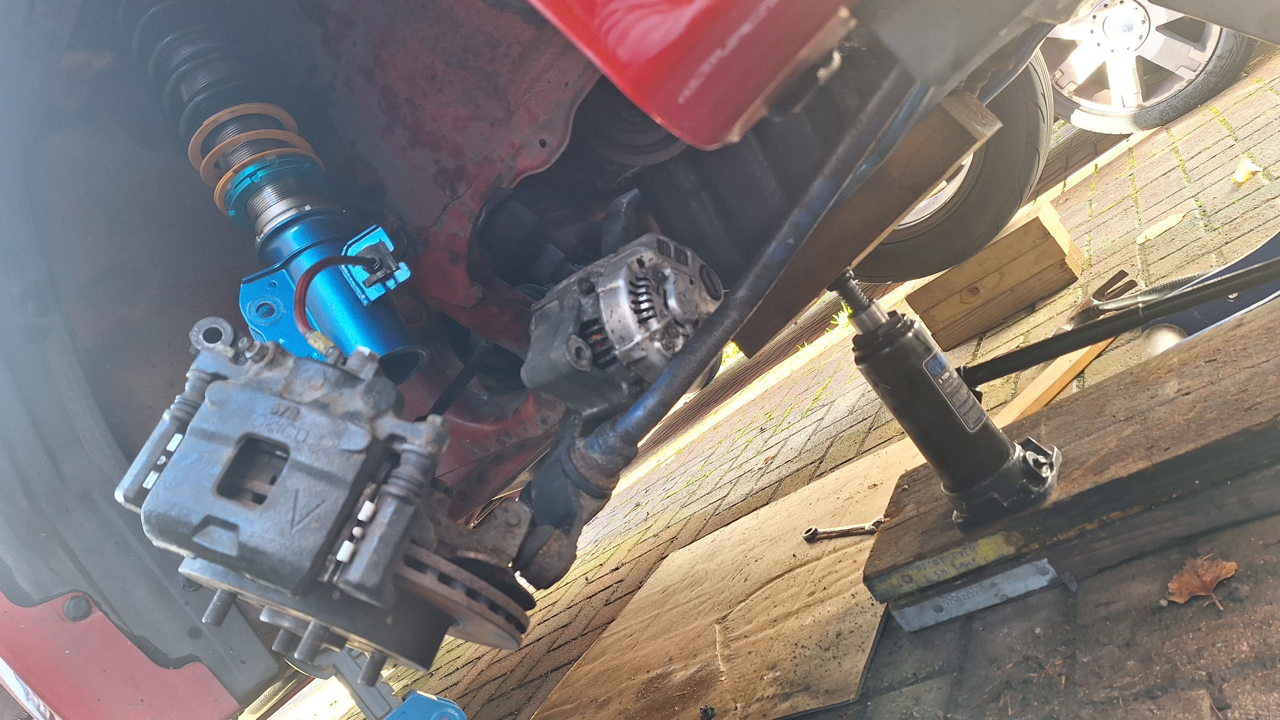

just looked back at that and i didnt mention the alternator... I did attach a pic lol... The alternator seized, upside is my starter is clearly strong cause it started car still, then i thought it was on fire as smoke bloomed out the front as the belt started melting on the pulley :ROFLMAO: .
Tricky little swap until you work out the technique to get it out and in the gap lol.

Well on the ignis its either inlet manifold off and out the top, or driveshaft off and out the bottom but its still a fiddle either way lol.. I figured after scratching my head a while if I just jacked the rear of the engine a couple of mm it just fell out lol. Also saying this reminds me, I went this way cause I had just had all this apart, so all new clean anti-seized bolts going in this way that just come off.. I think I forgot to mention that I have also had the driveshafts out recently to inspect the cv's and replace boots before they split (they looked really close to doing so) so all this really really had been off just before. And that inlet manifold looks awkward and has never been off once lol - was an easy choice it was which way to go lol.
