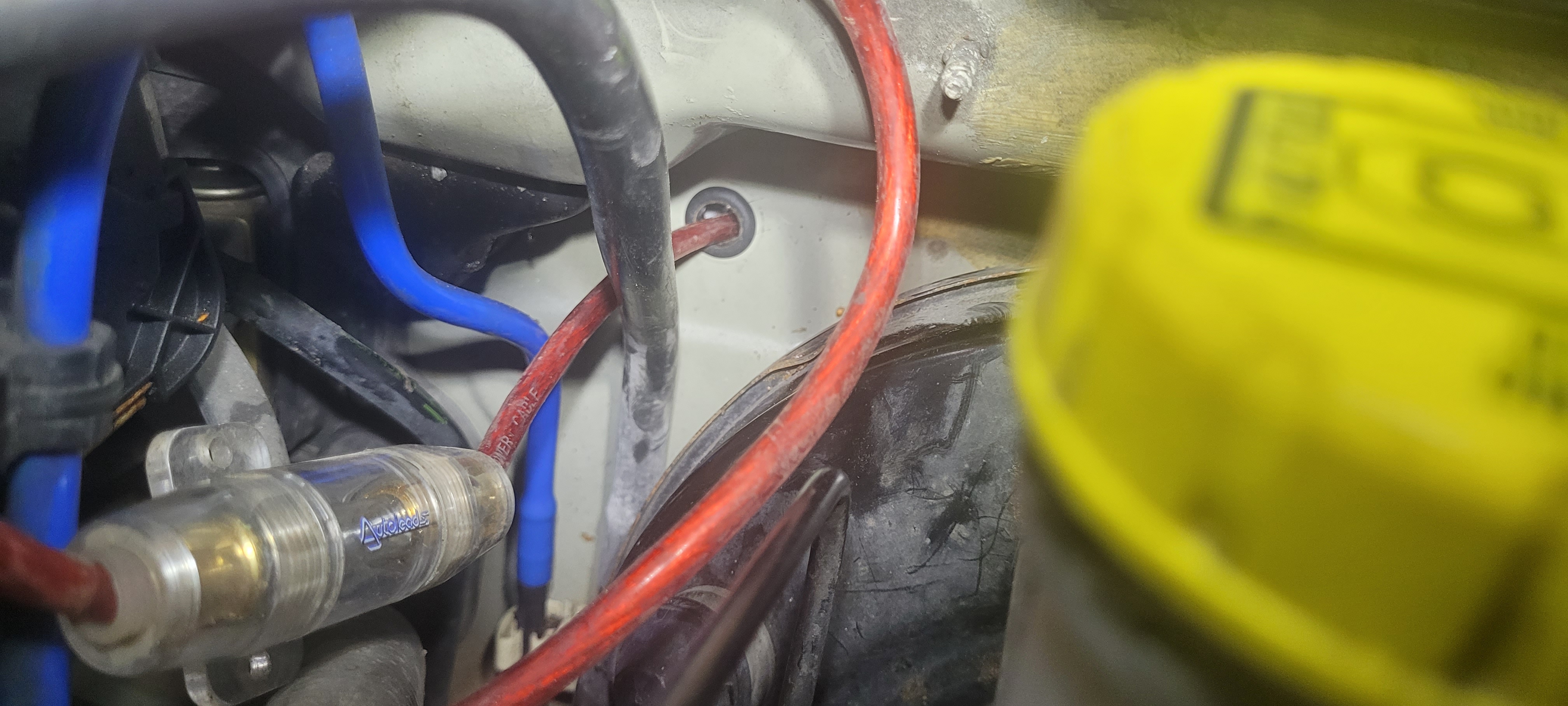

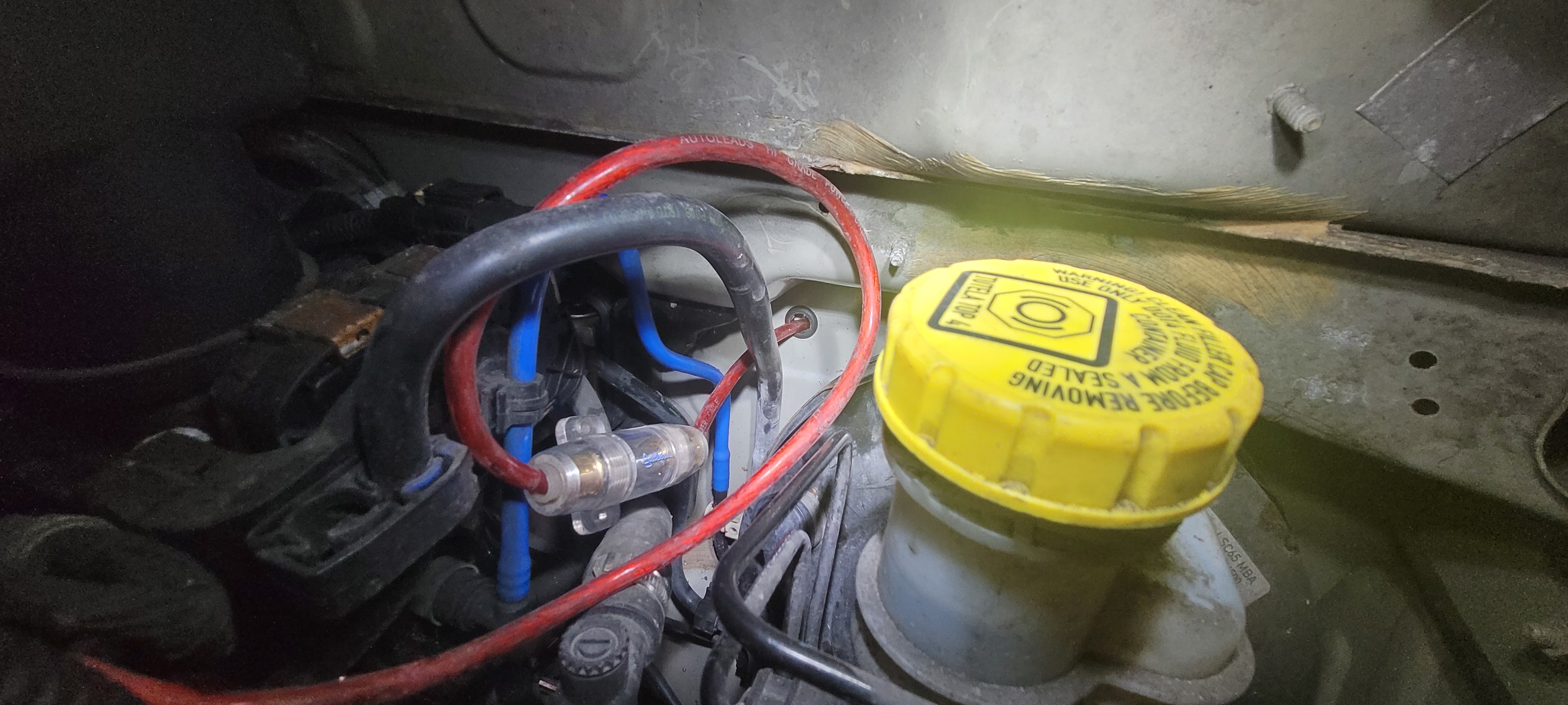

DiamondDave Patron member Written a guide Joined Jan 16, 2015 Messages 176 Points 121 Location Tipperary, Eire Mar 28, 2024 #4 A3jeroen said: Behind battery, under brakebooster. gr J Click to expand... Behind battery, left of brake servo. Pull out cap and put in grommet. Push a screwdriver through blue material within car Attachments 20240328_084908.jpg 1.8 MB · Views: 8 20240328_084853.jpg 1.7 MB · Views: 8
