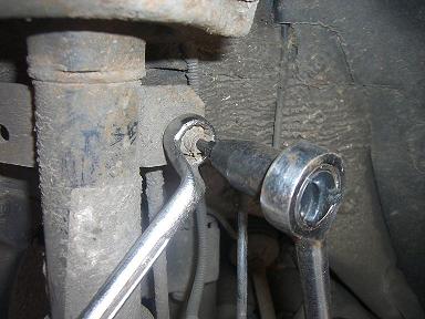

Just get hold of the back of the ball joint with a mole wrench over the protective boot and undo the nut with a 16mm socket. The protective boot on the drop link is very tough so you can use a mole wrench on it to grab the shoulder of the ball joint underneath without problems. You can put on new links using this method too without problems of damaging the boot. Move the link out of the way, no need to disconnect the bottom one

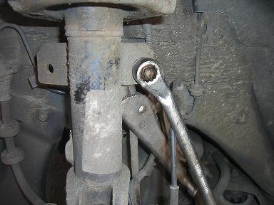

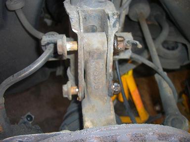

These are not as tight as you might think they are gong to be but a long bar makes easy work of them. Don’t remove the nuts entirely yet, only run the nuts up to the end as you’ll need to use a hammer to knock the bolts through and don’t want to damage the thread. BUT BEFORE YOU DO. Move the ABS and brake pad wear wires out of the way. Don’t want to smack them with the hammer
OK just knock the bolts through a bit to get them moving as they’ll have a bit of rust holding them.

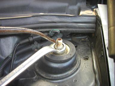

Put some oil on and get to undoing the very top nut but don’t take it off completely just yet, you’re just loosening it ready, so take it up until it’s just finger tight and then leave it ready. You may need to use a torx or allen key in the screw centre to stop the shocker spindle turning while you unscrew the nut..

Ok you can take off the nuts and turn and knock out the bottom bolts now. Then you can lever the hub out towards you
Now the strut is just hanging by the top nut and cover, so, supporting the strut with one hand underneath just undo the top nut. Take off the cover and now your strut is ready to remove from the car. It’s not very heavy.
WARNING DON'T even attempt to undo the nut shown down in here under the top cap. This is the strut spring retaining nut and is holding your strut spring on.

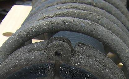

When your garage man reassembles the strut with the new spring for you, make sure they have lined up the top cap and bearing surface like this with the point on the cap and the hollow on the top plastic bearing surface all in line with the bottom bolt mounting brackets. If not then they’ll have to do it again as it determines the angle of the top mount in relation to the bottom strut
